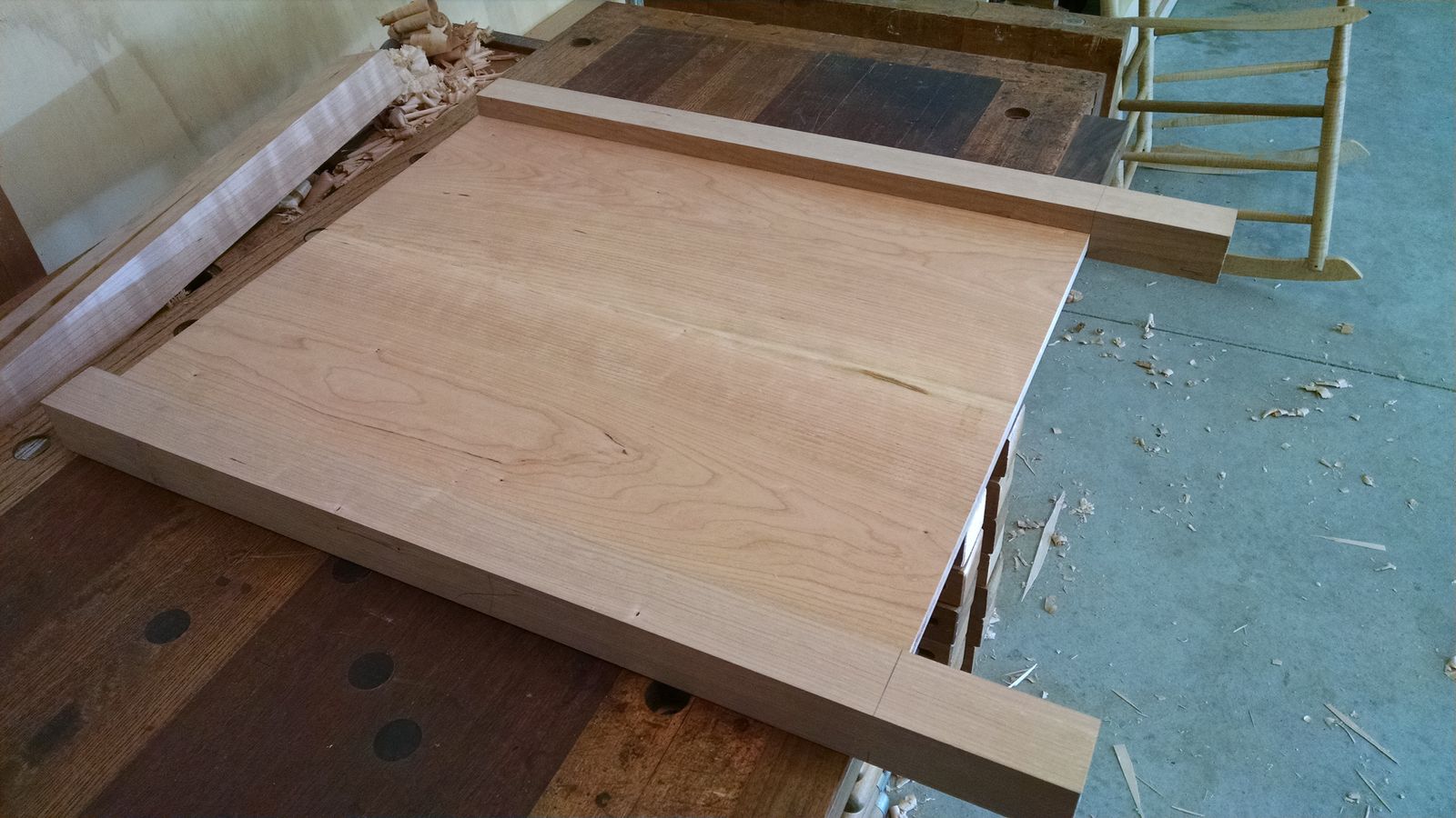

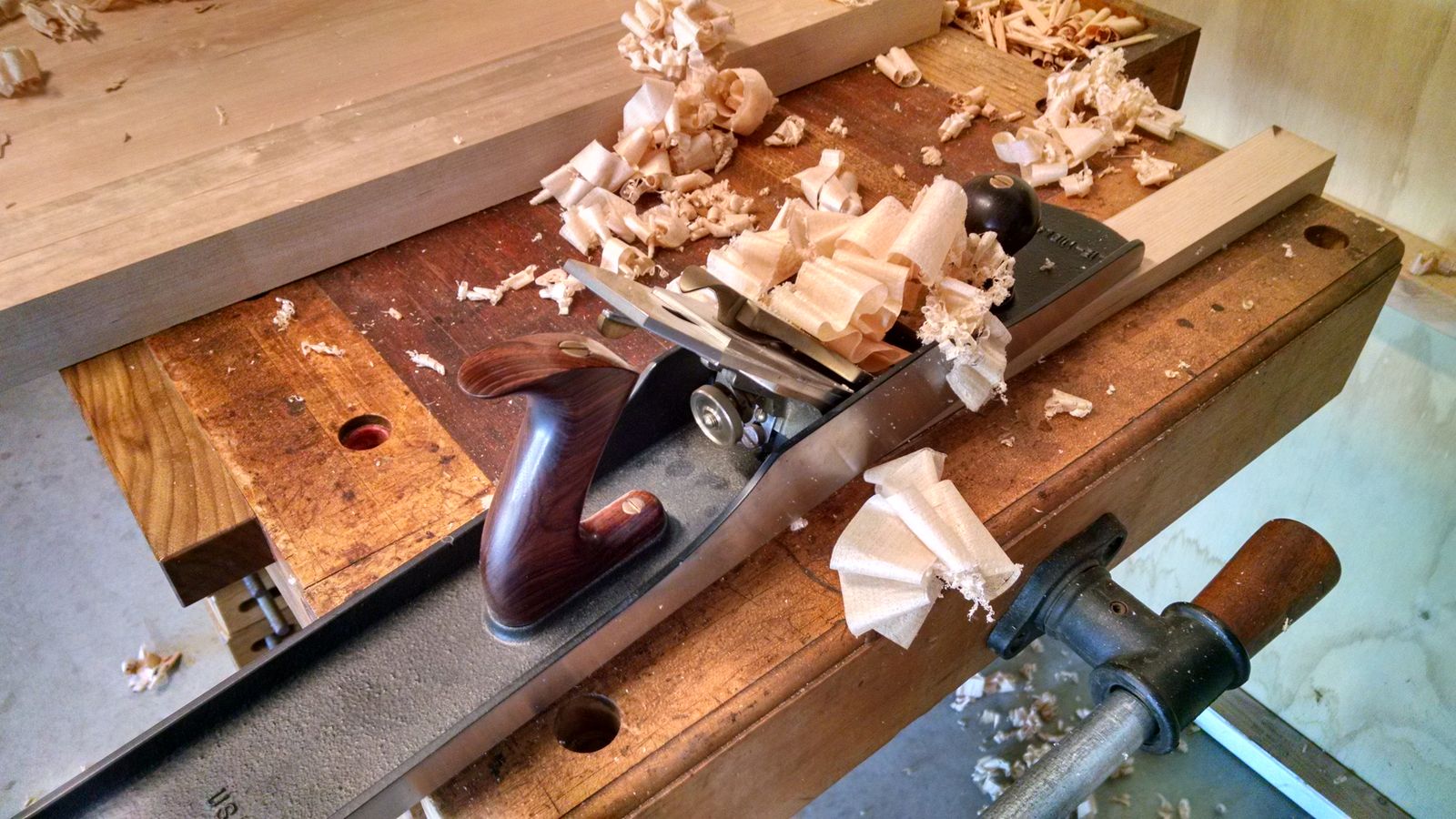

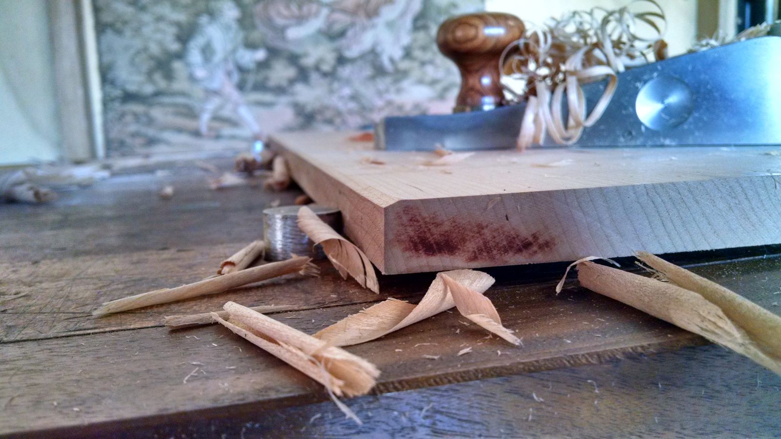

Popular Post John Morris Posted August 5, 2019 Author Popular Post Report Posted August 5, 2019 Well here we are, hot as heck and the garage is pushing 94 degrees all day, so it was hard moving from our AC 78 degree home to the 94 degree garage, but my son and I ventured out anyway. Saturday we pulled the clamps from the panels and found the panels were cupped, and I think it's because the clamps were on all week under pressure and the heat and humidity we've had, all added up to undesirable conditions for our panels. So we had to flatten the panels. I undertook this operation myself with my son standing by and watching, I just wanted to get moving on the project and get this little FUBAR taken care of. So I pulled my Veritas Jack and went to work, in diagonal directions, keeping an eye on the thickness of the edges and trying to keep a uniform thickness. Before I started working the boards I planed a chamfer on the edge where the plane exits each stroke, by doing this you avoid edge tear out, since the plane is working almost perpendicular to the grain, the risk of edge tear out is high. I started working the panel from left to right diagonally and with deep cuts. The panel is flat now, this image is after about a dozen passes left to right. You can see the short flaky shavings indicative of planing perpendicular to the grain. Someday I'll camber the iron of this plane to avoid the edges of the iron dipping into the surface, but since this is just rough planing to flatten, and it will be followed up with a smoother anyway. I took a few passes on our newly flattened panels with a No. 4 Smoother, I demonstrated to my son how to accomplish this operation. Then my son jumped in and started smoothing the panels. He is really taking to planing, becoming familiar with the planes quickly and I can tell when the plane hits max efficiency and the wonderful sound of "scweeeeeesh" rings out with full shavings rolling out the top, he is really taken in with it all. With the panels prepped and ready, we cut the legs out on our Shopsmith, 1 3/4" x 1 3/4" and a tad over to allow for surfacing and clean up. I started out with the Jack and it was working beautifully but I noticed a couple of the legs were bowed end to end so I pulled down the No. 8 Jointer and flattened the bowed legs. Once the legs were taken care of we squared up the panels. After the panels were squared up I was able to understand how wide and deep I had to make the grooves in the legs for the panels to slide in. I am still getting used to my new downsized shop, since I downsized last summer, I really have not had a need to groove anything, till today. And I realized what I used to groove lumber with, is all gone. When I sold my 12" table saw I included the Freud dado set with it, and my router table was also sold which would have worked wonderful as well. I have a Stanley 45 but it's buried somewhere and I am sure even if I dug it up, I'd have to spend a good amount of time bringing it to usable condition for today, I want to get this desk finished for our son so he can use it soon for school. So I ran the legs through the SS table saw one blade width at a time, and snuck up on the fit. Once I got the width I wanted I broke the left over splines from the grooving operation and pulled them out as you can see them laying off to the side under the mallet. I cleaned up the bottoms of the legs with a chisel, and chopped a squared end at the bottom of each leg where the panel will stop. So I guess what we have then is a stopped groove right? Here is one complete panel, or desk end, we are debating if we should cut the bottom rails to finish off the appearance. Strength wise is a non issue, since I cut the stopped grooves for the panels, but we could mortise in bottom rails, it would look nice. So that's it for today folks, had fun on Saturday with my son and today, as you can see my Shopsmith is being put to great use, today I used the table saw function and learned some more table setup configurations for the work. We'll update this topic next week, and thanks for following along folks! lew, FlGatorwood, Gerald and 2 others 5 Quote

Gerald Posted August 5, 2019 Report Posted August 5, 2019 Good job there @John Morris. You know there could be several reasons for the bowed panel, but one preventative is to use cauls and time in clamps does not cause bows that I have ever seen. One more tip for your son is planning methods. Instead of pushing across the bench . Plane parallel to the bench and this allows you to use your body . Kinda of a rocking motion for a short panel. Gunny, Cal, John Morris and 1 other 3 1 Quote
