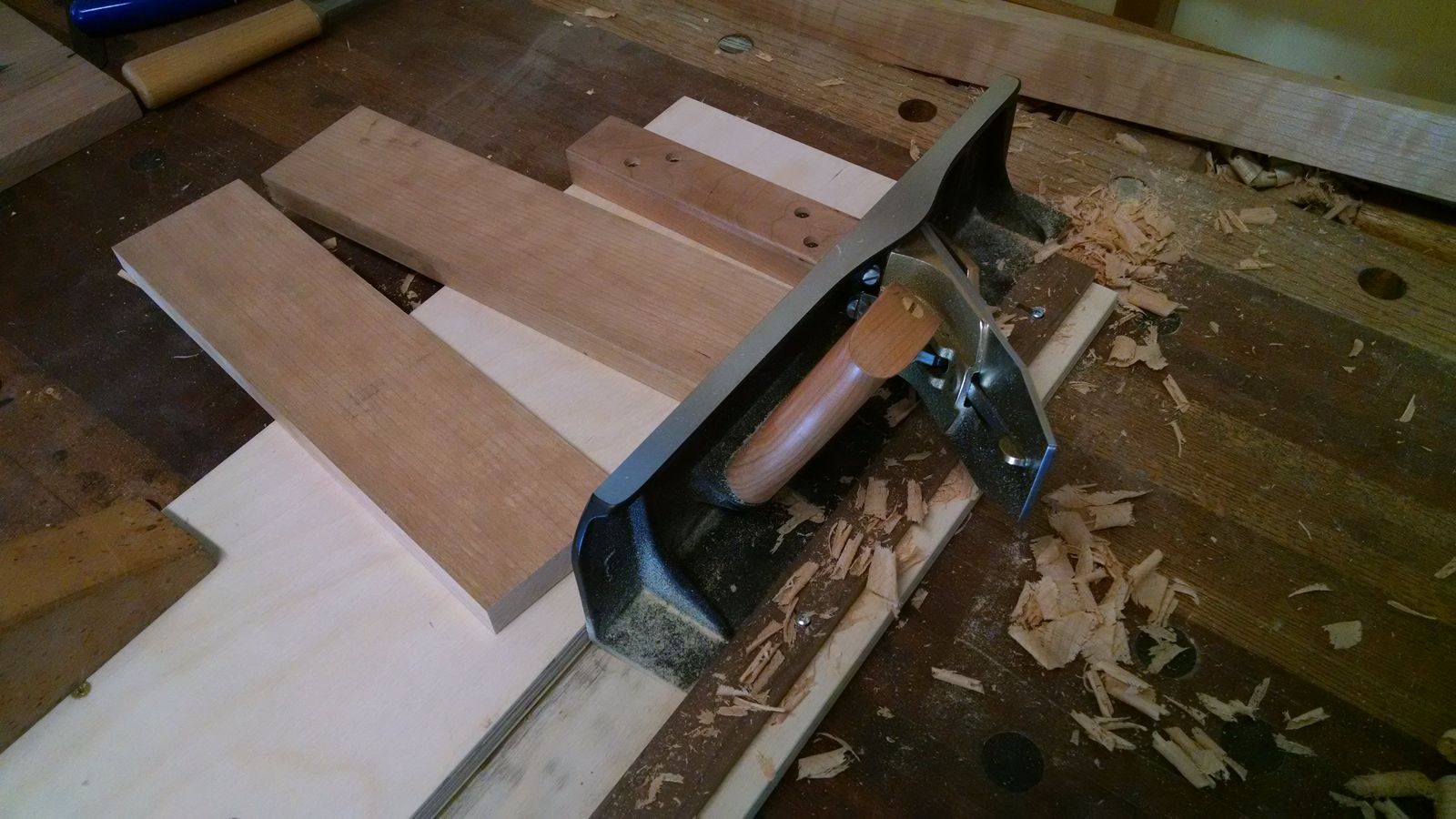

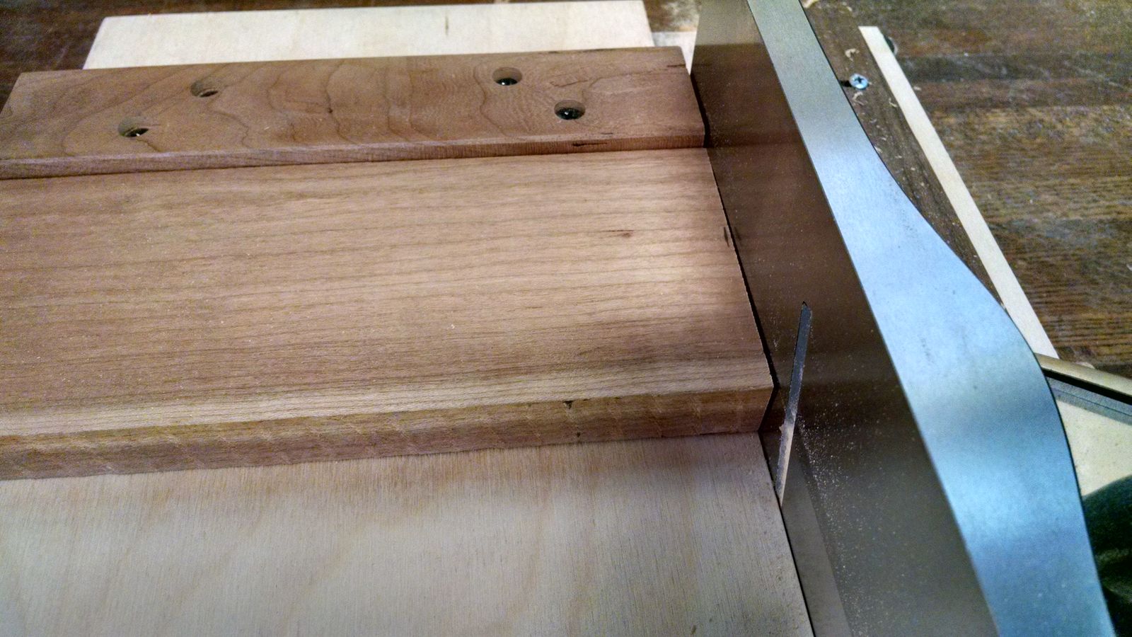

So starting with the horizontal dividers for the drawer and the top mount strip, I cut a board to length, fascinating the ends were not square, even though I cut them with my SCMS, so needless to say, my saw needs adjustment. It's been a long time since I built flat work, I've been involved with my chair(s) and things just don't need to be square, so sizing material without checking for square has been my forte lately, and as a consequence things in my shop have gotten out of square, I just don't worry about square anymore, my work has really taken a lax philosophy lately, since I am really getting into work that is not flat.
So I have two boards that I'll rip the dividers from, but before I rip them I am going to square the ends. Lucky me I have my wonderful plane and shooting board just for this purpose! I finally get to put it to work.
You can see how out of square the board end is, see the gap at the sole of the plane.
A few quick passes and I have square ends on my boards. Not shown, I guess I didn't get that shot, but I do have my boards squared up.

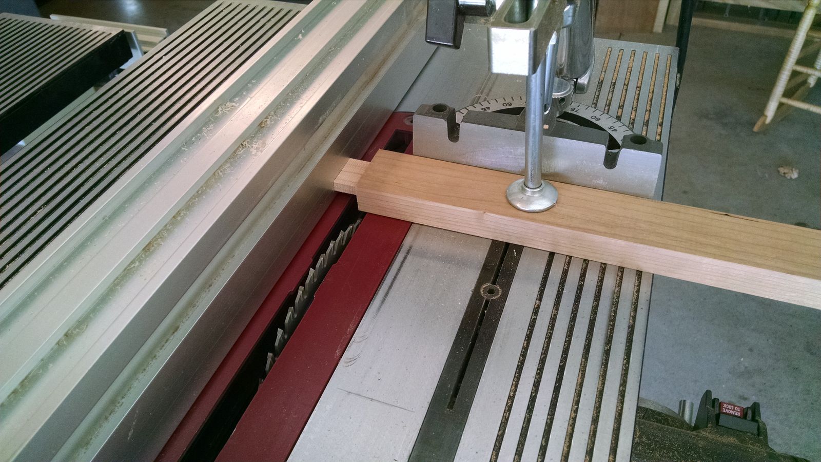

I am cutting my tenons on my table saw, just a few passes, since I don't have a dado set, I just make a few kerf width passes and the tenons are cut. I am working under the gun here, I need to get this done, otherwise I would have spent some time cutting the tenons by hand, but I need to get this desk done.

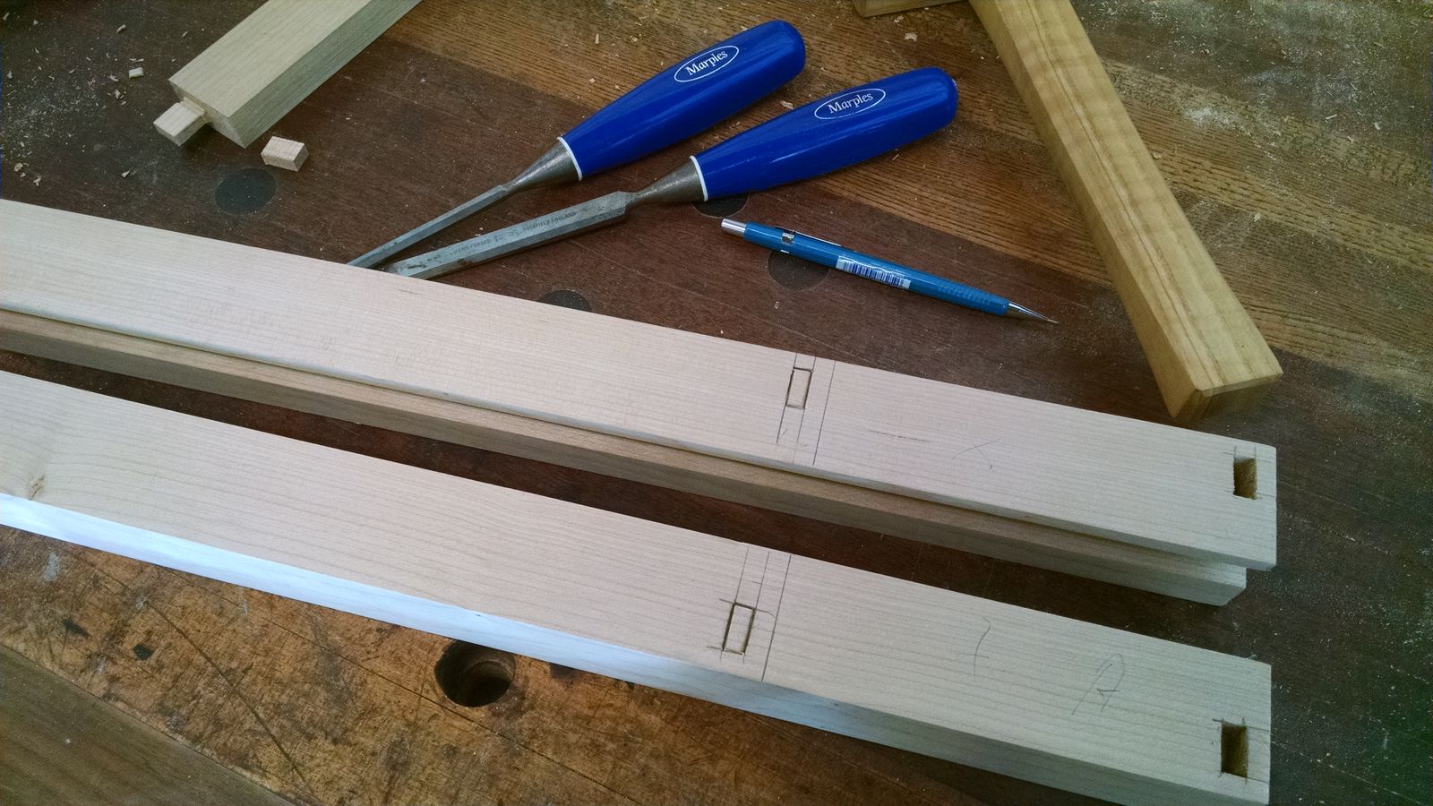

I laid out the mortises in the desk legs. Then just set my chisel into the layout lines so when I drill out the mortises, they won't splinter or flake beyond the layout.
Drilled the 1/4" holes to hog out most of the mortise.
Then I followed up clearing out the waste by hand with my chisel. So, here is where we are at right now, we almost have a desk cabinet to hold one drawer, and the lower compartment will hold the computer tower.

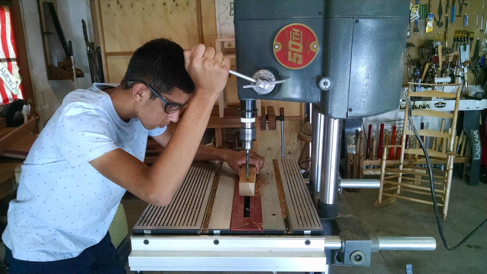

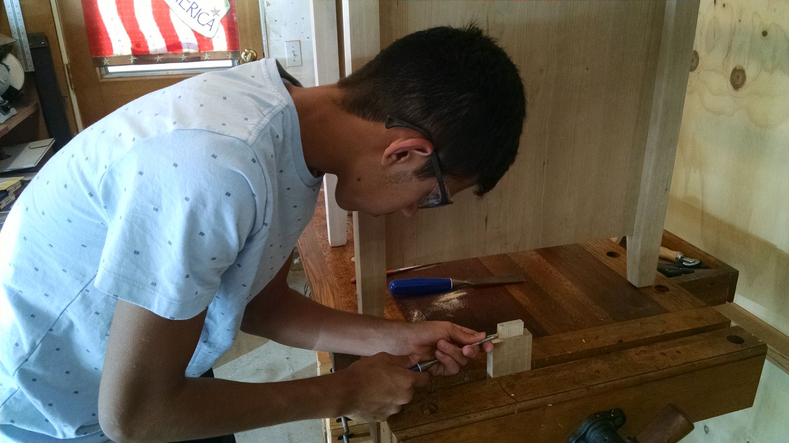

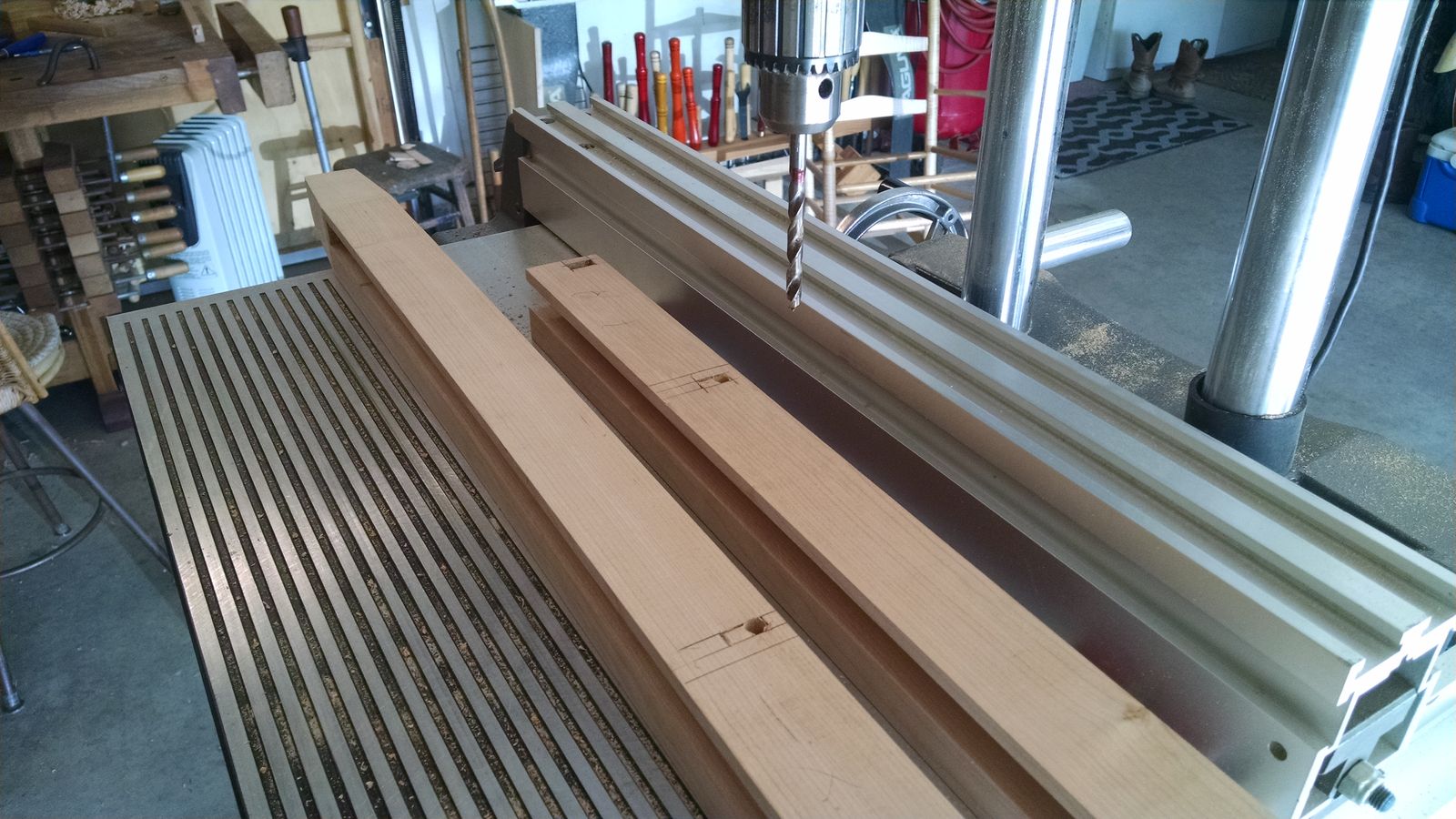

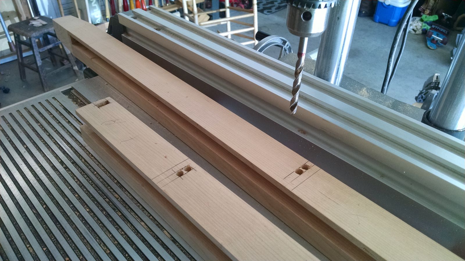

Today I felt pretty good, and I grabbed my son and we headed out to the ol garage and fired up the project again, we built the outside legs of the desk, I taught my son how to use the Shopsmith DP mode and he bored out the holes for the mortises in the legs. He then cleaned up the mortises with a 3/4" Marples and a 1/4" Marples, he learned today how to pare down the sides of the mortises to clean them up, and to fine tune the tenons for that perfect fit.
Below, he marked out the mortises, then took a 3/8" brad point bit and bored some starter holes.
I thought I took a pic of him cleaning up the mortises after the Drill Press operation but I guess I flaked. I was just enjoying and watching him work I guess. My style is to teach him the basics, get him started, and then often I'll just walk back in the house and let him go at it on his own, then a half hour later I'll walk back out and see how he goes, and I am usually quite surprised by how well he did all on his own. I feel that executing these steps on his own, builds confidence.
