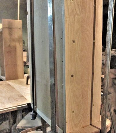

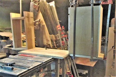

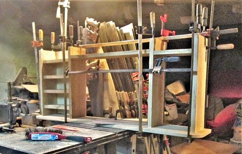

4 clamps to hold the cubby assembly, clamped the top of the Hutch to the top of the tablesaw, was a bit tippy, otherwise :rolleyes:
Toys were needed..

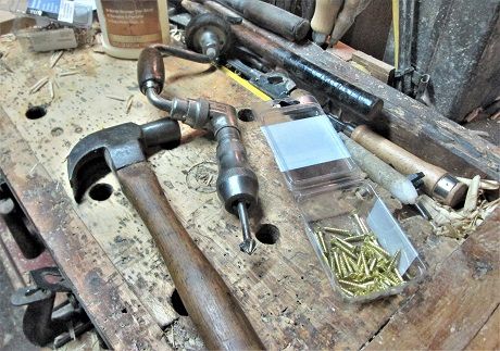

Added a few screws to each glue joint ( only snapped one screw :rolleyes:) drill for the pilot holes, another to drive the screws home after the countersink drill..:ChinScratch:
And sanded things smooth( and remove any markings :ph34r:)

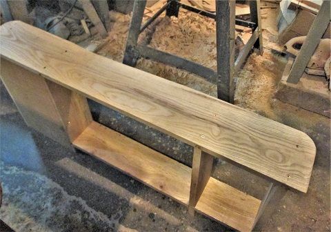

Fun part was to rotate this mess around, and glue the rest of the parts in place.   i didn't like the "show edge" of the Monitor shelf, flipped that over...spread some glue, and add a forest of clamps...B)
Will let this sit a day ( and me too..:OldManSmiley:), and then sand and stain?  :Tapping:

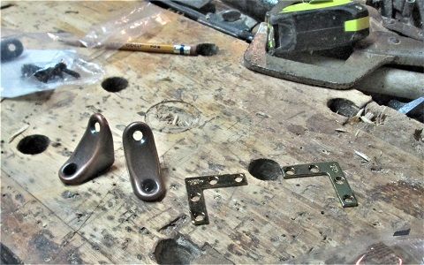

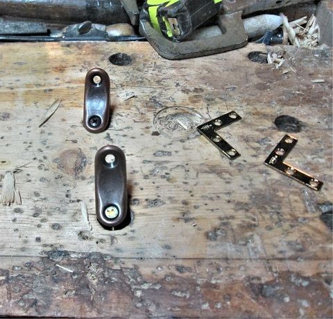

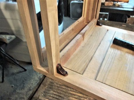

Now, gene has been hollering about the brackets I will be using to attach this hutch to the desk...bought  them this morning, along with those brass screws..:TwoThumbsUp:
Soooo....:SaluteandRun::SaluteandRun::SaluteandRun:

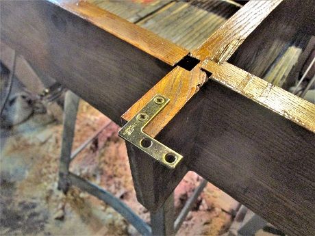

The Brass "L" shaped ones go around back, one per upright...IF the other brackets look familiar?:WonderScratch:
881625141_computerdeskassemblyassemblystarted.JPG.4e7cb3c2b25cf2d84badbd2253529c27.JPG
I used another set to connect the desk parts together....new ones come with their own screws..B)
Them black, round tops.....or, I could just use brass screws....:ChinScratch:

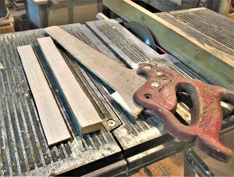

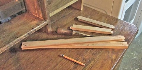

Ran enough for a pair of stiles and a pair of rails.   Then  ran a groove in all four  parts, and tenons on the rails..:TwoThumbsUp:
Used these to mark out what size plywood to cut....out of that fancy grained plywood....then a dry fit..:JawDrop:
Parts need cleaned up, glued up, sanded and stained...then some hardware.  Will use a paper shim under the door, when installing the brass hinges..B)

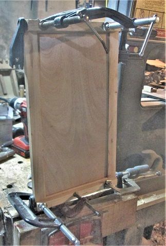

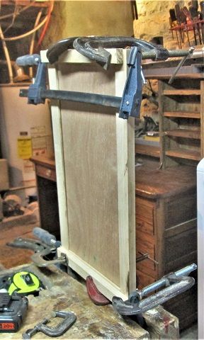

Door is now sitting in the clamps. B) Cleaned the show side of the frame with the #11  Junior jack plane..spread some glue, added some cauls..:Cheer:
View of the inside of the door, I used pairs of cauls, to clamp the ends flat. B) Vise is holding a second HF clamp, as a third hand...the outside?
Trying to decide which way is "up".:WonderScratch:..according to the grain in the panel.   Will let this sit overnight...then clean it up, test fit the results and maybe a coat of stain?:ChinScratch:

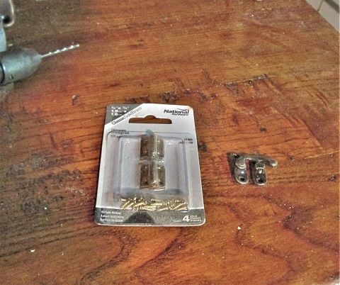

Dug up some hardware, too.:ChinScratch:
Will surface mount the hinges...latch is to keep the door shut...never know WHAT you might find behind that door...:BugEyeSmiley::CoveringEyes::DevilLaughing:

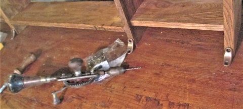

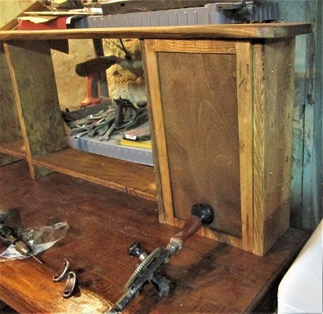

there is and issue...about one of the brackets for the front of the hutch...:BangingHead:
1299793920_ComputerDeskHutchfrontbracketsanddrill.JPG.13f05552347a2823cc6fa98656e4d016.JPG
That one on the right...won't allow the door to open all the way, will move it to just around the corner....like the pilot hole drill?:ChinScratch:

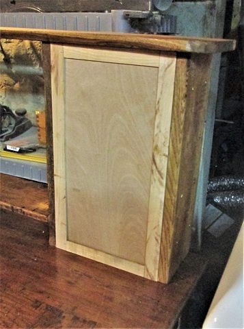

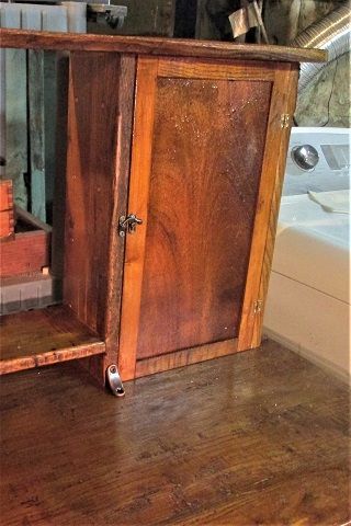

Door has been cleaned up, and stained...before I had the knee rehab, today..:SaluteandRun:
Rested up a while after rehab...then...:ph34r:
1527572081_ComputerDeskHutchdoorlatchandhinges.JPG.da03f684d307c2c974ad9b831fd45647.JPG

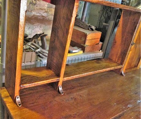

Shellac, varnish...hinges, and latch...all the brackets are installed, once the shellac dried..:JawDrop:
980233975_ComputerDeskHutchbackbracketinstalled.JPG.acde28e1557d03d8becced00a2d9e652.JPG
Other 2 screws go into the back of the desk's top...:ChinScratch:
1943267080_ComputerDeskHutchfrontbracketsdone.JPG.9e418d281fe4fd5faa2a8f9788caf211.JPG
Front brackets are in place...#4 is around the corner from the door.  :WonderScratch:

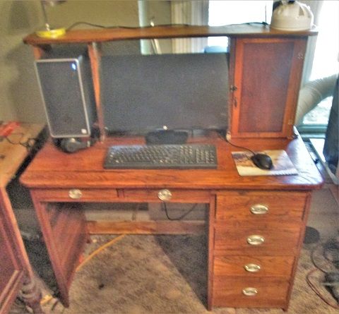

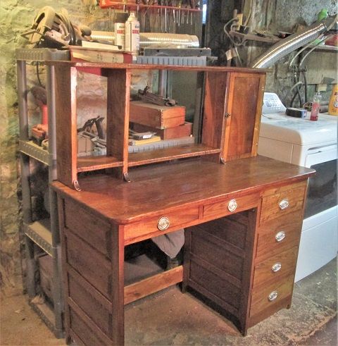

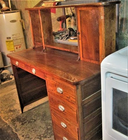

Desk is ready to move upstairs. :TwoThumbsUp:  had to shim under the door, was dragging halfway to fully opened. :ArguingSmileys:
Need to schedule a time when enough young bodies are around to move things around....I can move the drawers and the hutch...desk will take two people..and I am not one of them.:rolleyes:  Biggest thing will be moving the computer out of it's old home, and into the new one....:OldManSmiley:
Now have a new LED desk light...old one died.  And, it is very BRIGHT...need sunglasses to sit at the computer :JawDrop:
thanks for following along :cowboy:
This PIP is NOT over until we see a picture of you, at the desk, computer installed, and finally wearing sunglasses!:ChinScratch:
drat, NOW I have to go and BUY a pair of sunglasses..:BugEyeSmiley:

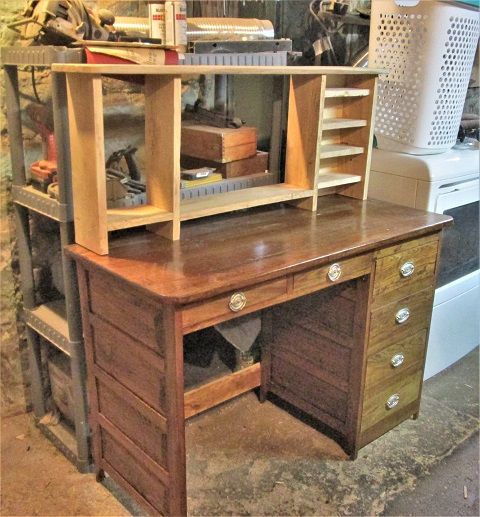

Disn't buy any "shades" was too busy running errands....cleaned out the old desk..:ph34r:

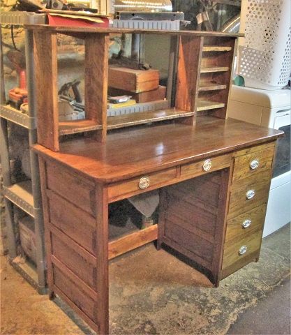

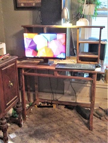

Pulled the 4 skinny drawers out, let the Boss sift through them.:rolleyes:..as I brought up the new drawers, and the Hutch....Grandson #3 helped me move the desk up the stairs, and close to it's new home....assembled the pieces, had fun trying to place the computer where it needed to go...:ArguingSmileys:.was unable to sit the monitor on it's shelf..by 3/4" ...:ArguingSmileys:
sat in the computer chair to give things a "test drive"
Might just work..:cowboy:
new hat, too :TwoThumbsUp:Thanks for following along...
