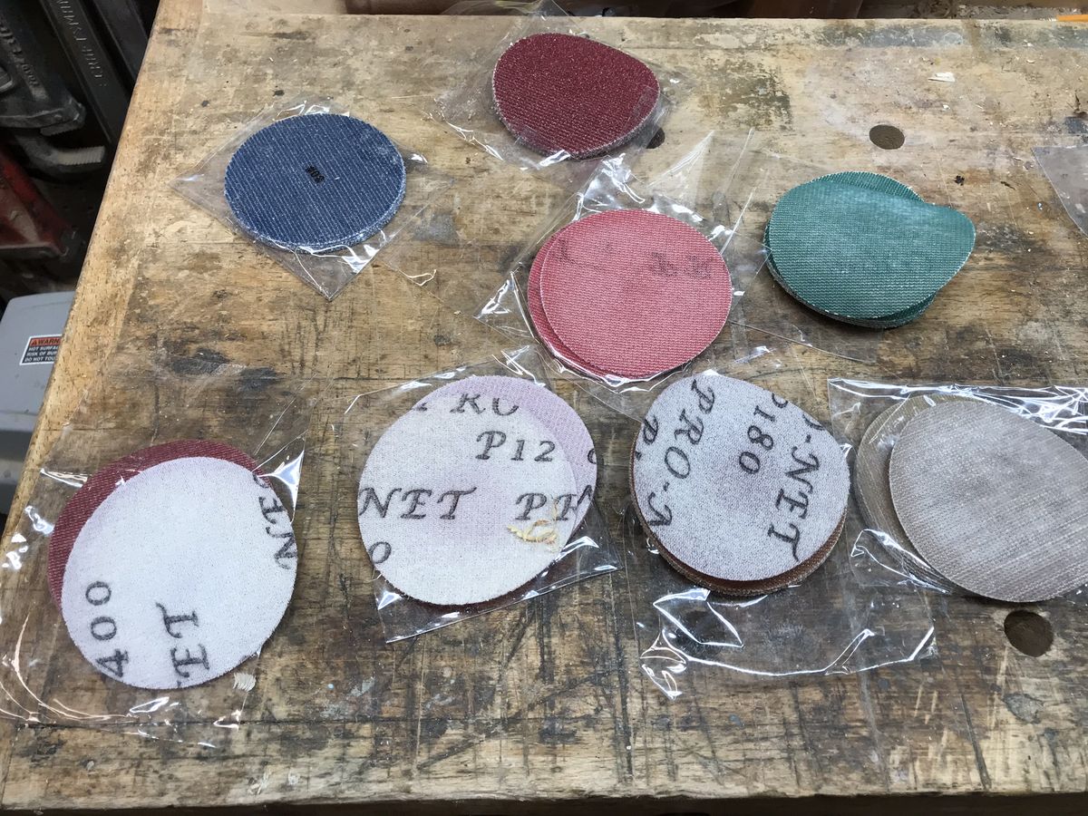

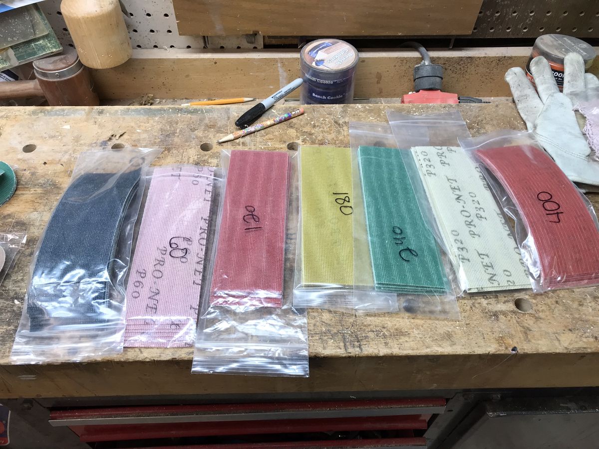

About a month ago, I purchased a variety of Wonder Weave from Woodturners Wonders. I wanted to compare these sanding sheets to the Abranet sheets I had been using. The sheets I purchased ranged from 60 grit to 400 grit. I also purchased a sample pack of 3" discs.
I have had an opportunity to use these products and I am very pleased with the results.
First, as you can see from the above images, these items have different colors for each grit and the backs are in light colored velcro. Both of these characteristic makes identification quick and easy. The Abranet products are almost all the same color and the backs are very dark making the printed grit identifiers very hard to read.
Another thing I like about these products is that they are a little more flexible than the Abranet- especially the courser grits. This allows easier sanding of finer details on a turning. I think the flexibility comes from a different construction technique. The Abranet substrate looks similar to expanded metal screen then the abrasive is attached to the substrate-
However the Wonder Weave substrate is more like long filaments with the abrasive attached-
The Wonder Weave, like Abranet, doesn't load up like sandpaper and is easily cleaned with just a few taps to shake loose the dust. The Wonder Weave lasts as long, or longer, as the Abranet with the sanding I have done.
I was buying Abranet from a sanding supplier near here. Their price is $8 - $9 for 10 sheets. The Wonder Weave is $4 for 8 sheets from Woodturners Wonders- a nice savings!

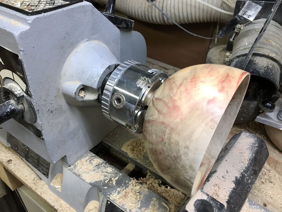

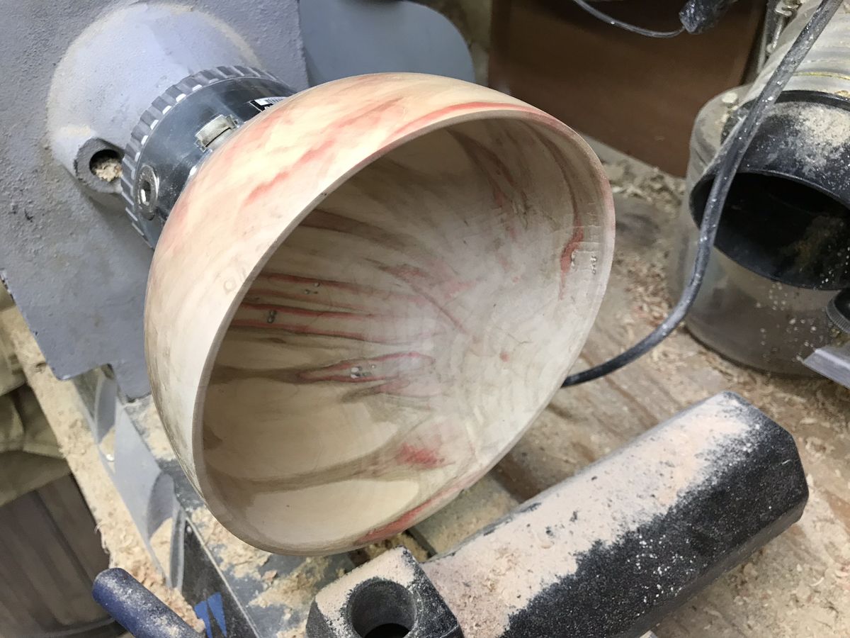

Here's the bowl I've been using as a testing vehicle. The outside sanded to 600 grit. Each sanding consisted of sheet sanding with a grit then the same grit of sanding disc using an inertia sander. For the last pass, I went from 400 grit sheet/disc to 600 grit disc.
The inside of the bowl has only been sanded with 60 grit at this point.

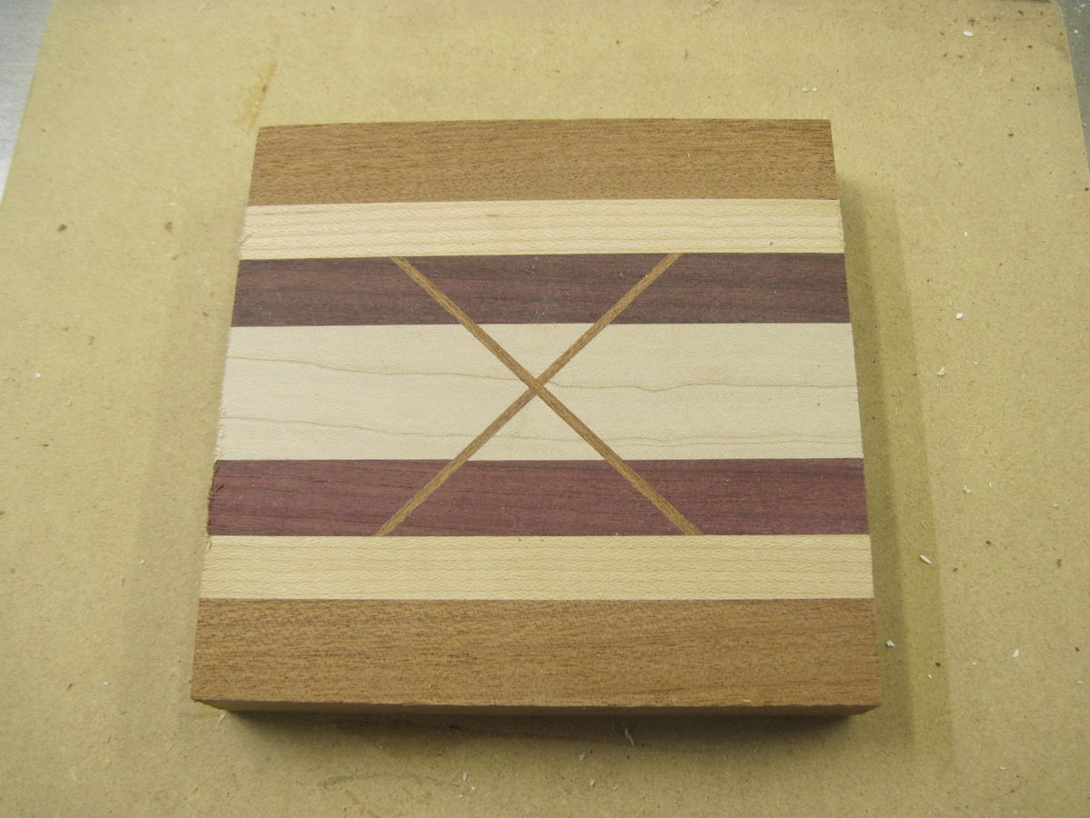

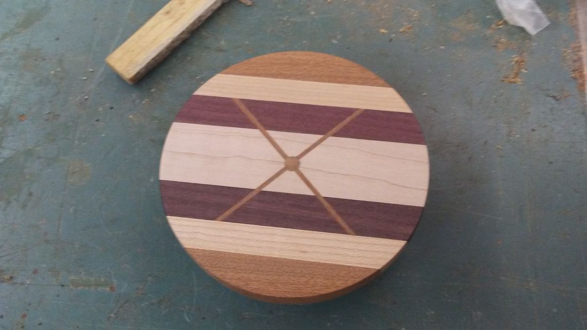

Made this today. Cherry.

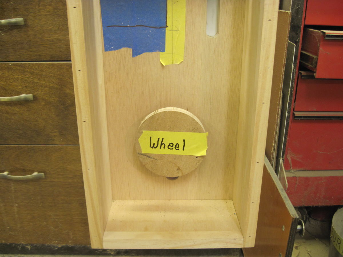

Got the blank glued up and squared to correct dimensions for the crank wheel.  No time to get on the lathe tonight.  Still working on the lock mechanism for the door.  May have finally got somewhere.

That's gonna make a fantastic handwheel!
Came out pretty good.
