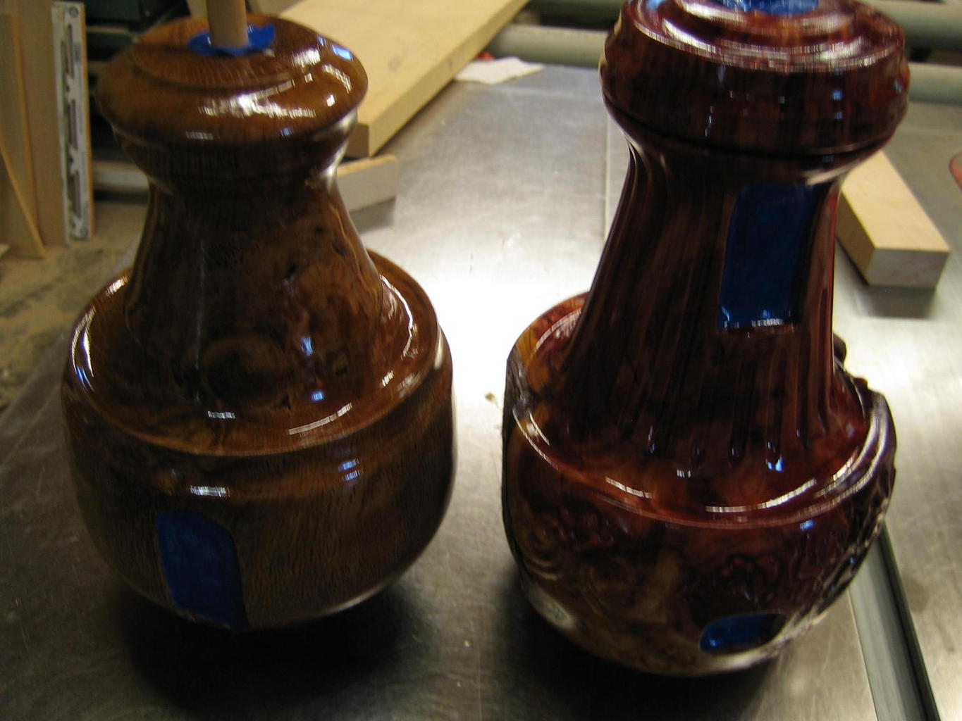

Two woods grown here by my wife, Chinese privet, variegated and I thought I was saving some walnut but it turned out to be oak I had stacked there.  IMG_0241.JPG.eb68df54c06411c0378dd6ebf3744a65.JPGIMG_0240.JPG.743ebcad167c90b0dce36f034d24d9eb.JPGIMG_0243.JPG.c60368c2be3c8b3567e79ff8b712298c.JPG
The easiest way to get the log ready for the lathe is first put the log in the Legacy Mill to knock off the bark and kinda get it round then go to the lathe...
   I had to stop and glue up some cracks  was the reason I am doing two at once, let the glue dry on one while I play with the other....
and again, this is what I am shooting for. Don't matter if it will end up close or not, just doing one with some carving and maybe a name?

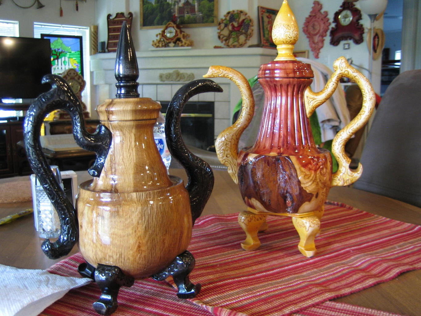

    I finally brought these things in to the house so I guess that means the only thing left is to give them a good shinning with the Johnson's paste wax and some 0000 steel wool. But better do that out o

   I think I have made myself clear as to how I feel about working with oak.......cracks, cracks, cracks. And for sure I have had to stop and fill some as I started turning this one. It was opening up right before my eyes...

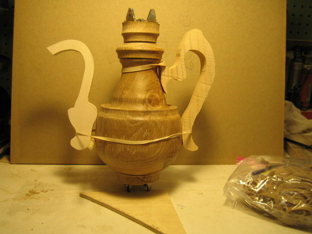

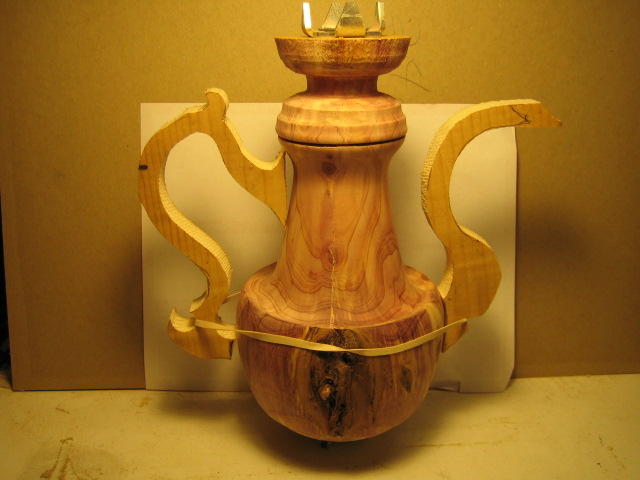

Found the rubber bands, I mean't to say mom found em..
   Just trying to get something that should tell me one way or the other. Too tall, too short, sticks out too far, too skinny, too fat. So I start with pine trying to understand what they need.... IMG_0263.JPG.bff35daca2768541e800ccbe074a84cb.JPGIMG_0265.JPG.e448acede5439611b5cb962ba62d2f44.JPG
 I don't even worry about the legs until I get the upper half under control.
    I leave the attachments on both ends for I still might alter the shapes of one or both!
These kind of ends will let me take them in and out of the lathe and still be centered.
    I don't have any more of this Chinese privet so I will disguise some wood.
Keep the story & pictures coming Patch...
That Chinese Privet has some very interesting and beautiful grain...can't wait to see that one finished.

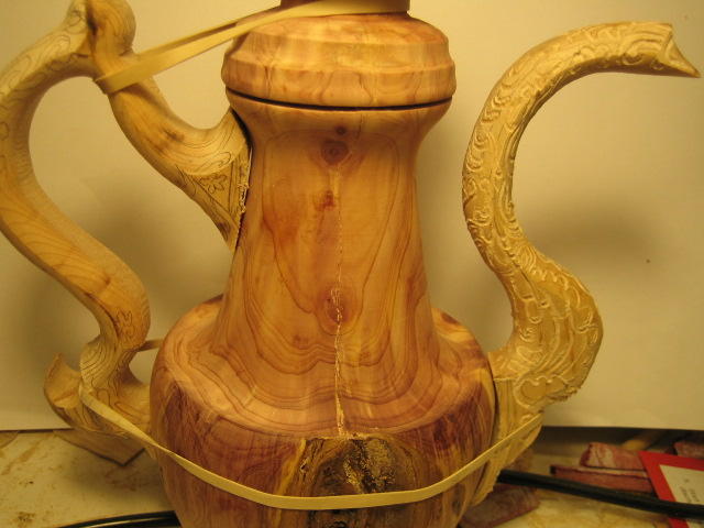

This is what I did today. I first cut the handle and spout out of maple and since no one ever looks at carving, usually just a glance, I carved the spout today and still have the lines on the handle waiting to see if I accept what I did to the spout.... which when finished will be somewhat deeper grooves but hey, still in the learning mode.IMG_0290.JPG.a0b9473a2c768c640fdc06b0f4d57b47.JPG
 I think I will leave the big knots, one on each side of the pot bottom just to let people see what a person starts with.  They cave in almost 1/2" deeper than the rest of the shape.
   The maple will probably be stained a dark something since I don't ever spend that extra money for the exotic stuff which 99 % of all the people could never identify the species anyway...

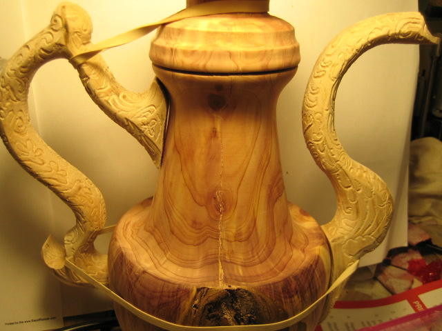

This real small carving type I have never done before and it is hard for me to see how someone starts the process.
  It seems like most of the bits I have are of the medium size and it seems to take some very small tools for this. So we will see how easy it is to screw up... I am finding flawed work in curves is easier to cover up.
I got this much done since lunch.IMG_0297.JPG.c3bfb0936cee4e3716c204d4b64aa03d.JPG

Ya' know Patch, I've been thinking about how one might finish the handle and spout on this one since you've done all the intricate carving.
Have you ever used gold, silver or copper leaf? Being honest, I've done only one small project ever so no authority or expert.
I have seen it done on some WW'ing shows...IMHO, one or combination of all would really look great on this particular T-pot and enhance the spout and handle much like a real tea-pot
I think you can buy the supplies at most Hobby Lobby &/or Michael's stores...
Might be a technique for @Ron Altier to consider for some of his ornaments too...
Anyway, something to consider but don't mind me, I've been whacked in the head a few times. :P
Dave I have and on carving as small as I am doing its very hard to press it down in the small grooves. It doesn't stretch at all and is real easy to tear and come apart. Yes Hobby Lobby was where I have bought some in the past... The first I bought was at Albert Constantine and was called Gilding supplies, I think.
Gerald, that is what I use to trim some of my doings back when I thought I needed to add that wow feature. Way easier than the gelding gold leaf and easy to apply with the finger...I think I have maybe five different color tones of it from Hobby L. My name for it is cold cream....
