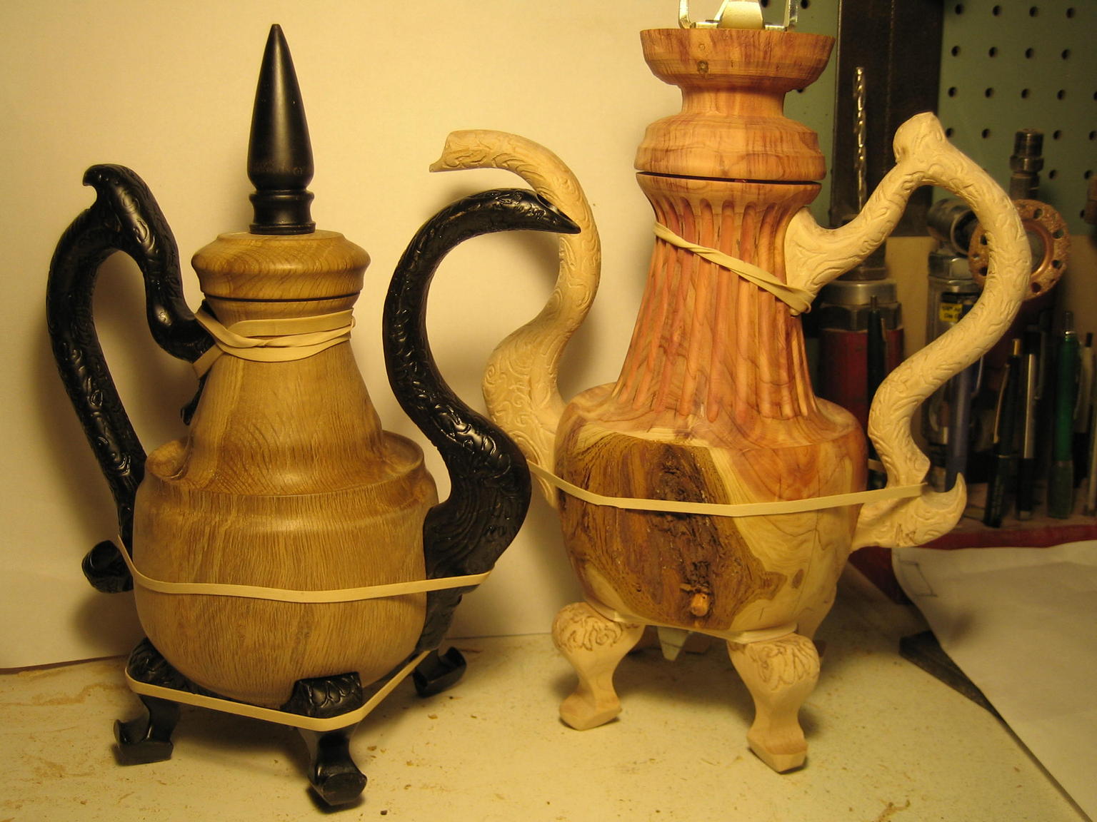

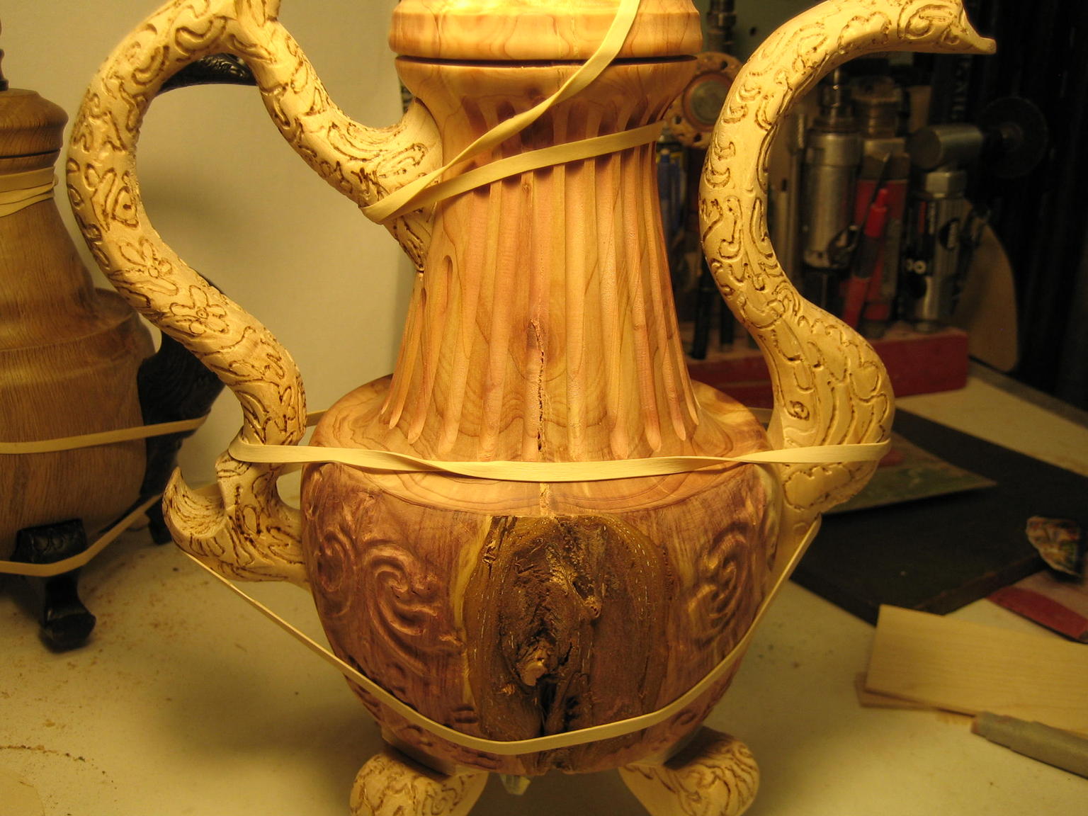

    Found the rubber bands, I mean't to say mom found em..     Just trying to get something that should tell me one way or the other. Too tall, too short, sticks out too far, too skinny, too fat. So

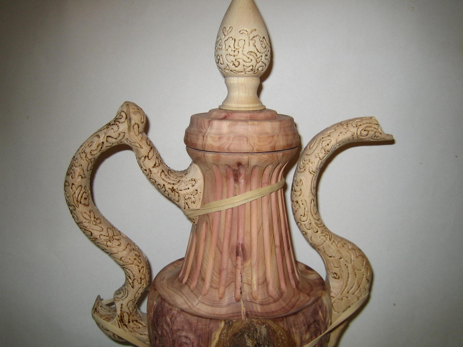

Added a little carving.IMG_0632.thumb.JPG.a7fa705b518d3c6cd93d740ddd673325.JPG
Jesse, you are one patient and talented guy. They both look fantastic.

Thanks guys. I'm seeing a small crack down the middle from top to bottom so before I glue the spout and handle on I will use that area to drill some long dowel holes crisscrossing through the crack.

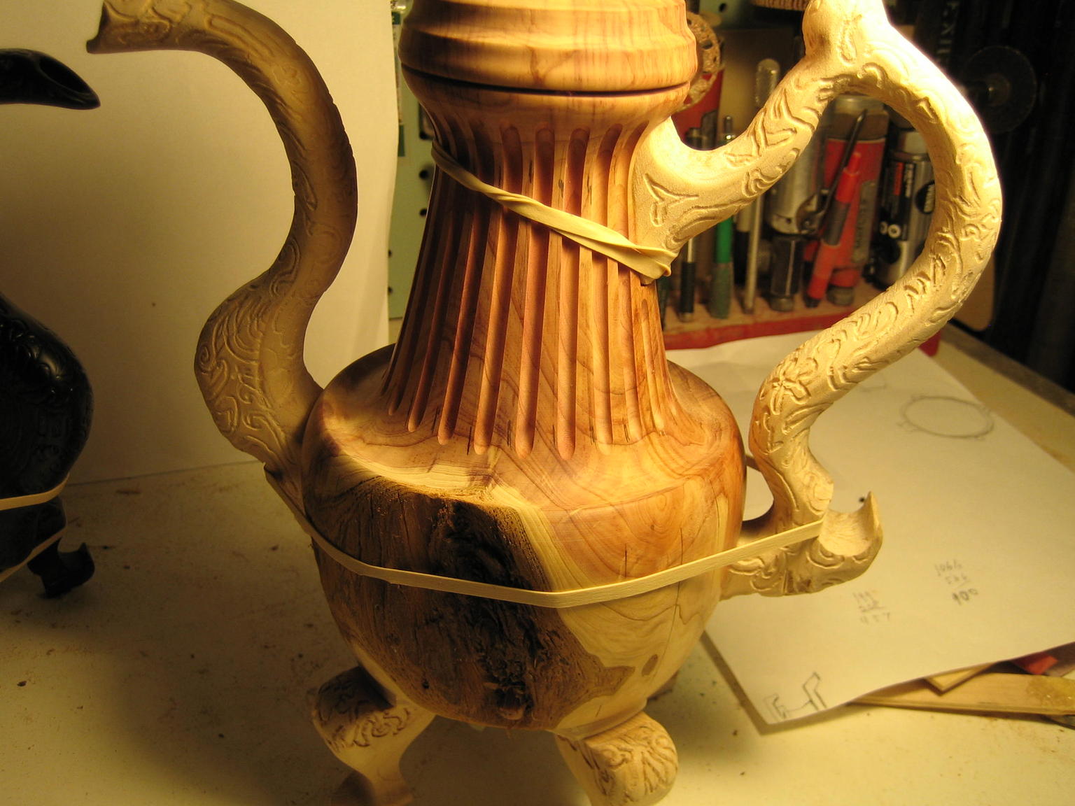

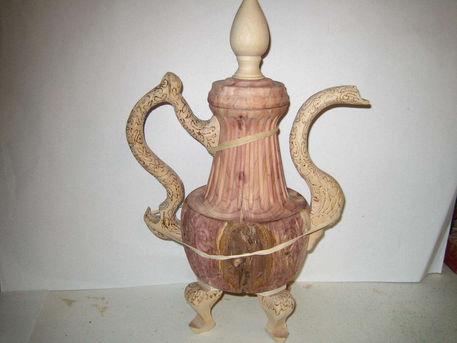

  Final got the last piece to the puzzle made today and now ready to smear on some stuff. Maybe a little too tall but hey.
  I finally took off the brackets that holds it in the lathe so I guess I'm through except for the finish.IMG_0646.thumb.JPG.f8be525885a944805bbbb4d17aee3947.JPG

  Not a lot to show how I pinned the cracks in the tea pot.. I took advantage of the areas I hollowed out for the spout and handle and drilled angling holes as deep as the 3/8" drill bit was long. All the holes got past the middle where the crack is. I did use the next size drill up from the 3/8 cause that deep of hole and a tight fitting dowel with glue all over it would have to be hammered in and for sure I didn't want to push the crack wider was the reason for the next size hole and with glue on both surfaces I worked the dowel back and forth pushing in as I went..If you get the right amount of glue when the dowel bottoms a small amount of glue will be pushed out at the top at the same time as the dowel hits bottom...This learning is lots of years in a shop. Anyone with lots of woodworking knowledge had to have lots of years in the shop..for a person does not  do the same kind of work every day. The next time I might have to do the dowel thing might years down the road. IMG_0656.thumb.JPG.bb1aa6b05359bbb118bf9ee36222bb1f.JPG

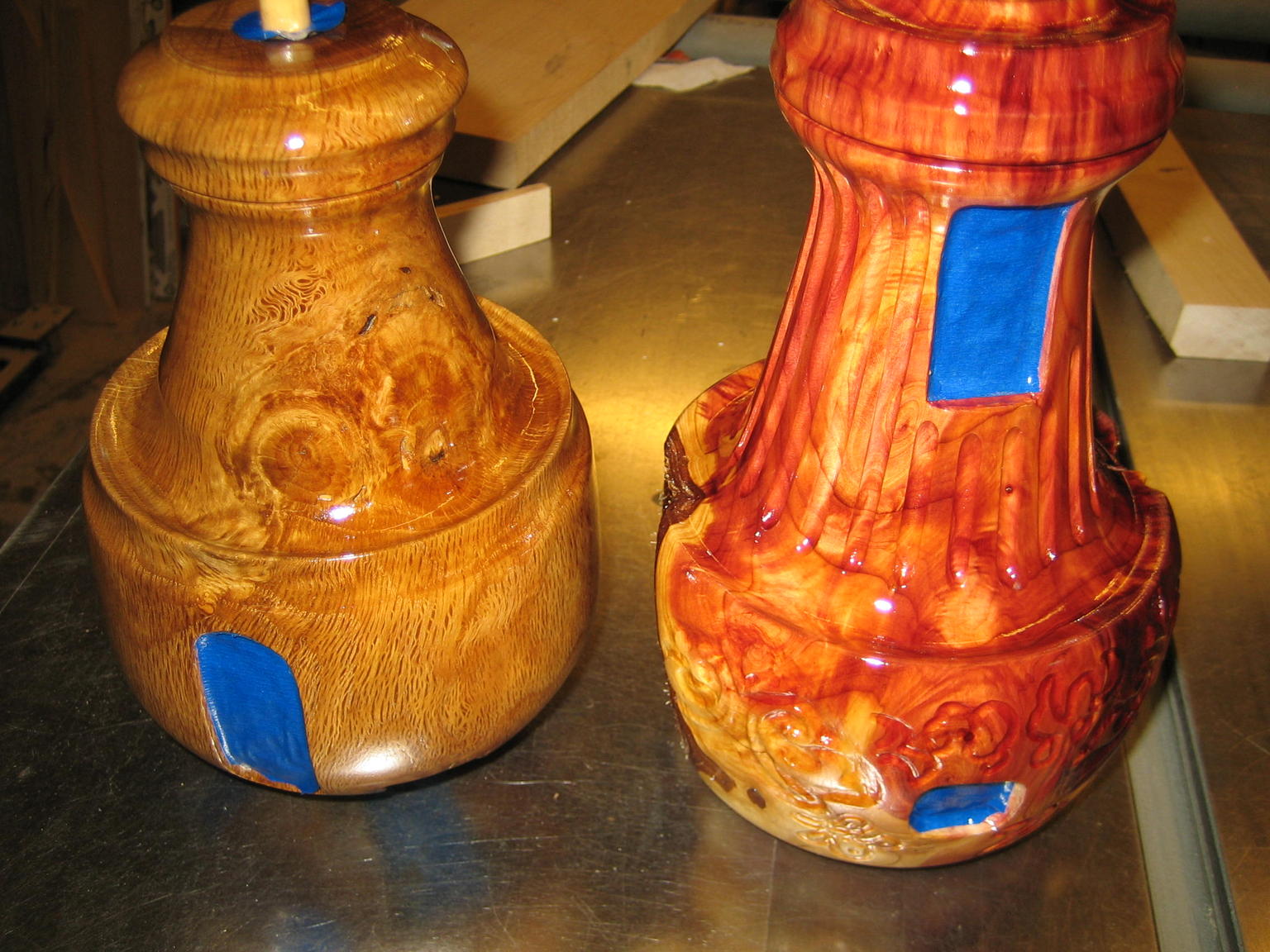

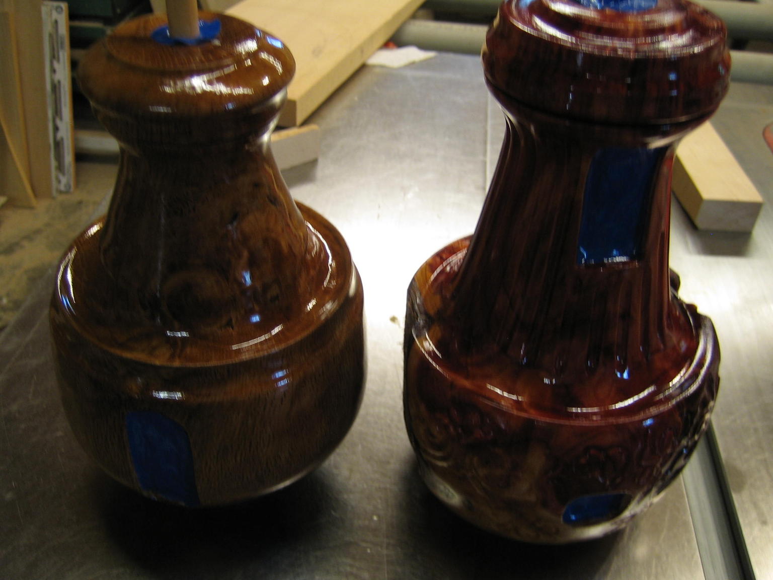

Finally a finish to get er finished.
I did this about a couple hours ago but when I tried to post it , the last post I typed and posted kept coming back up and I posted it again and not this one of the finish to get er finished..So I'll try again. IMG_0678.thumb.JPG.cffe9fb552fe99f1e4003cdeec503aef.JPGIMG_0676.thumb.JPG.5eb119166e40f83303d7ee02bc86244d.JPG
  I also decided the one on the right is from a plum tree that started dying and the one on the left is some variety of oak for there are 7 or 8 different oaks with different leaves on this property and only the live oak , the bur oak and red oak and pin oak is about all I know for sure. I started to add the pinyon but then as I was telling about the only pine tree with edible nuts I thought well duh, it ain't ever a oak tree.
  No extra stain or color was added to either wood, just 100% tung oil before the clear lacquer after a few days for the tung oil to dry before the lacquer.

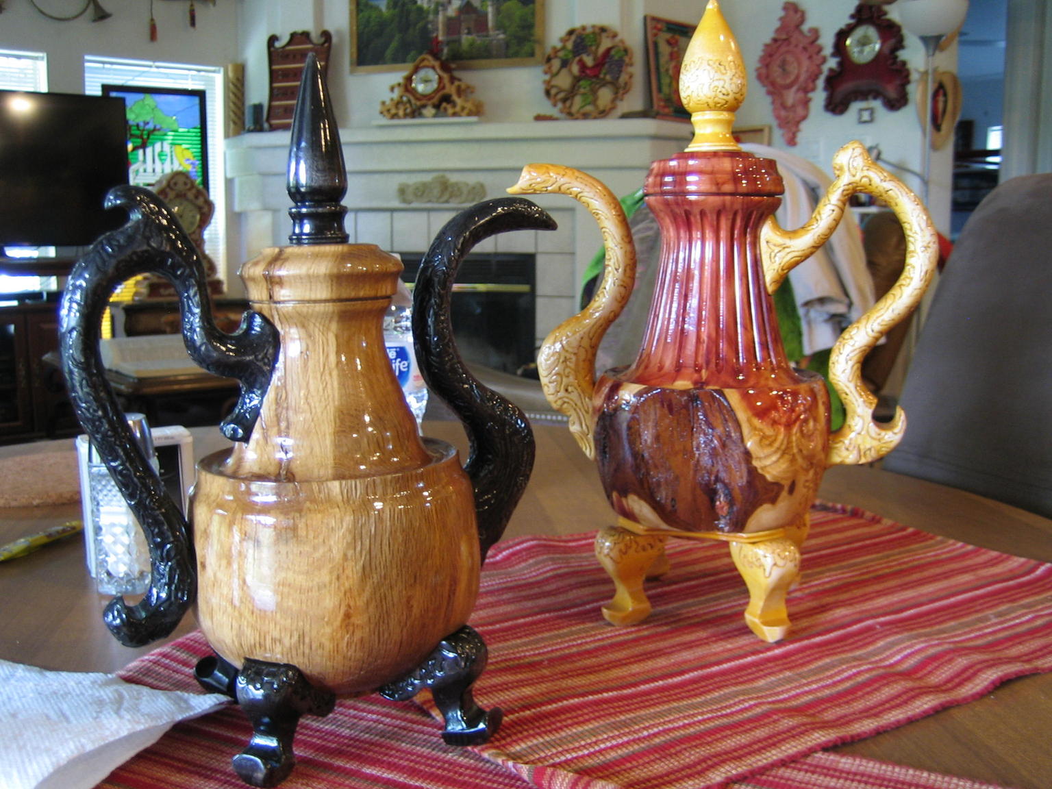

I finally brought these things in to the house so I guess that means the only thing left is to give them a good shinning with the Johnson's paste wax and some 0000 steel wool. But better do that out on the deck for maw might throw a shoe if she caught me..IMG_0744.thumb.JPG.0962b114e3a3e54c06dc8e072240a1ec.JPG
 As I was taking the black handle pot in after the last coat of lacquer I tipped it over and caught it before it hit the ground and do have some marks to smooth over and thats the side with the best looking wood grain..I have up to 10 coats of lacquer on these. Usually about 3 or 4 coats each day and most of the re-coating was done about every 30 minutes. I then let it sit over night then start spraying again the next day. Sometimes using 0000 steel wool each morning before I start spraying depending on how hard the wind was blowing. Summer time I always do my spraying outside. I keep the piece so I can highlight the spray as it is being applied. On large items I use an extension cord with a reflector and light bulb to make sure I don't get any runs...
  Kinda tall for tea pots at 12 and 14" but hey I already have some small ones!!
I now think both tea pots would have looked better with the handles switched but that was after I cut the slots and did all the finishing so it was too late. The black on the red was to me much better.. Now if I can just remember for the next time!IMG_0744.thumb.JPG.0962b114e3a3e54c06dc8e072240a1ec.JPG
