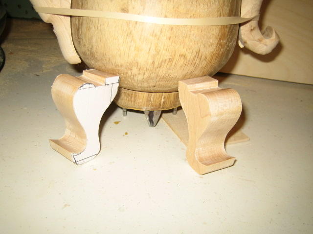

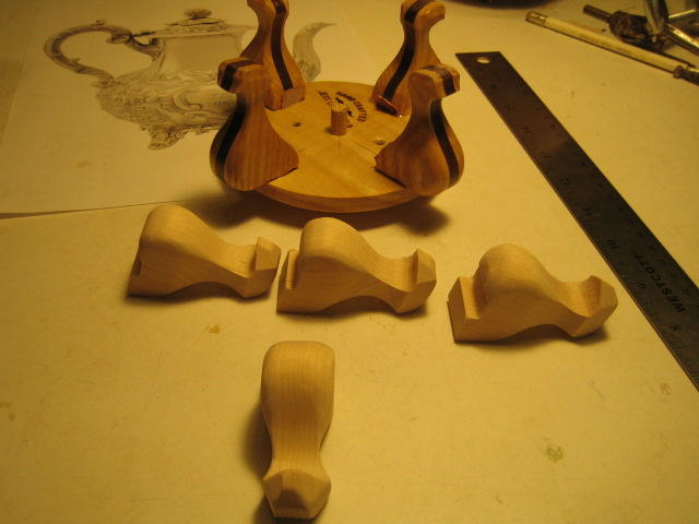

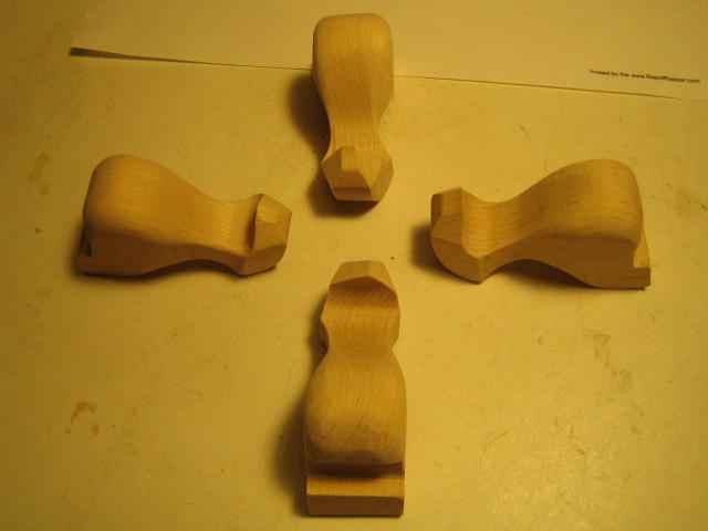

Well yesterday I started on the legs for one of the pots..IMG_0304.JPG.dc0907137b7aede3e3f8b334c97ff1cf.JPG
Making all four of these things from a pattern for just the profile ain't too bad but then setting up to cut more angles and then rounding some of the areas brings more problems.. Jigs for small items brings ones fingers in about the same area of the blades of each machine so real thick gloves and my skinny vise grips I prefer to donate some of first before the skin ....
  You can see by the points of the feet, getting the starting point of each cut is not cut and dried kinda...

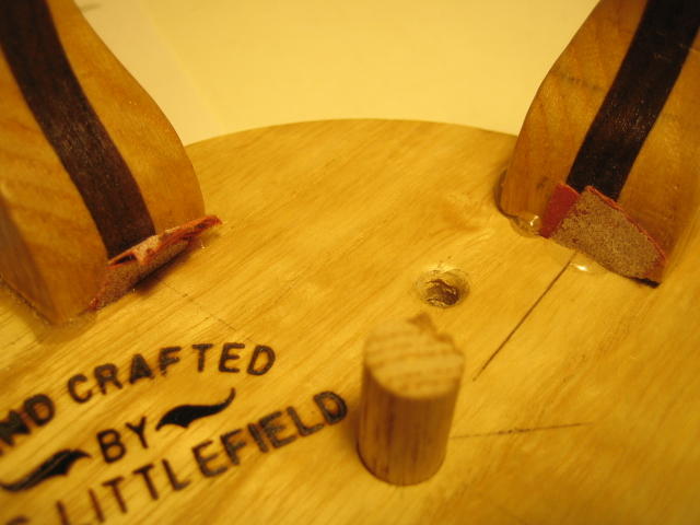

I do intend on carving  these feet before they get installed and thinking ahead, not a clue yet on the best and easiest way to get them installed to the base of the pot..... And thinking back to when I made this set of legs seemed easier than I had anticipated. Just getting them epoxied in and setting level was a chore.... Yesterday I was looking it over and there were pieces of folded up sandpaper under a couple of the legs I had epoxied in to make them level....Sometimes a person just uses what is there available at the time... I'm guessing I might have  IMG_0312.JPG.595846a33b8f8c530404f944c124c6e6.JPG
cut off the excess sand paper before the customer got them  but this went to wife's dressing table.
And like I mentioned before, the bottom of beverage cans is the perfect size for small amounts of epoxy that I seem to use a lot of  and especially when having to sit five minutes holding something in place while the epoxy sits up. Here again the scroll saw was the tool of choice in making the first shapes.

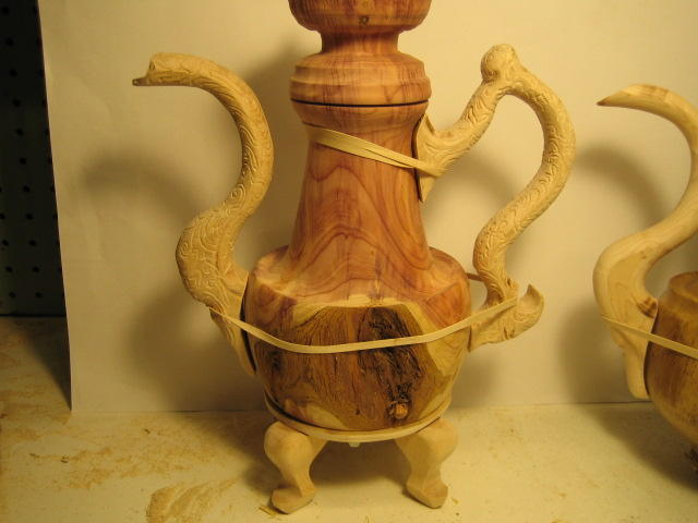

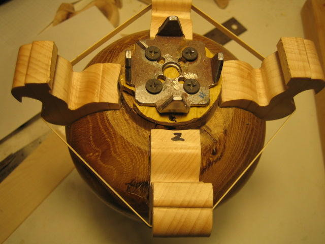

    Found the rubber bands, I mean't to say mom found em..     Just trying to get something that should tell me one way or the other. Too tall, too short, sticks out too far, too skinny, too fat. So

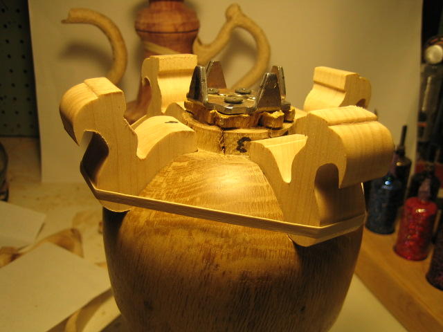

I've been fixin places for the four legs.  Maybe the hardest part of building a tea pot, securing the legs where they look like they were built for that area.. Better looking lines.IMG_0332.JPG.b5b3c70f9da314066218e76133a5c623.JPGIMG_0328.JPG.dbaf3b14a3a4dd8cf25de3b8291ea6b1.JPGIMG_0327.JPG.93fc401d2842795cdf3832f912f24c56.JPG
After the legs are carved and finished I'll epoxy them in. Then drill through the legs in to the body a ways for some dowels......for extra strength ???
  Time it takes for me to build one tea pot.....about the same amount of time for a 4 piece bedroom suite. But the bedroom set would already have some kind of plans where I just wing it on a tea pot.  I make one piece at a time then try to figure out how it will attach to the rest and try to make it look like all goes together.Like on all the tea pots I have made, no two are the same size just so I will have to start from from scratch and resize all over again....A person first has to satisfy ones self, after that, just cross your fingers.

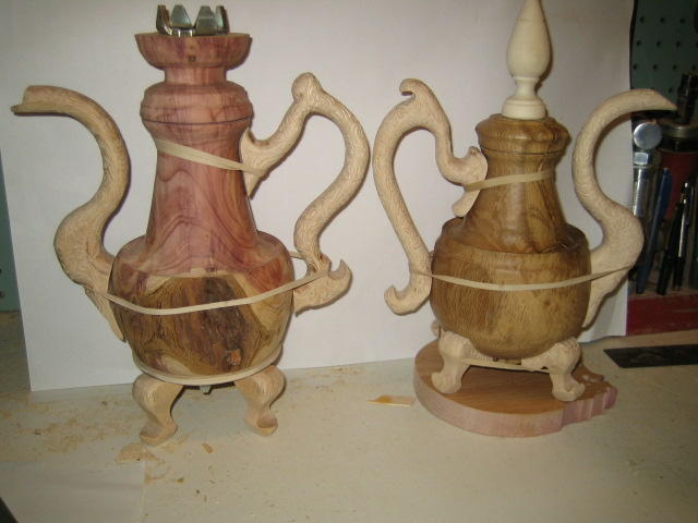

  This other tea pot I did the legs different... Now I got to figure how the set of legs  will melt into the rest of it and not look like a sore finger sticking out for everyone to step on.
  I mounted them on a piece of bb and the pot is just sitting there on the bb.

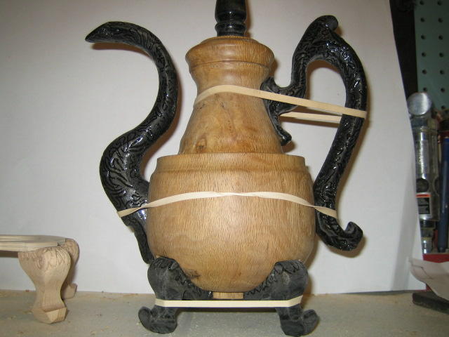

A little more work.. more thinking than actual doing something...IMG_0362.JPG.77530a5860d29a392b1dbfa18eba0051.JPG

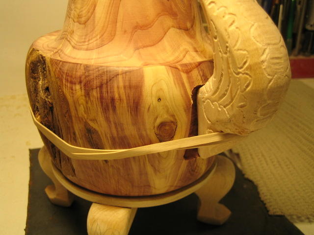

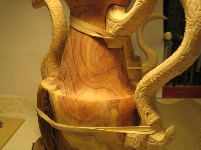

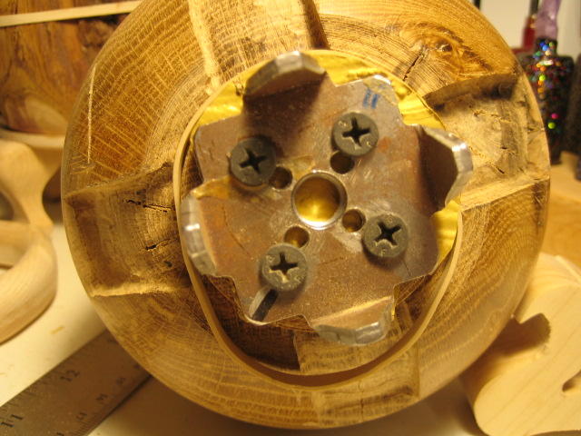

Now I'm cutting slots for the handle and spout to fit into. IMG_0377.JPG.71eaa03a7d01a149db68b549ee0b118e.JPGIMG_0375.JPG.b9890b15cd9cc7f508ebb1528deedf3a.JPGIMG_0373.JPG.629ceda60823411f48b362cf710718b3.JPG
 The gap on the top is not there when pushed up like it will get epoxied together,I hope
I know I am quite late to the party here, but if it was me, I would cut back the spout about half inch to an inch.
Otherwise it looks right to me.
OK since I posted this, I was able to see further progress. Looks great so far.
Edited by Charles Nicholls
I feel the same Charles. The spout is not epoxied in yet and I will pull it closer to the body before it sits up!

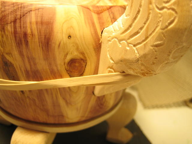

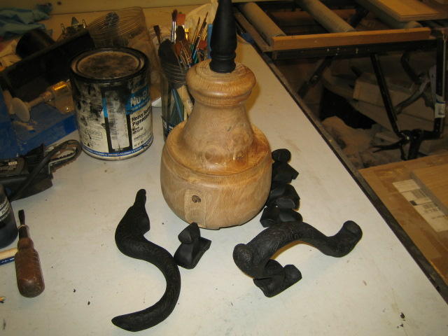

Now I'm in the process of rubbing the black stuff down with 0000 steel wool getting ready for the final shots of clear lacquer..Nothing is epoxied on yet. This way I am leaving myself an out if something goes wrong.....I also like to use the 3M all pro flexible sand paper in a fine grit..expensive but last forever.IMG_0432.JPG.c1a4a496ea8b3688528753fbc5fcafdf.JPG
 To secure the pieces on to the body I have 3/8"matching holes aligning the pieces to the body in all contact points.. I do wiggle the drill bit a little in each hole for better positioning and I do know the epoxy will take care of the voids.
  I will use thinned down 100% tung oil on the pot itself to bring out the beauty of the oak, uhgk.... then let set up for a few days or weeks before continuing.
  I do want to mention none of this carving looking stuff is any part of real carving... I actually ran out of things to engrave using the dremel with a very fine bit to make the indented lines.... So what I continued with were names of our families just to see if anyone actually pays any attention to what they are seeing when they look at an homemade object......
 By the way, the appearence of the black stuff will disappear with the next coat of lacquer...
