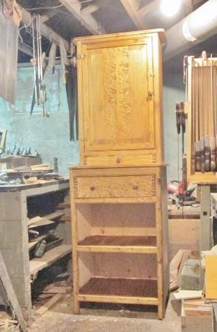

steven newman Posted March 22, 2018 Author Report Posted March 22, 2018 Was going to take a nap.....maybe let the door cure til tomorrow....nope, diddn't happen.. Went to the shop..was just looking for hinges...just in case I needed to buy ones.... Tested the clamps..removed them slowly..door didn't fall apart..good sign? Placed the door in it's new home...to see which was "Up" or "down" Folded up a couple pieces of sandpaper, to get a bit of clearance on the bottom...Hinges? I did have a couple packs of these..things....I hate these. But, I can make use of the screws.. Because I couldn't find the screws for these. Needed a way to start the screws in the right spots.. It centers itself in the hole on a hinge, then you drive that pointy end into the wood.. I even "clocked" the screws.. Or, tried to. Had some knobs. and installed one of these.. Used the two 6" sweep braces to drill a pilot hole, and a bit of countersink for the screw's head..Added a brass hook & eye.. Need to build a drawer to fill that gap between the two cases....add a couple cleats to attach the top to the base...then the stain goes on. Stay tuned...I still need a nap.. Grandpadave52, Dadio, HARO50 and 1 other 4 Quote

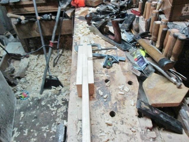

Popular Post steven newman Posted March 23, 2018 Author Popular Post Report Posted March 23, 2018 Hmm, for some strange reason..my hands smell like Golden Oak stain... This may be a long post, hope nobody minds... Typing and trying to eat a sammich, not the best way to do this, but here goes. Meandered to the shop..forgot camera.. meander back to the shop, had to turn these into sides and a back for a drawer.. Got these to match each other, already had fitted the drawer front into the opening.. Decided to use through dovetails, to match the large drawer Dry fit. then the groove for a plywood bottom was milled.. Even the back got a groove....back was attached via a couple screws into the ends of the sides..used a smooth plane to fit the drawer.. Dovetails sanded smooth, holes filled, knob in place, test fit? Now, the bookcase was designed to be removable, to make it easier to transport ( and get up my stairs) so I needed a pair of "cleats" installed Two countersunk screws into the top of the case, and two to hold the Bookcase in place, per cleat. These also act as drawer guides. Nailed on some pads for the feet.. Now, the reason my hands smell like Golden Oak stain..... Since I had to do the cleats, these two were set on the bench. Stain applied while they were just sitting around.. Once I got the lower cabinet done, I could set these into place where they belonged...( not blotch, GRAIN!) I also set the large drawer on the bench, wasn't much room with these two sitting there..but.. Yes, I did stain the shelves, even though they will get a pair of folding baskets on each shelf...freckled drawer? After tipping the lower case every which way to cover all the Pine....was finally able to set everything in place..ready? Well the skinny drawer does look good? And now the main event.. Waiting on the smelly stain to stop..smelling the place out, should be about dry, then. Then, a couple coats of Amber Shellac? Shop is not the best for project pictures...maybe once it gets upstairs? Stay tuned.. Harry Brink, p_toad, Chips N Dust and 4 others 7 Quote

steven newman Posted March 23, 2018 Author Report Posted March 23, 2018 They also guide the drawer as it slides in and out. Cleats stay hidden, with no sign of what is holding the bookcase in place.... p_toad, Dadio and Grandpadave52 2 1 Quote
lew Posted March 23, 2018 Report Posted March 23, 2018 I really like that "skinny drawer". Ideal use of the space. p_toad, Dadio and steven newman 3 Quote
Grandpadave52 Posted March 24, 2018 Report Posted March 24, 2018 You're beginning to crank out dovetails faster than a machine. Turned out very nice Steven. Thanks for taking us along the journey especially with all the pictures. Always enjoy watching what comes out of your shop. steven newman 1 Quote
