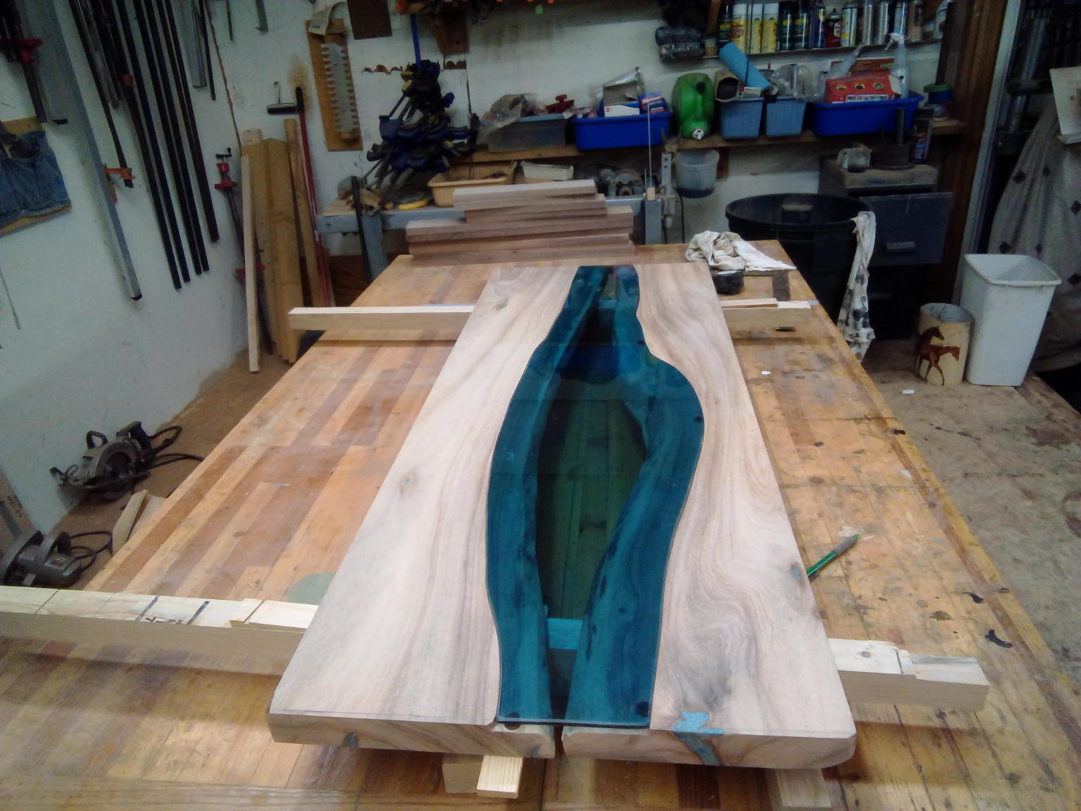

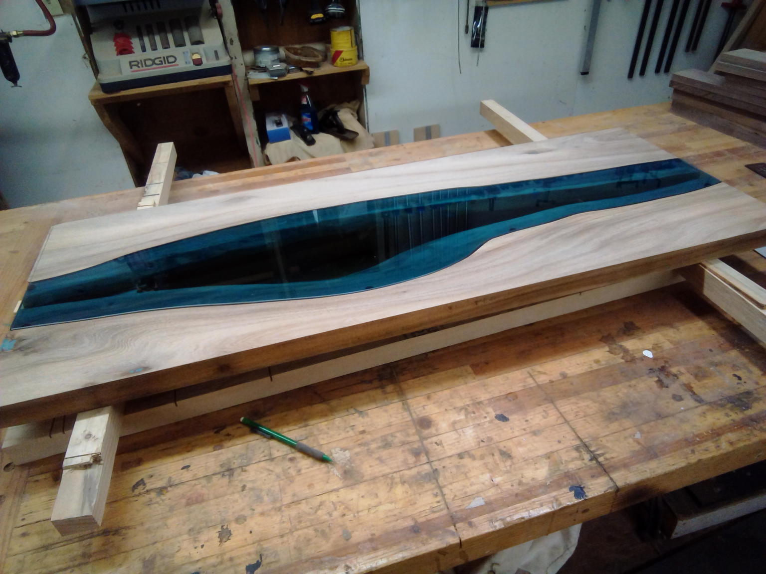

  • @Cal, THE GLASS FITS!!! Some trimming of the ends, purposely left a tad long. Next are the legs, then the finish. But, now I can uncross my fingers and toes.
  • Gene Howe
    Gene Howe
    @Cal, here ya go.
  • The pics are out of order. The first one is after splitting the slab and arranging it for the "river". The second one is track saw set up for the split cut.  Next step is planing.....after lunch.
WOW!  How nice is that?
