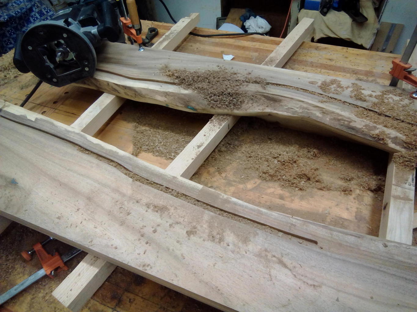

Routing for river table glass is getting a little monotonous. Got the first part done, routing up against the glass edge, using a 1/2” X 1/4” top bearing bit in a Bosch colt. A bit scary at first. But it worked well. However, now due to the curves on the live edges, there’s about an 1 1/2” more that has to come off. That itty bitty bit and router ain’t hacking it. Time to change to a bigger bit and a bigger router. The Freud 3 hp and a 5/8” straight bit might do the trick. Staying away from the edge the glass butts to will be nerve racking, though. But, it definitely won’t be boring.
Bit and router changed. No problems now. Love that Freud beast. Got some done but, now it's time to take Phyl out for a Valentine's day lunch. Lots of stuff on the agenda for tomorrow thru Sunday. Get the rest routed and glass installed Monday. Then, its on to the legs.

Patience, my good buddy. Maybe Tuesday next. Right now its practically smothered in shavings and there's a lot more routing to do. I'll get some pics when the glass is in.
For @Cal.....IMG_20180215_0541010_rewind.thumb.jpg.a4cc04c65fb1b580db3588d0796b7d8f.jpg
