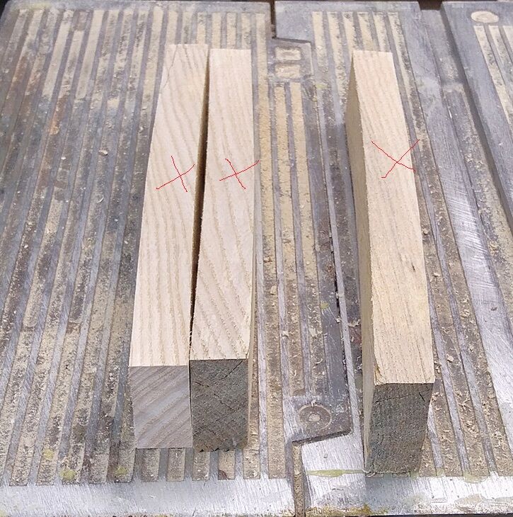

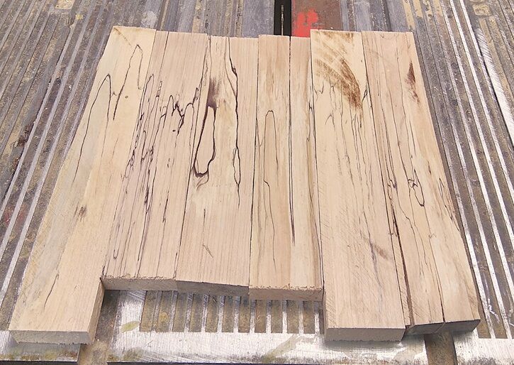

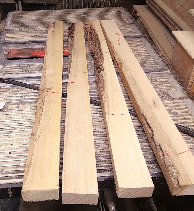

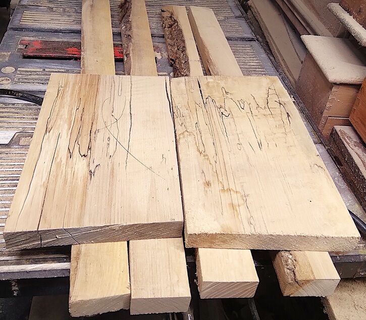

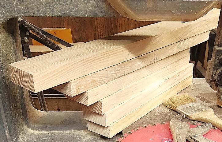

  1. Because..I have this mess to clean up.. Leftovers from other project...and some that will need to be tossed out.. And a couple that need a wee bit of work.. First step... Set the fence to rip down the wider boards..as I can always glue things up into panels.. And, sort through the worst of the mess...like these 3.. FUBARS? Or.. These 2 were not worth the effort to fix.. I also chose not the resaw these.. Raised the saw blade to full height..fence was set to 9/16" and then I ran a bunch of parts through, usually having to make one pass, flip the part over, and finish the cut...also had to keep track of Blade Tilt, as it started to move a degree or too....but.. Anyone liked their wood Spalted? Going to be Drawer fronts, Later... These are the "Keepers" Saw even needed a cool-down...was working hard, today..? Ya think? Red saw blade will be going back on the saw, later today....was a wee bit warm, yesterday.... Waiting on Moose & Squirrel Express to deliver "PLAN" then glue up 4 panels to surround 3-4 drawers? Stay tuned..

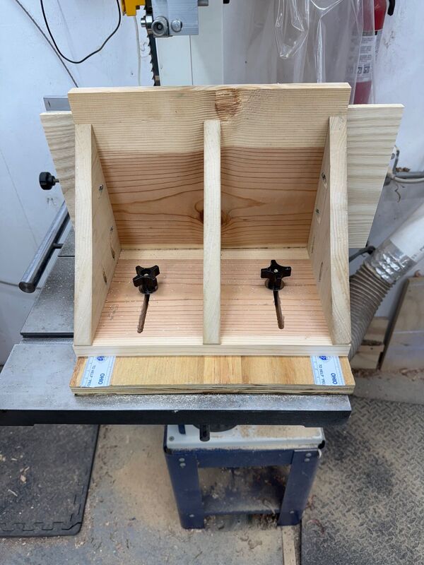

    Segment ring sled
    I have made a few segmented bowls in the past. I never cared for a 3/4” thick ring. A friend of mine showed me a sled he made that will allow you to cut rings any thickness you want. I just took some 7/8” thick rings and cut them in half. Then I sanded them to 3/8” thick on my drum sander. It is a game changer. It also works great for resawing a solid board but you are limited to length.

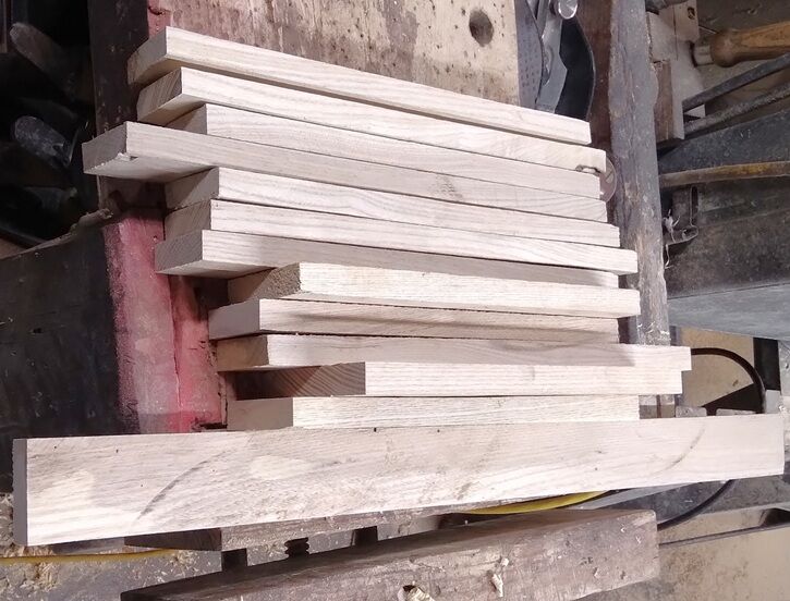

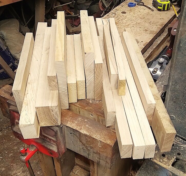

  5. Ok...this is going to take a while...seems after the last 2 Projects were done...I still had a stash of lumber.. Ripped the worst defects off the edges, or tried to....reset the tablesaw.. Placed the best ( straightest) face against the fence...fence was set at 1/2" width. Takes 2 passes but... Some were not quite as wide as most of the rest....sorted through for the best looking of the bunch.. Planed away the saw marks.. And lay things out a bit... Joint a few edges.. And glue up a few panels... What WAS going to be a "Lid" became the "Front"....another was cut in two equal sections, to make the 2 "ends"...the "New" lid became a 3 piece affair... Then it was a matter of cutting things to size.. But, these needed jointed, again..because.. None matched the other 3....Finally.. I think I was ready to start the joinery...I also had both the Lid, and a Base cut and milled to roughly the size I needed... So..Project Started...Next episode? Finger/Box Joints! Stay tuned...

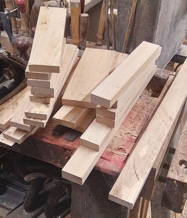

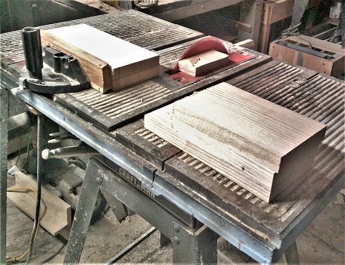

    Had a bunch of Ash scraps...too thick too be used as is....decided to thin them down a bit....and try out the brand new tablesaw blade.. Old blade was starting to burn stuff...New blade had to be installed from UNDER the top of the saw...BTW.. Wanted to square the ends of some of the boards, and see what the cuts looked like.. Yes it is very sharp.. Cut is a tad on the rough side...then set up to do some resaw work... Zero Clearance Overlay...cut will leave 1/2" of "good" wood... Almost deep enough...so, to remove that last bit.. Disston D8 , 28", 5-1/2 ppi RIP saw.... Doesn't have quite as wide of a kerf, as the tablesaw does.. Once I got the middle of each board.. I was left with.. 5 pieces, 4" wide, by 1/2" thick..and five at 1/4" thick....same set up for the rest of the "scraps" These only needed 2 passes through the tablesaw...and.. These 3 only needed a single pass each.. Tablesaw was busy, today.. And the hand saw was too... Half of it's sawdust stayed up on the bench, the other half? Made a nice little pile on the floor below.... Will let the pieces sit a spell, while I decide on what to make with them....maybe another boring little box? Stay tuned..

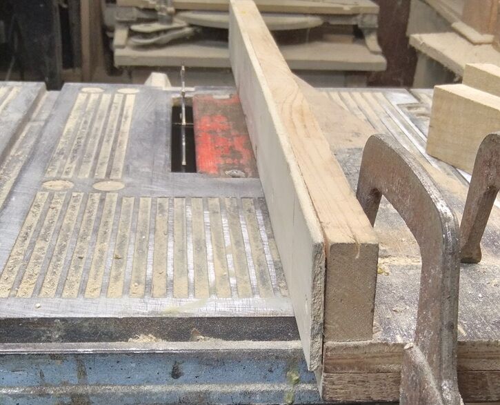

    Have noticed over the past week or so....vise on the end of my bench was getting a bit of the wobbles.....seems a couple screws into the end of the bench have stripped out, yet again....rather than tear the bench apart....decided on something else...Still had a chunk of 1 x 6 Ash.....cut and ripped it to close to size....but it was a tad too thick...we have ways Set this up...blade all the way up, still did not meet up in the center of the board...D8 Rip saw finished the job.. That just might work. Not sure about the thin piece, yet...Had to remove the sliding part of the vise..to drill and counter sink a few holes... There are no holes in the middle, as the steel jaw of the vise is there...Before I installed the moving part of the vise...a drop of 3in1 oil on the rods and the threads...works with just one finger, now.. Tried out a different vise.. Wentworth No. 1.....and it's 2 x stand....checking that this stays put...got a spotlight at the ready, too... Because there are some tiny teeth involved here... Saw is a Jackson 12", 14ppi (yes, I counted) Backsaw...and in the time it took to write this blurb up.... Saw file is back there in the tool tray...saw has been test driven....no binding observed...ready to go back to work... One vise is fixed..the other in use....while trying to get things sharpened and put away... Stay tuned...

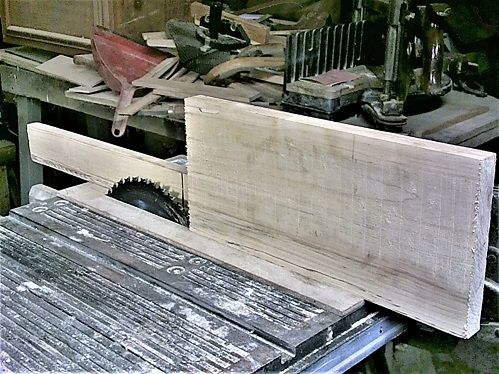

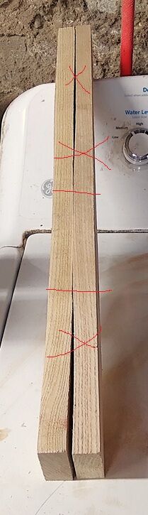

    That time again...time to clean the place up.. Sort through a few stacks..found some decent ones? Might come in handy...others? By the time all the bad stuff the cut away...this is what is left from one plank from upstairs...way too much bark and knots,,and holes.. There is a 1 x 6 x 2' that is just one big knot....other items.. Will meet up with the one on the right... All the further the tablesaw blade could reach...run the rip saw down the kerf to get some use out of these...throw the worst scraps out.. Then it become a puzzle as to how to put these all together into a project...might need some of these? We'll see... Stay tuned...

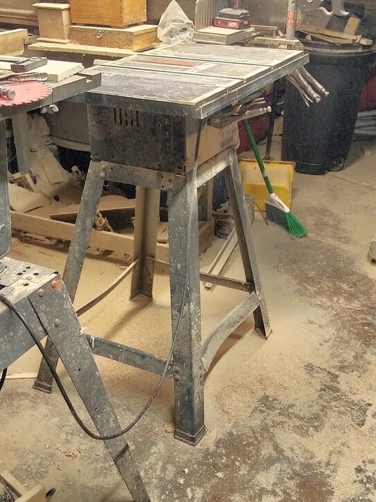

  14. After 235 miles round trip, gas, tolls, time, and one fried shrimp lunch along the coastal highway, I own an older Delta contractors saw. K88-xx serial number is 1988? The 120V motor had power and noise issues but it fully disassembled, it wasn't bearings nor bushings. It was the drive belt. Plus ribbons of HDPE wedged within the motor. Someone was cutting cutting boards As much as the motor guy motor-mouthed the motor, fully-assembled, noise was not banshee-unbearable. No one complained about my front porch resaw clinic. I ripped until I could not find my flip rule. Took a break, drank water, realized I'd been running the Delta four hours. Ripped another 30 minutes. Near'filled a bucket with sawdust. Did not have compressed air like Steve Newman, but with the mini-vac reversed, a blew everything out, eased the 110 pound saw back into the living room, and my new friend doubles as an off-entrance table. Quietly awaiting more fun. At max height, it is a slow push resawing heartwood. Started with full thickness machine-oil impregnated heartpine. With care got nice slats with no blade marks. Thinner stock, easier push. This wood, I'm unsure what I'll do with it; be more careful in what I buy I've more but it'll be venting cutting oils for my lifetime. Maybe decking for sturdy basement platform step. Noticed early that the thin blade cuts easier than the thick blade. With care, I got slats of heartpine as thin as the thin blade. Shut off the saw and adjusted the fence to 16th" before every resaw cut. Maximizing the good piece - a 3x4x22 remainder from a 4x8x22 joist, still not enough for a 60" headboard. Maybe a panel nonetheless? A shutter panel to set in a window frame when more darkness is wanted. Wall hanger by all other times. Left nothing to chance - even cleaned the flip rule. An old drawer front of fine-grained, white, buttery wood? Buttery wood, butter-smooth cut. Very rewarding - opening up a single 1x3 - 55" piece of c.1910 flooring dumpster-rescued a few miles west, outside a refurbishment. Ya cut it open, the wood is as fresh as the day those carpenters laid the floor, scraped it smooth, before floor finishers did their thing. Before my next session, this Lufkin will get more respectful cleaning.

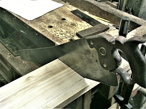

    Lets see..we have a plank of Maple.. Not only do we have a set of plans, we also have a "Prototype".. Had to haul the plank to the shop...do a bit of lay out.. I WAS going to use a full sized saw to make the cross cuts, but.. Choose this little "Panel saw" instead. 20" long, 10 ppi Disston D8 ( old style, the "8" is inside of the "D" in the etch) Between the plan and the prototype...was able to lay out a few blanks... As I need a bottom panel, a panel for the lid, a panel for the ends, and the front and back...which left this.. For some of the drawer parts. All of these were 7/8" thick...way too much...decided to resaw things down a bit, according to the Plan: Lid is 11/16" thick, bottom panel is 1/2" thick...the four sides were supposed to be 1/2" as well....will be 3/8" instead. Had one edge that needed jointed.. As it had a slight bevel going on. Need these blanks to stand up on edge, for the next step.. Because of the way the shop does resaws...I need to mill a kerf for the rip saw to follow. Saw is raised as high as it can go...fence is set for each thickness to be milled. In this case, it is set for 11/16" width..boards are shoved through on edge... Then rotated until all 4 edges are done... This is the 1/2" thick bottom panel...then it is time for the handsaw... 1st try...kept wanting to flip out of the vise...managed to finish this cut, from both ends.. Decided on a "better way" to hold the panel... Since the end vise will open just enough...results? I have to be careful, though...usual routine is to cut from each end, and meet somewhere in the center...hard to see where, so when I do reach the other cut.. The saw will drop down onto the benchtop. However, my left pinky is also right at the edge of the handle ( 2 handed grip) and yes, it did get hit..once. Just a matter of "follow that kerf".. Results? Just have to smooth things out, tomorrow. Have that Drawer parts blank to resaw, yet. Also tomorrow. Had quite enough of a Cardio Workout for one day....even with the fan on high, was still soaked through...swept the shop, and headed for a cold Tonic & Gin. Stay tuned..
