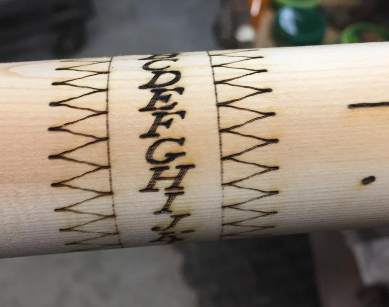

  2. Steve Krumanaker
    1st cryptex, rough
    This is my first cryptex and what a learning experience. It's really a pretty simple thing to make but dimensions are critical. I expect it will take two or three more before I get any I can use for gifts. I have to say I am thrilled at how well the rotary engraver worked once I got the pattern and spacing figured out. The rings have the alphabet on them but the code for each grand kid will be their birthday as it corresponds to the letters of the alphabet, won't tell them at first and see if one of them figures it out. I don't think they can guess it out as there are about 3 million combinations possible. I wasn't sure how long to make the barrels so I had to trim them off on the band saw, shouldn't be a problem on the next ones. From what I understand, these devices were used to transport sensitive messages. Supposedly the message would be written on parchment and a glass vial of vinegar was placed in with the message. A person couldn't break into the cryptex without breaking the vial which would dissolve the parchment. I don't know if all that's true but it makes a good story and these are kind of neat I think. FWIW, Carl Jacobson has three videos on making one of these and that's where I got the idea. Steve
  3. What do you do when you have a project in mind that will require a lot of lettering but your lettering stinks? Well, if you don't know any better, you try and build something to do it that you don't know anything about. I started gathering parts for this several months ago, doing research, doing drawings and redoing drawings. Bought a little 2D cad program and had to learn how to use that, still learning BTW. After all that I decided to try and build a proof of concept, prototype, and learning project. This is the result, this video is not public and it's not very good but you should get the idea what I'm trying to do. I can see mad potential for what this may do for me on vases, ornament globes, rims of bowls, etc. etc. For now though, it almost works and I have some areas to redesign and make it better. This is my first "successful attempt what I envisioned before starting this project. Not nearly refined enough and it's much too large for what I have in mind but it's a great start I think. Drew the scroll in Inkscape and turned it into a file my engraver can read. Still learning about all that as well. Steve
