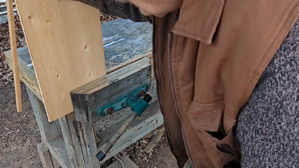

    I use my marking gauge to mark cut line for the other edge. My kingdom for a panel gauge. Ain't got time to stop and make one. I marked the board as wide as I could and get it parrallel, so all I
  • Handfoolery
    Handfoolery
    Once flat I mark it as the Reference Face. After which I use that Reference Face to flatten and square a Reference Edge. So, in the vise... And it's on. Reference Edge marked. From this

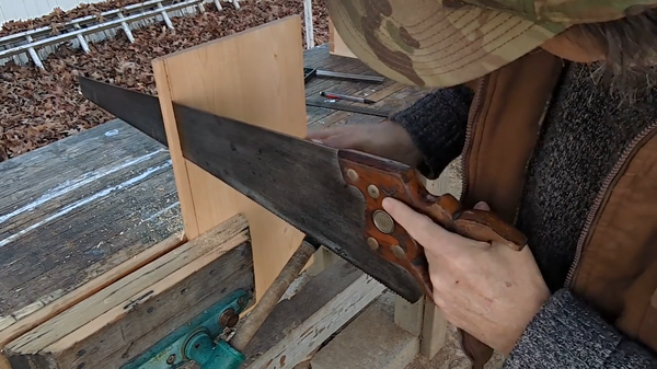

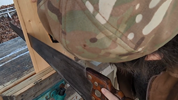

I need to make some boards that will go along the sides of the box at the bottom, so I break out my hand saw and start sawing.
I love this old Atkins.
And here are three of the four that I need.

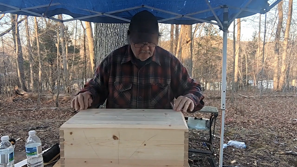

First step with that is to lay that board flat on the bench and set the chest on top of it
And draw a line on it that matches the interior dimensions of the chest.

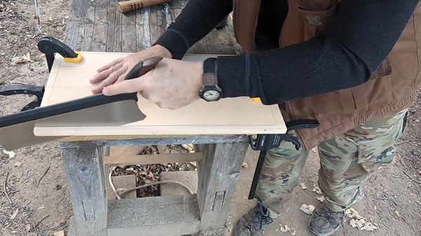

After cutting it to rough dimensions, I plane it down close to the lines
And it is just a matter of planing and shooting the ends
until it fits as closely as I can to the interior of the chest.

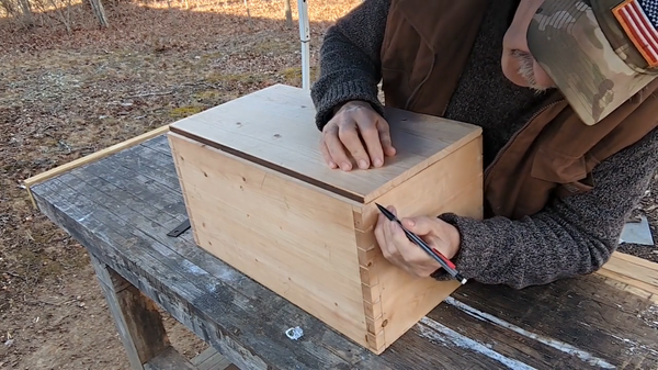

Time to work on the top.

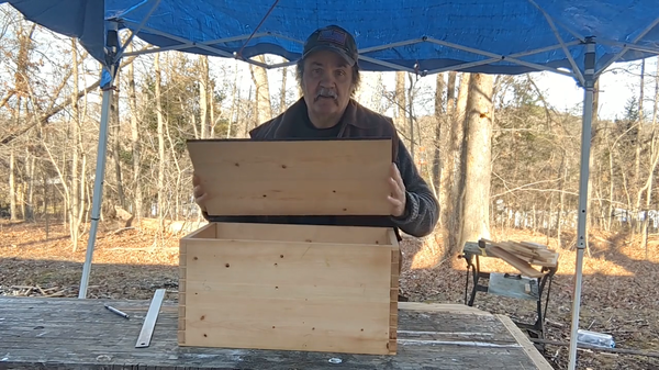

In building this chest one of the goals was to be able to add tools to the underside of the lid in the future. That's a problem because the thickness of the top is around 3/4". I want to be able to screw into it.
So the goal first off is to fit another piece of wood into the top opening, similar to how we did the bottom, but without the rails. You will see as we go.
This is going to be the internal piece for the lid. It's about 1/2" thick.

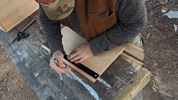

To trim this to the interior of the box, I set it on top and make pencil marks that will help define the corners, or depth, of the chest.
Then I'll use these marks to give me lines to cut to.
Then of course we gotta cut it to rough dimension.
