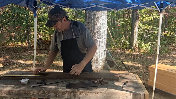

First step is to measure, mark, and cut to length.
So, measure
...mark....
...and cut.

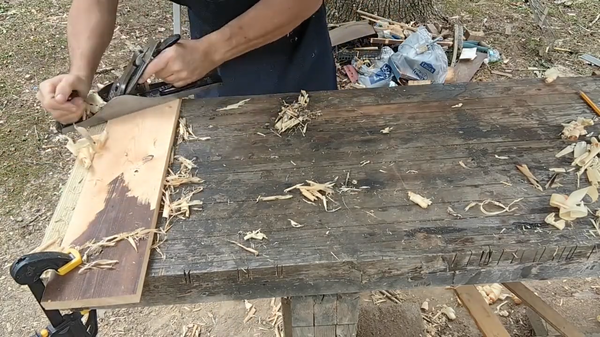

Time for flattening.
I start by laying the concave side face down against a planing stop. It's preference, but I find if i lay the concave side down the edges will lay still and not flop around on the bench.
To remove the hump in the middle of the convex side I work on the middle portion of the board, traversing across but not hitting either edge with the plane. If I did that the plane would ride over the hump and not remove it, but the edges would get really thin.
Speaking of thin, this is box store lumber. If I go at it with a scrub plane or fore plae, then a jack, and a smoother, there won't be anything left of it worth using. I want to remove as little wood as possible to bring it to flat .
Thanks, Lew!
Once I get the hump out and the board close to flat, I position it lengthwise against the stop and begin flattening with the grain. I tend to go at it skewed, so that I can use the flat surface of the plane sole the help span the high spots as I take the board down to flat.
Finish off with a straight ahead approach.

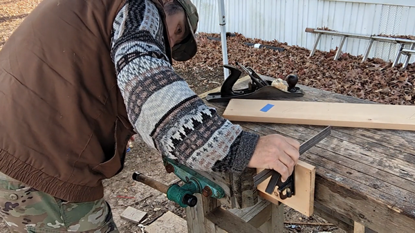

Once flat I mark it as the Reference Face.
After which I use that Reference Face to flatten and square a Reference Edge.
So, in the vise...
And it's on.
Reference Edge marked.
From this point on, all measurements and markings will be done by registeringthe square on either the Reference Face or the Reference Edge.

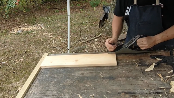

At this point we flip the board over and flatten the other side.
Then we check for wind...
By traversing diagonally from high corner to high corner, and feathering toward the middle of the board we remove any wind in the board.
I use my marking gauge to mark cut line for the other edge. My kingdom for a panel gauge. Ain't got time to stop and make one.
I marked the board as wide as I could and get it parrallel, so all I need to do is plane down to the line, flat and square.

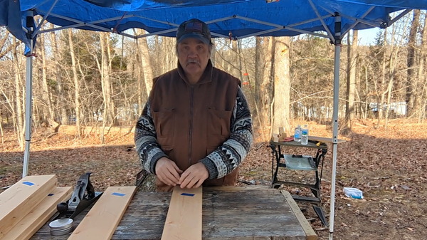

Time to joint the edges of the panels. I will spend some time trying to match them as well as I can for grain and grain direction. It's not going to be perfect, but I do the best I can. If you look at the boards they each have blue tape on them. They are labeled so that I know what goes with what, and they are stacked accordingly.
So, pop it in the vise....
...and plane them square and straight.
This is done on both pieces until they mate together perfect;y, with no light between them.

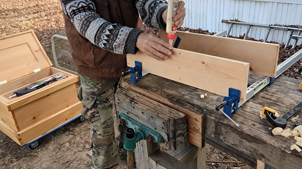

After which they are glued...
.and clamped.

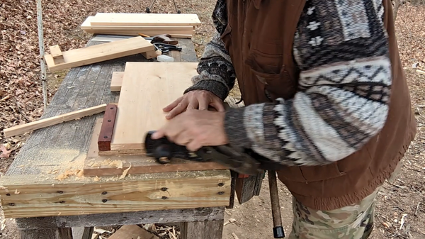

Next is the shooting board....
where we shoot until it's smooth and square.
Flip the board and mark final width of the front panel.
and cut to the line.
Shoot that edge...
