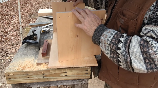

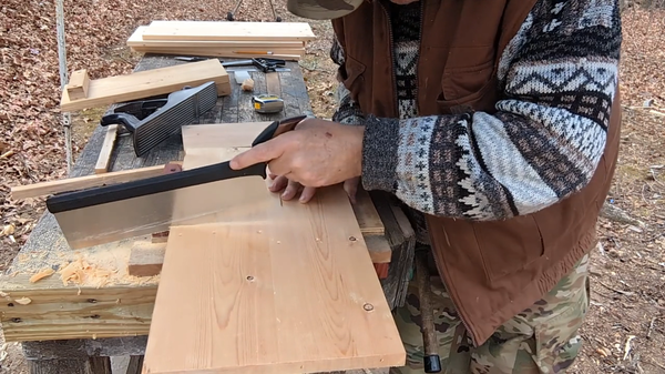

Once we cut the pieces for the side we need to shoot one end.
The shooting board and bench hook are wonderful tools for hand work. Both side pieces a shot for square and smooth, and brought to exact length with one another.
So now we have the front, rear and side panels for the chest cut to length, perfectly matched with one another, with end grain smooth and square.

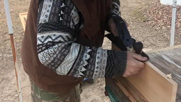

Once they are all marked I will saw close to the line with a rip hand saw.
And then plane down to the line.

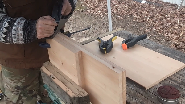

To mate them all together so that they are exactly the same height, I set them on edge together. In this case using a board I previously flattened, because my bernch is an outside bench, and I do not trust it's flatness....
.....and, grabbing them really tight so they won't shift, I transfer them to the vise.
Then it's just a matter of planing them flush with one another.
Keeping track of square as I go.

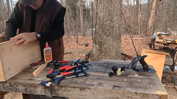

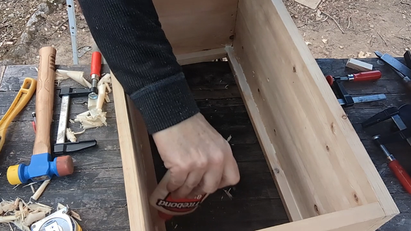

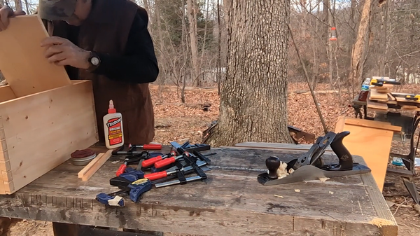

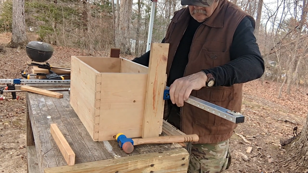

And then it's time for glue up.
And clamps.
Checking for squareness
And that will sit overnight.
