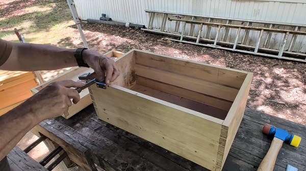

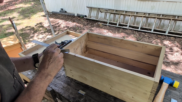

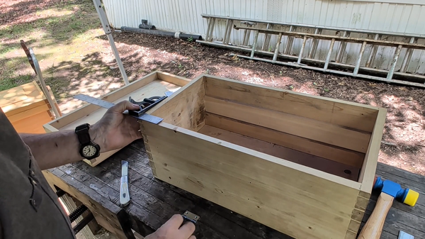

I set a combination square for 2 and 1/2 inches. Arbitrary; I just sat a hinge on the piece where I thought it looked right and measured the distance from the corner.
Lay it on the piece
Mark the outside measurement
Rinse and repeat for the other side

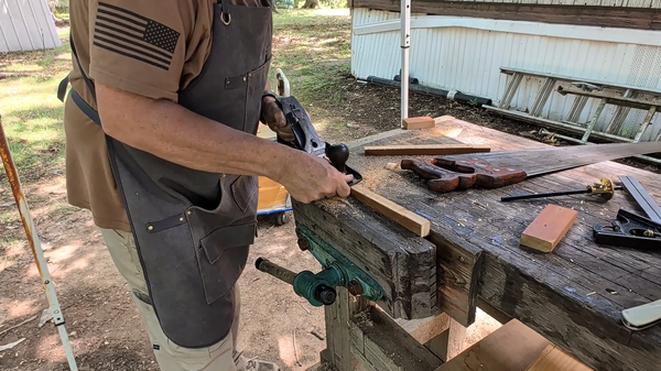

    I use my marking gauge to mark cut line for the other edge. My kingdom for a panel gauge. Ain't got time to stop and make one. I marked the board as wide as I could and get it parrallel, so all I
  • Handfoolery
    Handfoolery
    Once flat I mark it as the Reference Face. After which I use that Reference Face to flatten and square a Reference Edge. So, in the vise... And it's on. Reference Edge marked. From this

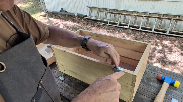

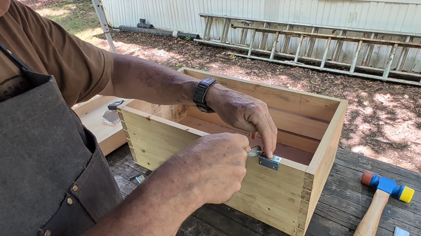

Back to the other side.

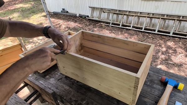

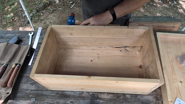

Place the knife in the knife line and bump the hinge up to it
Hold it in place and make a tick mark on the other side
Repeat the other side.

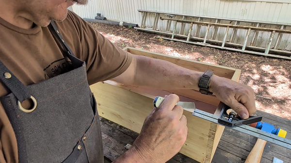

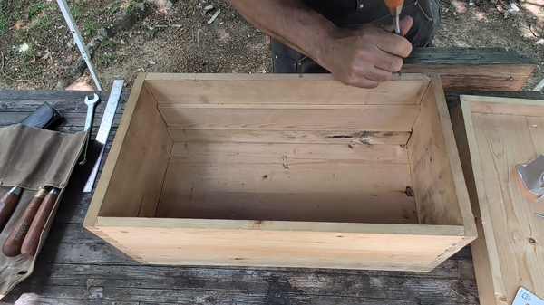

Mark the inner line for the hinge mortise with the square

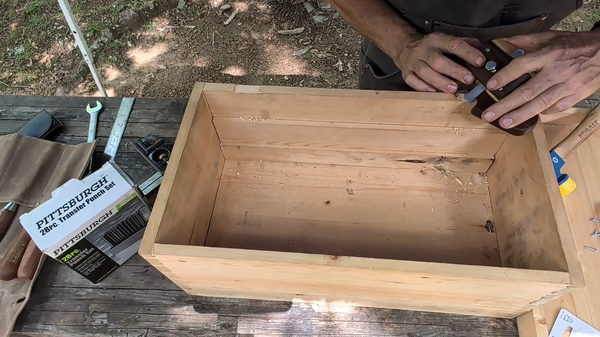

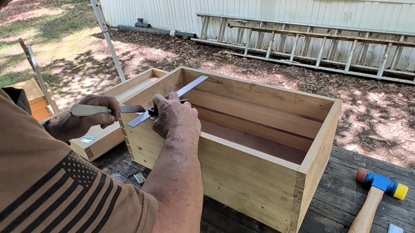

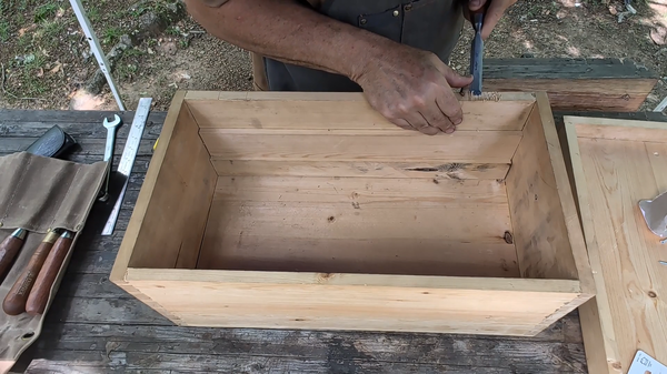

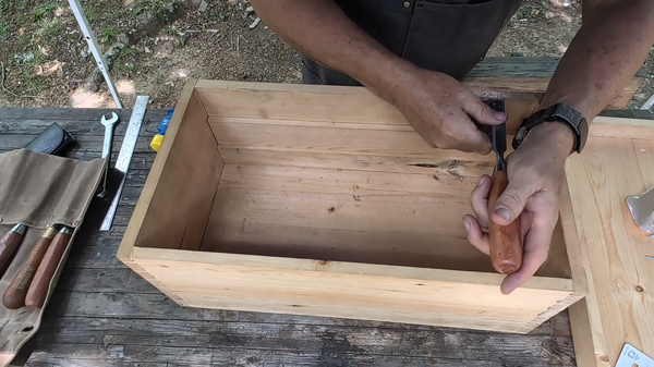

To cut the mortise I don't want to place the chisel right in those lines at first, if I do the wedge action of the bevel will push it back past the line.
So I place the chisel about a sixteenth or a bit more away from those lines. and chop lightly,
what I will do is begin making shallow cuts with the chisel until I have chopped the whole width of the mortise, and at the end I will define the outer walls. Something like this.

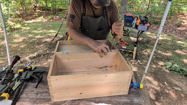

Then i begin excavation, carefully, with more of a paring or slicing motion than a push
Working carefully from both sides, once again with a paring.slicing motion, not a push.
No force is used, just a sharp edge. I like my belly and don't plan on stabbing myself.
I also don't want to blow out the other side.
These chisels are lovely, btw.

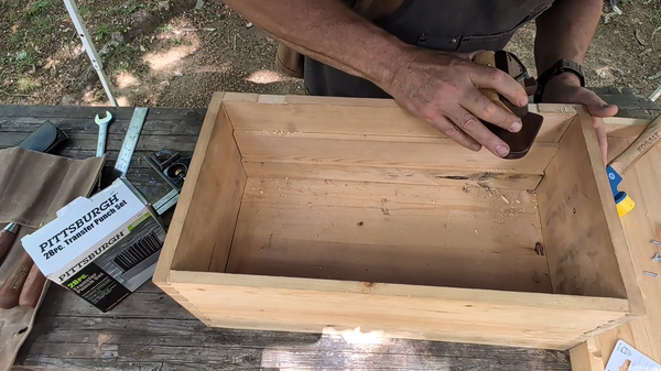

I use my little shop made router plane to flatten the bottom

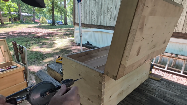

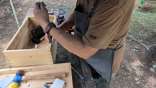

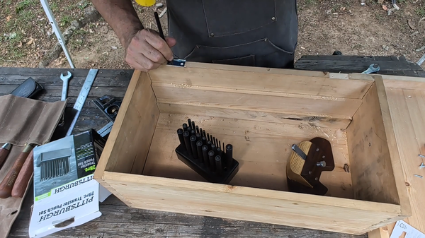

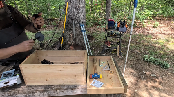

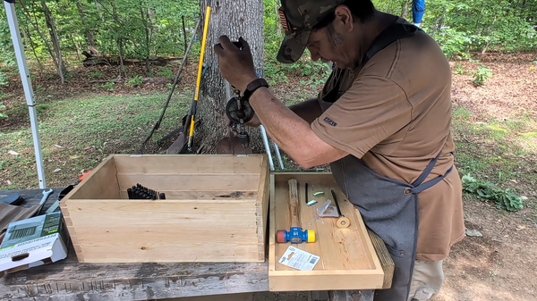

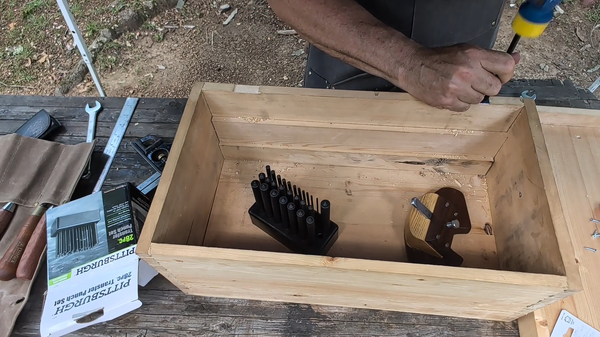

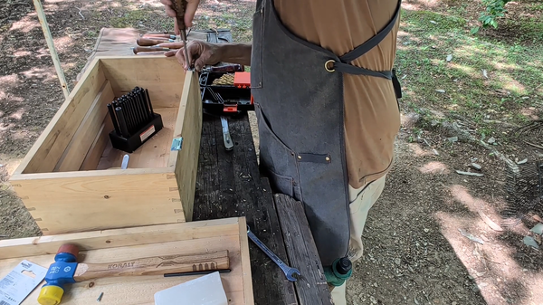

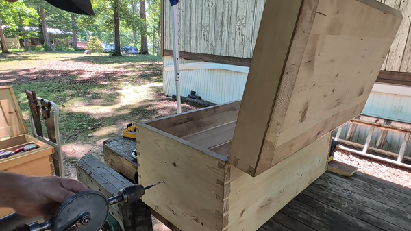

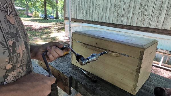

Once they are fittted and I'm happy i use a transfer punch to mark the center of the holes for the screws.
Holes are drilled the old fashioned way.
Edited by Handfoolery

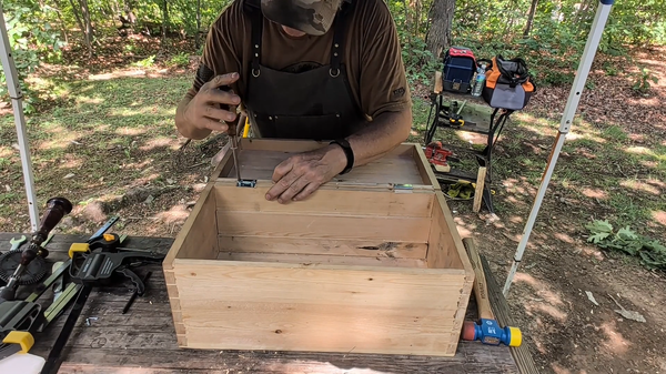

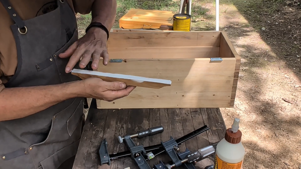

Same process is repeated on the lid, and then the hinges are attached to the chest first...
Then the lid is attached. I'm just resting it on my body to hold it in place.

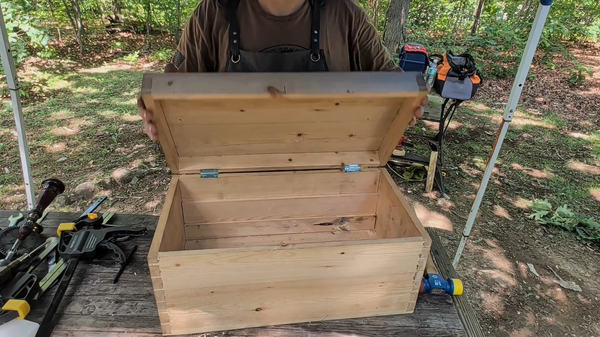

Annnd, here we are.
The fit is lovely. That's all for tonight. thanks for looking and commenting on my thread.

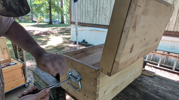

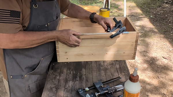

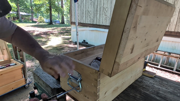

The chest has it's hinges, but the lid is very heavy, so I need a way to hold the lid open to the position I want, so that it does not spring the hinges.

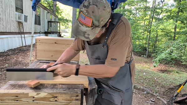

So, cut to length
Shoot the ends square.
Rip to width
Then it gets the plane
And the chisel

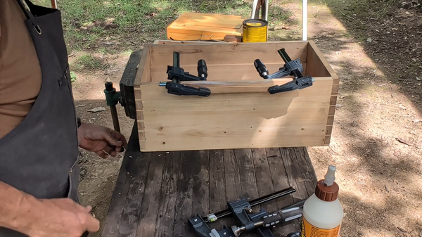

Some glue, using the greatest glue spreader ever created
Then the clamps
Once dry and the clamps removed it gets the screws put to it.

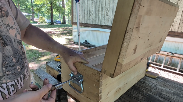

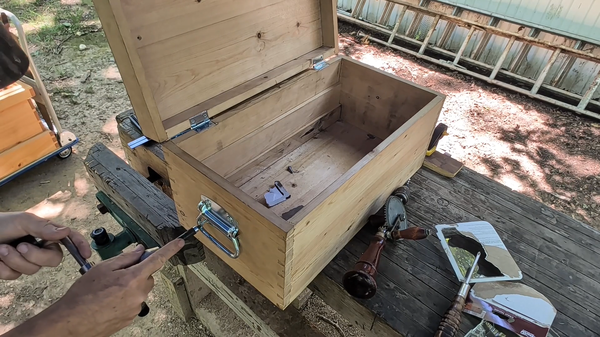

Once that is done it's time for the handles
More screws

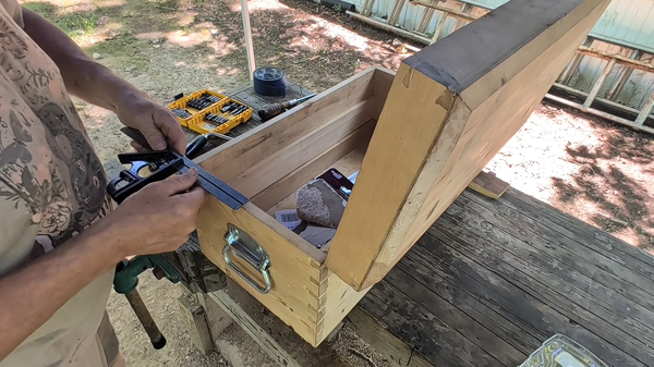

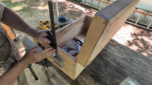

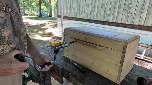

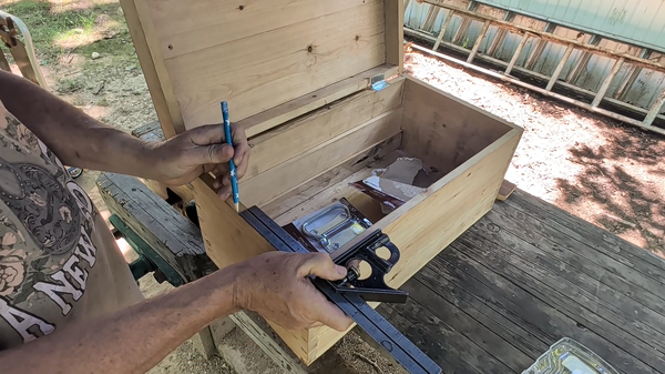

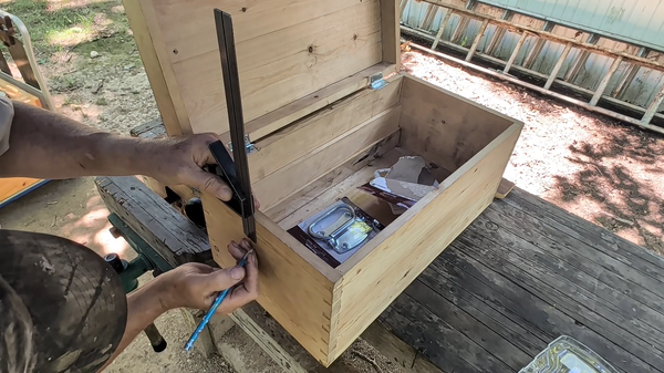

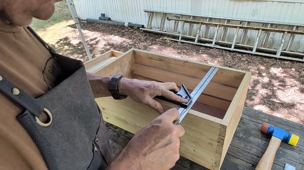

To locate the other handle I use a combination square to get the center position.
Mark that on the other side top edge.
Turn the chest back around and get the distance to the top of the handle
Rinse and repeat for that side
