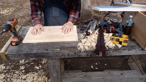

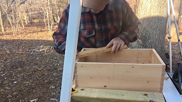

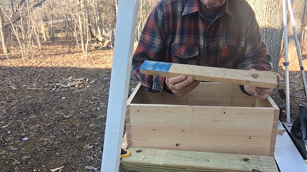

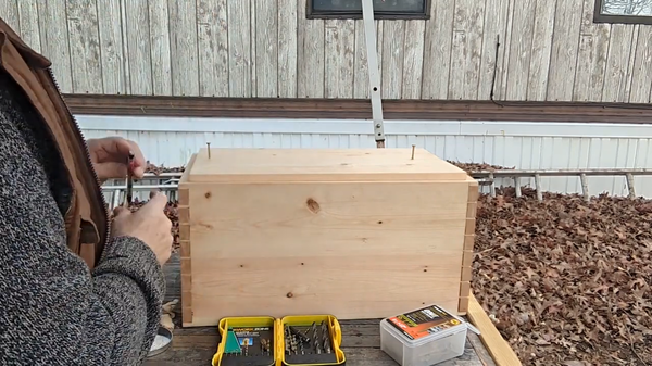

So, once I have the piece fitted to the internal dimensions on the opening of the top....lid 1.png
...the two screws are so i can pull it back out. 🤨

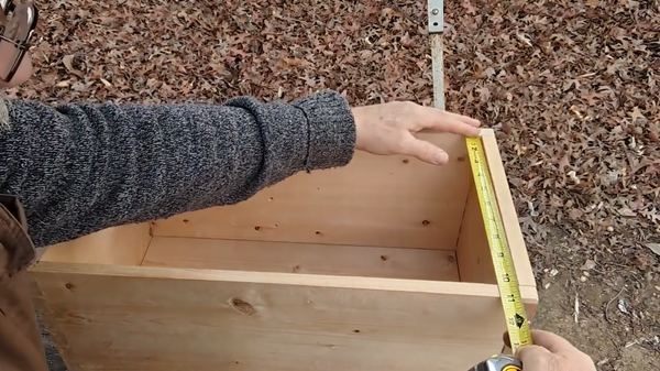

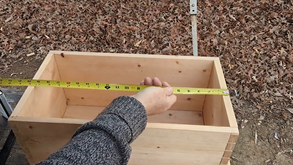

I measure the depth and width of the box....

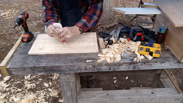

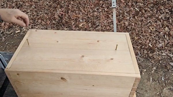

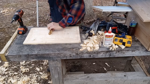

Place the fitted piece centered on a panel I cut to oversize of the box measurements I just took....
...slather on some glue....
...and clamp er down.
After the glue dried I glued the piece into the top of the box, waited for that to dry, then trimmed it to the box.

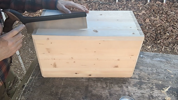

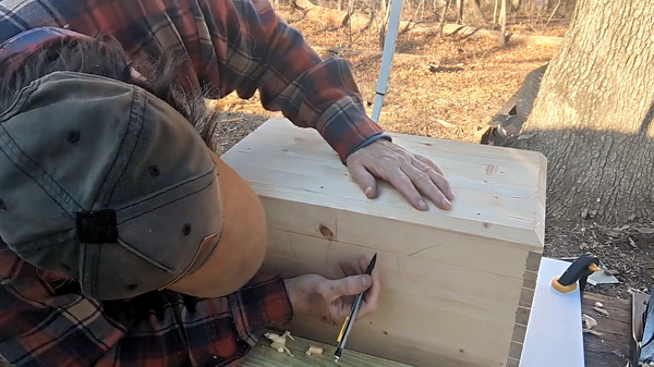

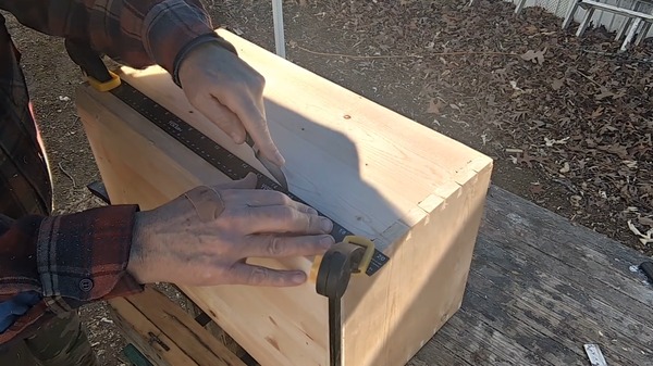

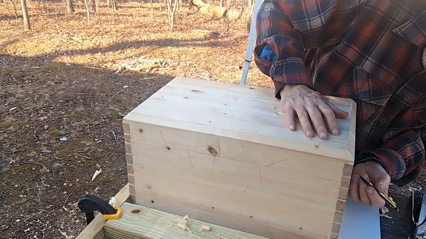

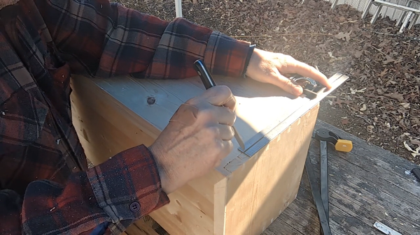

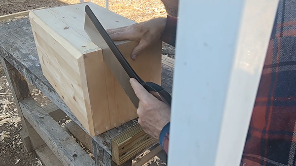

So, make a mark about 2 inches from the top

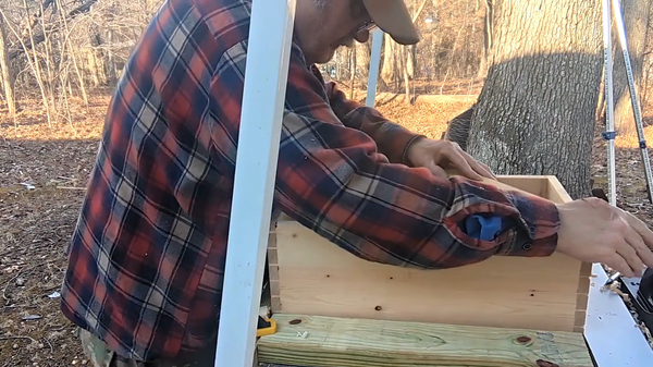

Carry that all the way around, then I make a knife line that defines the cut.
I used a rule clamped in place so it would not shift, and cut that line all the way around the box.
This is coming along nicely, glad the weather is starting to cooperate.

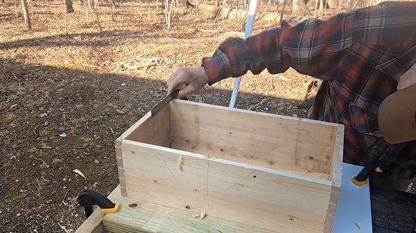

Then it's time to get happy.
As I get near the end of the cut I use a clamp to loosely hold things together. I don't want the piece splitting right at the end; want a clean cut.

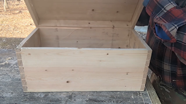

Tadaaaaaa!

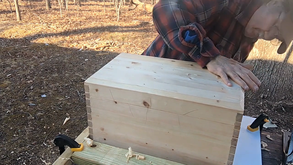

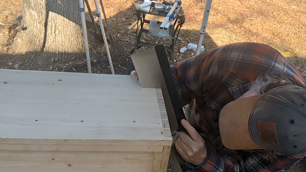

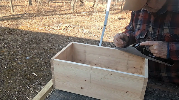

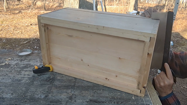

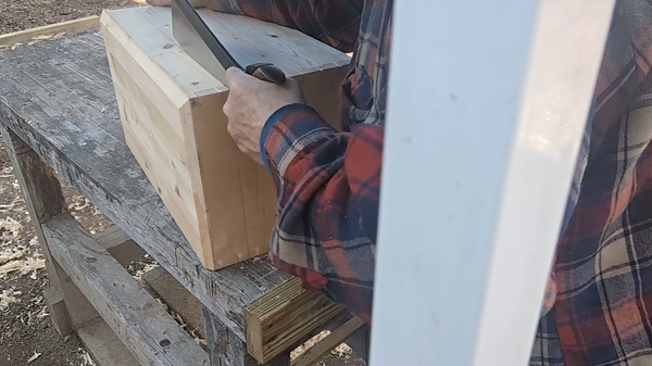

Once the box is "opened" it needs to be fitted.

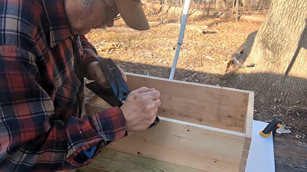

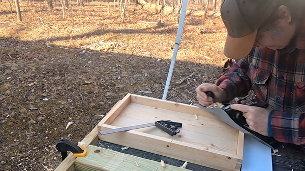

That involves taking a plane and cleaning the saw marks away, and squaring the edges.
This is done by using my 14" Jack, and using the longer sole to span two edges, keeping everything as level with everything else as is possible.
Keeping track of square.
This needs to be done on the lid as well.
Edited by Handfoolery

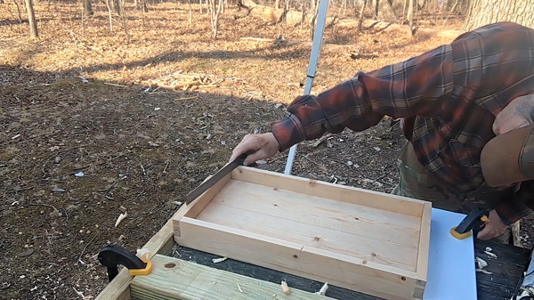

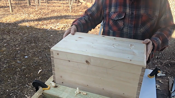

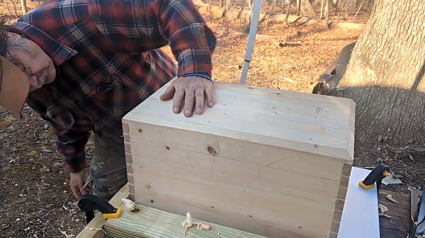

After which I sit the lid on the box...
Examine the joint closely
And mark any areas where there is a variance.
After which I use a straight edge in those areas to better see what is going on....
...and then plane for correction.
then I use a board with 80 grit affixed to one end...
to span the distance and smooth things out.
This is done on both pieces.
...until the pieces fit with no gaps, and no rocking.
All for now. thanks for looking. More to come.

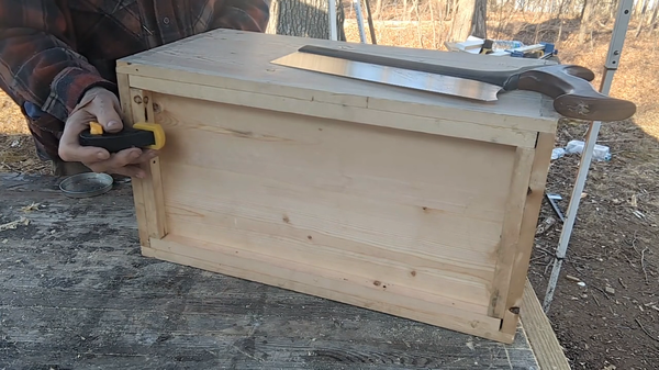

I am extremely sorry it has taken so long to update this thread. I'd tell you I'll do better, but I was taught to never lie, so....

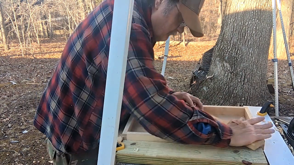

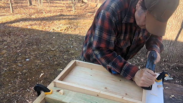

After cutting the box open, the lid and chest had to be leveled and fitted together as perfectly as possible. I inlisted my old friend the No. 5.
