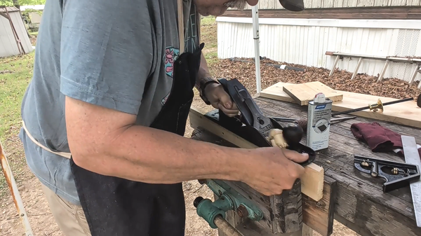

Next step was to install the rails.
So I get ripping......
....and planing.......
......until square is achieved.
Then shoot the ends until they fit.
This is repeated for all of the rails on which the two trays will sit.
Sorry, I repeated the fitting of the lid. Oof.

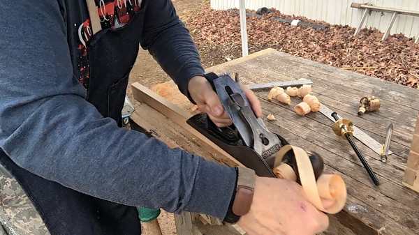

Pop some wood in the vise....
Cut to rough length.....
Mark a line for tray height,,,,,
....and plane it down.
