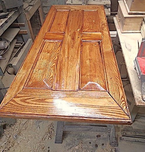

Doors now have a coat of Warm Gloss Poly..

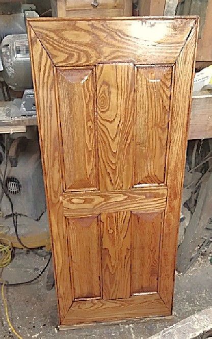

Door #3..

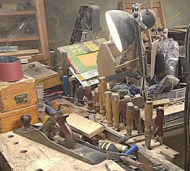

Bench has a spotlight/work light...
That I can shine over and onto the door, to see where I miss....Door #4?
Was done over on top of my tablesaw..do one end, rotate around 180 degrees, and finish up at the other end.
There is an overhead LED work light right above this..
Letting these 2 doors sit a while...rub them out later, today...

    Doors now have a coat of Warm Gloss Poly.. Door #3.. Bench has a spotlight/work light... That I can shine over and onto the door, to see where I miss....Door #4?

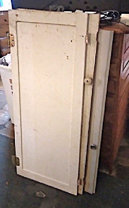

    Working on a Tuesday,,, that THOUGHT it was a Monday...old doors have been demoed off.. No, I was not the least bit gentle about it, either... First new door... Took 2 peopl

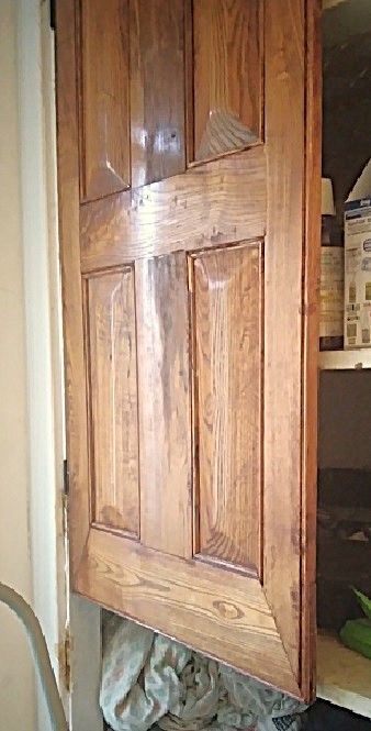

    Door #3... Has been installed..as is the divider strip...   Door #4?  Will have to wait until tomorrow..had to add a tapered jamb piece.. Waiting on white paint to dry.
Look awesome Bandit. Finish really makes the grain pop!
Finished really nice!
I love me some warm gloss poly!
Looking great.
Question, if I may?
What do you use to do the rubbing out? I'd be interested in your process.
0000 Steel Wool..looking mainly for "dust nubs" .....rubbing is done LIGHTLY....then wipe off with a clean rag...

Working on a Tuesday,,, that THOUGHT it was a Monday.:ArguingSmileys:..old doors have been demoed off..:MachineGun:
No, I was not the least bit gentle about it, either...:MachineGun:
First new door...:TwoThumbsUp:
Took 2 people to install...hmmm.."NEXT!"
"Yeah..YOU..come here!":SaluteandRun:
Between the Demo work and hanging these 2 doors...while standing up on a stepladder...was just about all these 71 yr old legs could tolerate..barely:BangingHead:
Handles and magnetic latches were installed..:TwoThumbsUp:
I build doors that are square..but this opening isn't...:ArguingSmileys:

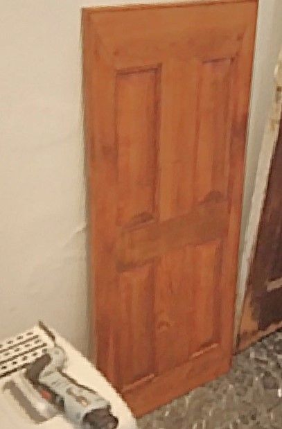

Brought Door #3 upstairs...and sized the divider that goes in-between the upper and Lower sets of doors...:TwoThumbsUp:

Door #3...
Waiting on white paint to dry...yes, the jamb was THAT far out of plumb,,,1" tapers to 1/2"..in 43"...
BTW: I asked the Boss how she liked this....she actually liked it...Filler strips, will get stained...

90 minutes, to get Door #4 installed...getting slow in me Dotage?
Kind of crowded in this spot...
But, that will do it for this Project...thanks for looking in!
