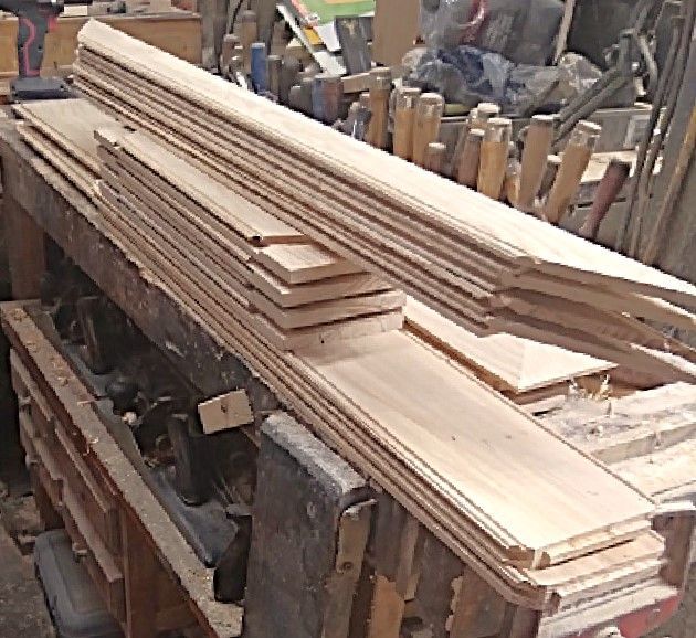

Lumber Run, today....1 x 8s and 1 x 4s...about 20' each...cut down to fit into the Chevy's trunk ( barely)  and all planed down to 3/4" thickness....to be parts for Door #3 and Door #4....

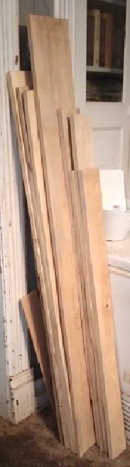

New lumber, stashed and waiting..
And..the 20" that didn't fit off of that LONG plank...
3/4" x 8" x 20".....either a top or a bottom rail...we'll see..

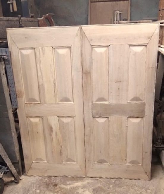

Two doors...
Just a 1/4" under 43" tall....and each door is 19" wide...Will start the clean up and Witch's Brew tomorrow...

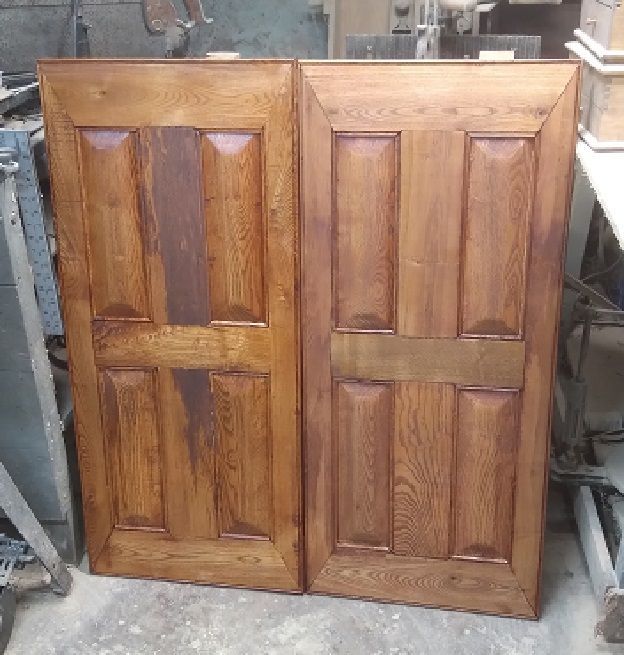

Witch's Brew, Gunstock version..
Will be trying to varnish these 2 doors...today....we'll see...Film @2300hrs

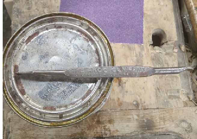

Needed a serious "Can Opener"...
For the "Olde School Types" out there, this even has a screwdriver end...The ARCO Company..

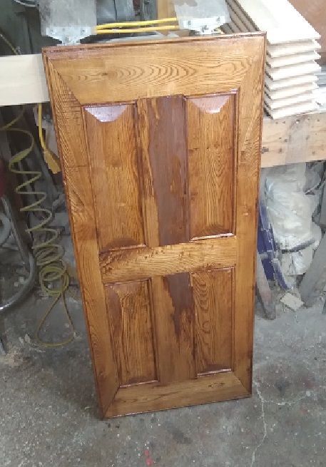

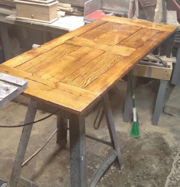

Door #2 was first..stood it up and varnish the "inside" face first, then rotated to do the show face..
Dark streak is Sap Wood...aka ..SPONGE...will give it a second coat later...
Knees did NOT like all that bending over..so, if I can't go to the Mountain...
I can do things this way...later, after this inside face has dried enough...I can flip it over, and do the Show face..
Have Laundry Detail after a while....will see how they look then...

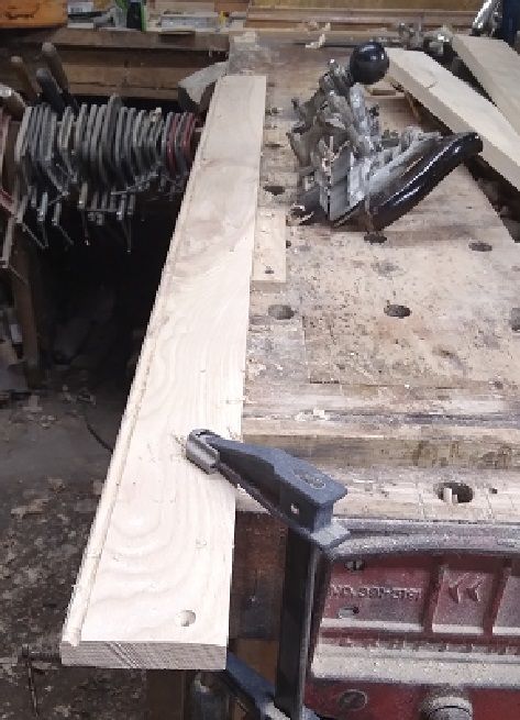

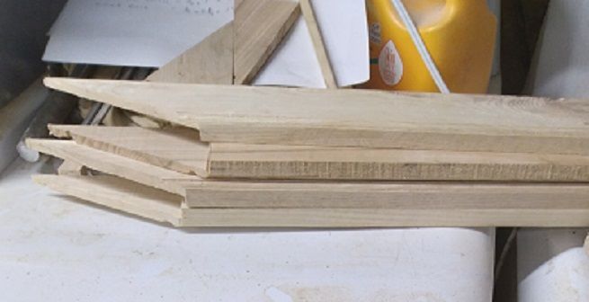

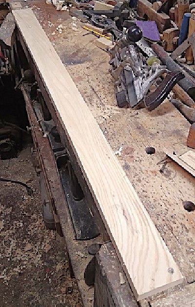

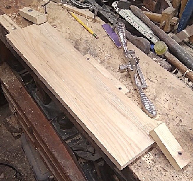

3 out of 4 needed to be resawn on the tablesaw, set to 3/4" between the fence and the blade...then pick one..:ChinScratch:

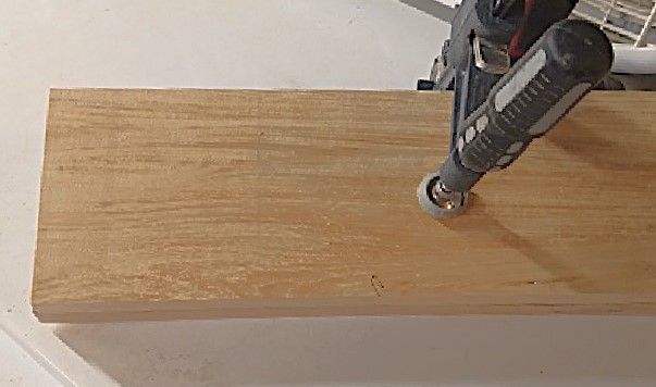

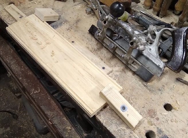

Yes, that IS a screw there...one at the other end as well....Stanley No.8c to flatten things down...:Cheer:
The reason I am not worried about those screw holes?:WonderScratch:
Is that they are in the area that will be mitered off..:OldManSmiley:

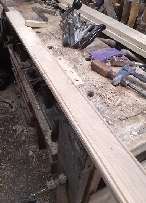

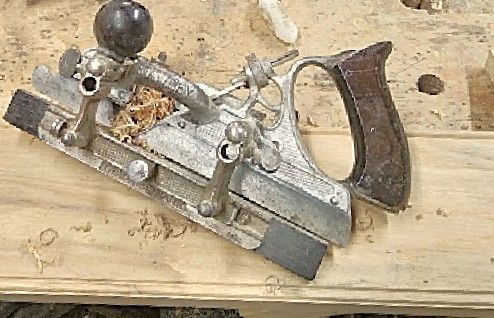

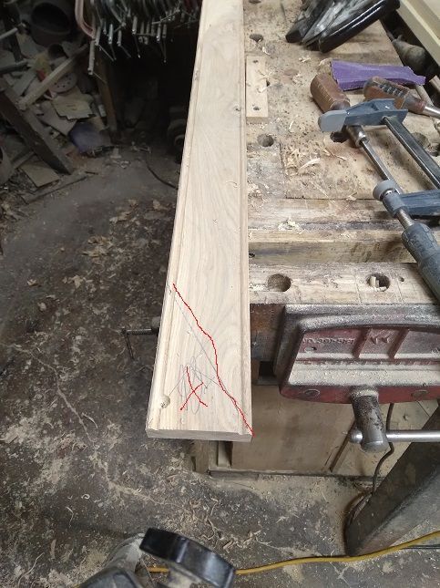

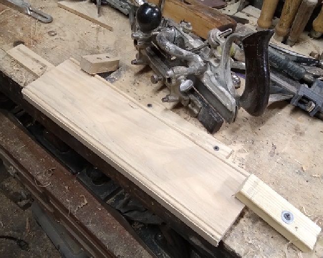

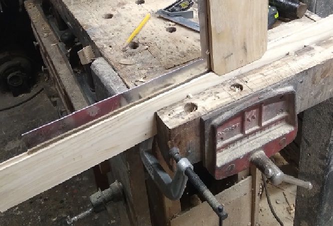

First bead, and..:ChinScratch:
2 beads done..only 6 more to go..:Tapping:
Speed bump?:DevilLaughing:
8 beads are done..:TwoThumbsUp:

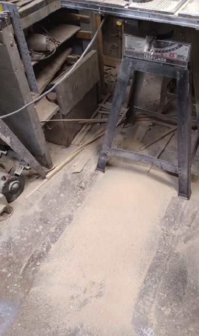

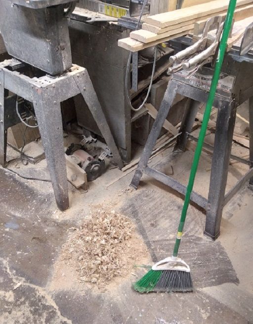

Decided to sweep the mess up..:SaluteandRun:
Was a very messy morning....:JawDrop:

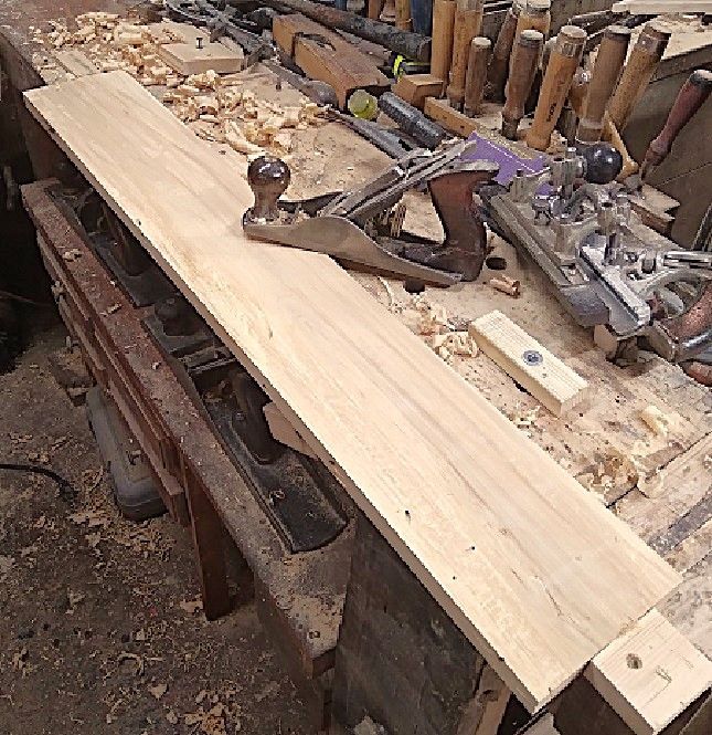

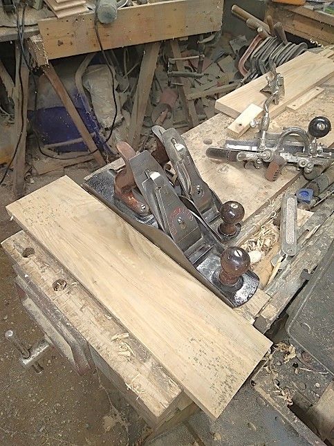

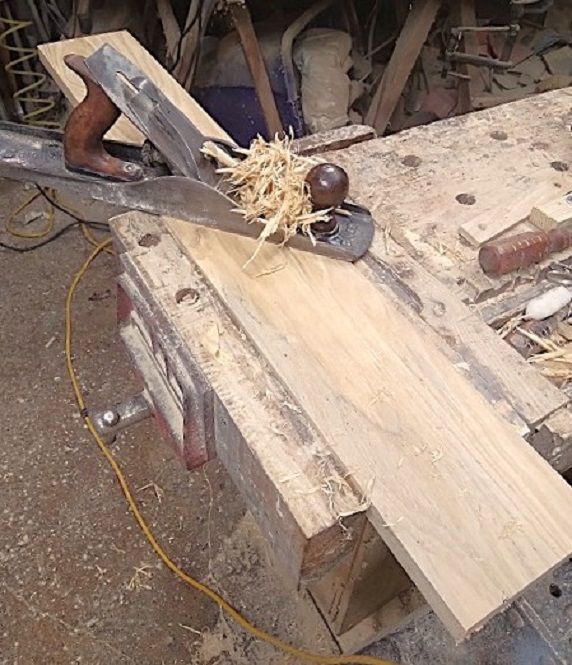

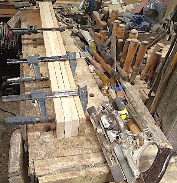

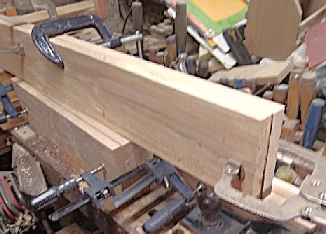

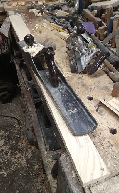

Monday Update...the blanks for the top/bottom Rails needed a wee bit of work..BEFORE they even saw the Stanley 45..
Cupped, bowed, and about everything else..:ArguingSmileys:.These 2 planes, plus a couple of 80 grit sanders...to BOTH faces...takes a while...:Tapping:
Jig needed adjusted...Best looking face gets the beads...:TwoThumbsUp:
Got 2 rails done on Monday...before the back and legs said it was Quitting Time...:KooKooClock:

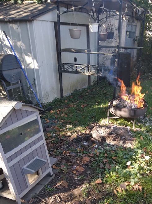

So, this morning....Finish up the other 2 rails...hauled that big pile of shavings upstairs to the Fire Pit..:MachineGun:

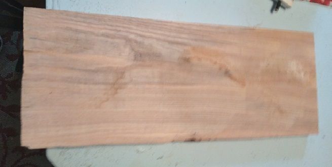

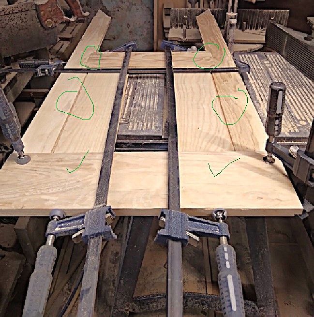

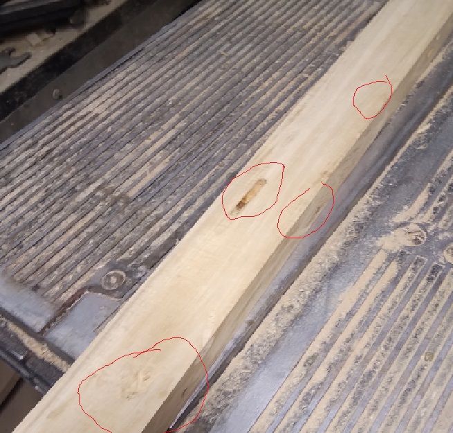

Then hauled a few 1 x 8s to the shop.:SaluteandRun:...out of the 3, I could only use 2....the 3rd one?:ArguingSmileys:
Imagine an entire 1 x 8 looking like this..:JawDrop:..the other 2 weren't too hateful...:rolleyes:
Found enough "good wood" for the 2 center stiles, and..:Cheer:
The 2 Lock Rails...and that was it for this morning....everything is clamped up to allow things to season a bit, hopefully stay flat....Tomorrow?    Either mill more beads, or...start some joinery....:WonderScratch:

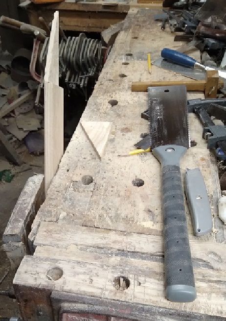

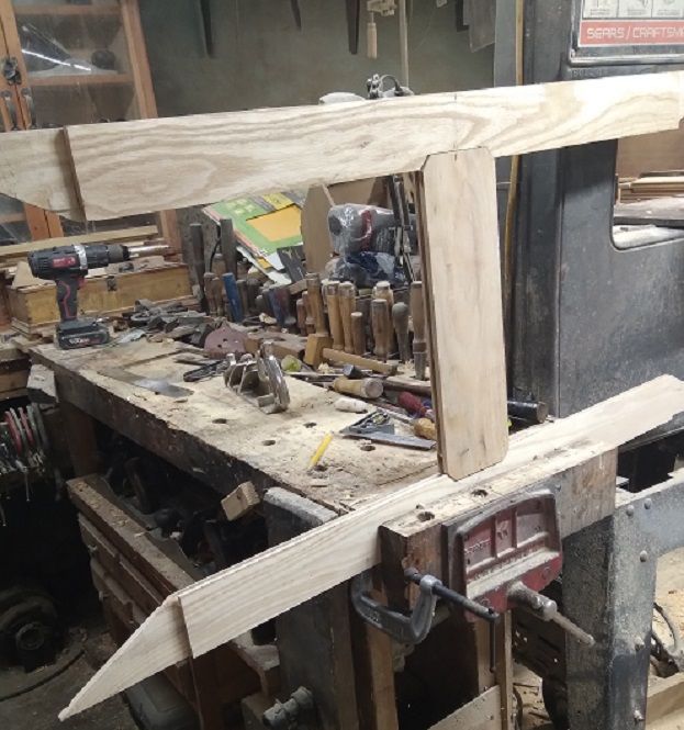

Laid out a few miter cuts, instead:TwoThumbsUp:
First pair..laid in the wrong direction..:ArguingSmileys:.and barely nicked those counter sunk screw holes...:BangingHead:

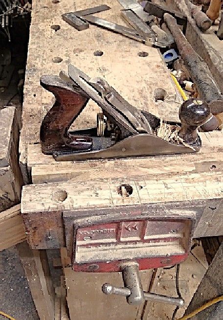

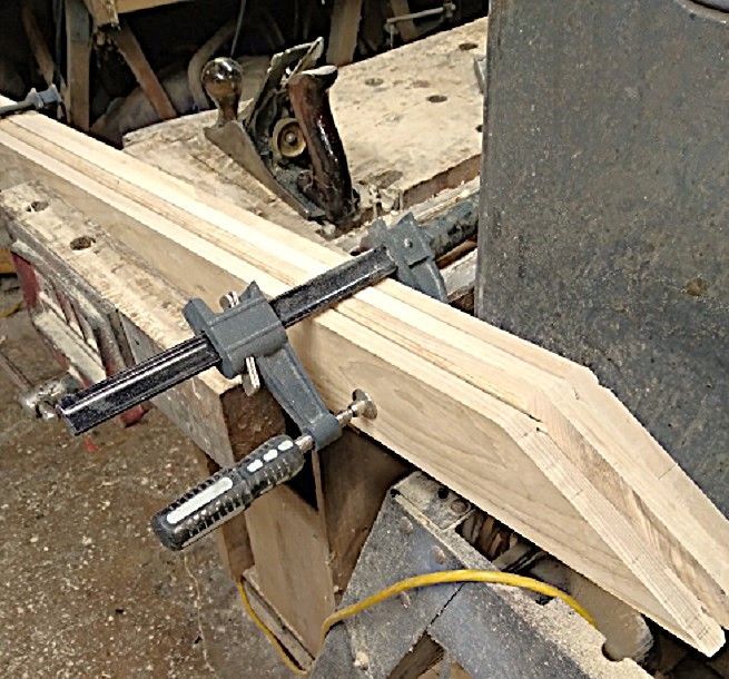

Adjust the cut lines back enough, to remove them...cut was made on the bandsaw :JawDrop:Then a No. 3 plane was used to remove the saw marks...laid out all 4 stiles..trying to make them all match each other..:ChinScratch:
At BOTH ends..:TwoThumbsUp:

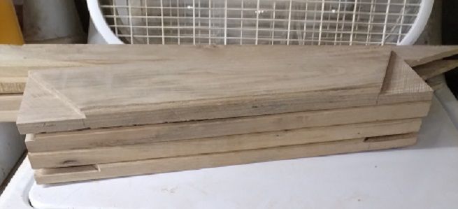

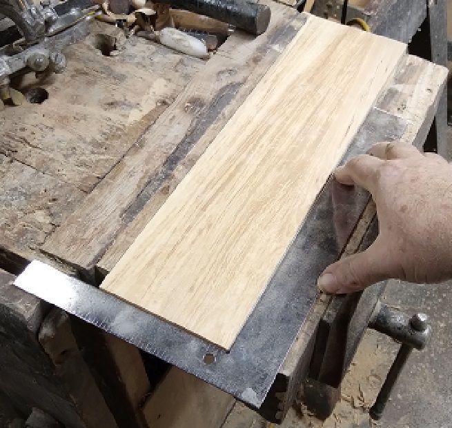

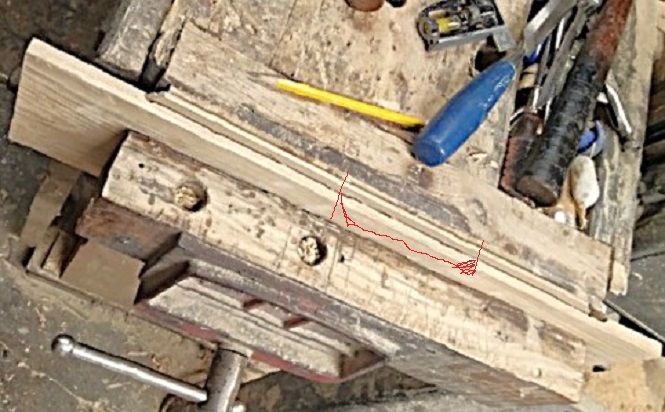

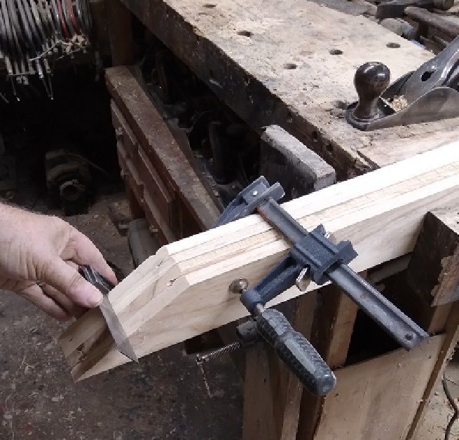

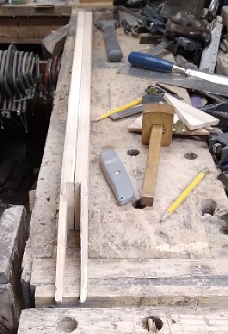

So far, so good?   But, these also need to be half laps...Marking gauge to lay out the cuts needed...Mitersaw to make the 90 degree cut down to the lay out lines..:OldManSmiley:.

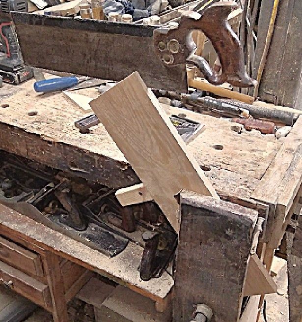

But, there was 2 choices on how the waste was to be removed....either with a handsaw....:ChinScratch:
Not feeling quite up to doing 8 like this.:WhoMe:..so..the next 3 were done at the bandsaw...:JawDrop:
LinenClosetDoor3MitersBandsawnversion.jpg.d2f85191e28408789f0f418a2e7f6de4.jpgAnd, as long as I took my time, and kept the stile perfectly vertical in the cut....wasn't all the much different ...:WonderScratch:
From the one done with the handsaw...

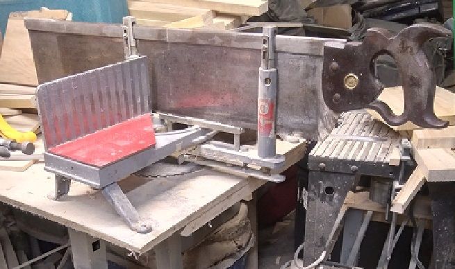

Well....Involved the top & bottom rails....Was going to try the half lap with just hand saws..even had the depth-stops on the Mitrebox set up,,:OldManSmiley:
Came time to remove the waste...:ChinScratch:
No matter which saw I tried, they all wanted to grab.(Grab-astick?)..was taking way too long..:ArguingSmileys:.so..

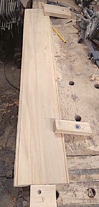

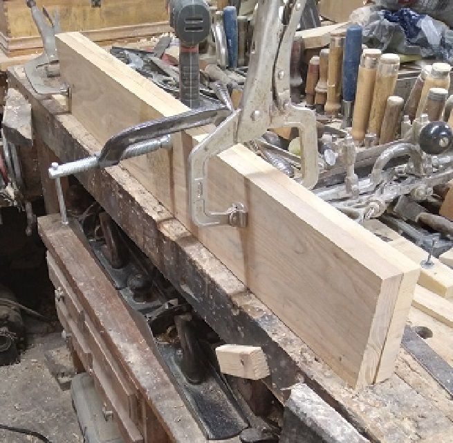

Task #4 this morning...took a bit of time to do...First..they needed planed flat...:OldManSmiley:
Then jigged to the bench..:SaluteandRun:
And then smoothed down, to see which face of each plank looked the best...then add a couple hold downs..:Cheer:

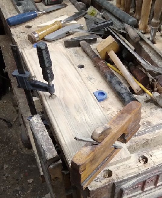

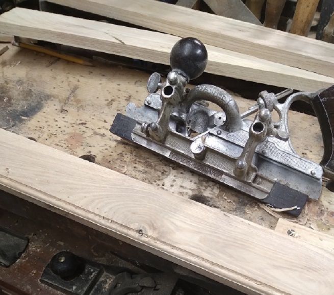

And start running the Stanley #45 to mill a bead...pausing every now and then...:ChinScratch:
To clear out any jams going on...:ArguingSmileys:
Finally..:TwoThumbsUp:
Last bead is done...and so is Task #4...:Cheer:

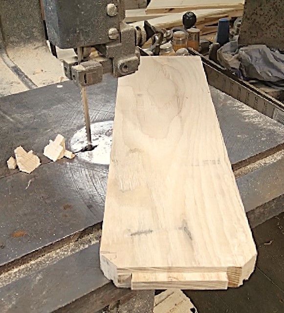

Task #5 was in 2 parts...:Tapping:

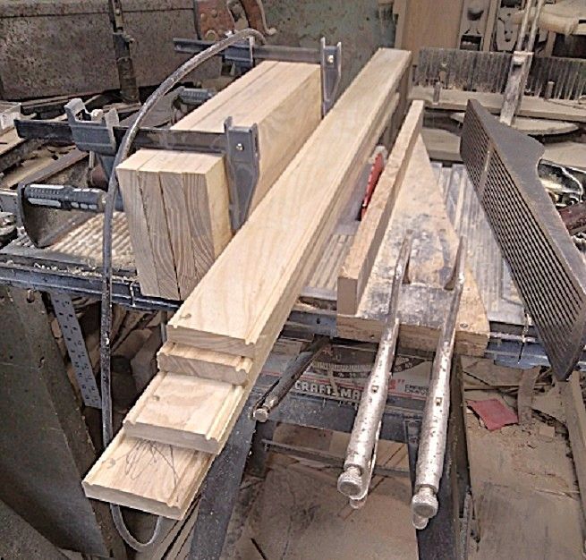

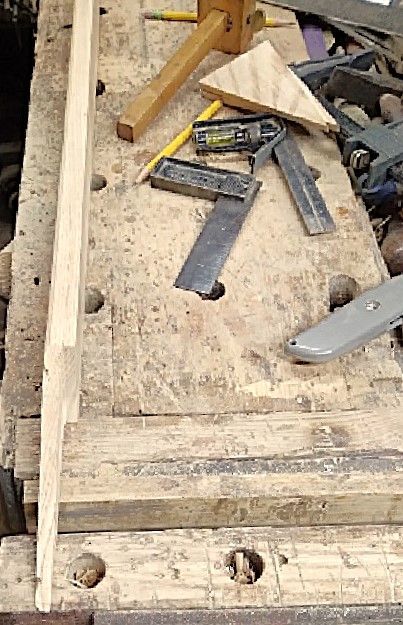

Part #1:  Tenons.   Used the 6" combo square to set depth of cut and the distance between the fence and the saw blade..
about four nibbles to each face, on the 2 Lock Rails, and the 2 Center Stiles...:TwoThumbsUp:
Part 2:WonderScratch:
Same Combo square to lay out a couple cut...on the bandsaw..:JawDrop:
And each corner gets a miter cut, and the tenon is trimmed down to size:OldManSmiley:

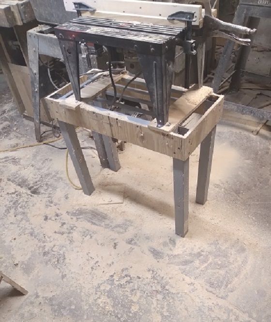

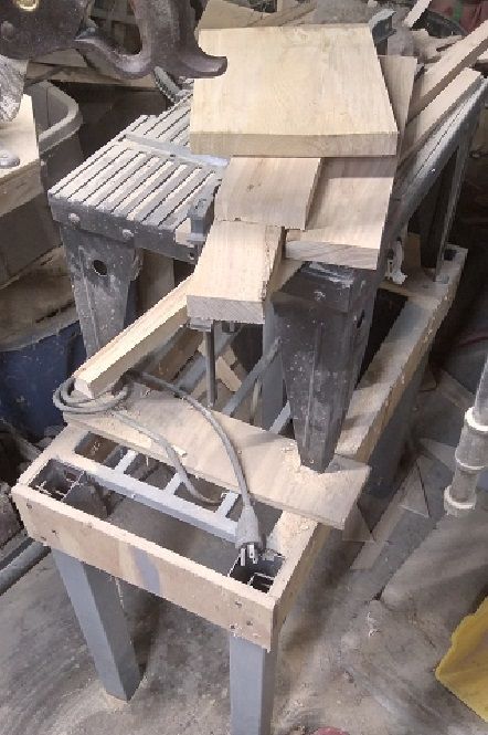

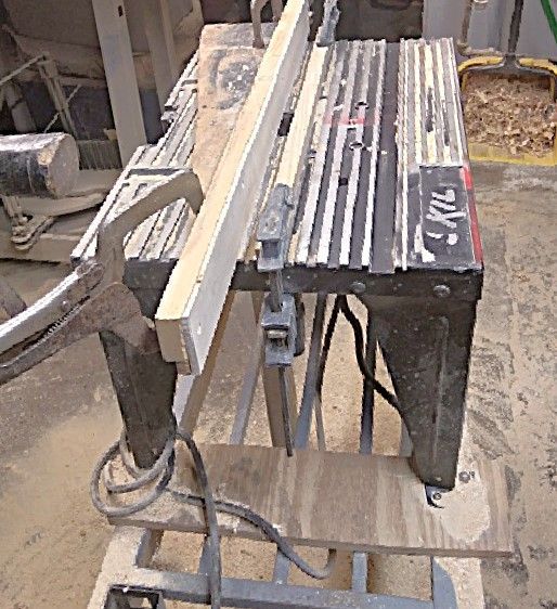

Router Table::JawDrop:
New guide strip..and a new "face" to the Fence ( covers up the hole where I buried a bit):TwoThumbsUp:
Load, and make a BIG mess..:DevilLaughing:.but..
All the parts for 2 Doors now have the grooves they require.:TwoThumbsUp:..which leaves Sunday's antics..:ph34r:

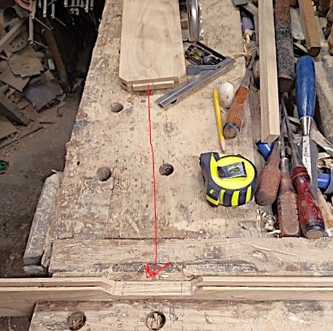

Mortise and tenon work...."Wir haben zu arbeiten":SaluteandRun:
This is how it is supposed to work....Bandsaw cuts away the waste..to fit the tenon...chisel to chop down 1/4" deep to house the tenon...:OldManSmiley:
And hopefully it sits square..:OldManSmiley:.this is the Lock Rail into the Stile joint...repeat for the other Stile...:TwoThumbsUp:

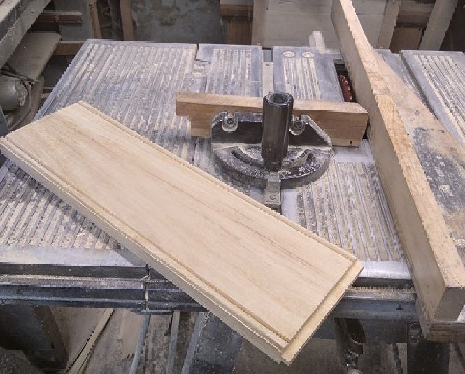

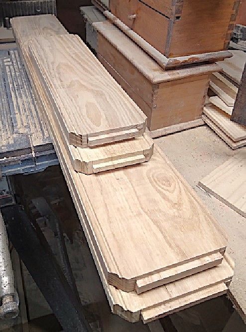

Tested out one of the raised panels..:Tapping:
Hmmm, we have work to do ...:SaluteandRun:

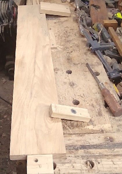

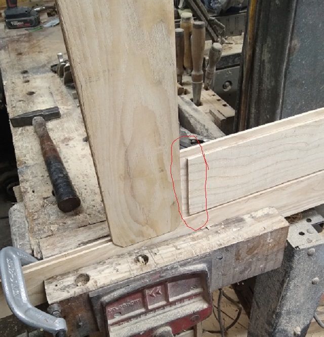

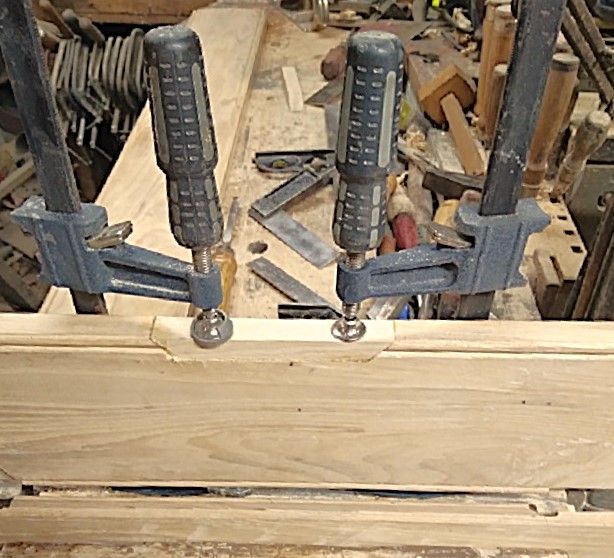

Came time to work on where the center stile meets the top/bottom rail....Mortise was SUPPOSED to go here..:WonderScratch:
The edge WITH a groove.....however..:PullingHair:
NOT this edge!:ArguingSmileys::ArguingSmileys::BangingHead:
Added a patch, waiting on glue to cure, will re-run the Bead, and try to blend things in...This will be the bottom edge of the Bottom door,,,now.:PullingHair:

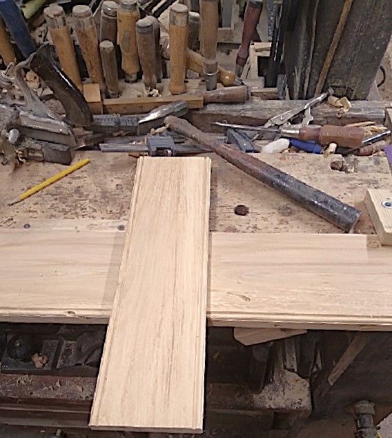

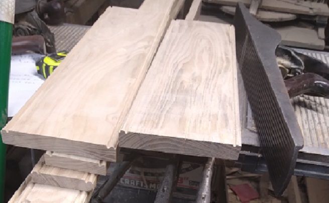

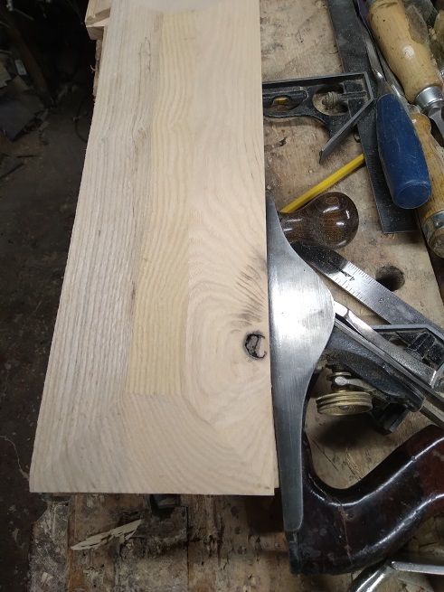

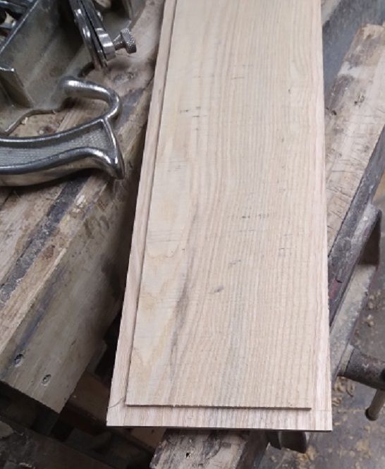

Raised Panels:   need thinner rebates, so that they will fit IN the grooves, and NOT break out the beaded edges...
We have ways:ph34r:
Craftsman #3720 (Sargent #79)  to remove the excess wood..even across the grain..then flip this over..:ChinScratch:
Run the #3 plane all over the front of the panel(  this one will be "FUN":DevilLaughing:)  then a dry fit of what I got done:ChinScratch:
That will be the Top Rail on this door, still needs its Mortise done...Center rail needs a half lap where it crosses the Lock Rail...2 raised panels were fitted..:OldManSmiley:
