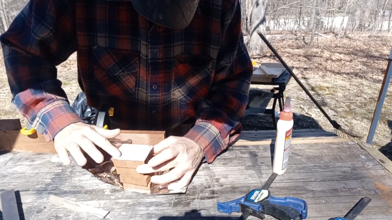

So I grab the glue and start the process of gluing things together.

This is repeated until they all have glue on them and are lined up.
Then they get the clamps.

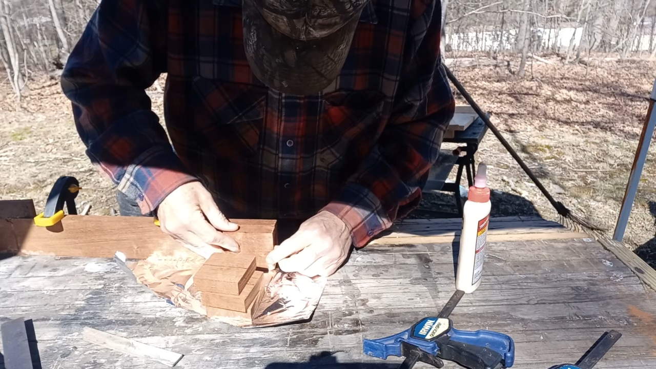

Now if you remember, I cut the neck blank to length, and had an "offcut".
I now place it on my bench hook, and start cutting the segments to create a stacked heel.
I use a stacked heel and a scarf joint for a couple of reasons. Firstly, it's easier to find a long 7/8" thick piece of hardwood than it is a 3" thick beam. And secondly, when a neck blank is cut out of a larger piece there is a lot of waste left behind.
I "rinse and repeat" the process and cut enough blocks to create a 4" deep heel.

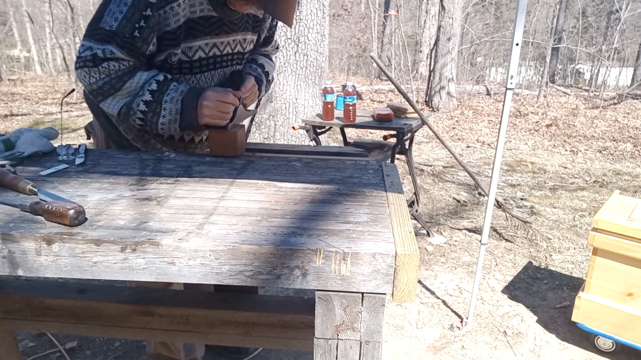

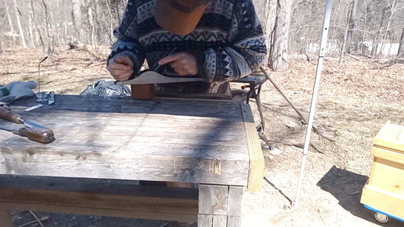

Once the stacked heel is dry I need to scrape off all the dried glue squeeze out so my plane blade will take much less of a beating on it's freshly honed edge.
So I take a sharp, fat chisel and go to town on it.

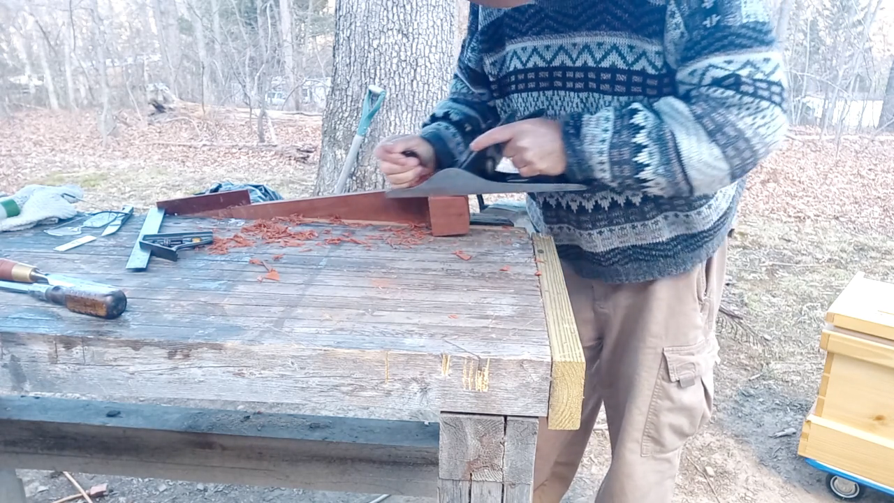

And speaking of a freshly sharpened plane blade.....
Edited by Handfoolery

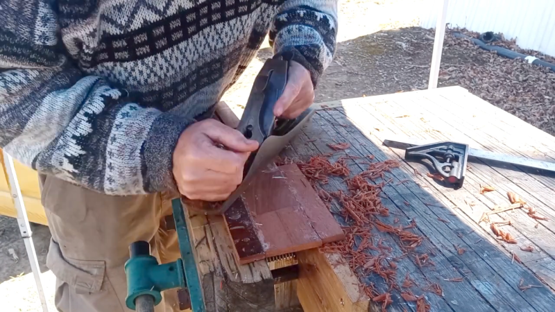

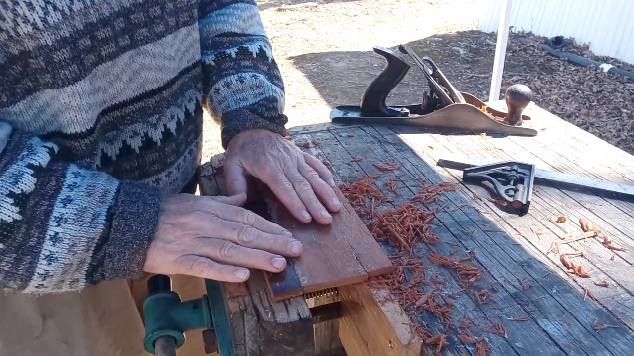

Need to mark the heel in prep for squaring it up.
Then it's on to the aforementioned hand plane.

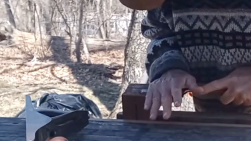

Checking for square.
Reorient in the vise....
...and trim the sides.

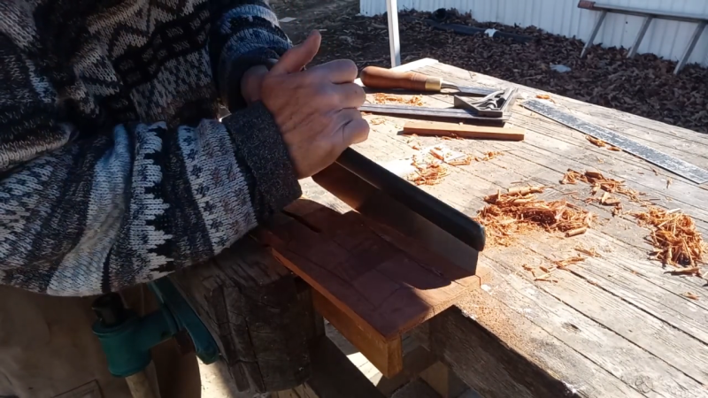

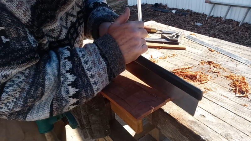

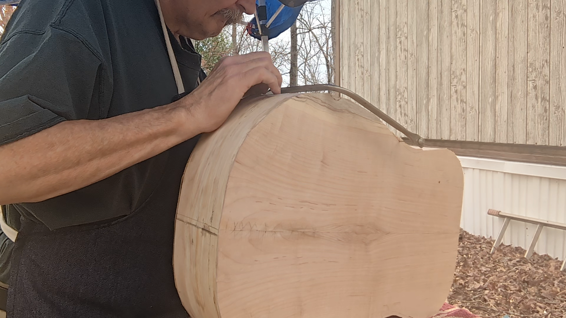

Next on the agenda, I need to trim the top and back plates level with the sides of the guitar. I start with a fine tooth backsaw.
I know I could have used a router and a flush trim bit to do this work, but I don't like things that move at 6,000 rpm; it doesn't leave much room if i go "oops". I only use power tools if it makes sense to me.
