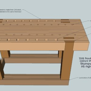

So, what style is it going to be?  I just got Schwarz's workbench book out of the library again.
This looks a lot like the bench I built. Looking forward to more on this. I know you have designed this to the nth degree but if you want to look at mine it is in this blog.'
Thanks much for pointing me at that blog @Gerald The bench design I have a pretty decent handle on but there are some great ideas there for the drawers that I am going to use.
@kmealy This one is going to be a left-handed split top Rubou with some modern modifications.

I have seen  that some people make the crazy thru tenon plus thru dovetail leg to top joint by merely laminating strips along the edges and on the legs.  Seems like a good way to do it to me.
I have seen that as well and aesthetically, I think it looks nice.  That said, I am not opting to do this on my bench because I am planning on installing a tail vise and I cannot for the life of me figure out how to keep it from pulling the 3 laminated sections dovetail, dog hole, and tenon away from the rest of the top over time.  The tail vise can put a lot of stress on those joints and it probably isn’t as big a deal as I am thinking it is but I am opting to run solid laminates.  I suppose in 200 years or so someone can look at both options and let me know which one held up better lol.
