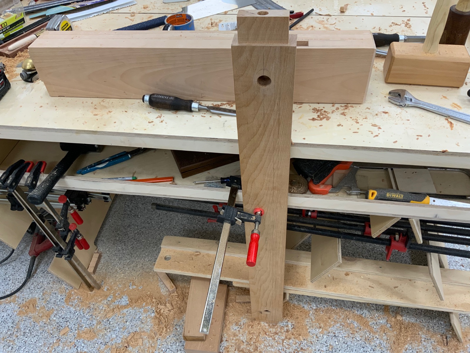

Made a little progress today. The back rail that goes between the leg assemblies is pretty much complete at this point.
The tenons are cut and fitted and the knockdown hardware has been fitted. For the record, this is a painful process.

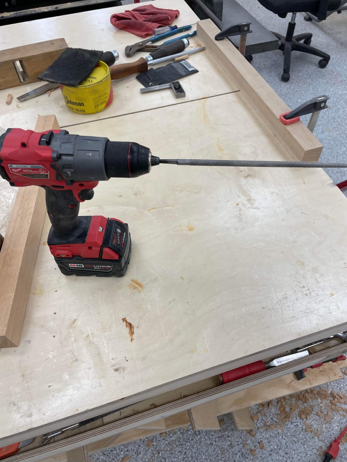

If you are off at all the knockdown hardware will not thread and I don’t have a drill press or hand drill that is accurate enough for this operation….Enter the round file…  There is more than one way to skin this particular cat and after a brief and savage session with said file, the bolts will thread into the knockdown hardware.  I think if I was to do this again, I would drawbore and pin all of the lower assemblies and just deal with the fact that the base assembly is going to be heavy.

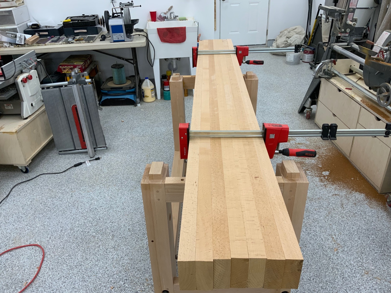

  • So I was able to glue up the back part of the workbench top yesterday and today it is looking good…ish. Because of the sheer size of this thing and the awkward placement of cauls and clamps there

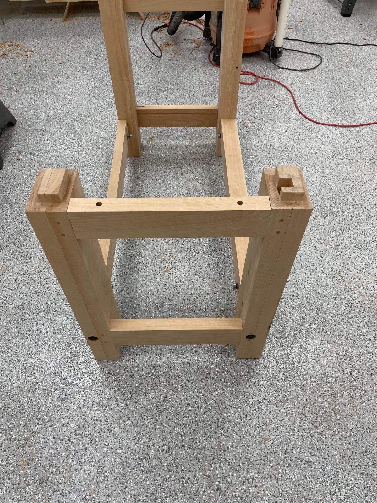

A little daily update, wrapped up the front and back rails.
These were a bit of a challenge and the knockdown hardware makes these trickier than they need to be.
That aside, the base goes together nice and square and once the bit for the vise screw comes in I will be able to drill that out all the difficult stuff will be done.  From there it is just scraping, sanding, and final assembly of the base.

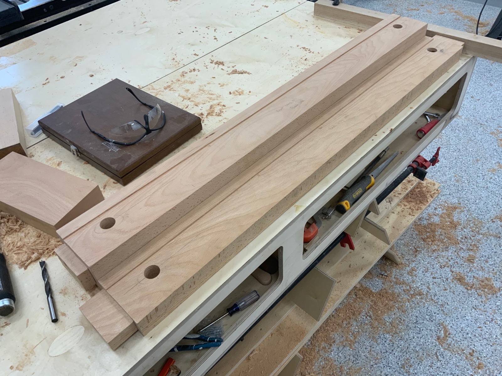

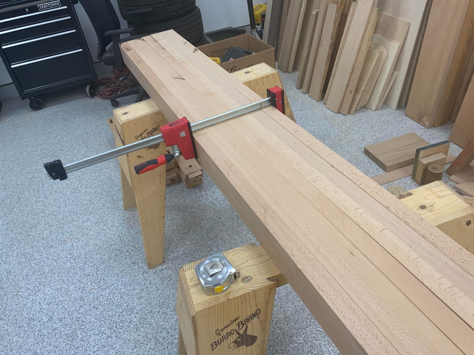

Got my stock for the back part of the top ripped to length today with visions of getting it milled down and glued up today.
This was not to be….

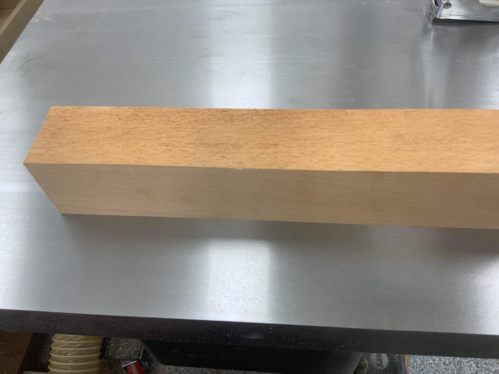

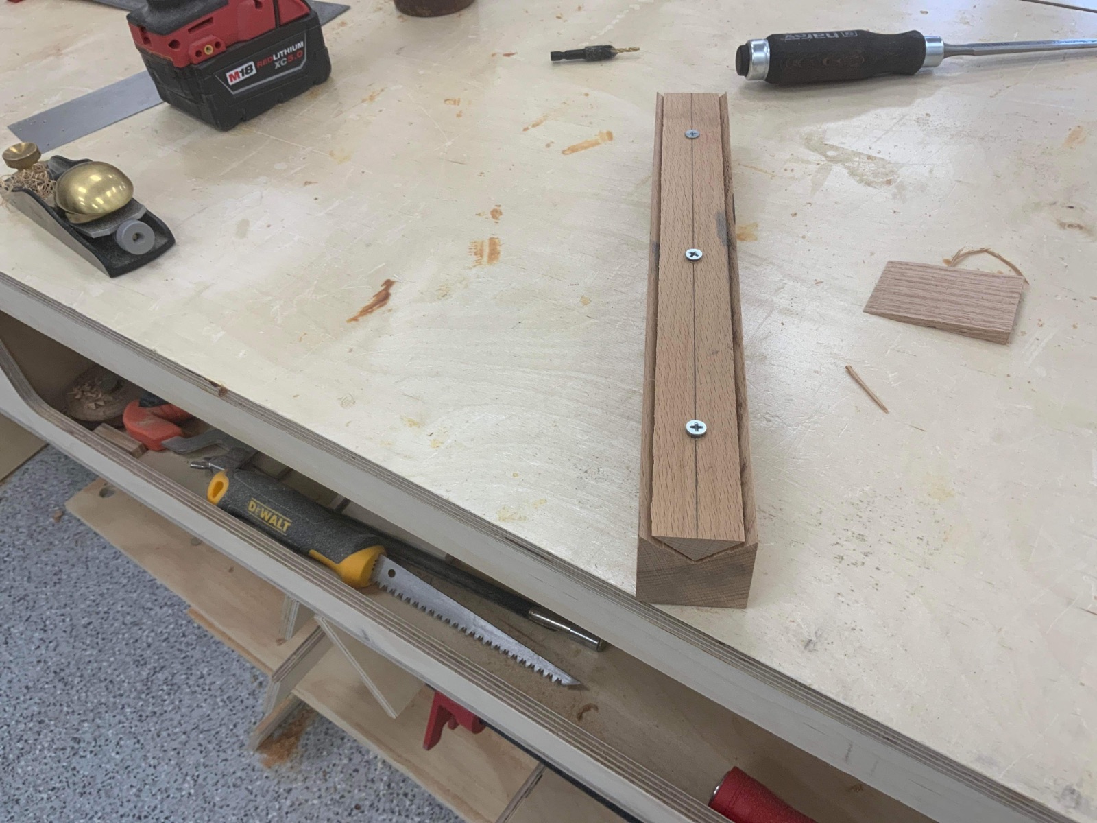

With everything cut to 4 1/4” I need to join it, thickness it, and cut to final 4” so I ran the first piece through the joiner and it left a nice little groove.  Something hit the joiner blades and left a nice little divot. So I have been learning about sharpening joiner blades.  And since I didn’t have anything to sharpen said joiner blades with, a sharpening jig was devised.
After some trial and error blades are sharp, and set, and I ran a test piece which I am pretty happy with. (joined face is down)

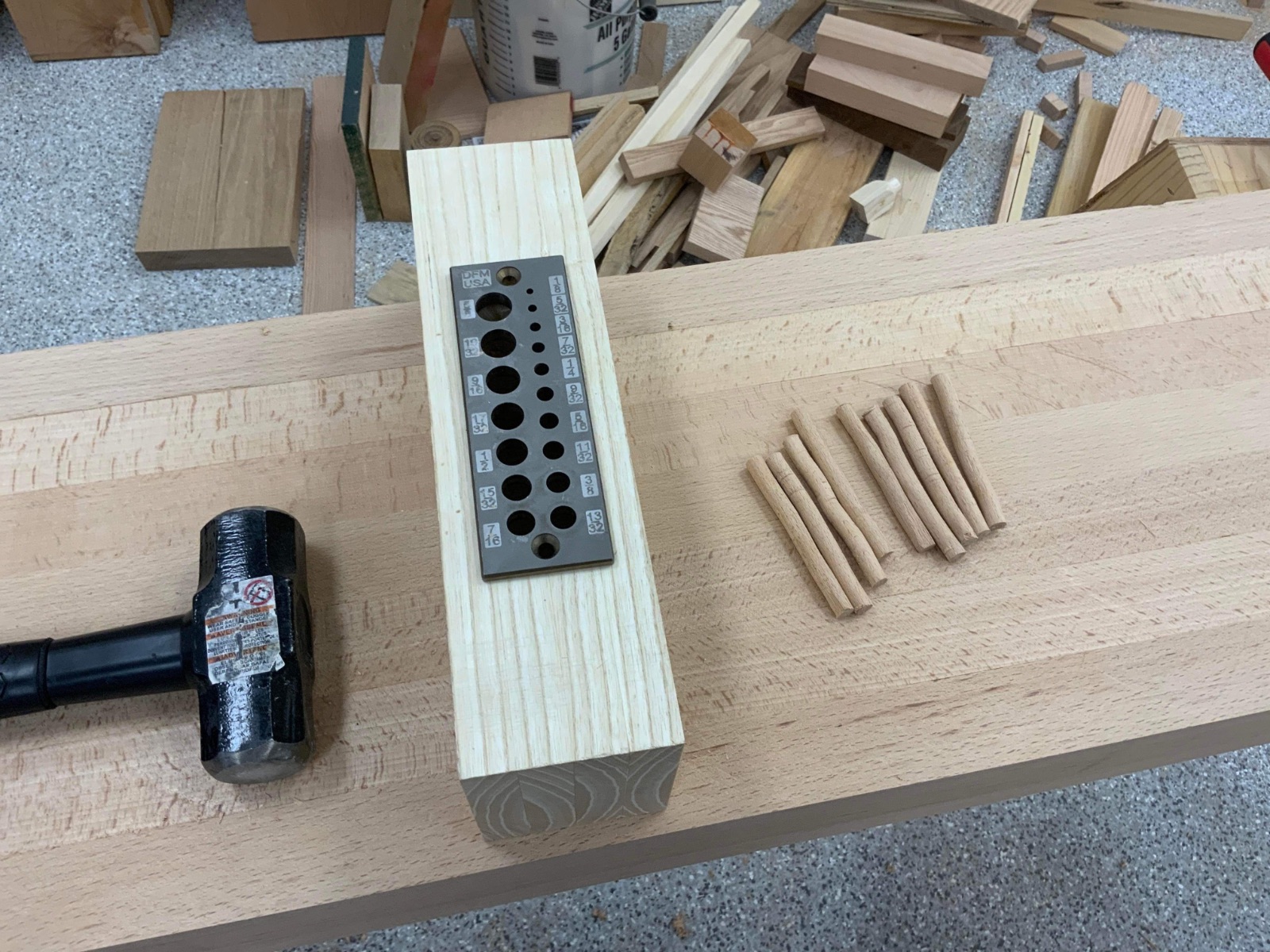

Back on the bench topic, the base is now ready to assemble… but not so fast self.  If you are going to drawbore and PIN those joints, you need some dowels…  Conveniently, the blanks for the back part of the top make for a nice pounding surface when clamped together and sitting on a sawhorse.   Back to putting square pegs in round holes  :)

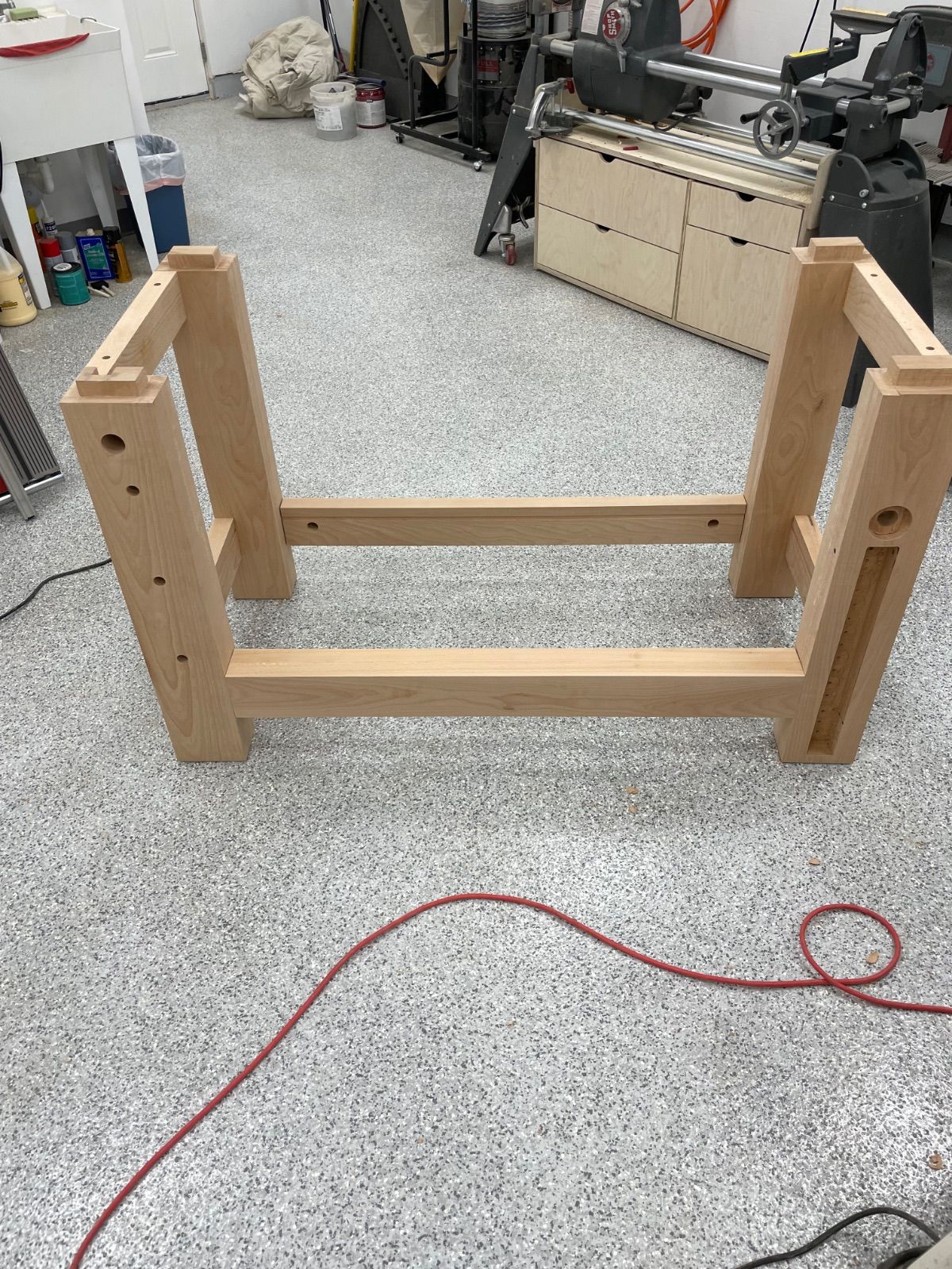

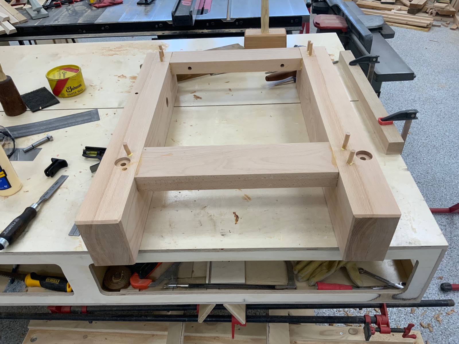

The right leg assembly is sanded, glued up, and pinned.  Pretty sure that isn’t going anywhere

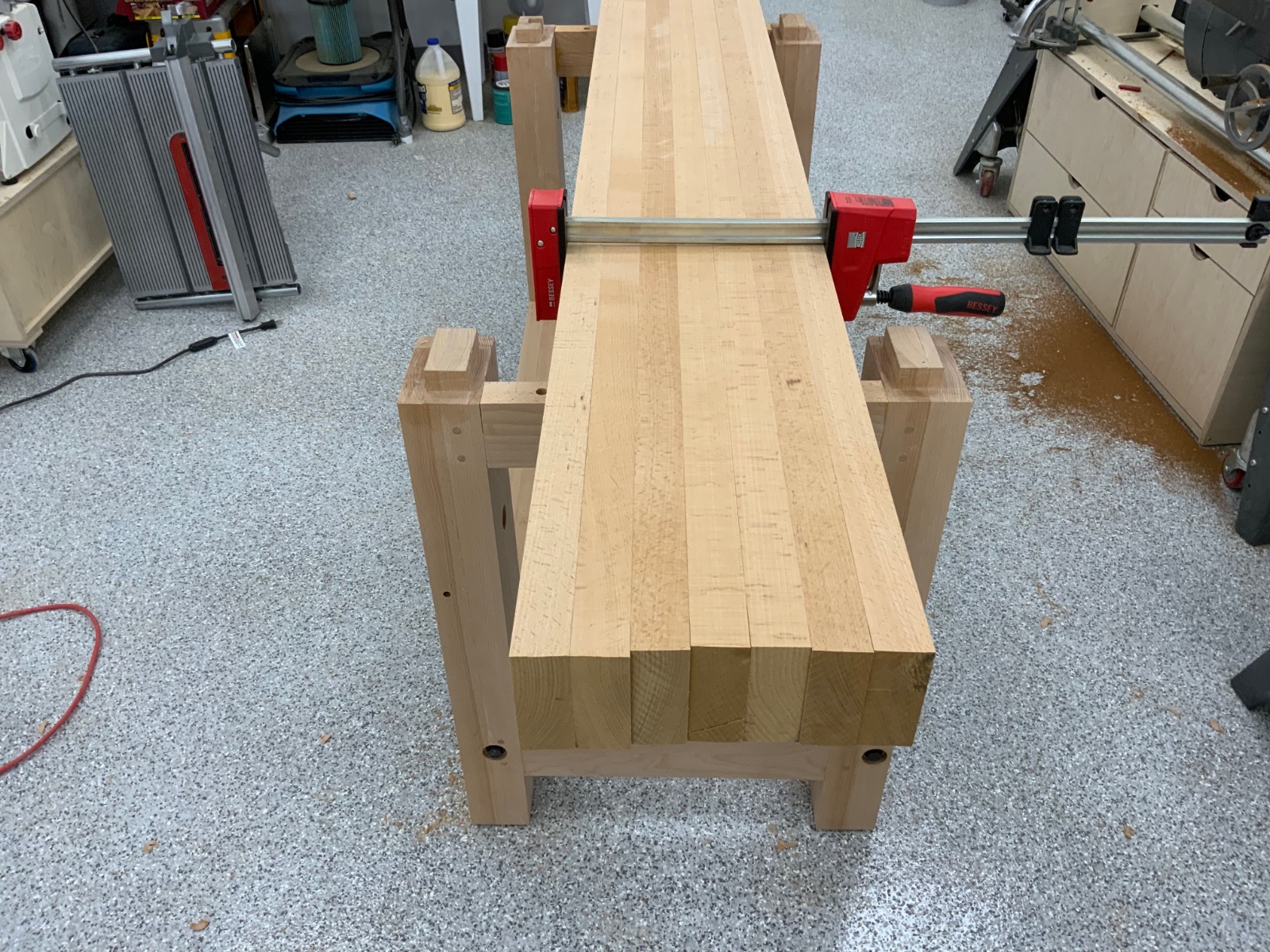

Test fit of the whole base assembly
Looking good. See you are using Draw bolts, I used those too and made the attachment of stretchers easy and can be broken down If I am still able to lift the top. Well no actually that would be someone else and my next move will be the eternal one.
Funny looking at prices in estate sales I suspect the family will just about give it away when the time comes, unless I sell it before that time.

Yeah i am going to have to finesse the Draw bolt fitment a bit or just drawbore and pin it, that is still an option
I decided to use the knockdown hardware after all, I had a moment of inspiration and chucked a round file in a drill.
That was enough to finesse the final fitting of the knockdown hardware and almost took less time than it did to tell.
Pictures for posterity in case anyone runs into this in the future.
Had a slightly easier time of things today, with the joiner actually joining again, I was able to get the stock for the back part of the top milled down to spec and ready for glue up which I will probably get to after dinner.
I will need to use some of the off-cuts to make some cauls but the top is looking very flat already.  If I can keep it like that, it will save me a lot of planing and scraping in the final steps.
