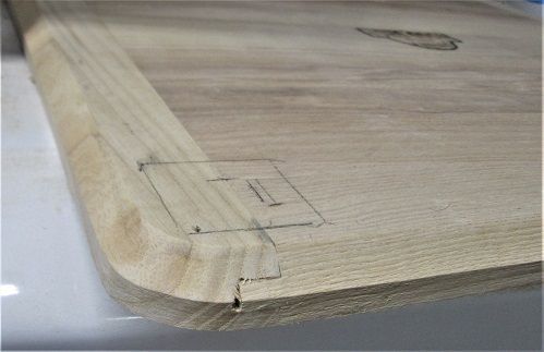

    Work area... Layout tools.. First chops... Clean out the chips, go back through 2 more times...until I THINK I am deep enough... Took about 20 minutes...rep

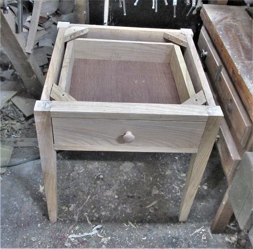

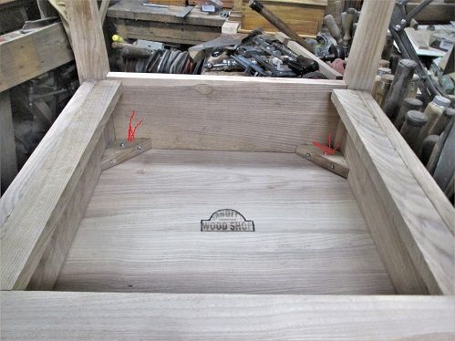

Bottom edge of the top..got a visit from..:MachineGun:

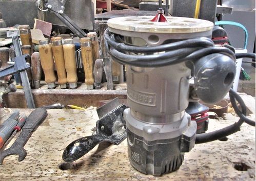

And, yes I used that No. 80 scraper....drawer front needed a wee bit of work, before the knob could be installed..:TwoThumbsUp:
Tried to match up the grain between the front and the knob...top was also installed onto the base...:ChinScratch:

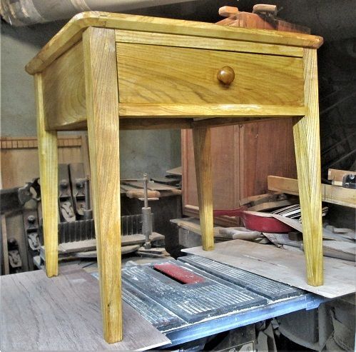

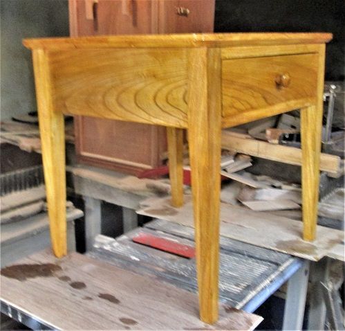

PIP #1 (1st coat Of Amber Shellac)
A little rough, yet shiny....#2?

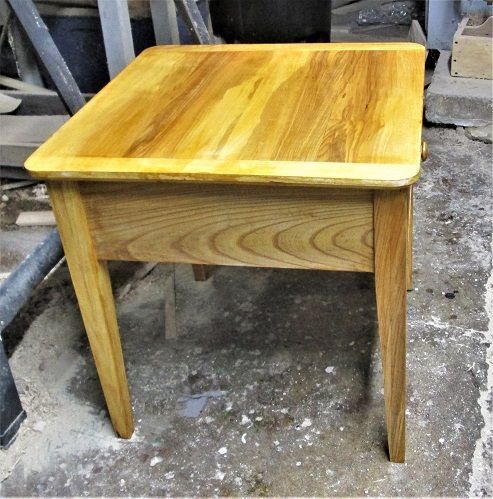

Trying to cut down the GLARE...#3
Overhead light hitting just a little too much...#4?
Yes, I did the drawer, too...
Will work on it again, tomorrow...

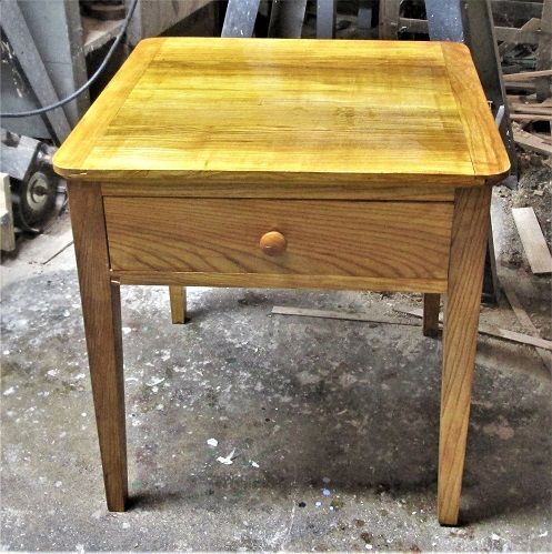

Table id now DONE! :TwoThumbsUp:Needs to head upstairs and go sit in the Gazebo....:SaluteandRun:
Rubbed the varnish out, after a hand sanding....time to show off a little?B)

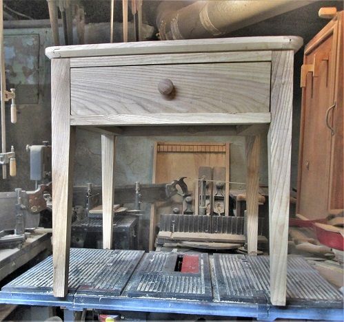

From the front...only stands 22" tall, BTW..
Was trying to get the grain to "wrap around" the corners...came close...
Simple wooden knob, as this is supposed to be in the "Shaker" style...

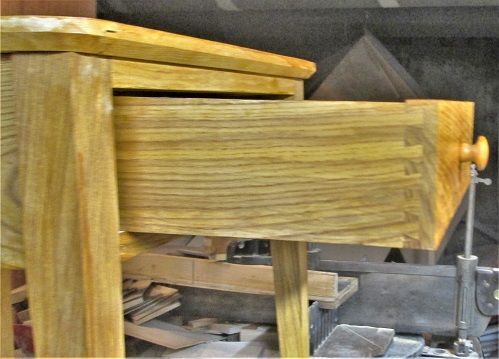

Someday, I just MIGHT get the hang of doing these dovetail thingies...:OldManSmiley:

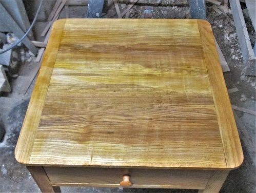

A view from the "top"?
While the top IS 7/8" thick..a beveled edge can give it a thinner, lighter look..
