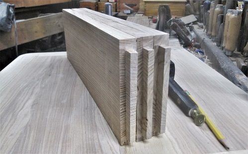

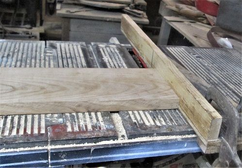

Once I laid out what I was going to remove....leaving a 8mm tenon, about 1/2" long...set the fence, and blade height..:ChinScratch:
Last pass each time, is with the board against the fence....:OldManSmiley:
Then rotate the board as needed...:OldManSmiley:
Same for the other ends..:Cheer:

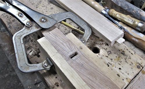

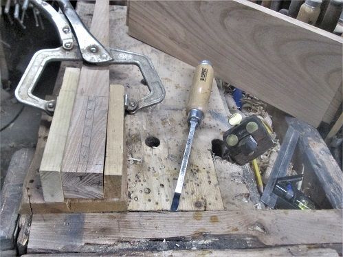

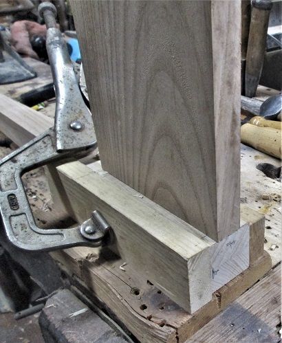

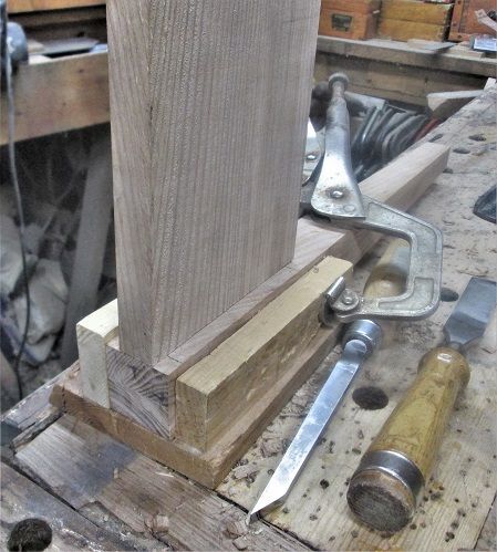

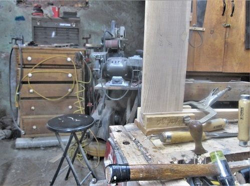

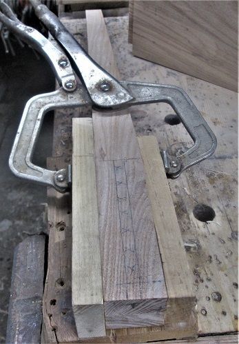

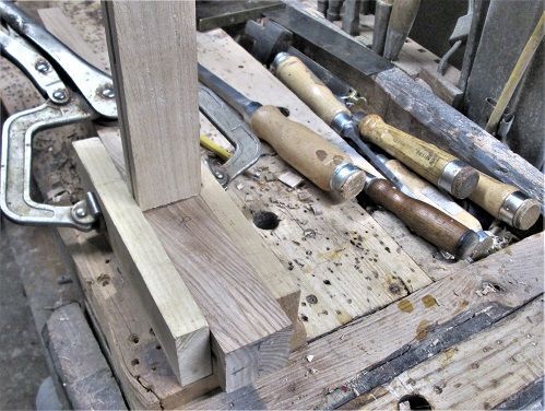

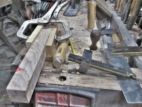

All set up for Tuesday Shop Time.   Mortise Jig set up...:ChinScratch:

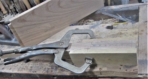

1st mortise is laid out....visegrips to keep things steady in the jig...:OldManSmiley:
Sits right on top of the bench's leg....NO BOUNCE allowed...will see how long each mortise takes...and how many Guinness Stouts it will take to recover :ChinScratch:

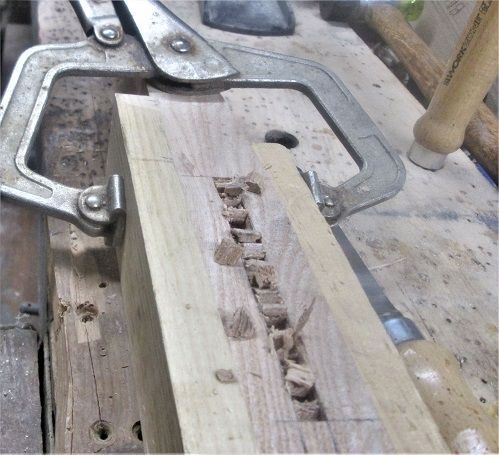

Work area...:BugEyeSmiley:
Layout tools..:OldManSmiley:
First chops...:TwoThumbsUp:
Clean out the chips, go back through 2 more times...until I THINK I am deep enough...:OldManSmiley:
Took about 20 minutes..:ChinScratch:.repeat..
Hour total time...3 mortises done...kept going..:Cheer:

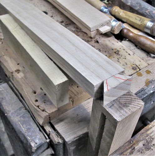

Wednesday = Work Day..2 hours on the clock...had 2 sticks to work on..:Cheer:

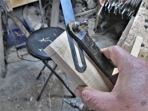

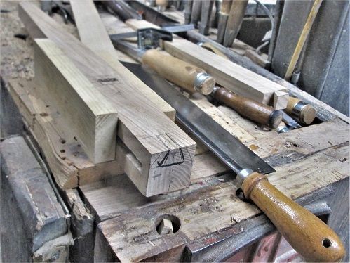

One gets tenons, the other gets a dovetail..Tail...:WonderScratch:

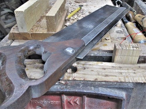

After a try with the bandsaw, went with a hand saw..and a chisel..used the tenons to lay out for a mortise..:ChinScratch:
And hope I get it deep enough..B)

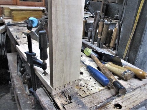

Almost..had a crumb or 2 down inside..next..mark out a tail...:OldManSmiley:
Thinking this was a bit TOO fat..:JawDrop:.dovetail, not the hand...:ROFL:

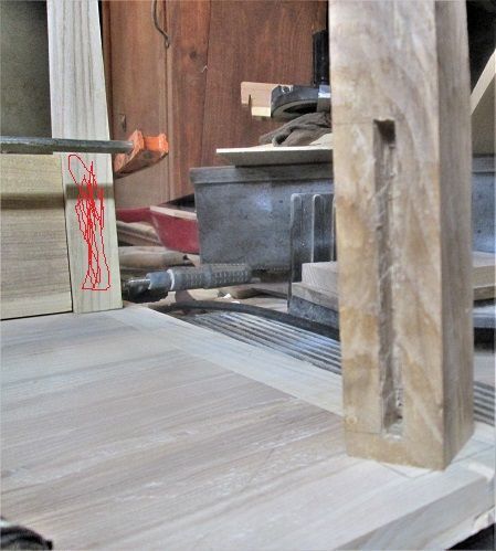

Recut to just take out the red lines...then lay out the socket..:ChinScratch:
I need to LEAVE them black lines...:rolleyes:
Dry fit...this leg is done....try a few other things for the other leg's socket:ph34r:

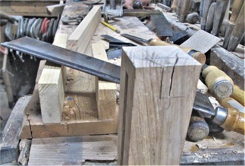

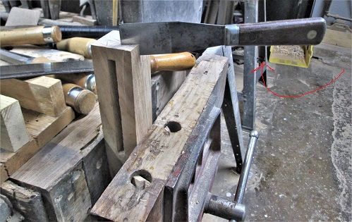

Stand it up in the vise, same saw...wanted to get back into the corners, though..:ChinScratch:
Called a Kerf Chisel...:WonderScratch:

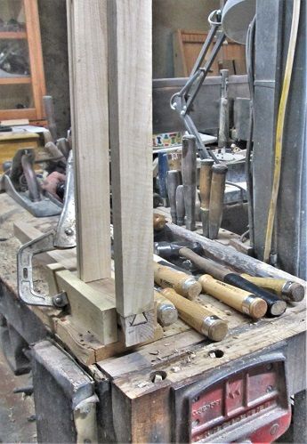

Got that all chopped out, tail fits...drawer opening parts are done..one more mortise to chop..419613878_WorkDayTHELASTMortisefitted.JPG.0b4bed7bfdc4e6cf9040abeea145e766.JPG
THE LAST MORTISE is done..:Cheer:..I can even do a full dry fit...:TwoThumbsUp:
And find spots that will need a bit of fine tuning, before the glue goes on..:ChinScratch:

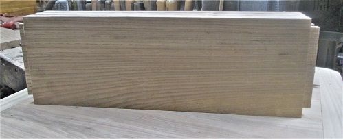

Now, about that grain direction....which would look better...:ChinScratch:

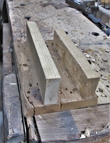

About time to set this jig aside...:TwoThumbsUp:
All those "extra" holes?   So I can adjust the jig to fit.   Along with 2 countersunk holes for the 2 screws.:OldManSmiley:

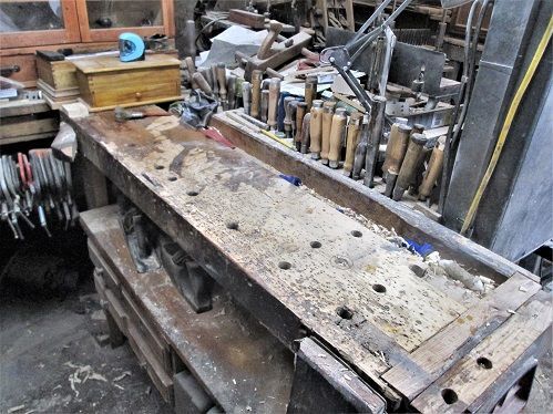

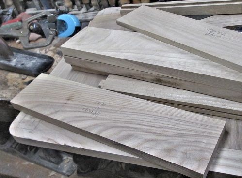

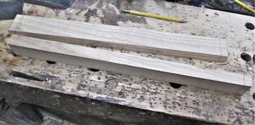

Need to move everything off the bench, move that dry fit over onto the bench...and start milling parts for the drawer...:ChinScratch:

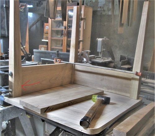

This morning....knocked all the parts apart....set the table top on the cleaned off bench...:ChinScratch:
Had details to clean up.:SaluteandRun:
.1374570271_ThursdayMorningneededtrimmedback.JPG.6650fb2dcb551bd2b6038f043b6923f4.JPG
Spots like this....sharp chisel pared this off....cleaned up the tenons, too:ChinScratch:
Spread some glue on those tenons...and mallet assist the legs into place..one leg kept trying to twist:BangingHead:

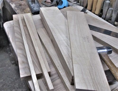

A better looking drawer front, 2 drawer sides..and a back for the drawer...which spent a little extra time at the saw...:Tapping:
Figured 7/8" was a bit too thick for the back of a drawer....resawn to ~1/2" thick..:OldManSmiley:
Milled 2 runners for the drawer to slide on..:ChinScratch:

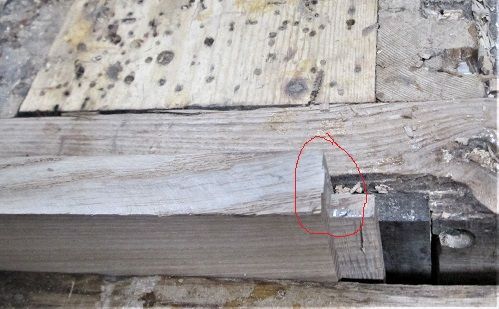

Got in to too big of a hurry...this used to be on the outside....:BangingHead: not good...reglue and clamp on the INSIDE:ArguingSmileys::ArguingSmileys:
Lesson learned....side #2 had the runner CORRECTLY installed on the first try :Praise:...will have to come back later, and scrape the outside bare to bare wood...:MachineGun:

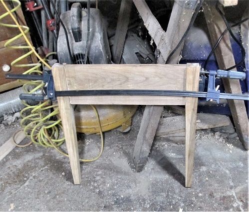

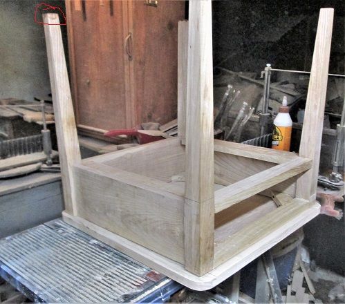

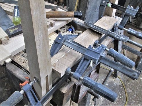

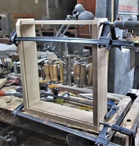

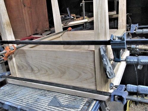

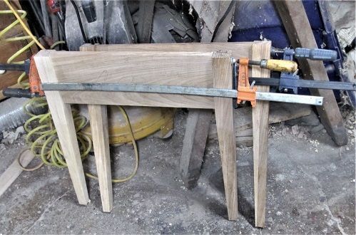

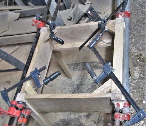

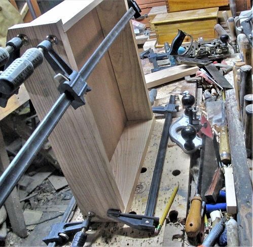

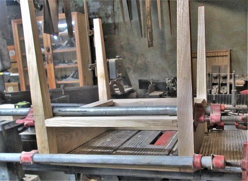

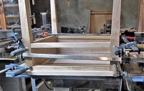

Friday's Follies....a glue up..
Only place big enough...started to use an F style clamp,,,,not getting the job done:BangingHead:
We have ways.:ph34r:
Nothing talks back to these...then, I needed to rotate this mess to the floor...FUN fun...:ArguingSmileys:
A size 13 boot to move the tablesaw OUT of the way helped....then double check for square....:OldManSmiley:

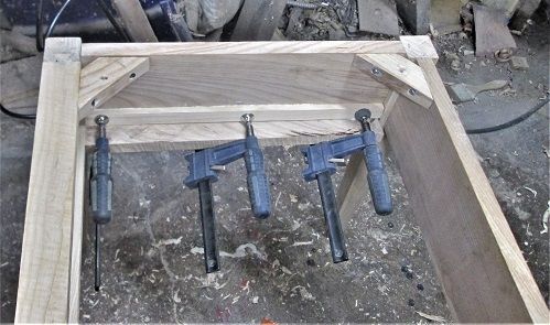

Got 2 out of 4 corner blocks installed...and ran out of the right length screws :PullingHair:
Well...they are also known as glue blocks...
You might want to tip-toe as you walk by :rolleyes:
When a box of the right length screws arrives, I'll finish install..in the back 2
Tomorrow is the start of "Drawer Build 101"   Maybe...we'll see:ChinScratch:
Stay tuned :cowboy:

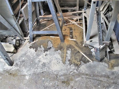

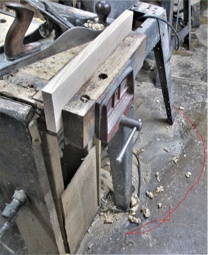

Bad part of leaving something on the shop floor, when the Gulley-washer comes through..:JawDrop:
Muddy Dungeon Creek..:BugEyeSmiley:
Feet got a little damp.:ArguingSmileys:..clamps have been removed...:TwoThumbsUp:

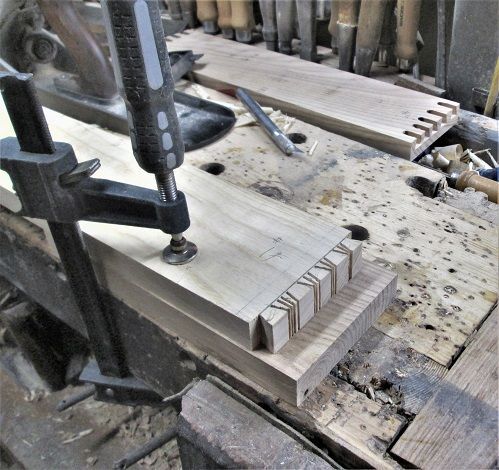

Drawer front needed jointed...before it would fit..:ChinScratch:
Drawer sides needed the same treatment..:OldManSmiley:
At least they will match....next...re-arrange the shop a bit...tablesaw out of the way..:SaluteandRun:

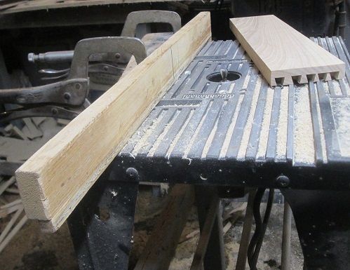

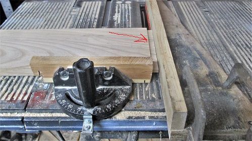

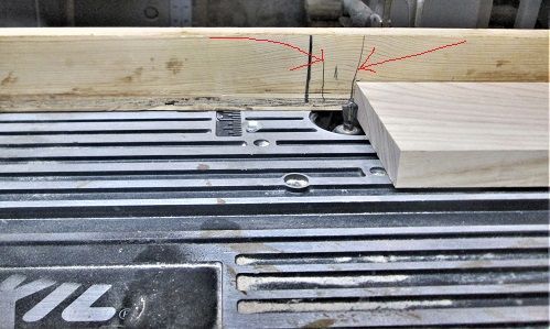

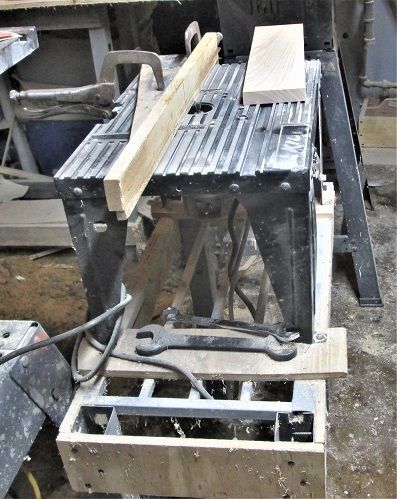

Router table out where I can use it.:JawDrop:..had enough chopping by hand, for now..:BangingHead:
Fence has Start & STOP lines...had to move the fence a few times, but..:TwoThumbsUp:

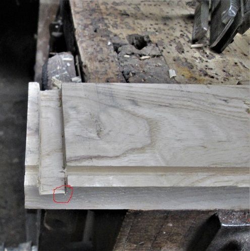

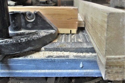

Both ends are done...then use these to lay out and saw..:WonderScratch:

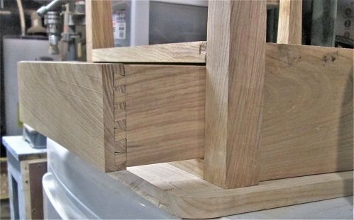

Then the chisels can get to work...first dry fit?:ChinScratch:
Had "crumbs" in the back, holding things out...by the time both front corners were done...:Tapping:

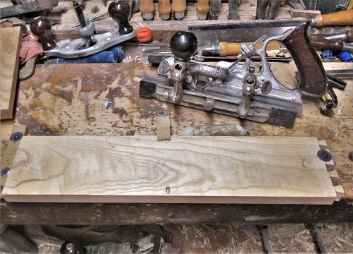

I think I got it, now.   That "step" at the drawer front?   It is a "stop", to keep the drawer from going in too far (never to return..:DevilLaughing:)

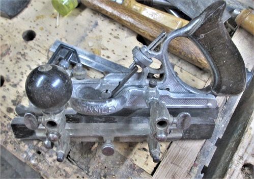

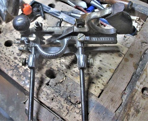

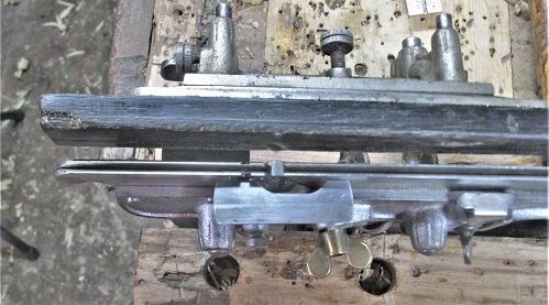

Decided to reset the Stanley 45...as it was still set up for "bead work"....needed to change back the groove work..:ChinScratch:
1/4" groove, set in 1/4" from the bottom edge of the sides and front of the drawer...:OldManSmiley:
So...tomorrow, maybe..:rolleyes: I can jig up to get "Groovy" :TwoThumbsUp:

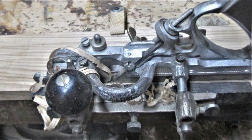

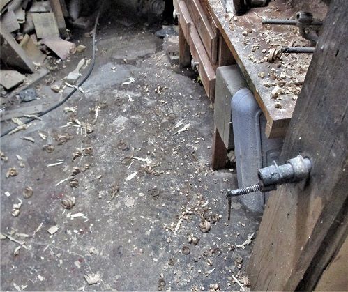

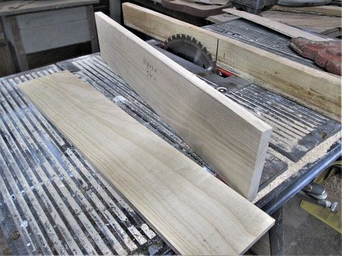

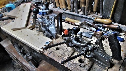

Had to go to the basement to retrieve an item....couldn't help meself..:DevilLaughing:
Set up a jig..:DevilLaughing:
Once the depth was adjusted just right..:ChinScratch:
And, it started making "Noodles"...the 2 sides soon followed...:SaluteandRun:
An old candle helped out, made things go faster...:SaluteandRun:
Thought maybe this would be rough to do....3 minutes later...B)
The only "issue"?:WonderScratch:

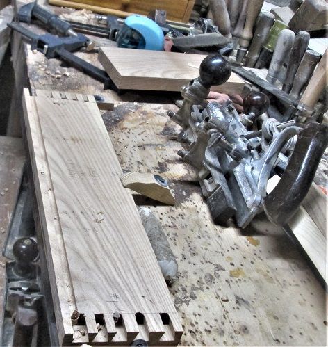

Dang shavings go everywhere..set up a second Stanley 45 as a dado plane..:OldManSmiley:
Yes, I do have TWO such planes...:JawDrop:
So...maybe tomorrow, leg willing, I can mill a dado on the back ends of the 2 sides, to house the thin back.:ChinScratch:

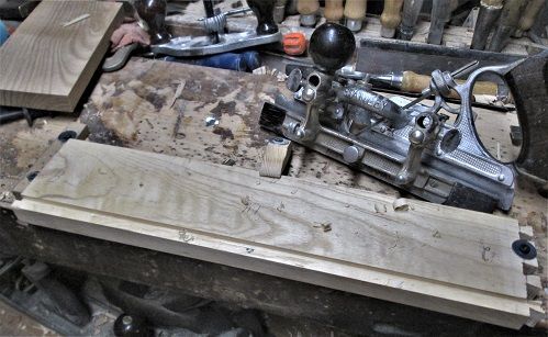

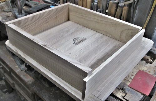

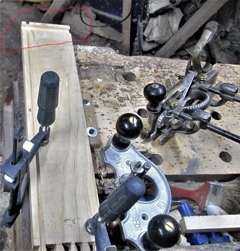

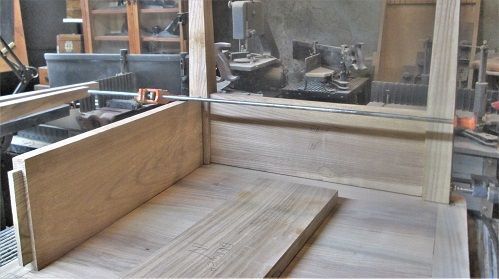

Dados have been milled...had to find a way to clamp the sides so they will stay put..:MachineGun:
A stop block and 2 clamps seemed to work.   Spurs on the Stanley 45 are not the best...wound up using a dovetail saw to cut the walls of the dados.....then the 45 went to work...the Stanley #71-1/2 then did the clean-up..:Tapping:
As the 45 wanted to tilt a bit...:BangingHead:

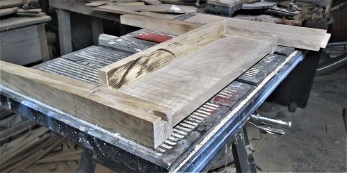

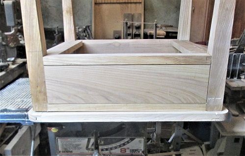

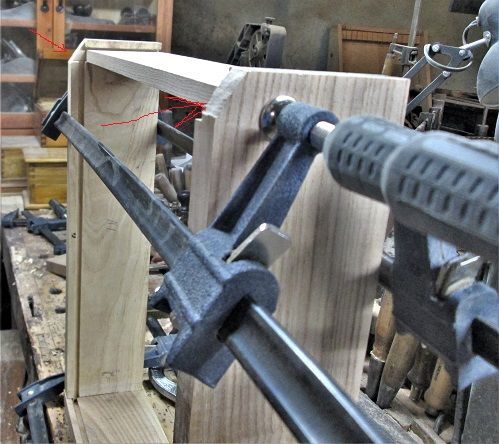

Dry fit with the drawer back....too tall, too wide..:ArguingSmileys:..3 dry fits later..drawer FINALLY slid into the table base's :Praise:opening....the back corners of the drawer get a "starter bevel"..
Makes it easier to start a full drawer into the table...checked the dry fit for square...:OldManSmiley:
Will do for now...:ChinScratch:
Had a sheet of 1/4" plywood on hand....way too long, and way too narrow..:ArguingSmileys:..trip to Lowes before they closed for Sunday..:SaluteandRun:..bought a 1/4" x 24" x 24" panel....$7.38:ArguingSmileys:
Cut the panel to size, to join in the dry fitting..
Will do, for now..:ChinScratch:

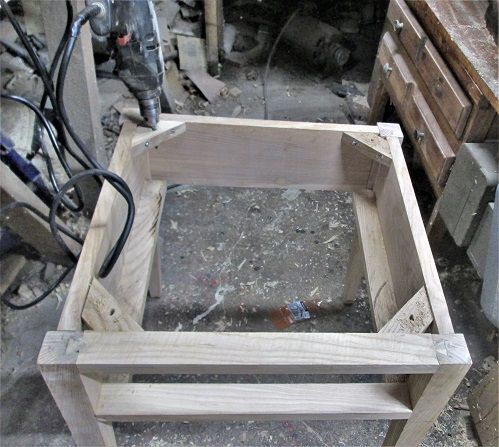

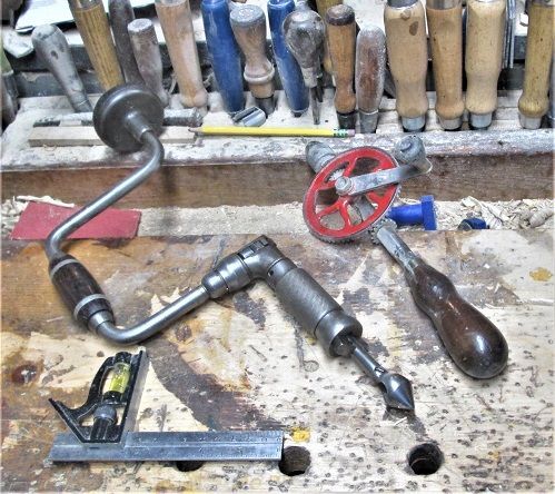

Monday, or not.:DevilLaughing:...needed a laundry list of things done...:Tapping:
This mess needed cleaned off, and put away....:SaluteandRun:
Task 1 done.    Then needed a couple tools set back out...:SaluteandRun:
Have a use for each...:OldManSmiley:

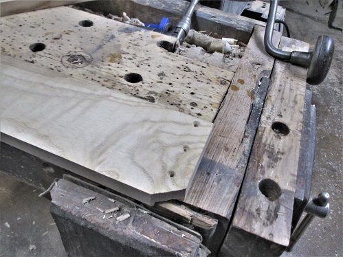

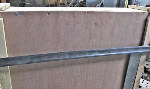

1790433021_MondayAfternoondrillandcountersink.JPG.910ace4f63b612145ecf25ce8440649c.JPG

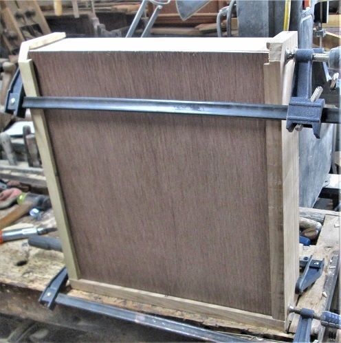

Drilled and counter sink....then recheck the drawer back...was a hair too long, trimmed that...:MachineGun:

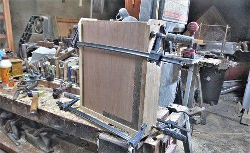

Glue and clamps next..:Cheer:

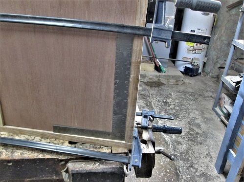

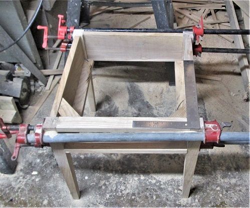

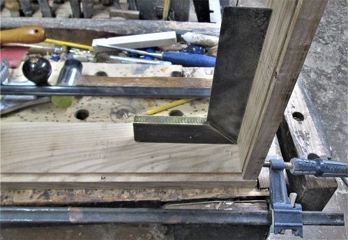

A bigger square was needed...:SaluteandRun:
Once this read "square" in both corners..I could attach the bottom to the back..:ChinScratch:
That combo square was need to draw a line. :SaluteandRun:  Set this aside...and work on Task #3

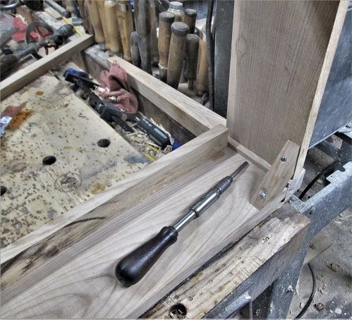

North Brothers Screwdriver...Back two corner blocks needed their screws installed...Next?
Task #4:  drill the slots to attach the base to the top....then, Task #5?

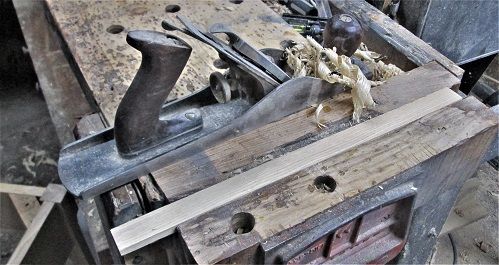

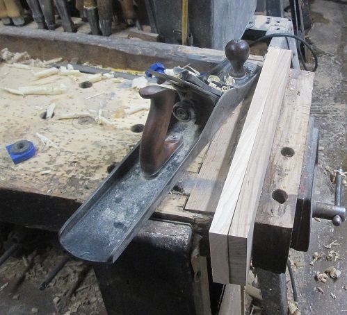

Guides for the drawer...one was the right thickness..the other?:WonderScratch:
Needed thinned down a bit...far end was tapered...planed to remove the taper...:ChinScratch:
Then a bead of glue and a few clamps...and that was quite enough for a Monday Afternoon....about 90 minutes, counting that clean up....:KooKooClock:
Will wait until later...stay tuned..:cowboy:
