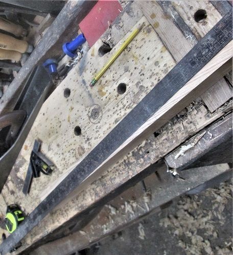

    Work area... Layout tools.. First chops... Clean out the chips, go back through 2 more times...until I THINK I am deep enough... Took about 20 minutes...rep

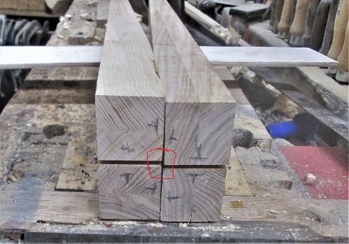

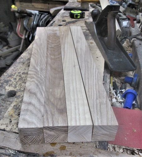

Hmm, ok..:WonderScratch:.needed to remove the dried glue from the 4 legs...we have ways...:ph34r:

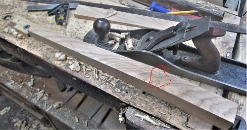

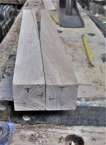

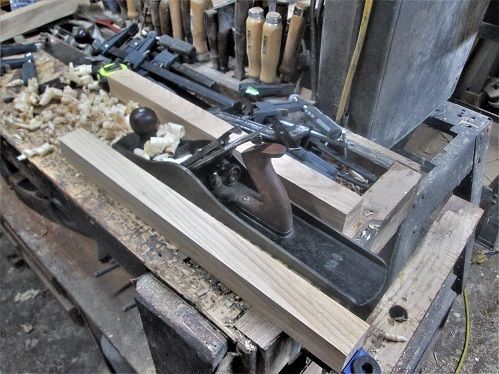

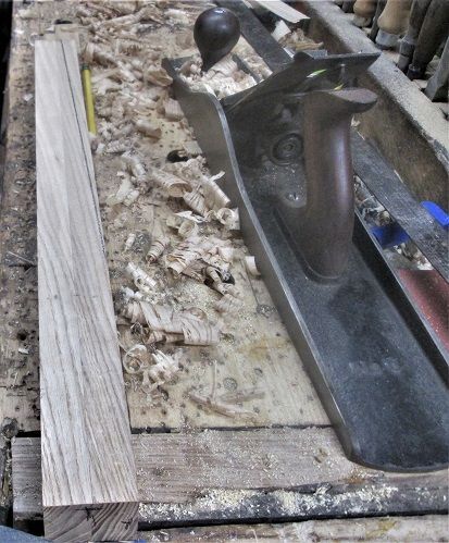

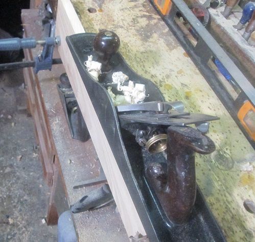

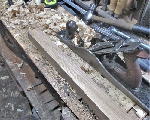

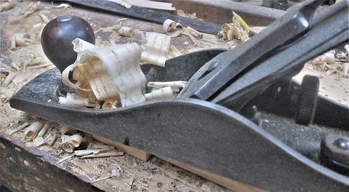

Millers Falls No. 14, sold as a Craftsman Jack plane...cleaned off the dried glue with ease...ends of the legs were trimmed square, and all 4 legs are now 19-1/2" long....needed to level the sides a bit...:ChinScratch:
And a few of the rough sawn faces were planed smooth, too..:rolleyes:
Made a lot of thin shavings...soon had all the legs squared up...:TwoThumbsUp:

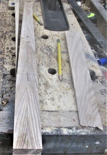

And since they were all just sitting here...squared a line all around..:OldManSmiley:
6" down from the (Now) Top of the legs.   This is where the tapers will stop at....then set 3 legs aside..:ChinScratch:

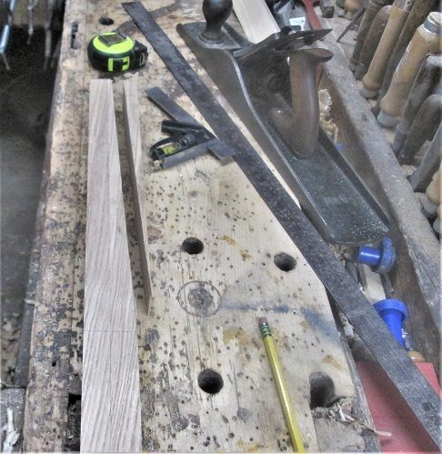

Mark 1" in from the edge (covered by the ruler)  and mark a line up to the stop line...Bandsaw time..:JawDrop:

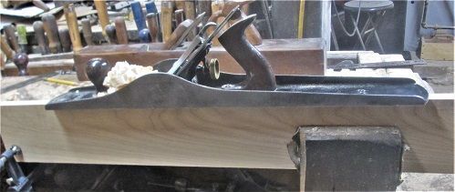

Cut one taper..rotate 90 degrees, lay out the other taper..saw that...then back to the No.6c plane..:SaluteandRun:
1267522876_TheShakerTableLegscleanupsawmarks.JPG.f874564f9e89ccd52c3f4ed24d2cb2e8.JPG
Clean off the saw marks....by the time both tapers are planed...:TwoThumbsUp:
You will not need to sand anything.  Mark the top of the leg with a "T" on each edge there is a taper on....which is where the tenons will be going.  :OldManSmiley:

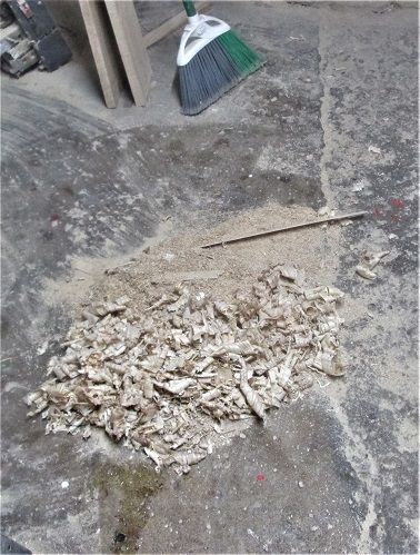

Was a bit too tired to sweep up..:GoodNight:
Hope nobody minds a few shavings on a shop's floor....:rolleyes:

Legs, Part 2...:SaluteandRun:
Lay outs..:ChinScratch:.
Cuts..:TwoThumbsUp:
Plane..:Cheer:
Have to keep track of where the tapers are going..:ChinScratch:
About 45 minutes of the hour in the shop..:OldManSmiley:
Needed to cut and plane 6 tapers....:TwoThumbsUp:

And...I even swept the floor tonight..:JawDrop:

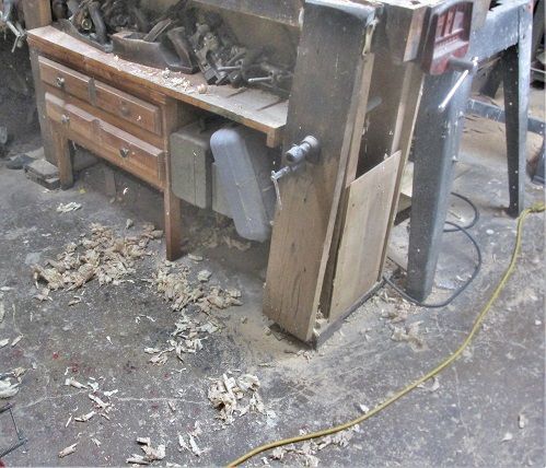

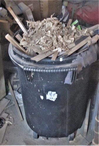

But, still need to haul this up to the firepit..:ChinScratch:
Getting a might too full...:BugEyeSmiley:

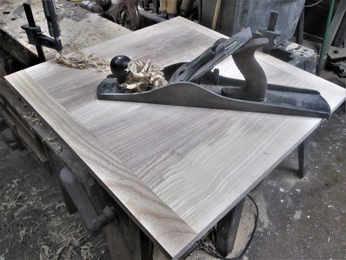

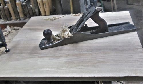

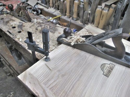

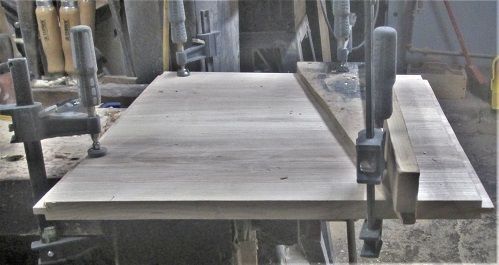

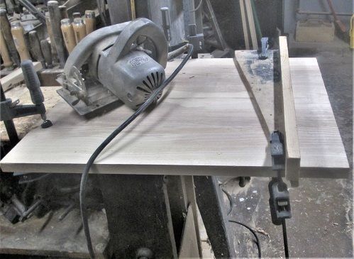

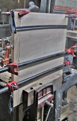

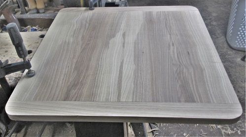

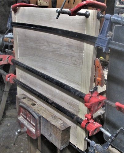

Clamps came off the panel for the table's top....between this No.6c and a coarse beltsander ( glue lines)  spent some time getting both faces leveled....couple of spots I used the M-F # 8 smoother....Then set up to trim this down a bit..24" was a bit too long..:rolleyes:

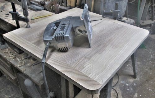

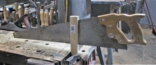

Have to allow for the bread board edges...to still have a square top...Saw is a Skil #520 Home Shop 6"....older than I am..:JawDrop:

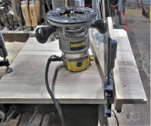

Next, and old router was put to work..:ChinScratch:
Took 4 set ups....but..:Cheer:
Used these to lay out the groove in the bread board ends...then finally, spread some glue..:SaluteandRun:
Why is it, that glue on fingers dries faster than glue on wood?:BangingHead:
Should be enough clamps?:ChinScratch:

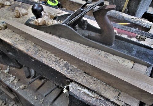

My Millers Falls planes stop at the No. 15 size.....as for the Stanley no. 8....the No.8c WAS in use a while back....working as a jointer on those 33" long planks
IF there happens to be a high spot....old #8c will find it.....but...10 pounds of plane tires the arms out, real fast....
One of the reasons I switched to the No. 6c.....and, the number 8 was a tad too long...working on boards as long as the plane is..

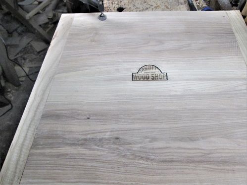

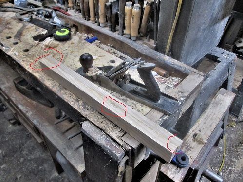

Had to level things up, once the clamps came off..:SaluteandRun:
Had one pesky corner..:ArguingSmileys:

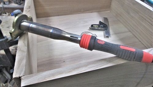

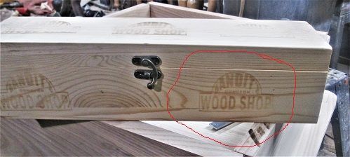

And that edge was trying to raise up.:ArguingSmileys:...about that Brand?:WonderScratch:

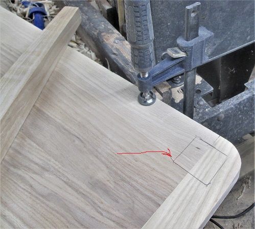

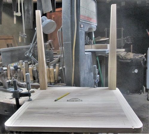

Once the underside was flat, and smooth...I could use the branding iron...about in the center..B)1600840976_SundayFunniesBrandingironcase.JPG.2d607fb9ad451370f563df11d2f3ec18.JPG
BANDIT'S   Dungeon    WOOD SHOP...:OldManSmiley:
This is AFTER it had cooled back down...:Tapping:
Vintage saw time..:ph34r:
Then beltsand smooth....:JawDrop:

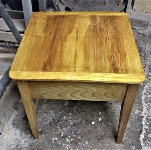

This is what you'll see from the top of the table....flip this over. and locate where the legs will sit..:OldManSmiley:
Something like this..:WonderScratch:

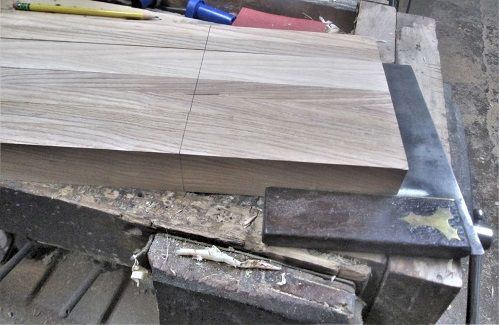

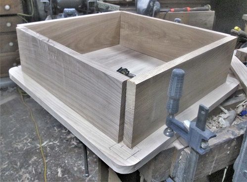

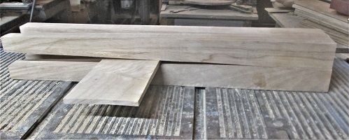

Back 2 legs....needed to measure how long the aprons and drawer fronts needed to be...16-3/4"  allowing for a 1/2" tenon on each end...Then cut 4 blanks..
One will be the drawer front..2 look-alikes for the sides, and one for the back...:ChinScratch:
Mortise and Tenon tasks will be the next time I go to the shop.....we getting there..:Cheer:
