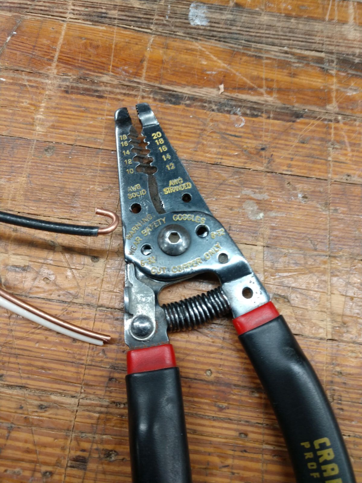

Well Keith, I didn't know about that requirement. Additionally, even #12 wires are stiff enough to discourage me from wrapping them around the outlet or switch screws.
I wired my whole shop with #12 and agree completely.  Subsequently, I found a tool that helps bend the ends and push/pull them in the outlet box.  Used it just  couple times and like it.
That looks like a good multi-tool Keith.
Gene, my BIL showed me how to bend the hook needed for 12 ga wire and screws.  On this tool you use the hole towards the base of the jaws.
The better outlets and switches though don't require you to bend and screw the wire down, the wire is stuck into the side and is clamped down by a screw.  Much simpler.

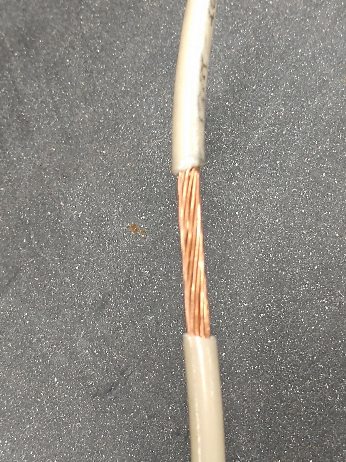

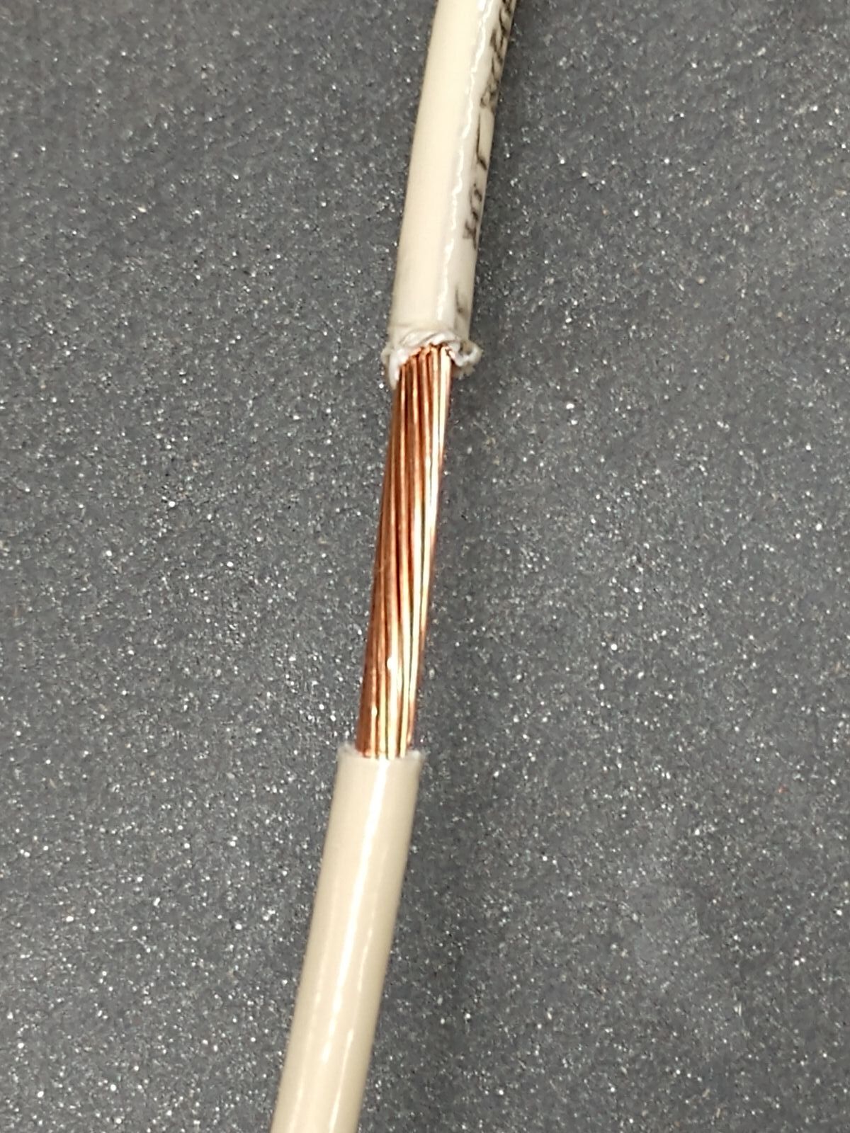

When wiring a receptacle or switch I try to stop short of removing the insulation from the end of the wire, takes a little practice but it has its advantage. I then back wrap the wire. When looking at the end of a piece of wire you can see that it is twisting clockwise,
 m3.jpg.311bca7faec4bef00f50a1c9d8ad4e9f.jpg    twisting the wire counterclockwise (back wrap) you get thism4.jpg.5a50611fa1dad2d6e4f790c4d2cb61fd.jpg
 The advantage comes when wrapping the wire around a screw
Screw on the left has the insulation removed and was not back wrapped.
Screw on the right has maybe an 1/8" of wire left under the stripped insulation.
