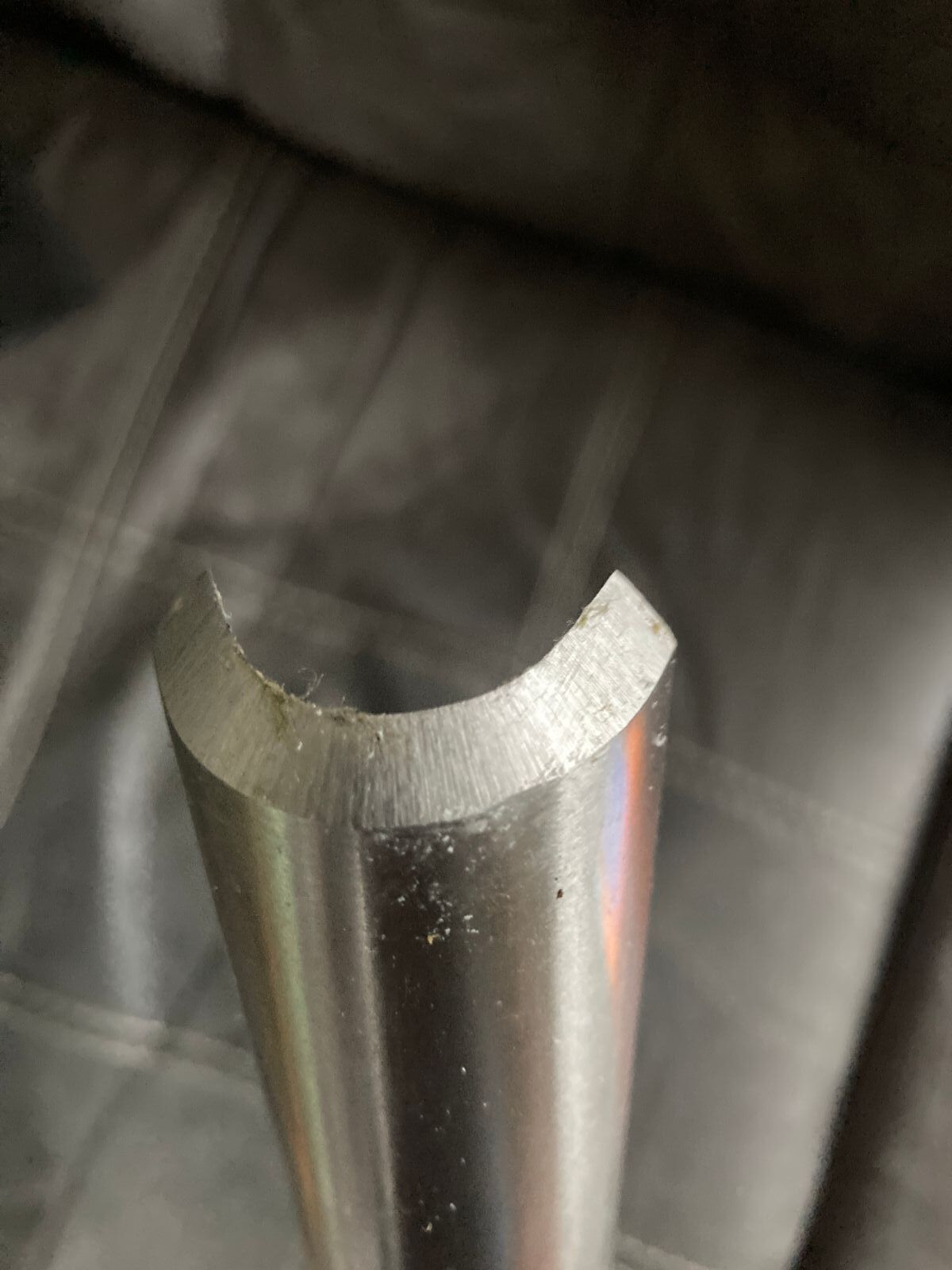

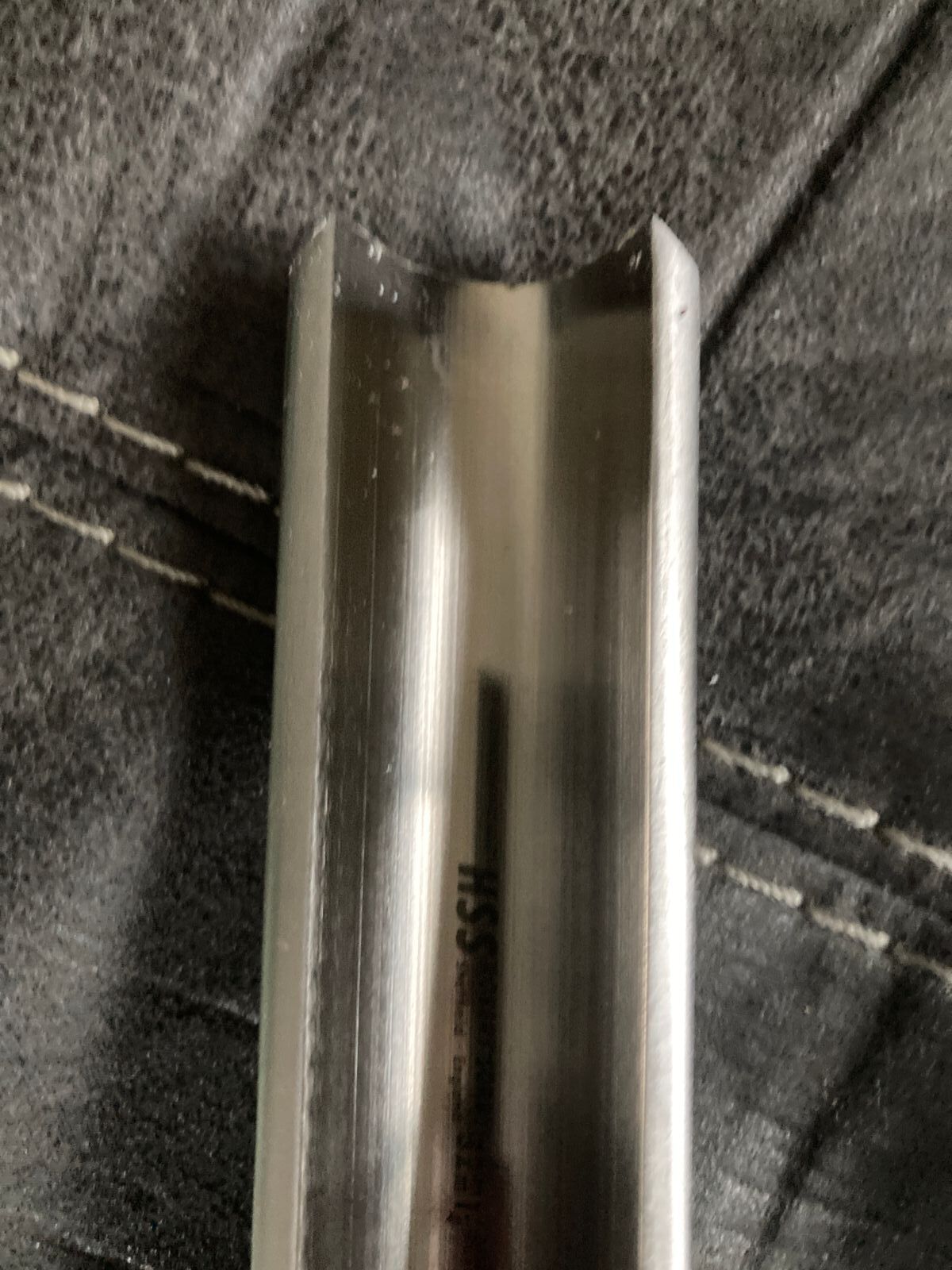

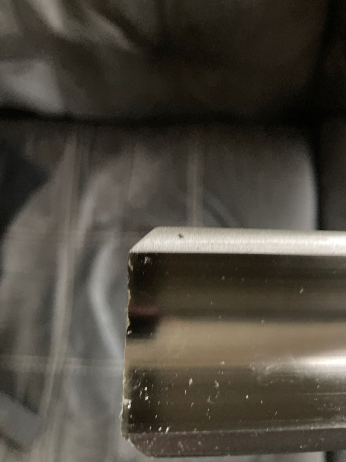

Just delivered the Robert Sorby 1 1/4 inch roughing gouge.  I haven't even yet had a chance to use it.  But I am surprised at the over all size of the tool I was thinking it was going to be a lot smaller than it is.  How ever  the weight of it seems fine to me about the same weight and length as my carbide tips.  Just need to pick up a couple more HSS tools and I think I'll be good for the time being still looking for a good HSS parting tool.

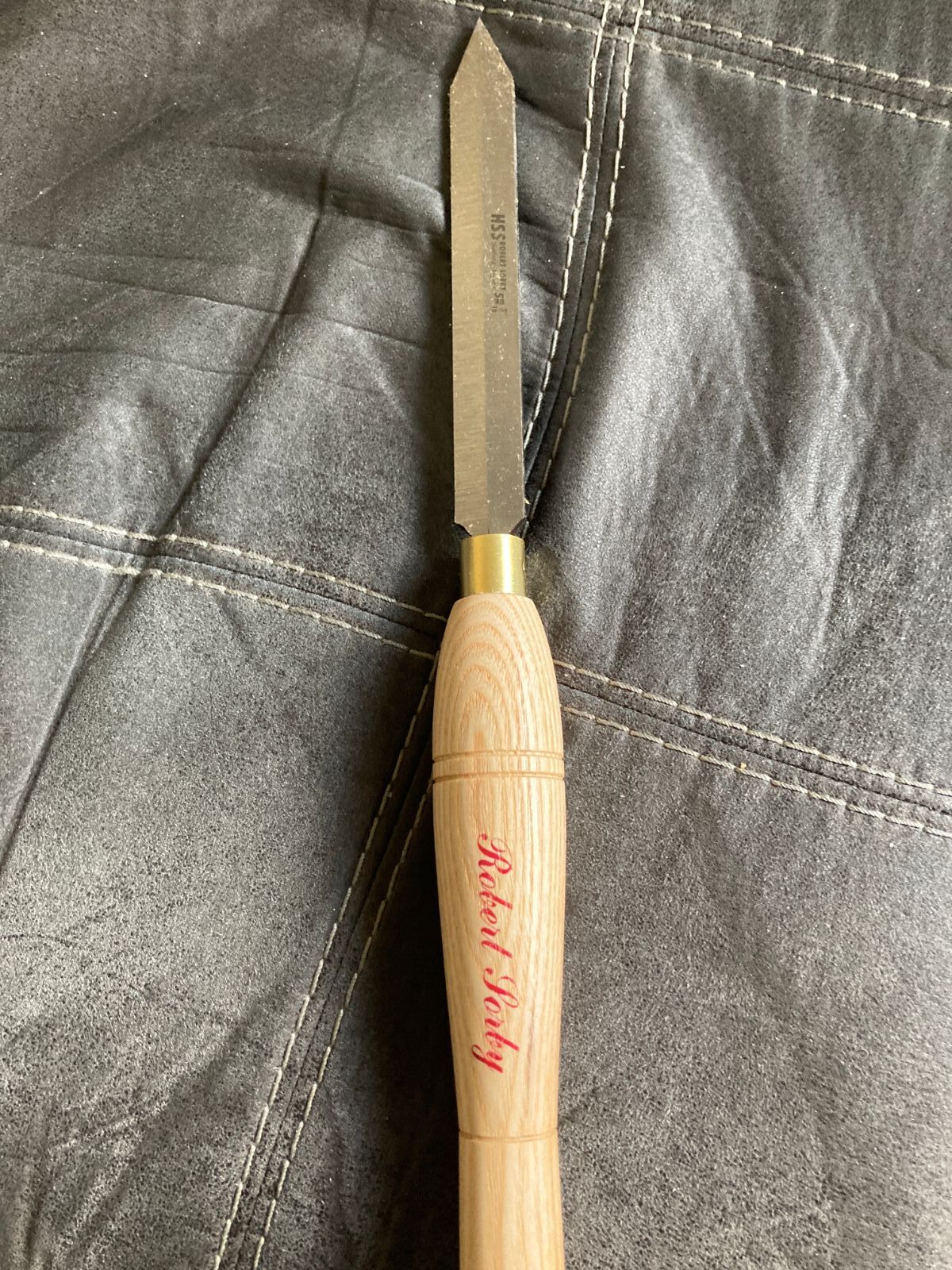

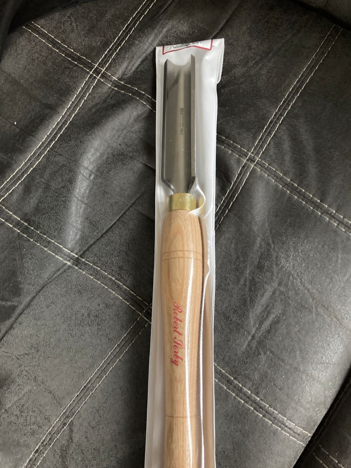

I just picked up one of the Robert Sorby parting tools I've been wanting an HSS one for a while now.   So now at least I'm starting to build my collection of HSS quality tools instead of buying cheap crap at least.  Still need to get a smaller spindle gouge and a bowl gouge.  But at the moment those can wait.

Not too sure on this but it seems like it will work fine for what I want and need for a parting tool.  Just need to acquire a couple more I think a skew and a finishing tool will do the trick that are HSS.  Not sure what other tools Id need.  Aside from a bowl gouge but that will have to wait.
Is that a 1/8" tip?  That will be good for tenons and such, but for straight parting off, you might eventually want one with a thinner tip.  What type of finishing tool are you thinking of?
