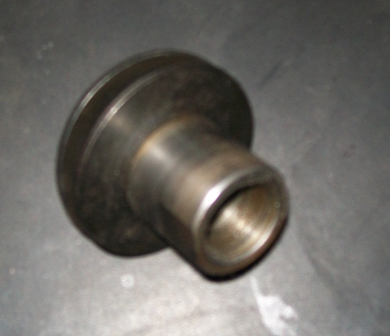

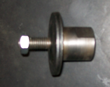

Andrew,
Since you got the PSI setup, you could use the rest/guide with an adapter that allows you to use a grinding wheel on the lathe and have a variable speed grinder.
2116216103_LatheGrinderAdaptor1.PNG.cee61aab09ae1c4daddb87224bb18bed.PNG653497833_LatheGrinderAdaptor2.PNG.580e5793673a1cd3e9e9995354de4f11.PNG

I have already ordered the grinder it is on the way as far as putting it on a lathe I don't think Id do that with the stones how ever buffing pads that would be an entirely different story and one I may try out.
