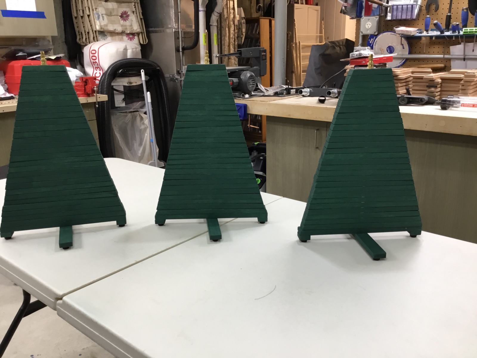

I have all the wood cut,sanded,and 2 coats on 5 of them. I woke up at 1:20am to do my Forrest Gump imitation, and couldn’t eat back to sleep, so I went down to the shop and started the second coat. Last night it looked like 2 coats may be enough, we’ll see how they look in the harsh light of daytime :) I have no idea of how long I’ve been working on them, but pretty much all my free time for the past two weeks.

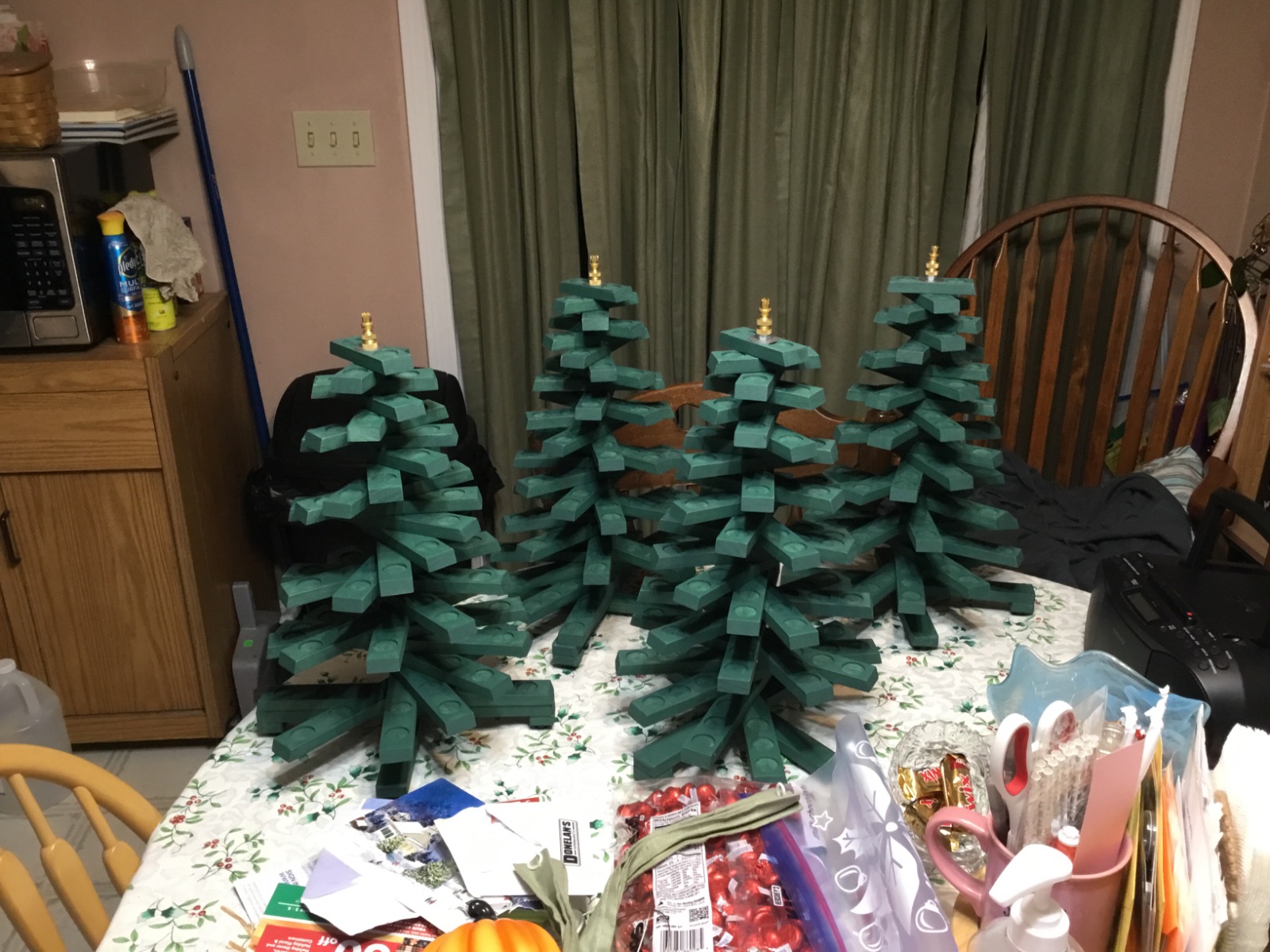

So, the first 5 trees are done. Overall I thought they came out better than I deserve, for my lack of finishing skills, and patience. I made some changes going in. I Knew Iwas gonna paint them, because I thought green was more Christmas’y than the natural wood. Also I could buy less expensive wood, and therefore make more of them to give away. I bought very thin washers to install between each piece. Figured this would allow them to be fanned out, and flattened easier, and with it being paint, less damage to the paint. I also bought rubber feet. I thought this would eliminate any future issues with the threaded rod screwing through the tee nut and scratching surfaces. If I was to make any again, I would also make some other changes. 1-use a 9/32, or maybe 5/16 drill bit for the holes. There was more work than necessary to get the pieces on the threaded rod. The width of the pieces was 1 1/8, the holes for the kisses are 7/8. I would change this to 1 3/8, and a 1 inch hole for the kisses. Where I’m painting, this fills in the ID of the hole enough that some of the kisses are sitting on the hole, rather than in it. I could see me making more of these, I really like the look of the milk paint, they’re rather simple to make (in my wheelhouse LOL), and who doesn’t like Hershey’s Kisses? So I’ve got 5 done, making some socially distanced deliveries tomorrow, and there are still 5 more waiting for paint. If all goes well, might have them done by the end of next weekend.

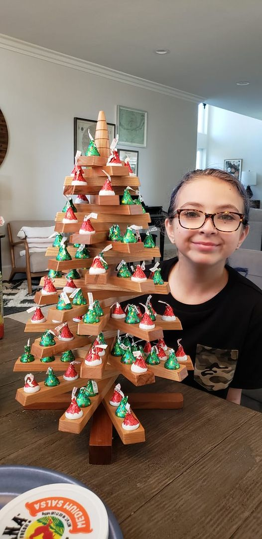

I saw them in the last issue of Woodcraft magazine, and thought, those are within my abilities. Then My M-I-L liked them, and of course at that point I was making one for my S-I-L also. Then my brother, and sister, son, son’s new girl, (she visited, saw the shop, and now thinks I’m like a Thomas Edison, or something ), our son’s half sister (who just got her own place), and our son Trevor’s best friend, also named Trevor (who just moved into their first house with his fiancée last week), and a very nice lady who has been like a grandmother to my wife, since she has been 10.
So I thinkI’ve mentioned it a couple of times, I have NO patience. I wish this project was in the issue before the last issue so I would have time to plan this out.So I turned it into a rush job, making 10 of them. Was fun, and I learned a lot that I would do differently, if I make more. I figured that the two people I know, who have both moved into their own place in the last month, probably don’t have a whole lot of their own Christmas stuff, and would really like these.

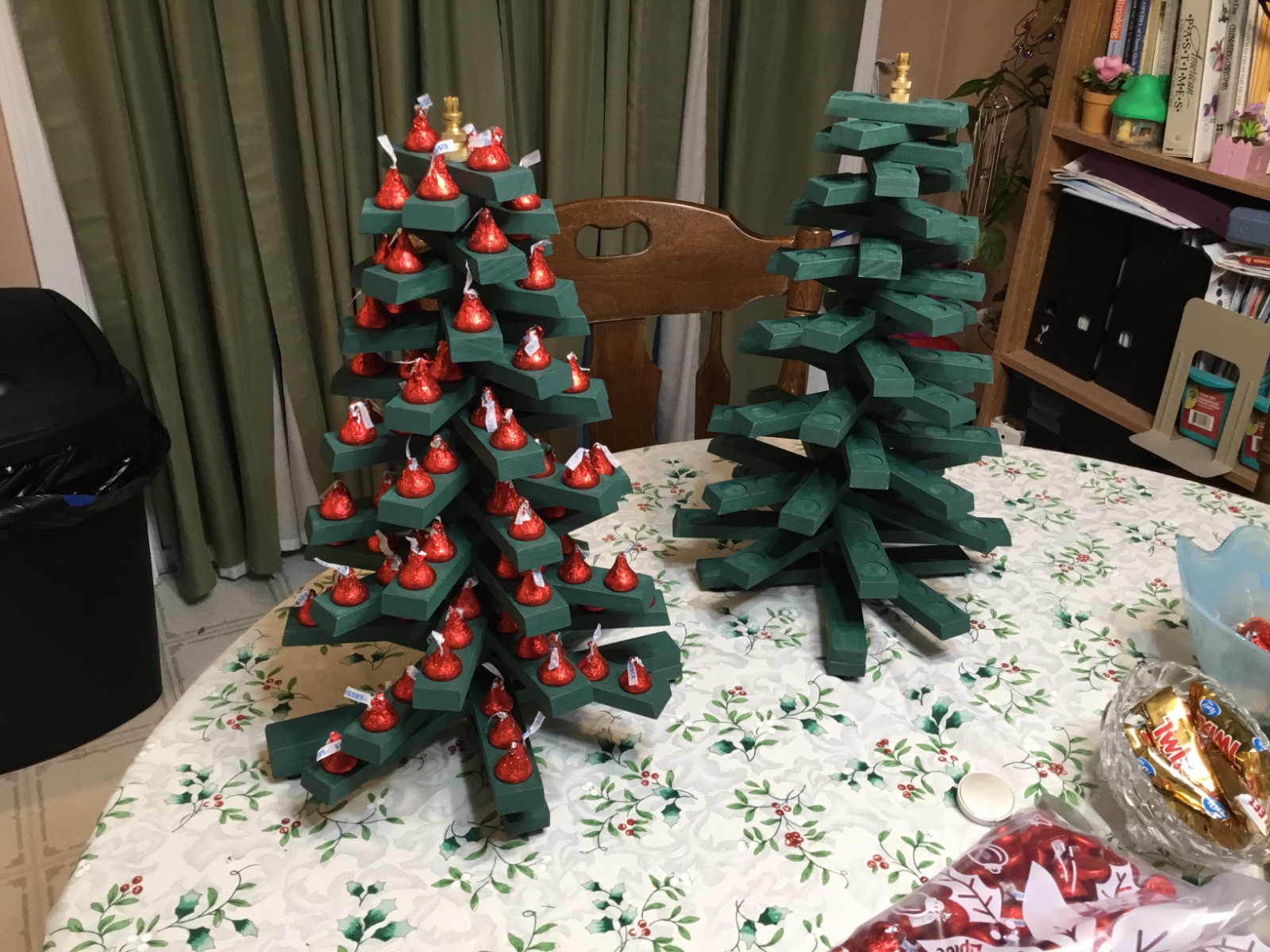

None yet, just loaded up the Kisses about 3 hours ago. I found some candy place online, bought 1200 Kisses, wrapped in red foil, and had them delivered. Posted some pictures on the Facebook, and getting requests for more. :(

So got 6 of them done now, I love this milk paint! if I knew what I was doing, I don’t think I could have picked a better paint. Kinda like the ribeyes I get from the butcher. I’m no cook, but they taste good no matter what I do to them. I wasn’t happy with the trees after the first coat, but man that second coat did wonders. The people I have given these to so far have loved them, and it appears I will be making 4 more. They will be better.
