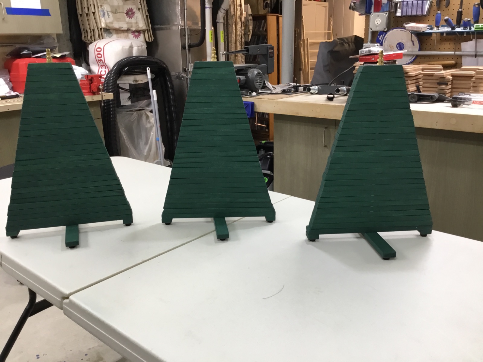

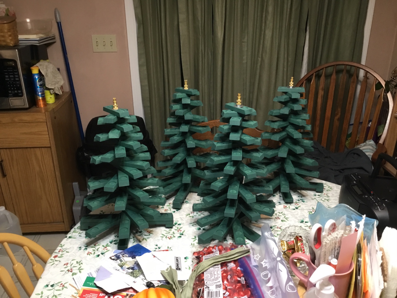

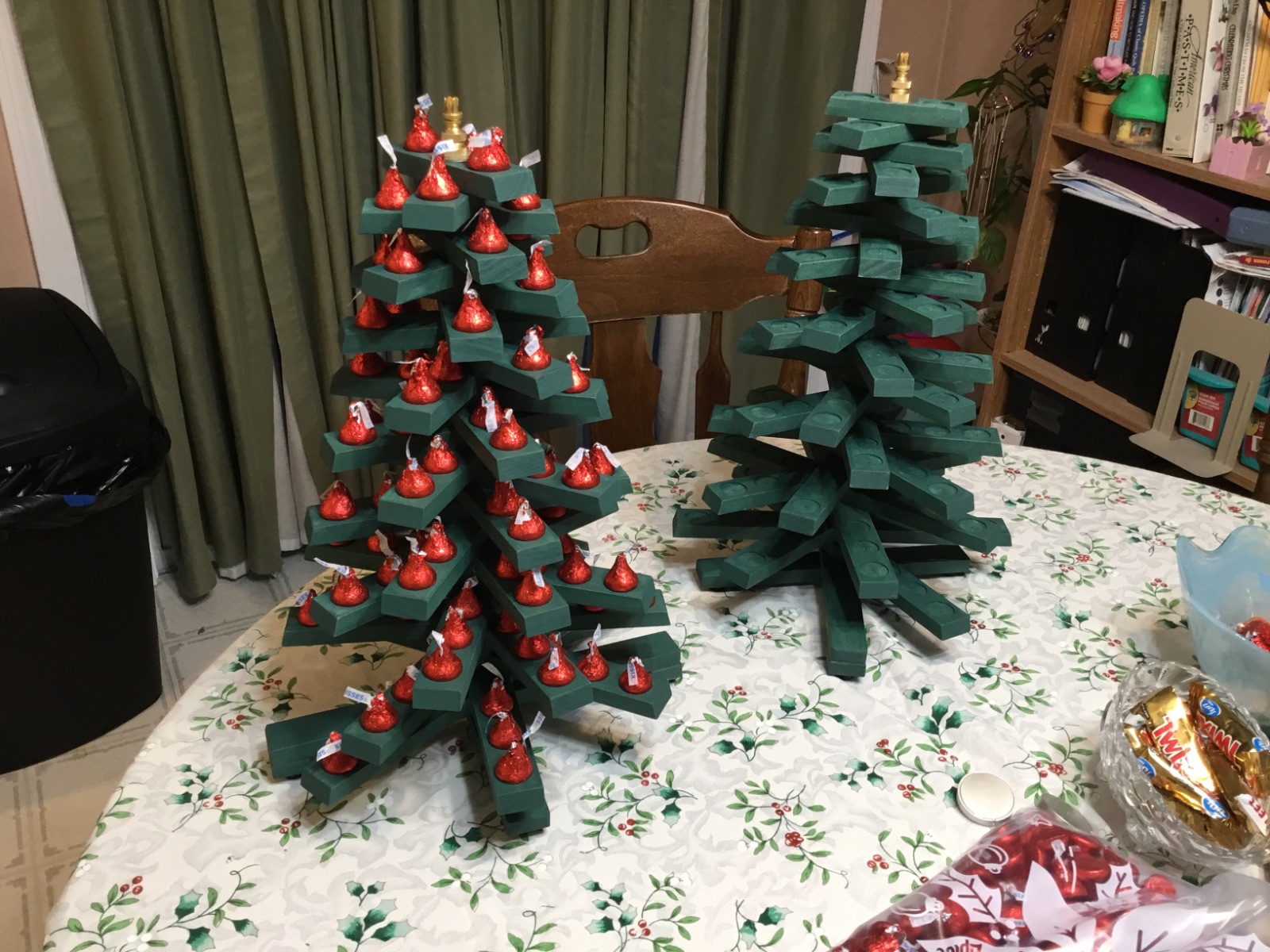

  • So, the first 5 trees are done. Overall I thought they came out better than I deserve, for my lack of finishing skills, and patience. I made some changes going in. I Knew Iwas gonna paint them, becaus
