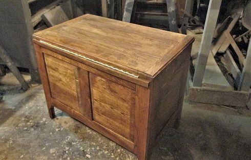

Outside has been given a coat of that SMELLY BLO ( allowed to sit a bit, then wiped down)......Will see about the underside of the lid, this afternoon-ish:WonderScratch:  and maybe install the cedar planking floor?

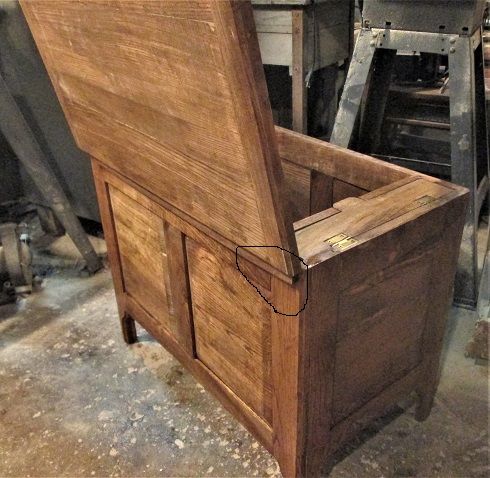

Added a 1 x 1 strip of Ash across the back...right at the hinge for the lid....idea is as a "back stop" so the lid will not go over the back of the chest.....serves the same task as adding a chain between the lid and the chest...strip was glued in place, before any finish was applied, and then finished just like the rest...

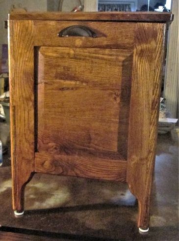

handles?   May use a "cup" version like on the Mini Tool Box...:TwoThumbsUp:
centered in the top rail of the Blanket Chest's ends..:ChinScratch:.we'll see....need to clean out the shop, to get a place on the floor large enough to work on this project..:WonderScratch:....THAT might take a while....:JawDrop:

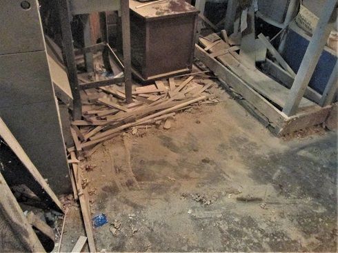

Time for a PIP?   had to clean up a mess, first..
Move these 2 out of the way..
Remove all the trash..
Floor WAS clean..
Until I moved the tablesaw back into it's place..
Which promptly left a trail of sawdust behind....Swept that up....moved the Blanket Chest into the cleaned up area..

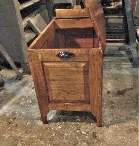

Right under the hinge...is the backstop....open the lid far enough..
And the backstop will keep the lid from going too far back...

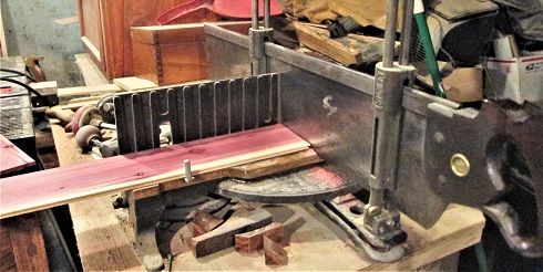

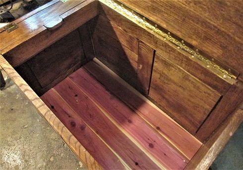

Mitersaw to cut the Cedar planks for the floor..
Held with just glue...

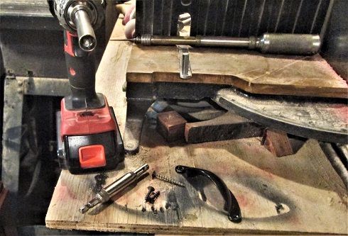

As usual, lid was stuck..a bit of varnish was holding the lid shut..:BangingHead:...got out the tool kit..:ChinScratch:
1452240616_BlanketChesthandlesinstalltoolkit.JPG.69fd298e64d0663aa38c28350967e459.JPG
Couple of drills,a VIX bit, handle #2 shortened screws ( with the "normal length one) handle #1?:WonderScratch:

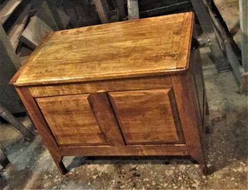

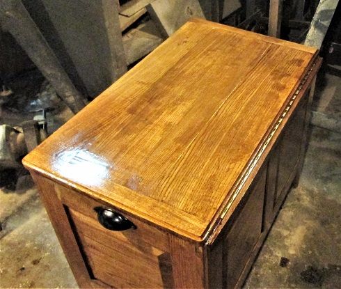

Hmmm, may try to "fix" that white streak....why do they always show up AFTER the finish is on? :ArguingSmileys:
Lid is rather shiny..:TwoThumbsUp:

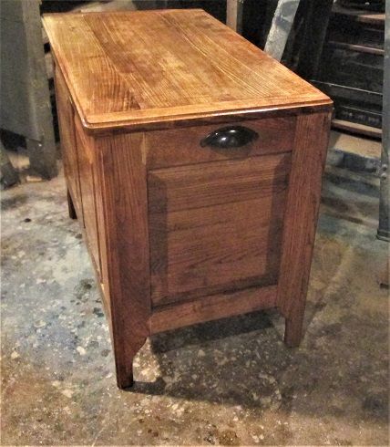

Theory being, you put the fingers into the handle, while resting your thumb on the lid...when you lift this thing...:ChinScratch:

Front view of the Blanket Chest.  Already looking like an antique?:WonderScratch:
Hope I can open the lid, later...:ChinScratch:.need to get this up off the floor, where I can sand things a bit, and add the second coat of varnish...:Tapping:

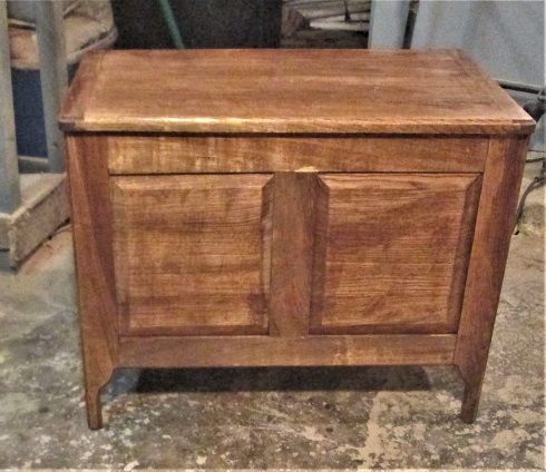

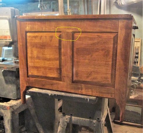

Well..I didn't really like those white streaks ( glue schmears..:ArguingSmileys:.)so....Dremel to sand out the spots.   sander with 320 grit paper to sand all over the chest.   Glaze coat of stain....had wiped of the sanding dust first, of course....let the glaze sit a bit...lightly wiped it down....then brushed on Varnish coat #2...:ChinScratch:
Right near the top of the rail, to the left of the handle....was one such streak..rest is all just wild grain...:rolleyes:
yellow circle shows where one on the front USED to be....and..
765898840_BlanketChest2ndcoatspotrepairdone....JPG.226f7cd1ec0395141c1a2ac33c93a5bc.JPG
That large "neon" stripe is now gone....:ChinScratch:

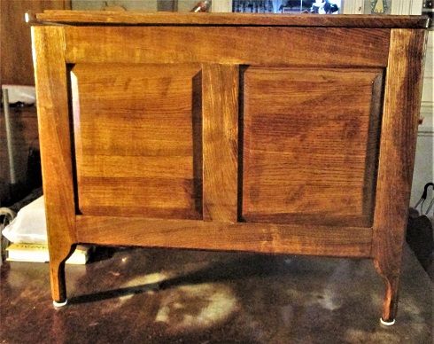

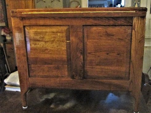

Are we ready  to show off?   Have moved this thing upstairs ( Grandson just by himself, no less..:Praise:) and sat it down on the Dining Room table....lighting wasn't the best, and he set it down..
With the backside towards the camera...white shoes on the feet are Furniture Glides...nail them in place...:ChinScratch:
End view as I turned the chest around..

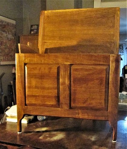

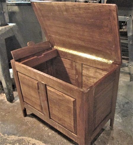

Front view...lighting ain't "Studio Quality"  oh well...opened the lid...
Time to get this down onto the floor...better lighting, better views..:ChinScratch:
Looking at the front...gate to keep the fleabags off the bed....chest of drawers behind it?   I was supposed to match that colour finish...came close?:TwoThumbsUp:
Better view of the lid....was kind of hard to get, without a LOT of glare...
1149228252_BlanketChestProjectPostinsideview.JPG.0aa8842573ca46c0e61a2fd653d92435.JPG
A look at the inside...and.

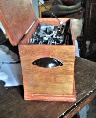

The inside of the Stash Box....
I think maybe she will like this little box?:cowboy:
