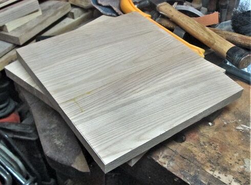

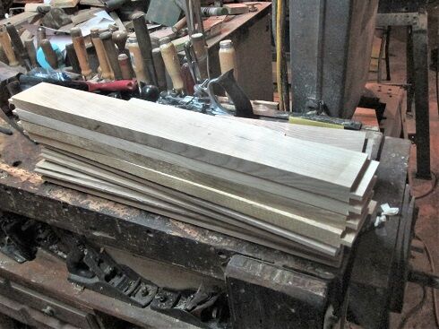

Bought about 25bft of Quarter Sawn Ash, today....
There are 11 boards in that stack..average width is just under 6"....all are around 3/4" thick.

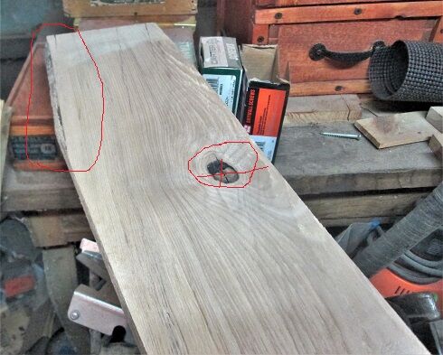

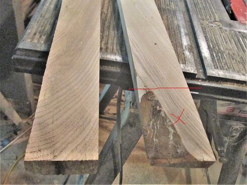

Had a few knots to work around...wasn't quite up to hand sawing things, today..
These two...one on the left?  have a way to get around it...one on the right?  Firewood.
Will have to see where the cuts will be...Not much use for the wainy edge...:WhoMe:

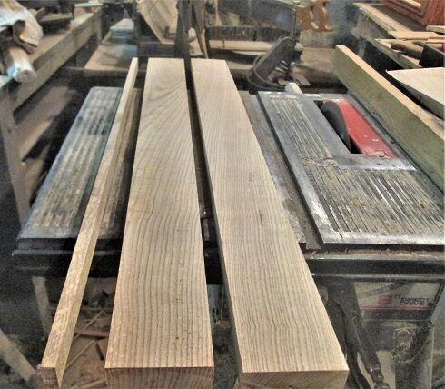

tablesaw to rough cut the planks...looking at 23" long, or so....then rip cut at 2-5/8" wide...soon had 8 blanks for the legs/corners
Yep, there is that knot, again...we have ways..:MachineGun:

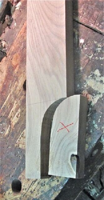

Say good bye, knot. :rolleyes:   Foot detail,  4" above the floor, the curve starts...leaving a 1" square foot...

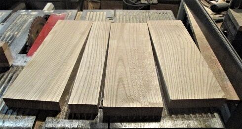

First one is a pattern, to mark out the other 7...

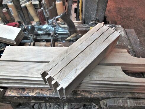

Thought about using the Stanley 45's tongue cutter....way too dull.:BangingHead:..used the tablesaw instead..:JawDrop:
Corner joint.  Times four.   I first ripped down the tongue side, one, to remove the mess left by the Stanley 45.:ArguingSmileys:..and to narrow the ends a bit...next?
I needed a groove to house the raised panels in...will come back later, and do a mortise.    Will use "Haunched Tenons"   on the rails...
rails? :WonderScratch:  Well, right now, there are the 4 rails for the end of the chest...and they also got a groove milled..

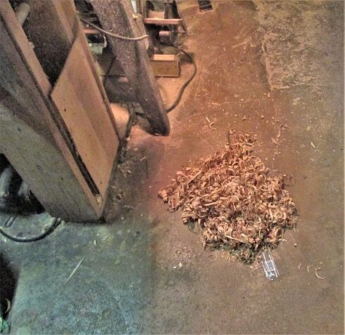

And this is what I managed to mill, today.....big pile of sawdust under the saw, and a pile of shavings to sweep up..

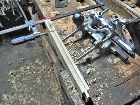

Stanley 45 was still set up..got the bench clamp set..
1811636115_BlanketChestProjectDay2benchclamp.JPG.392f86835542cd5e7df7e9c83107999a.JPG
Wanted a better edge to run the 45 along, so..
388366947_BlanketChestProjectDay2edgecleanup.JPG.0b548ea35ddffe1213b3be75e4e8f3a6.JPG
A few passes with the Jack plane smoothed things right out..
800511218_BlanketChestProjectDay2railgrooved.JPG.96b5158f190fa8841b58ff3f194786fd.JPG
Then the 45 could do it's thing...:Cheer:
I also used the Wards 78, to add a small bevel along the inside edge of the grooves...

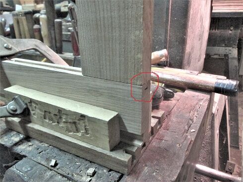

While the actual tenon goes a bit deeper.   Not too bad up at the top..however, the bottom needed a step made..
454062192_BlanketChestProjectDay2stepdetails.JPG.6e223be1b077dcc7baf6f3128a963f5b.JPG
Because the bottom rail does not go all the way to the end....make a saw cut where the rail stops...then a chisel..
Like this.  Was having issues with fat tenons...we have ways..:MachineGun:
Ran this across a few times, on both faces..tenon now fits..test fits..

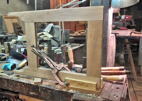

Not too bad?  The rails get a divider right in the center...had to find the center point, lay out the mortises, and chop those out...haunched tenons not needed, though..
1083255868_BlanketChestProjectDay2dividersfitted.JPG.1497676a319d0f048b010ddcf2e3cf2e.JPG
remember to not only label which is the inside  face, but also number each corner...most importantly, also READ those markings.:rolleyes:..try a full dry fit..
1176318482_BlanketChestProjectDay2frontframefitted.JPG.4c5105dc8730288025171c9d7500fe7c.JPG
So, this will be either the front, or the back of the blanket chest....need to do a few panel glue ups...once I know the sizes needed..:WonderScratch:

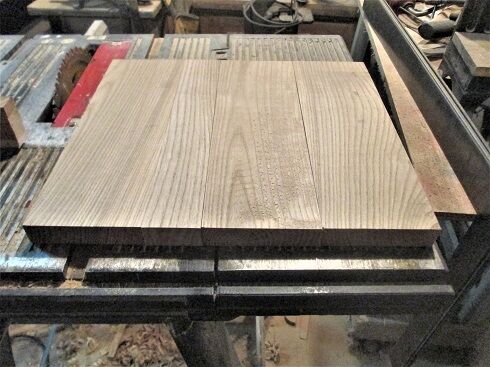

3 boards at 3-1/2" + one board at 1-3/4"   push these together..
1227786950_BlanketChestday3firstpanellaidout.JPG.9c4e3738e519a340b8620c2d92c4d1ef.JPG

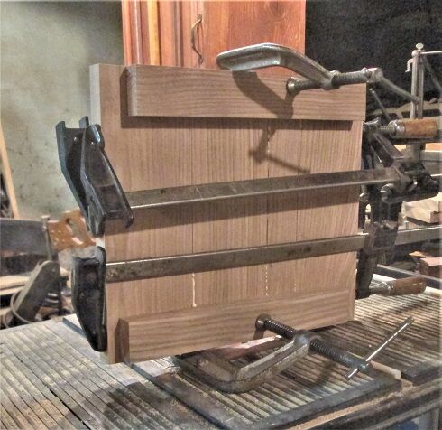

And this one is ready to glue up...had a couple dowels handy to help out...
Then spread some glue..add a few clamps..
Then set this aside, repeat for the other panel...and set it aside...

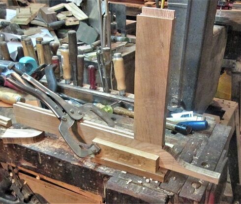

Frame on the bench came over to join them....back to chopping...getting better at that..:ChinScratch:
Even the haunch fits better..:TwoThumbsUp:

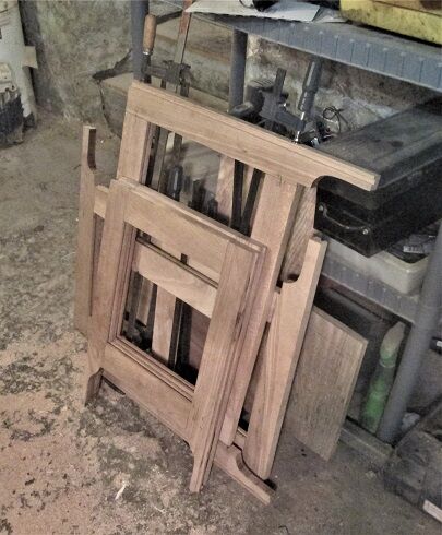

Set this aside with the rest ( didn't even NEED a clamp to hold it together, even) and just got started on the last frame...

So it got stashed over with the rest of the "parts":ChinScratch:

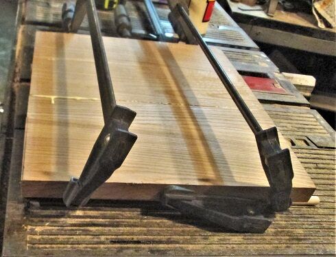

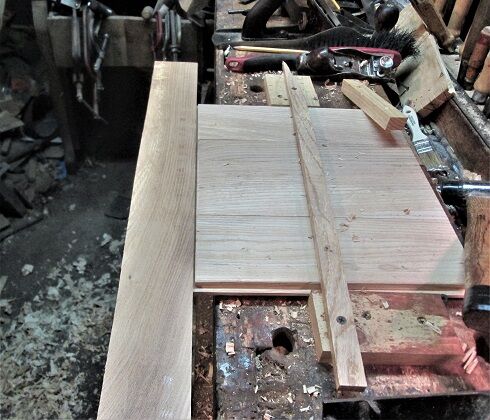

Another use for that jig..:ChinScratch:.then lay out 3 wide parts, and one skinny part, trying for the best looking grain match..

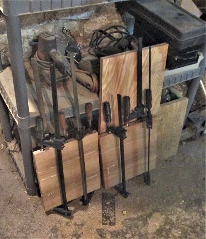

Close enough? before I could do the glue up...had to release two panels from the clamps...kind of needed them.:WonderScratch:
I can clean and square these two up..tomorrow....I also needed cauls, this time around...
To keep things FLAT...until the glue cures.....this is #3....I was able to also glue up #4 panel....:TwoThumbsUp:..but,,,not enough clamps to glue up the last 2...:BangingHead:

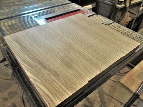

Anyway...Day #5....started out decently enough....had joint a few more edges...and needed extra cauls..
There are cauls on the backside, too...managed to get panel #5 and #6 glued up...
And set aside...and, since the clamps came from #4 and #4....decided to square the ends up on all four of the panels ...:ChinScratch:

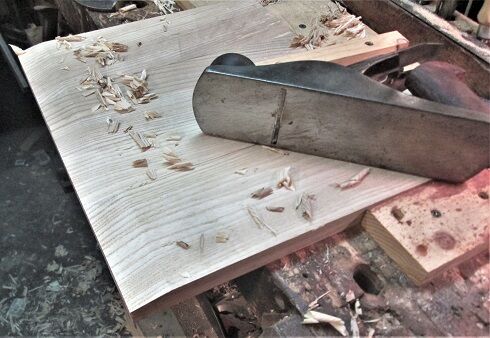

jack plane to flatten (or at least try) and clean up the glue joints...dug out another plane..
Stanley #4,Type 10..with it's brand new handle...Paul Sellers raises a panel using just a plane like this....we have ways..
Draw a pair of "stop lines", where the bevel will ( or is supposed to )stop...
Instead of going across the grain, you go at an angle...working back from the edge until you hit the upper line,,
A little rough, and un-even...come back across the grain..
To smooth the bevel down to the lower stop line.   do both ends first...then the long grain edges get laid out ( after re-doing the jig a bit)

Had to remove the backstop...and get all but the last inch back from the edge of the bench...time for the next planes..
yep, it does fit the groove..plane is a Wards/Stanley#78...Block plane for fine tuning, and clean up..
Going with the grain, the spur is not needed, nor wanted...Block plane then adds a slight bevel...going across the grain..
Spur is rotated down.  It cuts the fibres ahead of the iron...first, I drag the plane backwards and let just the spur do a little line...
Then just plane until you hit the depth stop, and then check for fit..
One more to go....was reclamping things, when....snap...that glue joint that was acting up...broke apart...joint both edge..had a HUGE gap right in the middle,,,then try to re-glue and clamp the thing up:ArguingSmileys:
Circled area is the repair...waiting on glue to cure.....again:Tapping::Tapping::Tapping:
Guess this will have to do, for today....1200hrs until 1530hrs....tomorrow, we go back to just 2 hour days:rolleyes:
