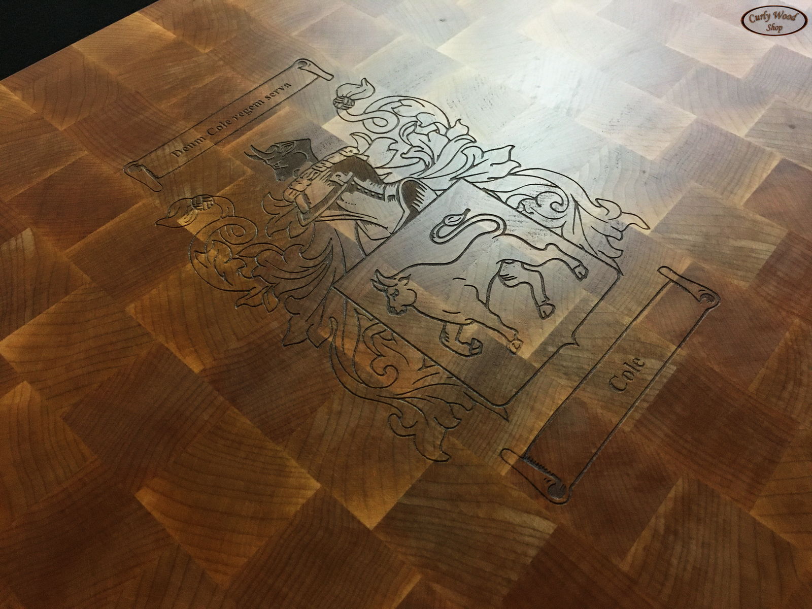

It will have a juice groove along two edges of one side and the other side will be laser engraved with a family crest.  Obviously, the side with the juice groove is the working side and the laser engraved side is for show.  TB III is used because it's FDA approved for food service items, plus it gives a few more minutes of open working time.

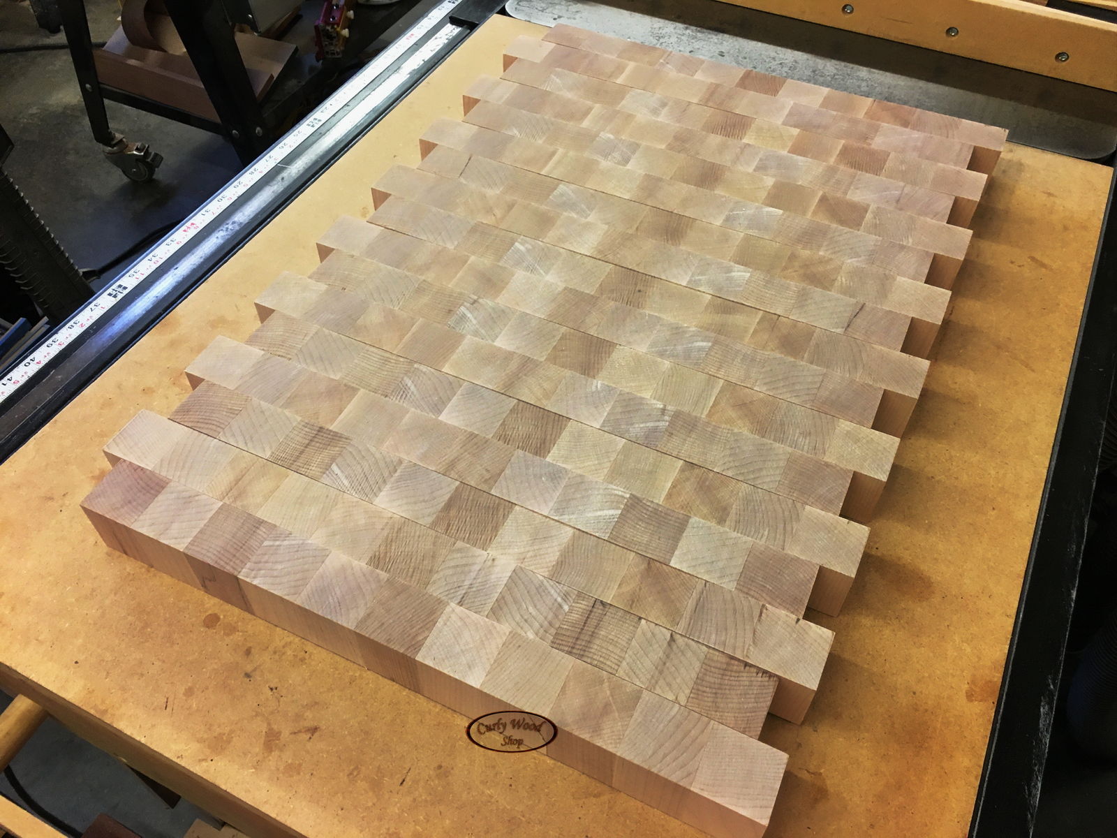

End grain strips set on table saw extension -

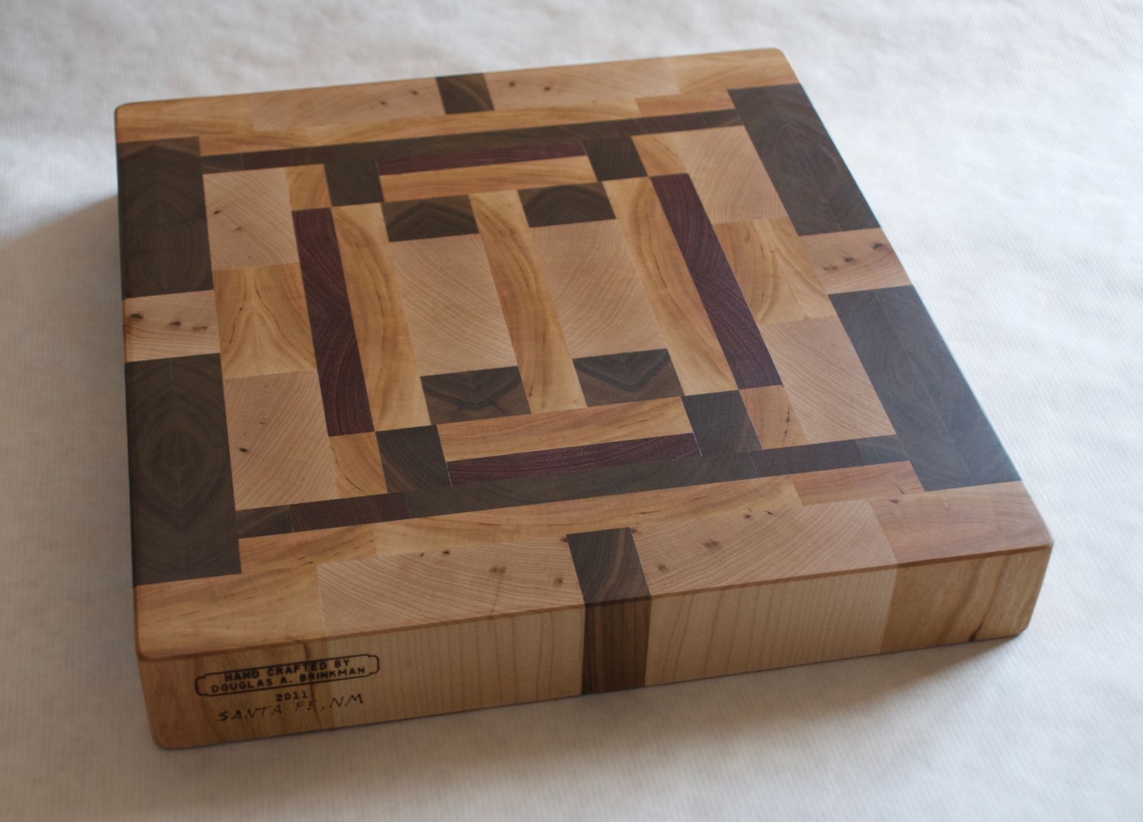

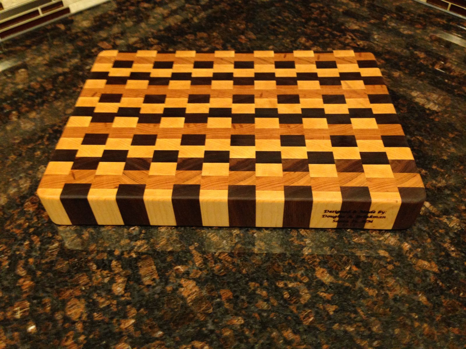

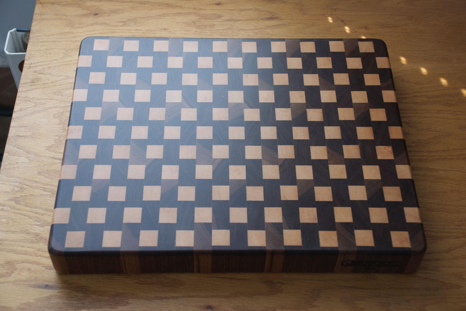

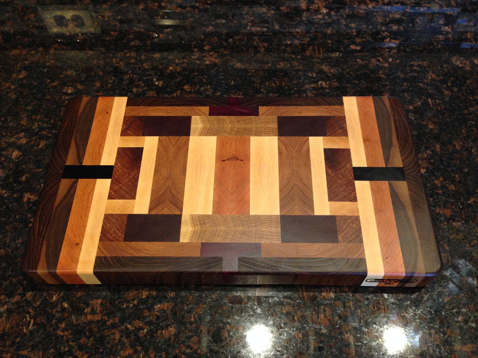

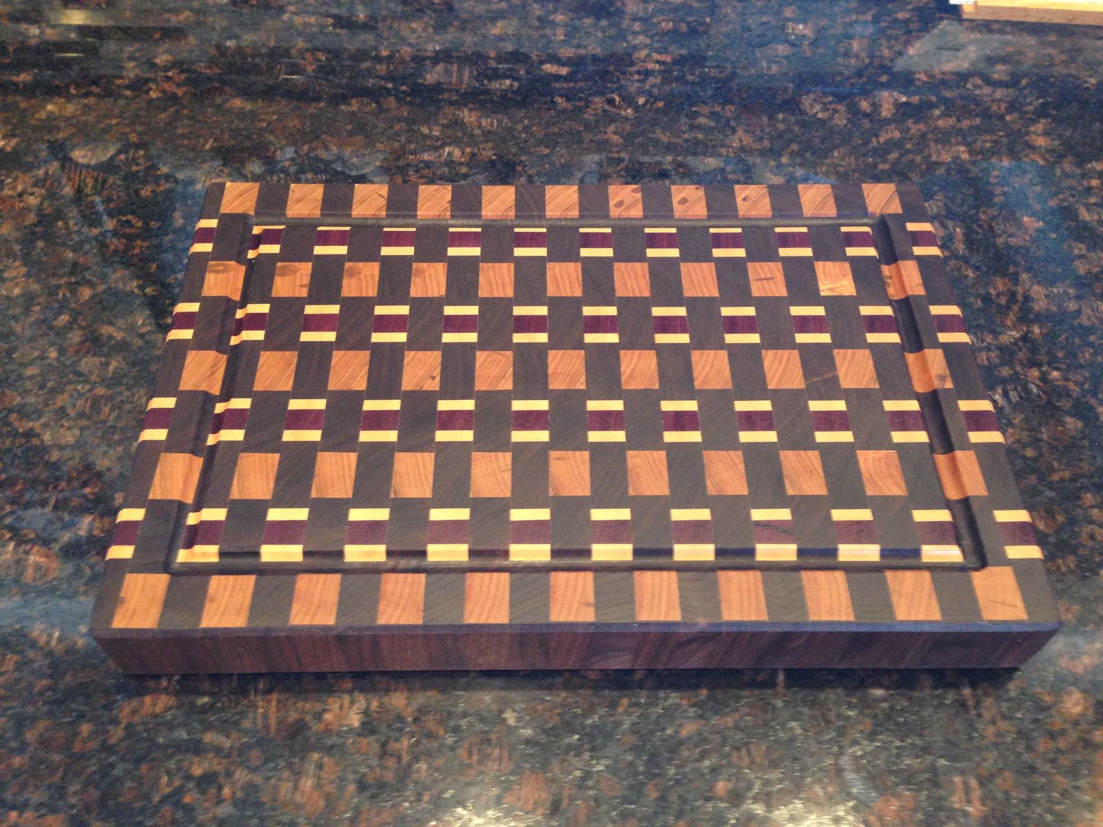

  • a few of the cutting boards i've made over time:   all but the last one are end grain.

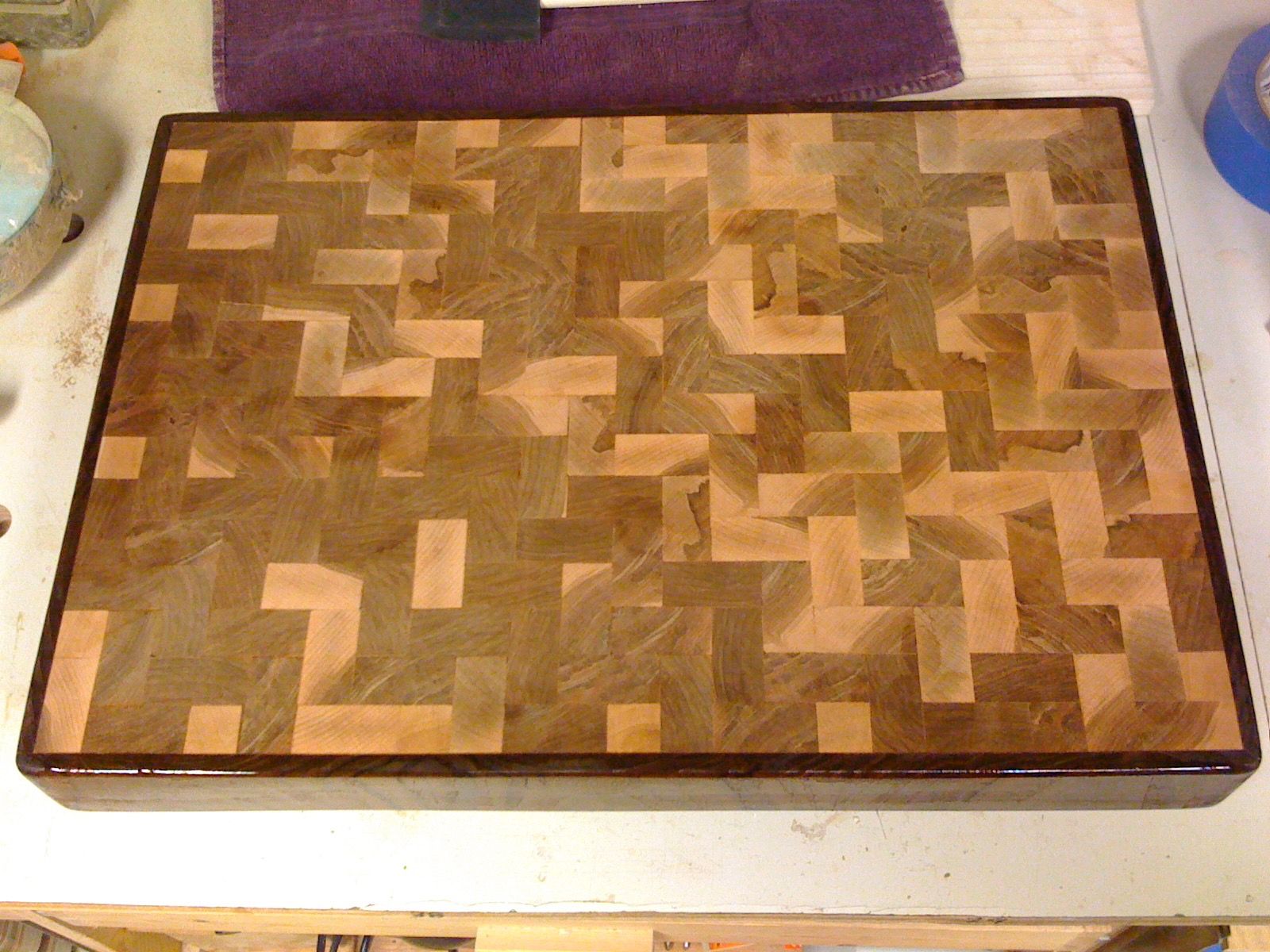

  • The cutting board has progressed through the stages but I forgot to post anything about it - oops!     I cut the outer perimeter down to 1" on the CNC (I don't have a bit long enough to cut
WOW!!!
8 hours ago, Gunny said:
WOW!!!
I second that!

That's the plan.  The pieces on the tablesaw extension are just there straight off the bandsaw, not arranged in any particular order.

Initial layout - probably glue it like this later today.  The end pieces won't be used for the final board but they will have screw holes for mounting to the CNC for cutting the juice groove.
David

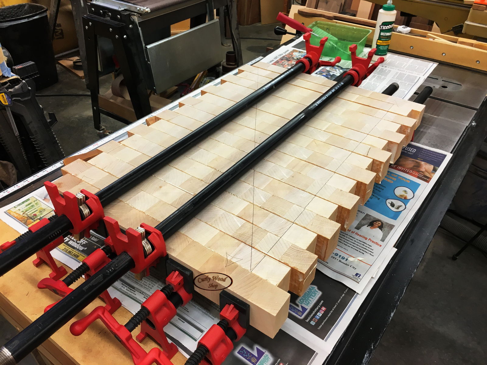

Glued all the end grain strips tonight -
David

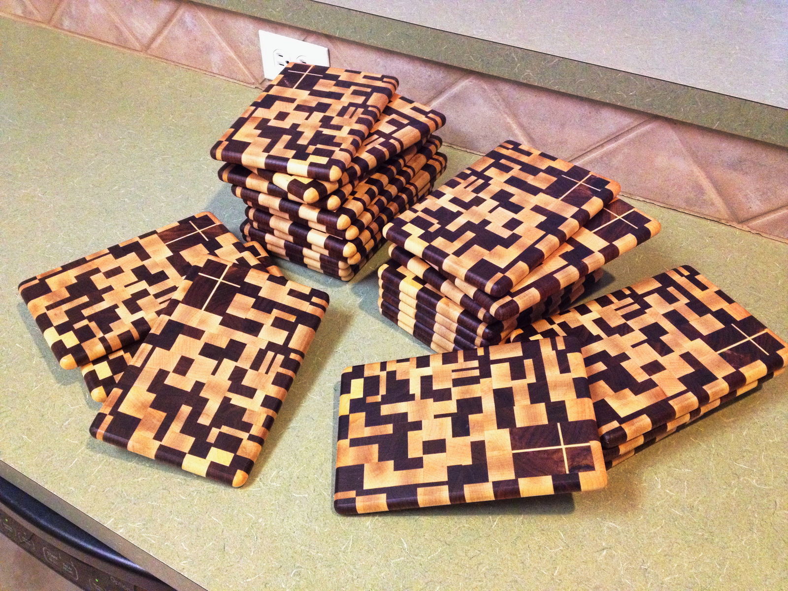

Yes sir, I have seen several in person and many in photos.  But I've also seen a few photos of thinner end grain boards that warped.  We made about 35 small end grain boards, I guess more like cheese boards, and they've all remained flat.  It probably has to do with how the grain was oriented in the build process, whether there's runout in the boards, how flat they were to begin with, etc.
Here are some of the small boards we made (gave one to each family in our Sunday School class and to our church staff) -
