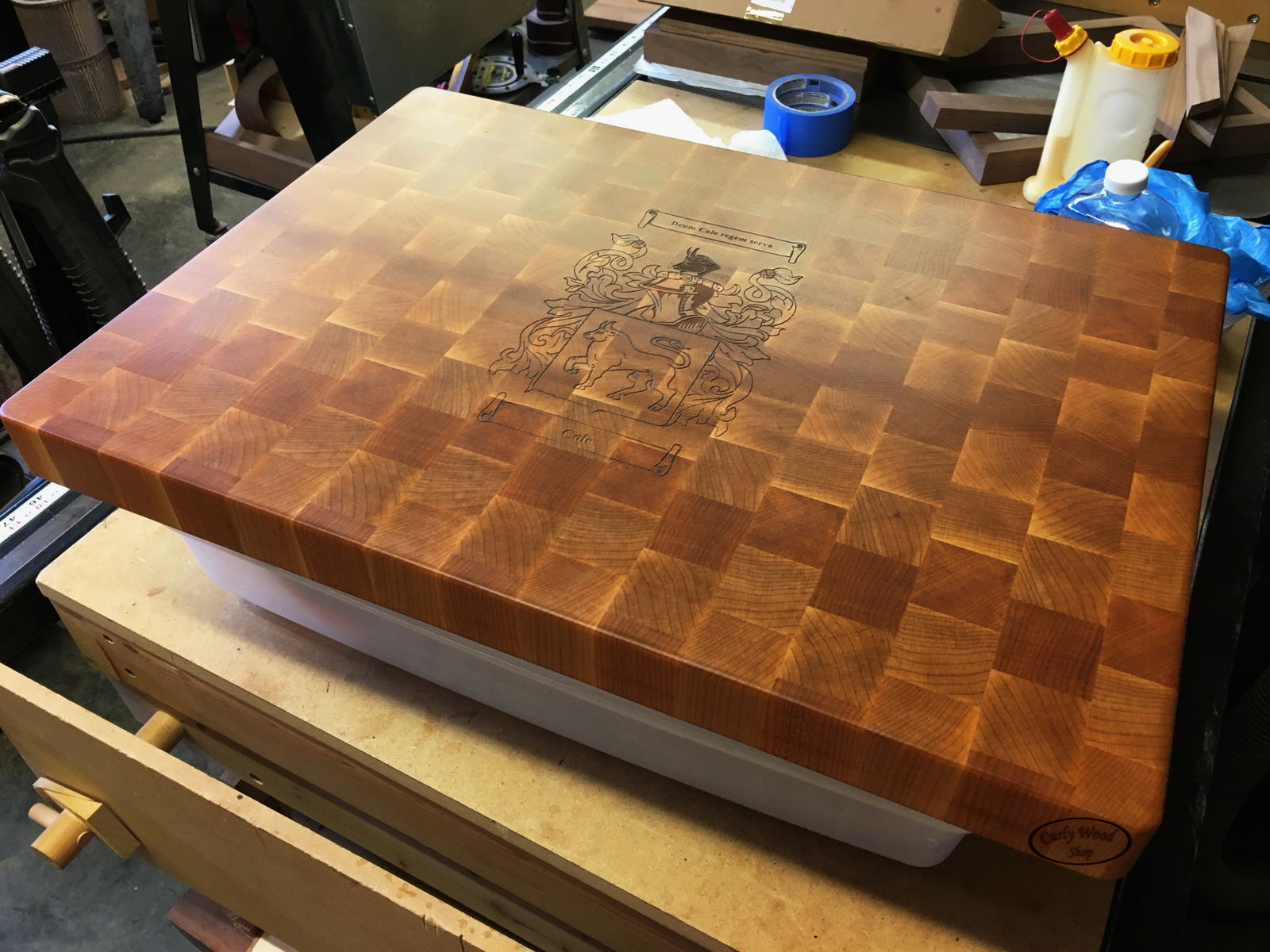

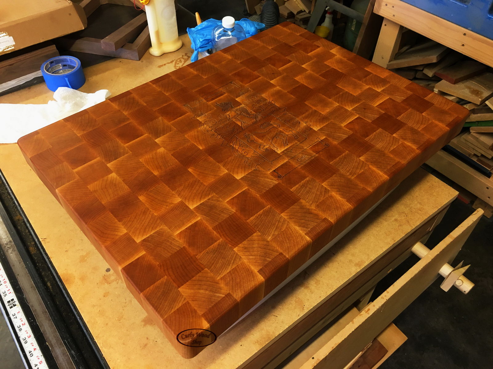

Three coats of mineral oil with the last being a mineral oil/Beeswax mix.  I let that set for about 6 hours and then buff it with paper towels to get the excess Beeswax off.  The cutting board is left with a rich luster sheen that is velvety smooth.
Working side -
Show side -

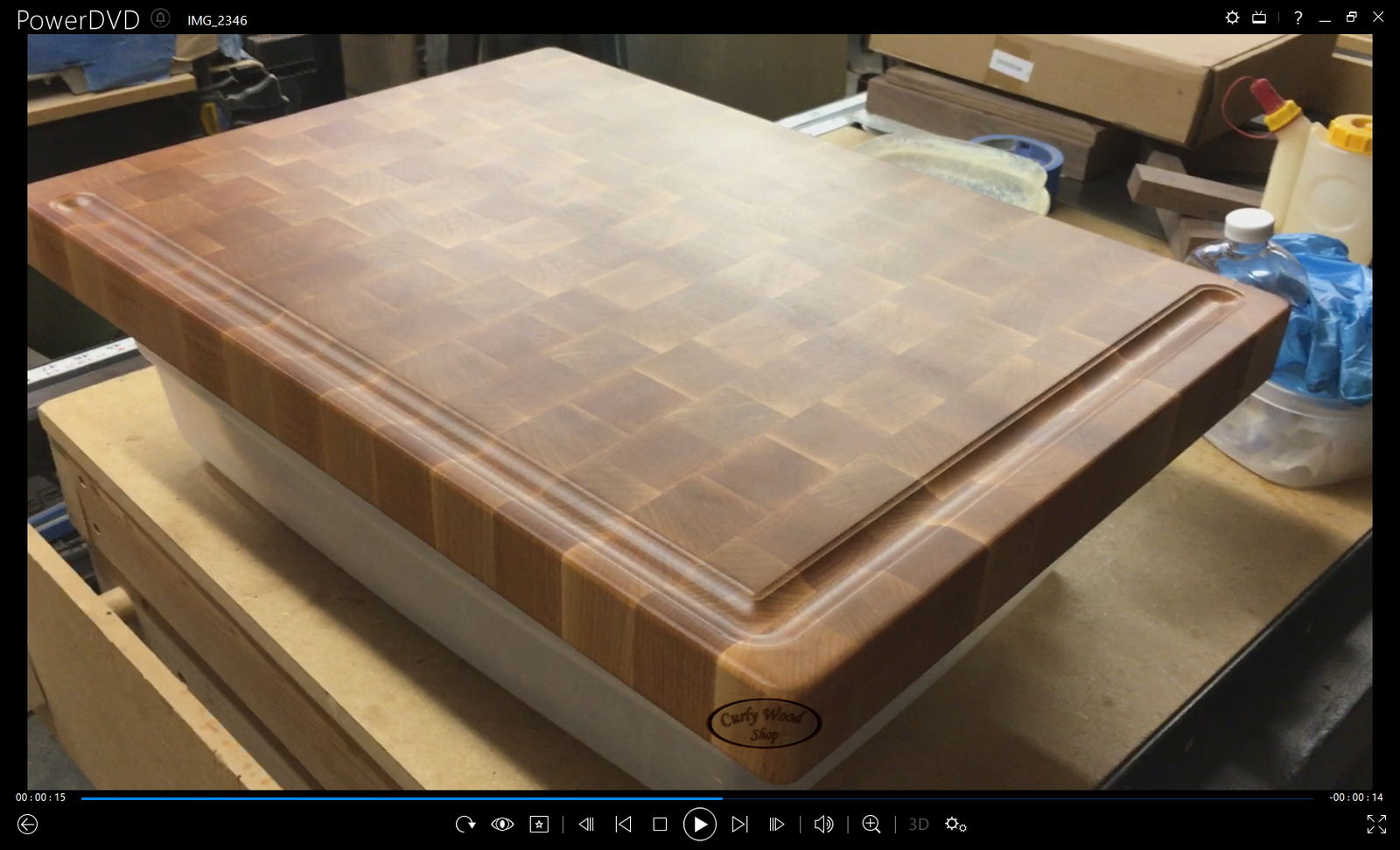

  • The cutting board has progressed through the stages but I forgot to post anything about it - oops!     I cut the outer perimeter down to 1" on the CNC (I don't have a bit long enough to cut
Finished cutting board -
1548409225_030-Finishedboardworkingsidecornerdetail.JPG.ecbe38b3c6e22f2d08bcba3c256a996d.JPG
500342015_032-Finishedboardshowsideengravingdetail.JPG.0e5c6e23229b2945172027dabdc5bda6.JPG
