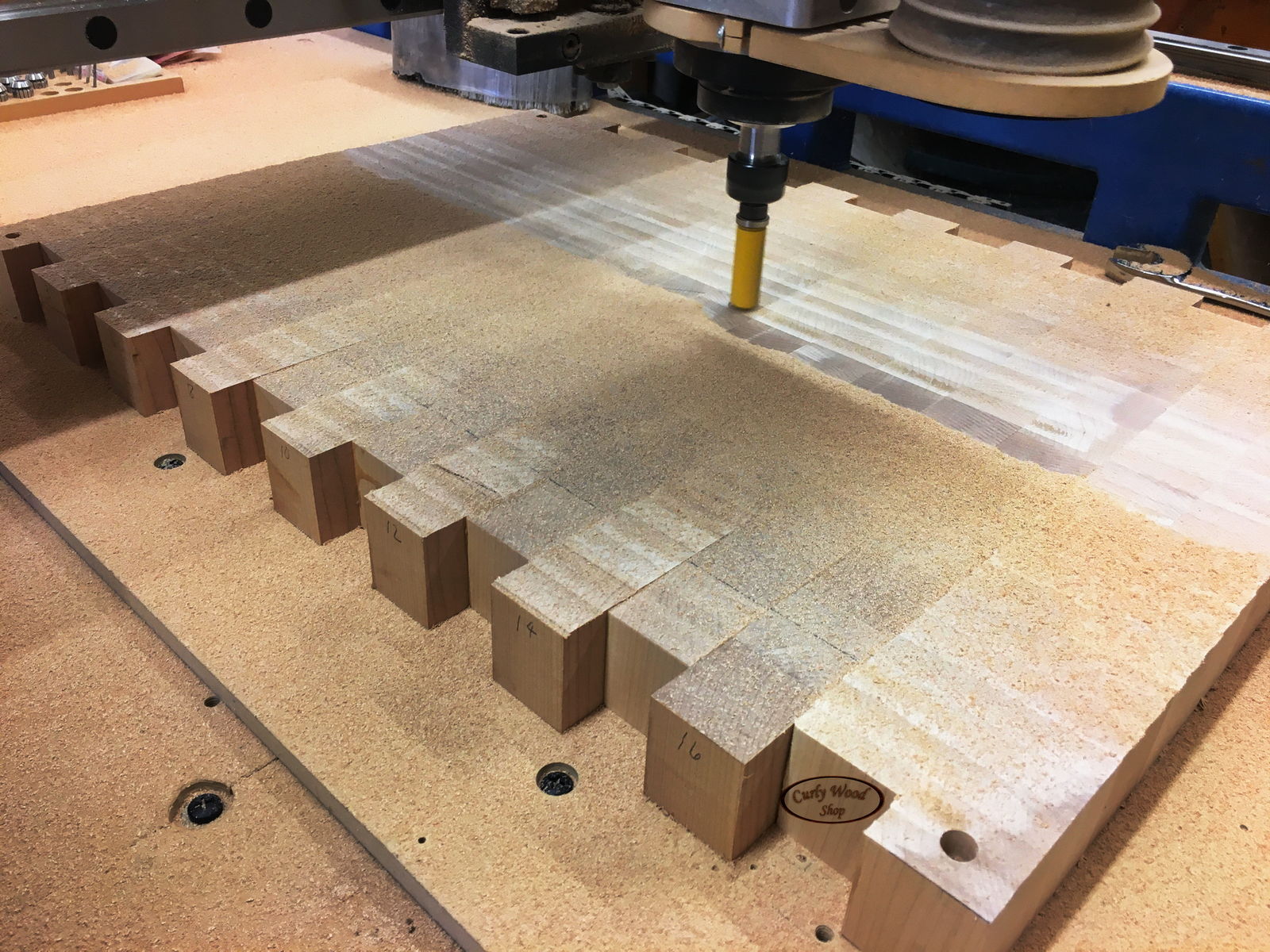

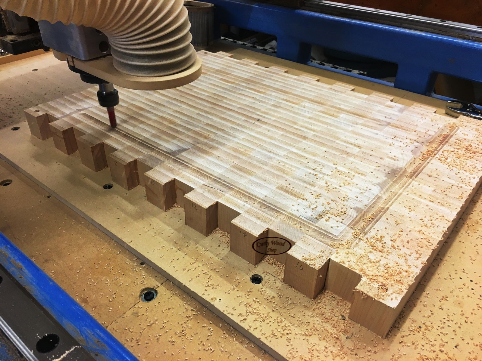

  • The cutting board has progressed through the stages but I forgot to post anything about it - oops!     I cut the outer perimeter down to 1" on the CNC (I don't have a bit long enough to cut

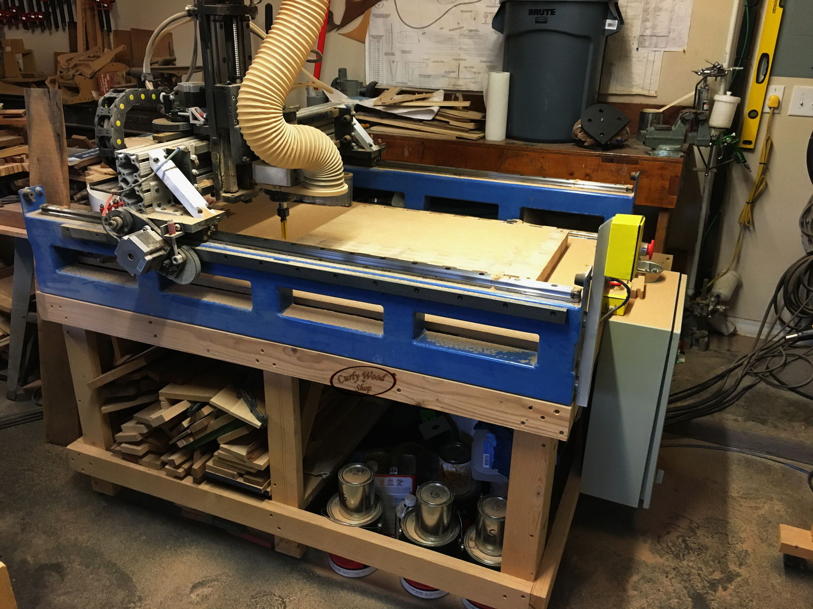

I built it and in the four years since it's been operational it has paid for itself probably three or four times - not too bad.
Here's a wider shot showing the mess this made since I didn't have the dust shoe on for photo and video purposes.  It's rare to see any dust in the shop because I either catch it at the source or clean it up immediately following the use of the offending tool. :rolleyes: With the dust shoe I'm able to collect almost all of the chips and dust.  The trash can on the workbench is temporary and is for converting my dust collector to a two-stage system.

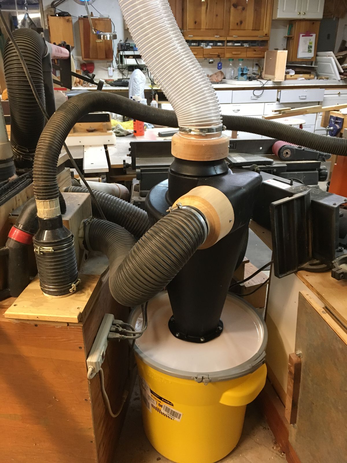

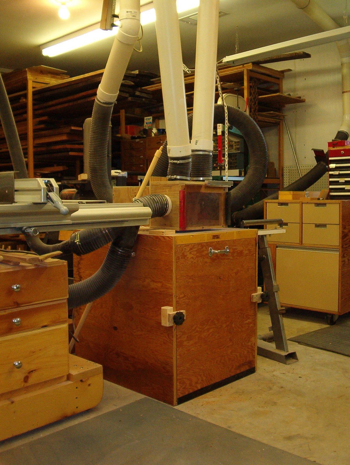

David that is fantastic. I suggest you look at Dust Deputy either the 5 or 6 inch. It really makes a difference in what drops out before the filter and increases suction. I got mine last year and really saves me trips to the attic to empty that bag. Have a homemade one also and it is still in the line now and a lot still goes there but almost all that gets past it goes into the DD.1045840037_DCchipcollection(2).jpg.16cac1a10e6b8bc14251d0a0a3b8c0bb.jpg

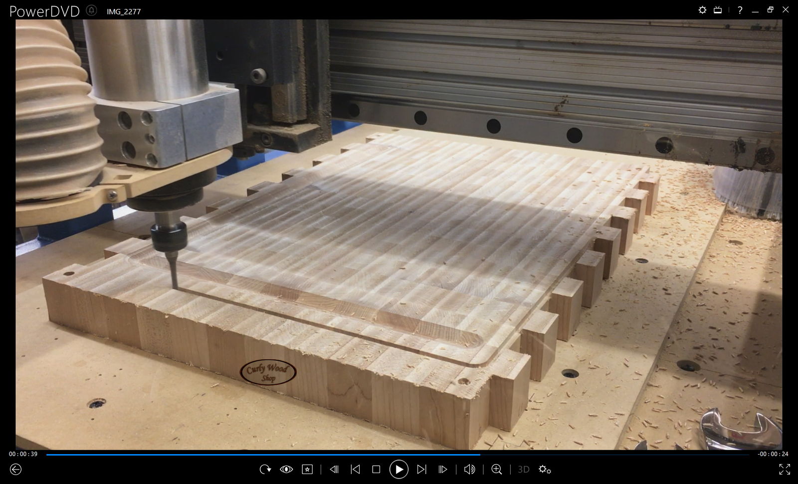

Cutting the juice groove -
David

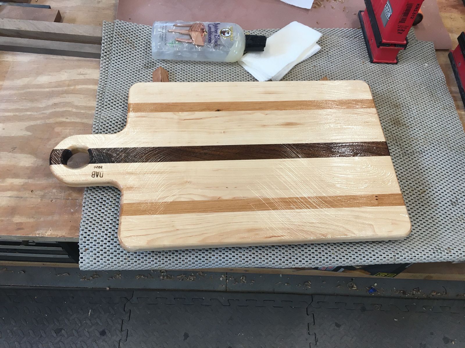

a quick and cheap (made from what i had in hand) cutting board of maple, cherry, and walnut.  edge and face grain, gift for someone.
don't worry, the excess finish got wiped off later on.
Edited by DAB
I like it a lot. Great job and it looks beautiful.
I cut the outer perimeter down to 1" on the CNC (I don't have a bit long enough to cut through 2" of material).  Then used the bandsaw and tablesaw to cut the excess pieces off.

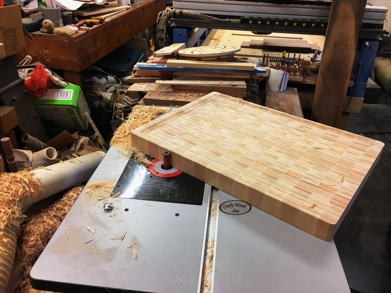

Then I used my router table to flush trim the sides -

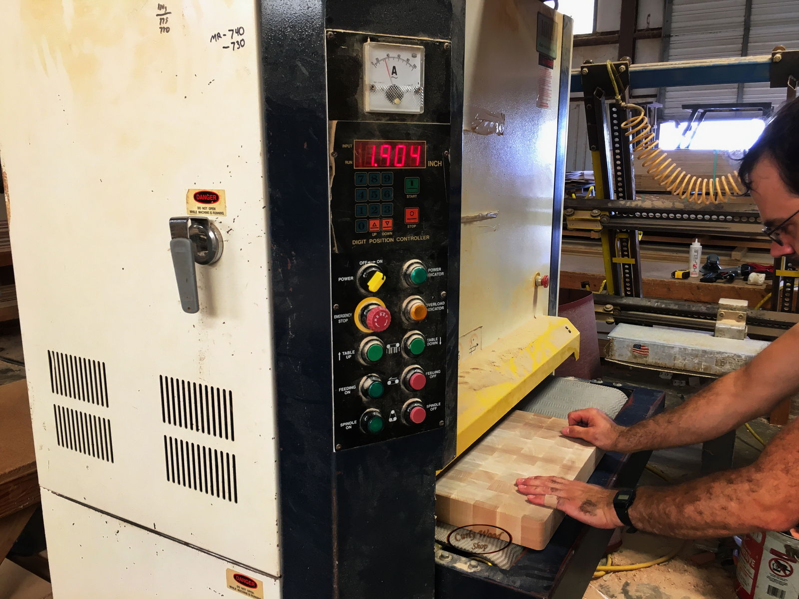

My drum sander is wide enough to handle this board but the juice groove was causing issues because the pressure rollers tried to dip down when that went through, so I carried the board to my friend's cabinet shop and it took all of about 6 passes to sand this on his wide belt sander -

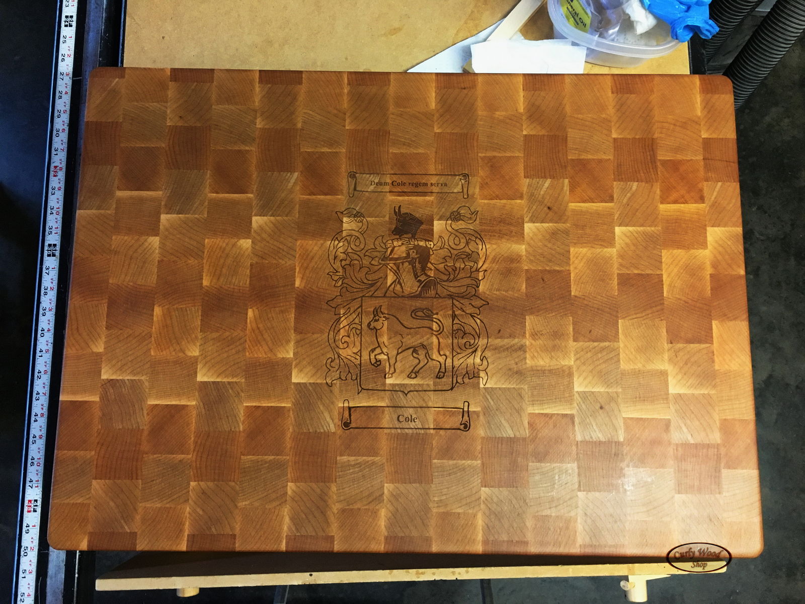

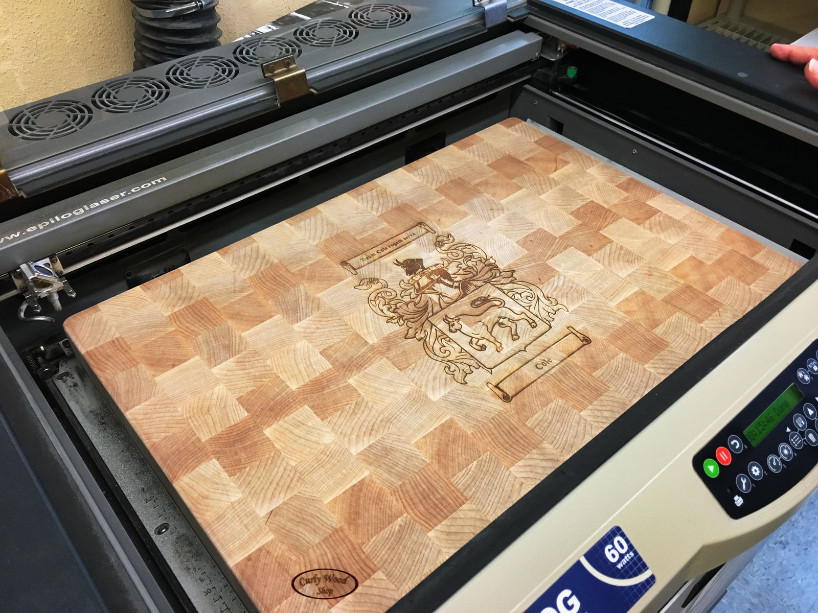

Then I finished sanding with 120/220/400 and will take it to the laser shop for engraving -

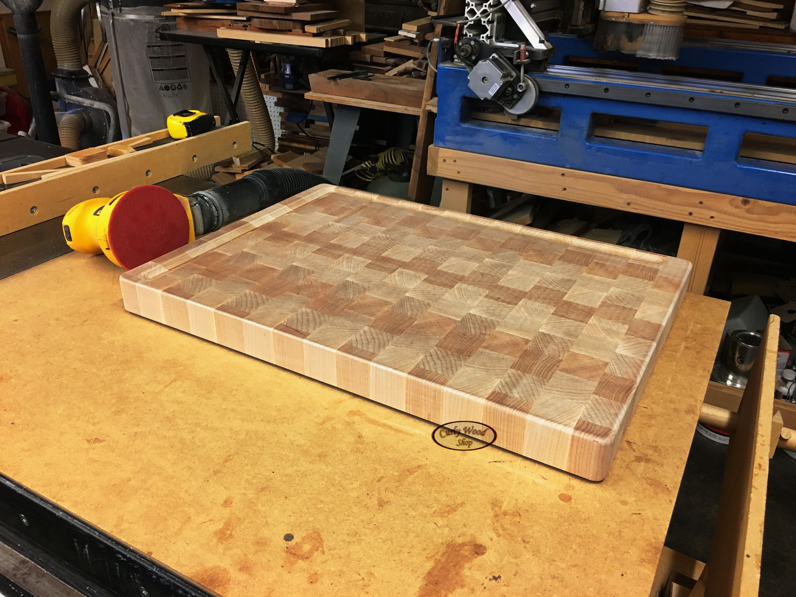

As you can see, this Hard Rock Maple can get really smooth if you take it down to 400 -

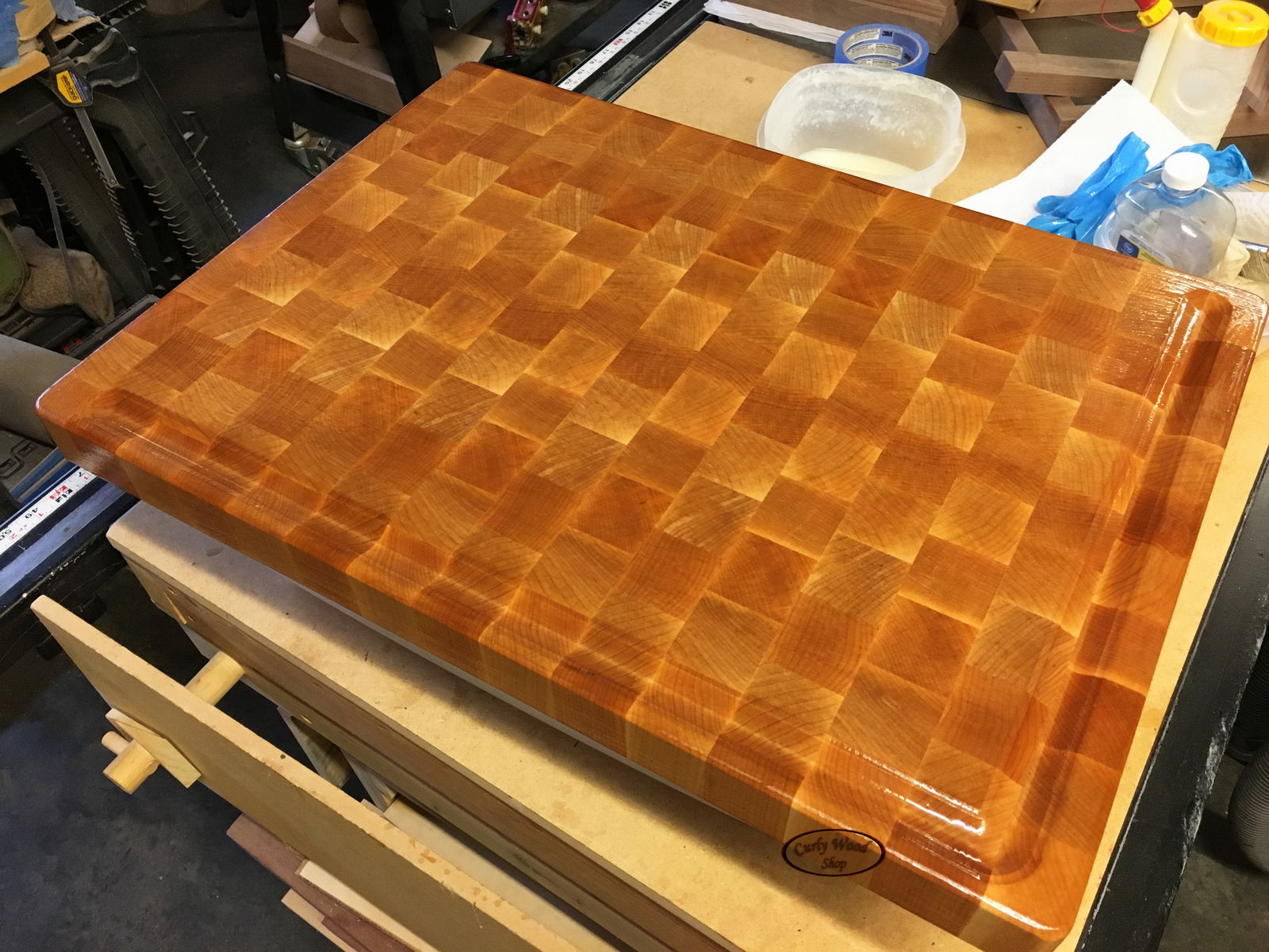

We're finally at the point where I'm applying the mineral oil and Beeswax finish.  Got the cutting board laser engraved yesterday and have now put three good coats of mineral oil and let that soak in and am now applying a good, heavy coat of Beeswax with mineral oil (my mixture).
I'll let the Beeswax set for about 4 hours and then wipe off as much as I can, flip it and do the other side.  I'll continue wiping it down until it can go a few hours without seeing any wet spots.  This part could take a couple of days.
In the Epilog laser right after engraving (you can go to my Instagram and see the engraving in motion) -

Beeswax applied, it's a nice, rich color -
1729427419_025-ThreecoatsofmineraloiloneheavycoatofBeeswax.JPG.aca8eede54370fc0a74722499f25a810.JPG

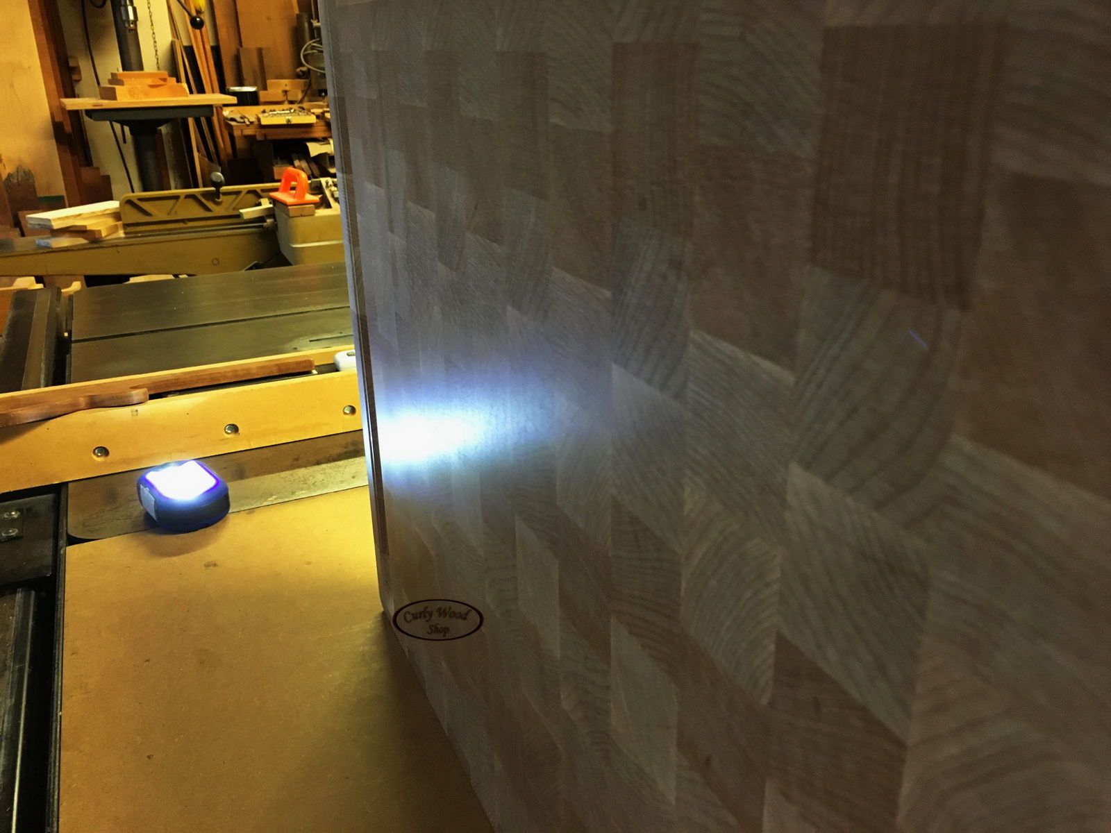

Three coats of mineral oil with the last being a mineral oil/Beeswax mix.  I let that set for about 6 hours and then buff it with paper towels to get the excess Beeswax off.  The cutting board is left with a rich luster sheen that is velvety smooth.
Working side -
Show side -
