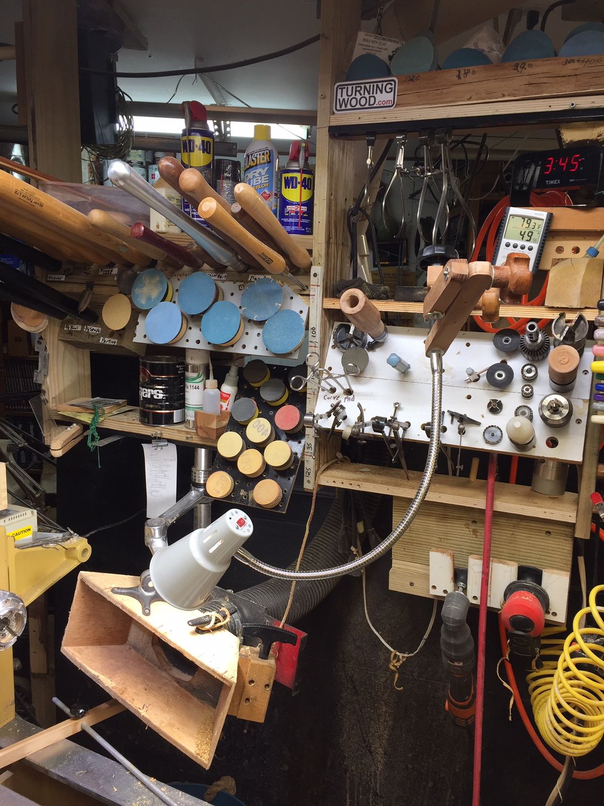

  • May have posted part of this before but these are shots of the sanding organization at my lathe station. The Roloc pads are screwed into pegboard which has had a proper size hole drilled. This does no

May have posted part of this before but these are shots of the sanding organization at my lathe station. The Roloc pads are screwed into pegboard which has had a proper size hole drilled. This does no damage to threads and is easy to retrieve .2080707097_Sandingdiscs.JPG.bc89c57dd010ff41a9078a8e70c3b47c.JPG
Sanders hang ready for use.

Gerald, I like your sanding assortment.  Would you care to elaborate on sizes of the discs?  The upper panel sizes are larger than the ones in the lower section.  Do they attach to a power tool or insert into one of those hand holds like Cap'n Eddie makes?  Thank you.
Steve the smaller are 2 inch and the upper are 3 but slightly larger since the blue is from Vince's. This is a Roloc system the pads screw onto a mandrel. In the lower photo to the right side are two round black objects with silver center, these are the mandrels. This system comes from https://woodturnerswonders.com/
He has both round shaft and new hex ball end extensions up to I think 8 inches. It could fit into any handle that has dimensions the same as the post.
But my interface pads and gold sandpaper I prefer come from SandingWood.com .
