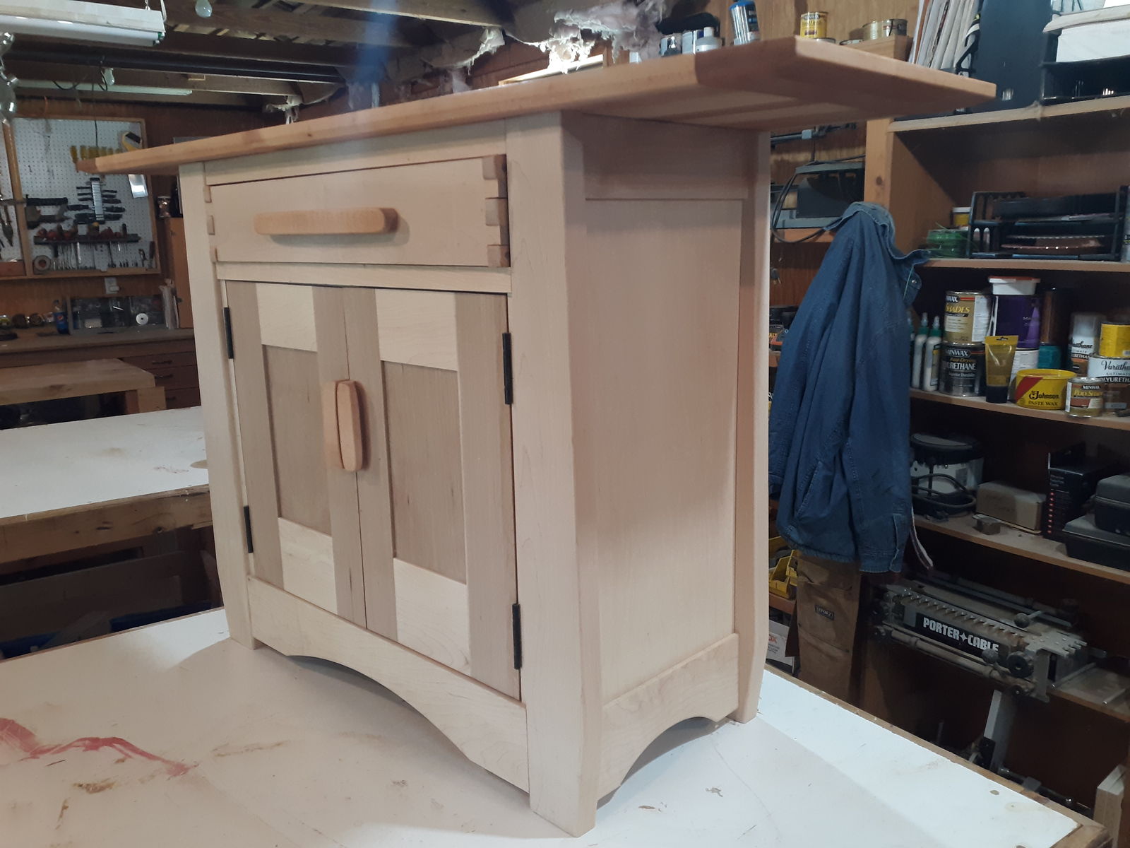

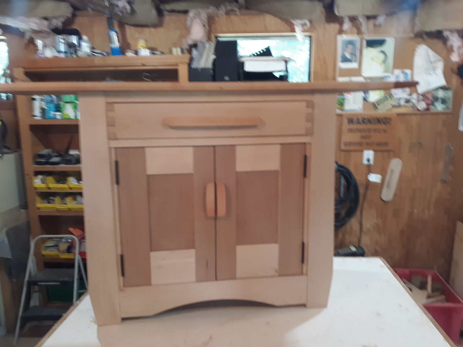

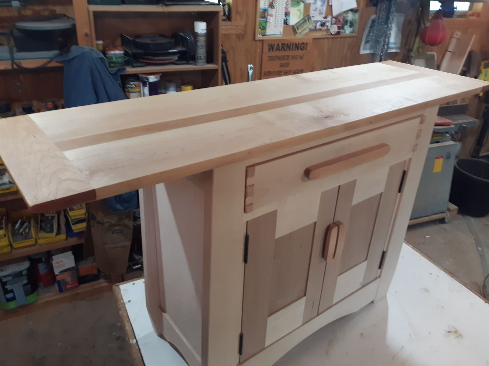

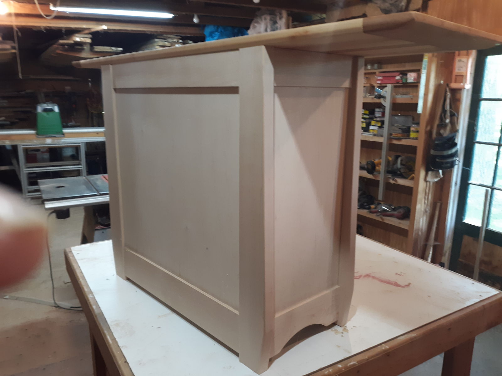

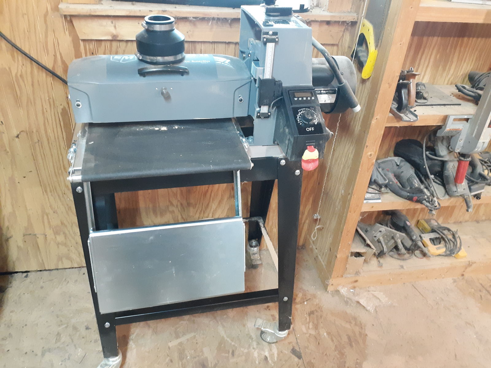

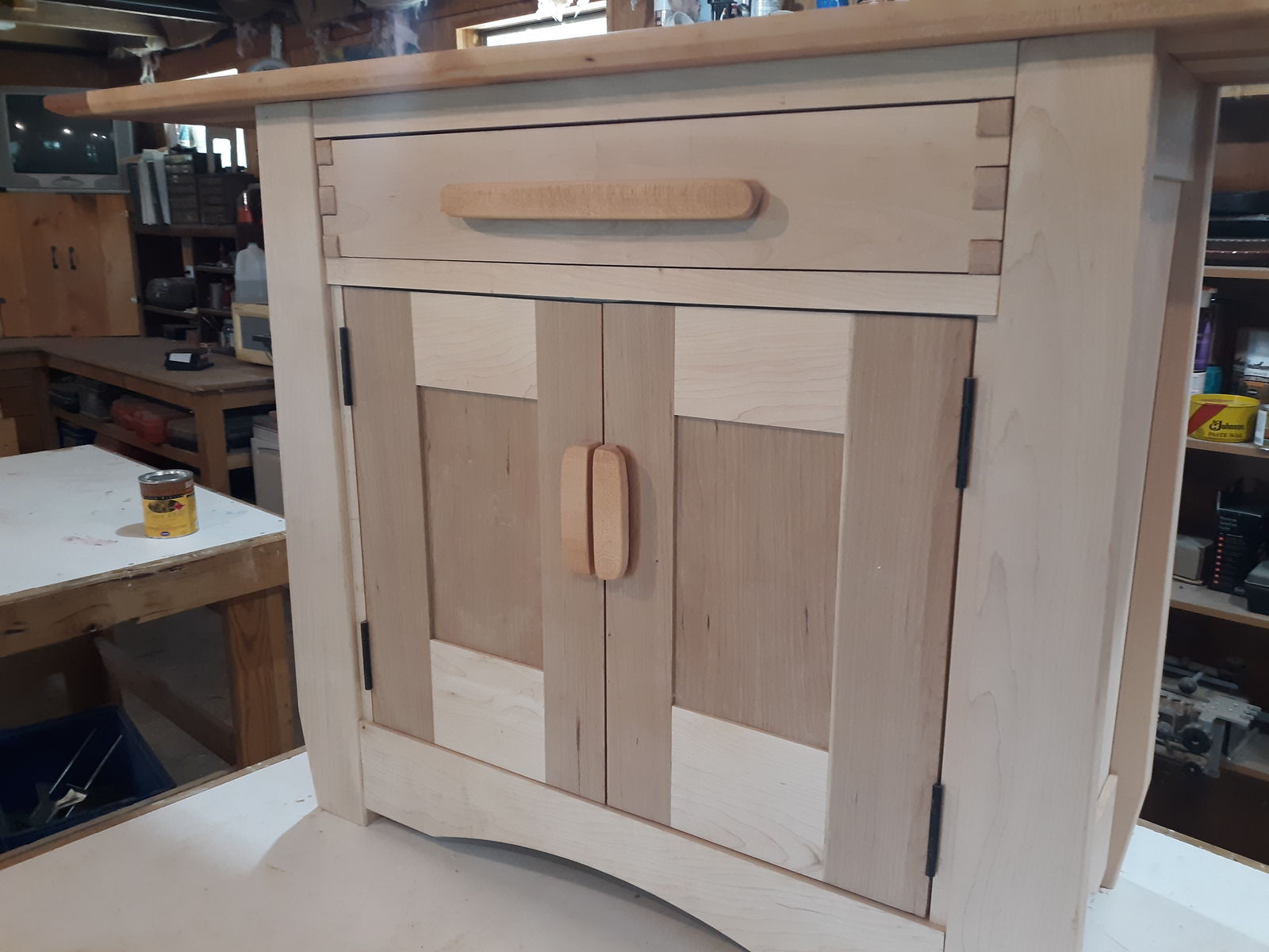

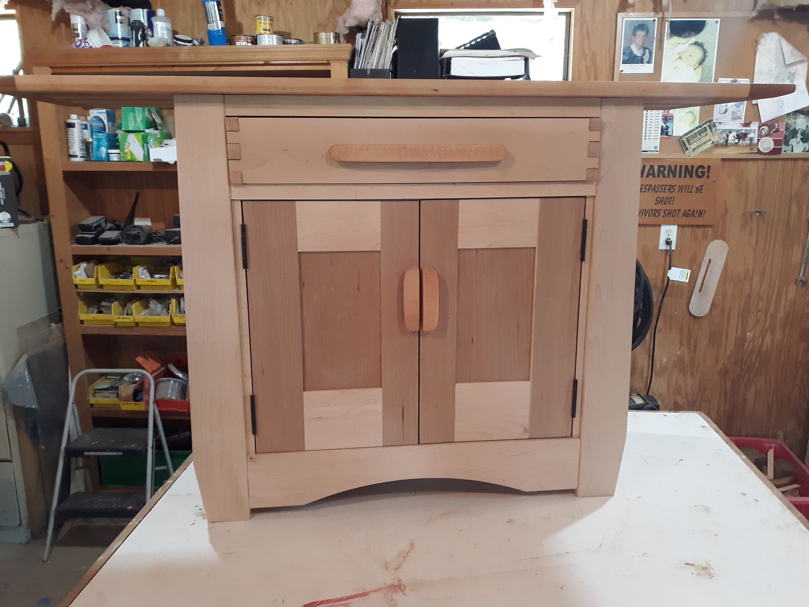

John, Here is a set of pictures of my latest project that is causing the angst in finishing. It is a side table, a hose warming gift to my daughter and son in law for their new house. It is maple with the darker sections in cherry. I also threw in a pic of my drum sander retirement gift to my self. I am rather a novice and feel more so after seeing some of the projects other members here have shares. There are obviously some very talented woodworkers on this site.
Regards, JJ

Wow, John, that is one awesome table and equally awesome job.  You have some skills and in a few more years, you are going to be a master.  Keep up the good work, friend.

@junglejohn, this is why I asked, because many of the finishing fears can be put to rest if you use a wipe on finish, no runs, no fuss, no mess, and your side table is a perfect candidate for a wipe on finish, by the way, you are no slouch yourself when it comes to woodworking, great job!
To start with, you could just go with an off the shelf brand of wipe on such as Watco Danish Oil, this will get you on the road to understanding the wipe on wipe off process, then later you can delve into making your own wipe on finish.
When working with solid wood furnishings like you have here, the bulk of the prep is in your sanding, the wipe on wipe off is the easy part. I like to sand up to 400 grit at least, often I'll go up to 600 before a wipe on finish. Then between coats whatever your highest grit you ended with during prep, you can use between coats, I have found with Watco, I like to apply at least 4 coats.
Nice piece there John! Congratulations!
I'd like to add one more plus about wipe on finishes, specially with solid wood work like you have here, I personally don't like a perfect glassy smooth finish, I do like the "in the grain" finish wipe on provides, you'll have some texture left when you are finished, to me the smooth plastic finishes are not attractive.
