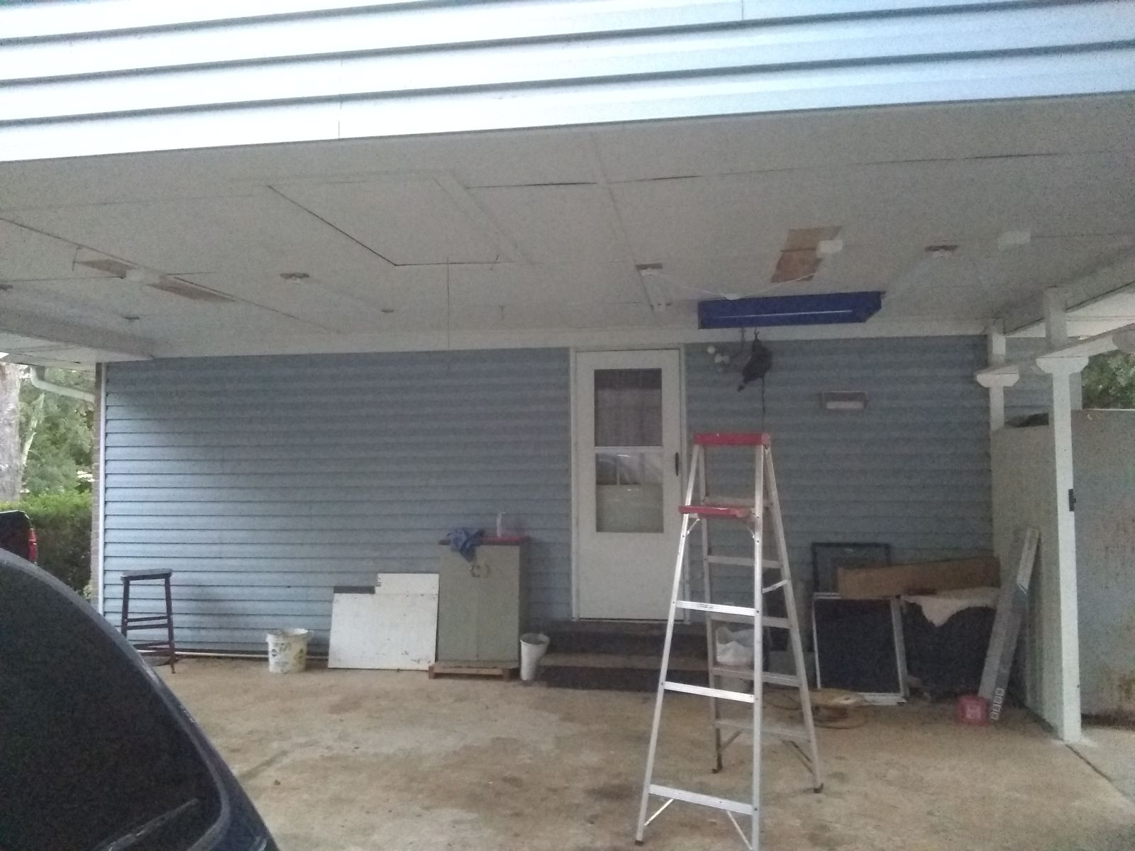

With my deck refurb in the finishing painting stage I can now work on next outside project.  For whatever reason the rest of the house has vinyl siding and soffits, but he carport seems to have been left out.  For many years I have just painted it, but now I just want the vinyl soffit and be done with it.  Of course while I am at it a few upgrades are in order.
First up is a improvement to the lighting.  When it rains or I need to work after dark the carport offers the best place and plenty of work area.  But only two 4 ft fluorescent fixtures provide very poor light.  So I am thinking to add eight 4ft long LED fixtures.  That should cover the 22x16 ft area with plenty of light.  In theory.
So today I have removed the old fixtures.  Conducted chemical warfare against the wasps and hornets that had taken up residence inside the guts of the fixtures.
These lights have been up for 33 years according to the date stamped on one of them.  You can see in the picture at one time the ceiling was a golden / yellow color.
Not worried about painting this, I intend to cover the works with vinyl soffit.  I have enough in stock to do about 2/3 of it so this should be a $100 project.

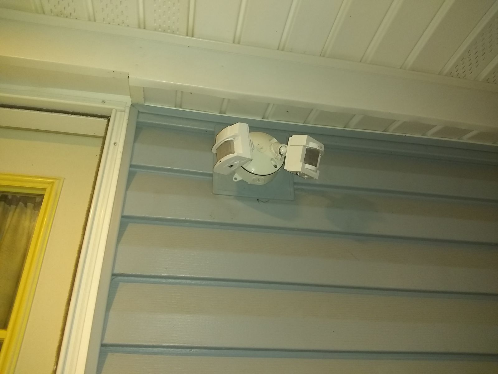

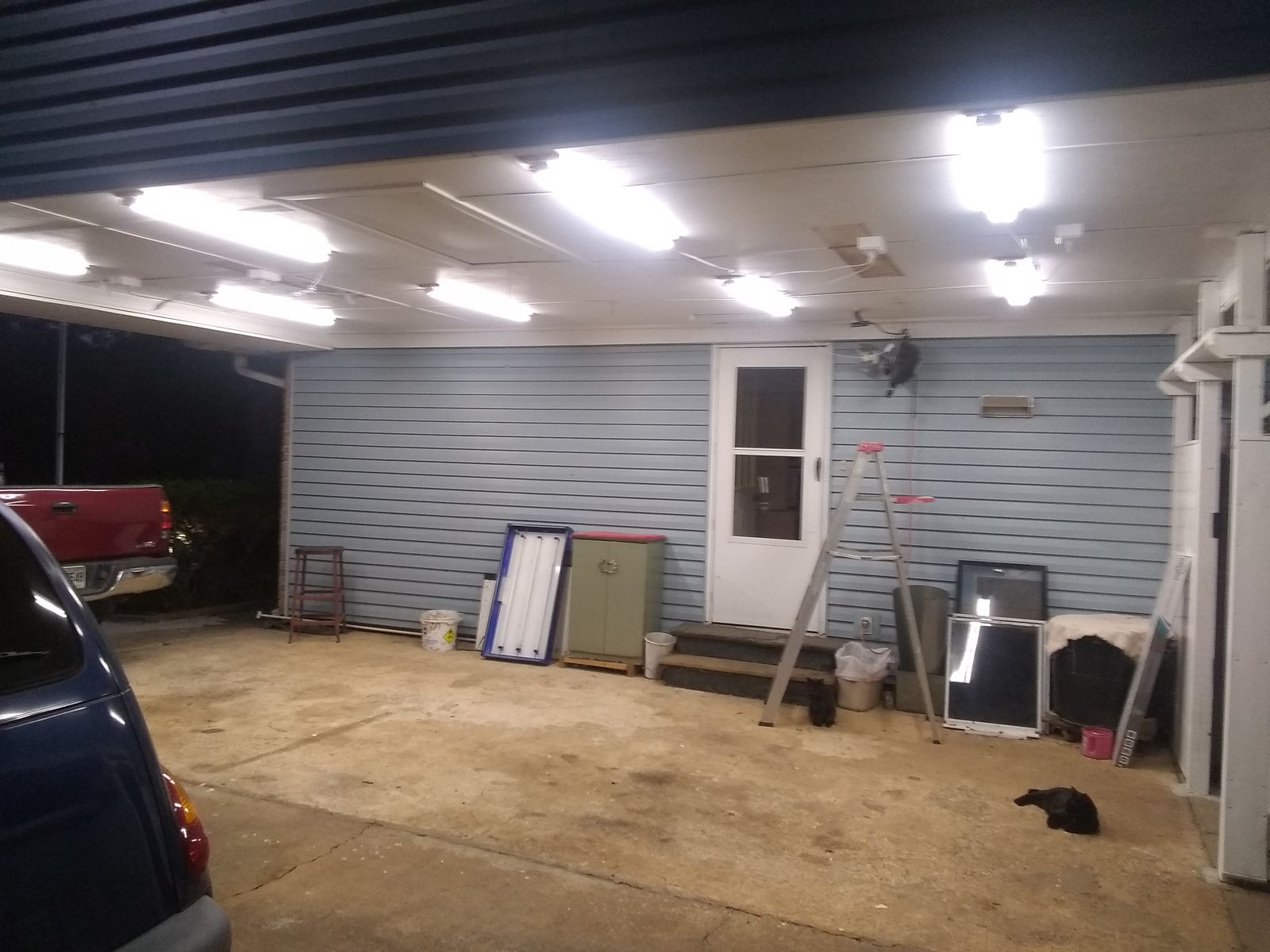

Got a delivery today of 4 more lights so I got busy and installed them.  Pretty pleased with the end result.  Plenty of light when needed.  Still working on what light works best for the motion light we have by the side door.  I did a temp install of a short LED bar light and a 20 watt LED floodlight.  Have to see over next few days what I like best.  Did discover that with the LED main lights on the motion sensor thinks it is daylight and does not work. :D
This was 4 LED fixtures few day ago.
This is 8 LED fixtures this evening.
