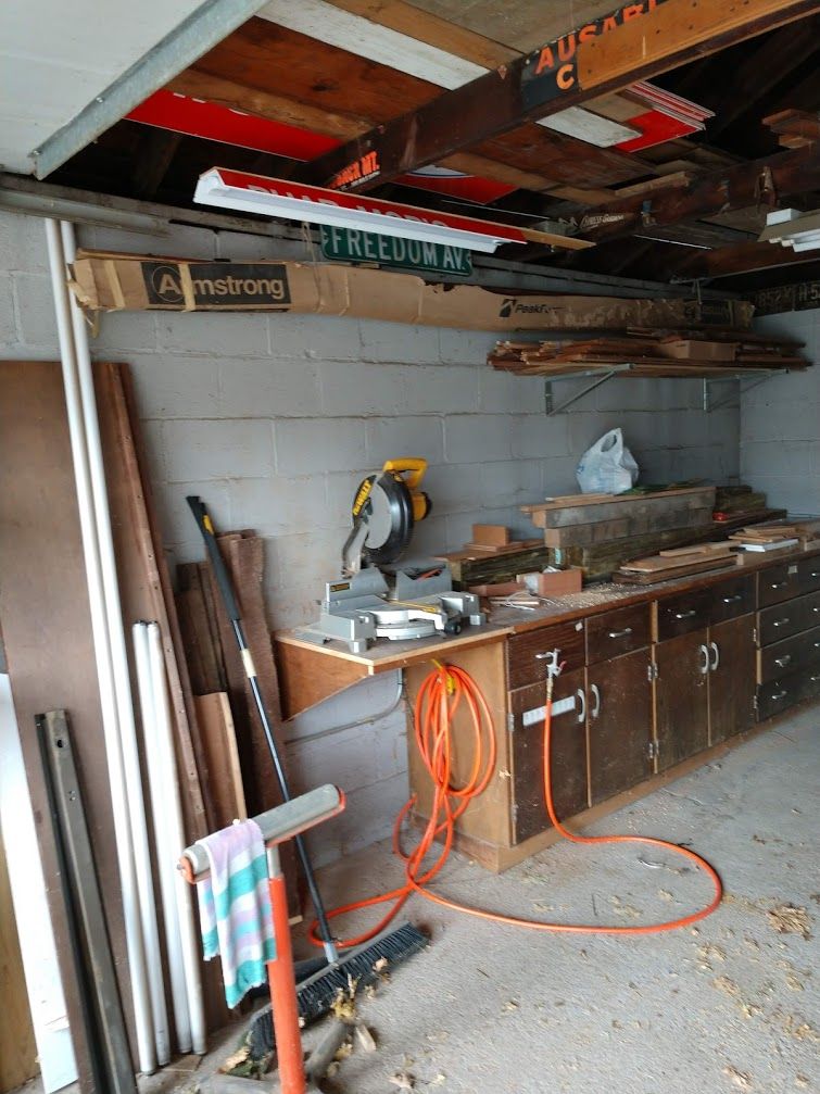

@FlGatorwood keep in mind that the LEDs are only on the bottom of the fixture with a light reflection at 180 degrees. I screwed mine to a board that allowed me to center it over the saw. I have since added one to light the rest of the work area. At about $13.00 for a 2 lamp fixture I've been hard pressed to find anything cheaper.
led1.jpg.5b9b26738790c5de66ea768eefbbf625.jpg   led2.jpg.10325e80c05220876772333b8ceb4276.jpg

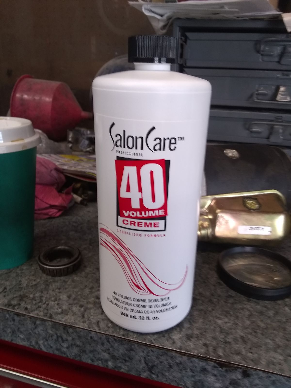

Progress is slow.  Not much actually to show for what has been done.  Cleaned all the soffit, it was dirty from being stored.  Had a few pieces that had turned yellowish.  Found a youtube video that suggested I could bring them back to white by using Salon Care 40 volumizer crème and letting sit in the sun for a few hours.  For $4 I got 32 oz bottle and tried it out.
Excellent results.  I smeared it on and put saran wrap over it to keep the cream from drying out to quickly.  After 4 hours I rinsed off and all back to white.
So with this test done I will do the other 3 pieces and if all goes as planned, I have enough to do this job.  Just barely. At most I need 1 piece of 12ft siding.

Interesting tip about the Salon Care 40 Volumizer (whatever that means) creme...I'll have to write that down somewhere (I know I won't remember it).
Got this at Sally's Beauty Supply.

I wonder if any other hair creme would work as well.  Something that could be picked up in a regular department store.
Not sure, found the idea on YouTube and the guy used this.  Said it had 12% Hydrogen Peroxide.  As I found it quickly and local I never bothered to check into anything else.  Of course the woman checking me out had the Mr. Spock Eyebrow going on.
Probably didn't help when I asked if it worked good on pubic hair.  :JawDrop:
Ah!!!! Hydrogen Peroxide.  Secret's out.  Thanks.
