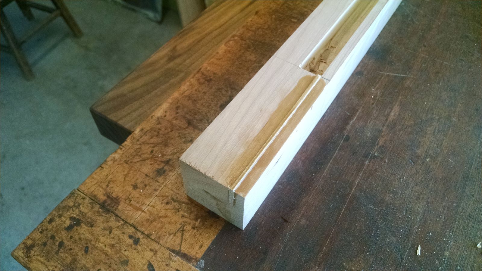

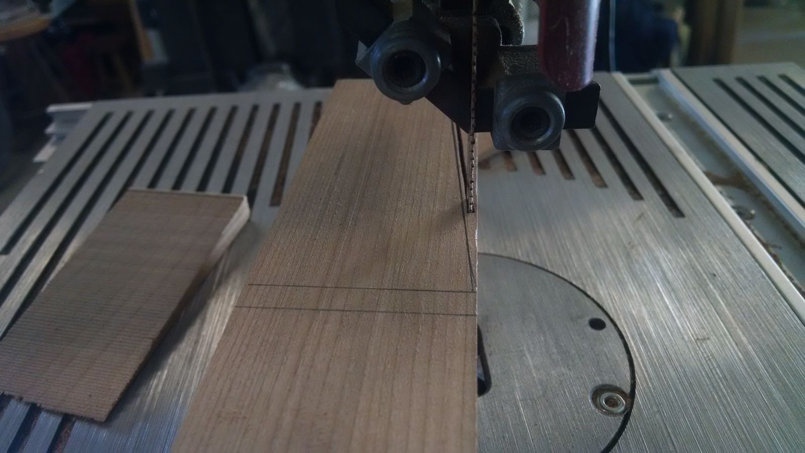

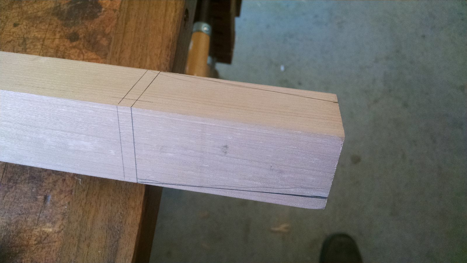

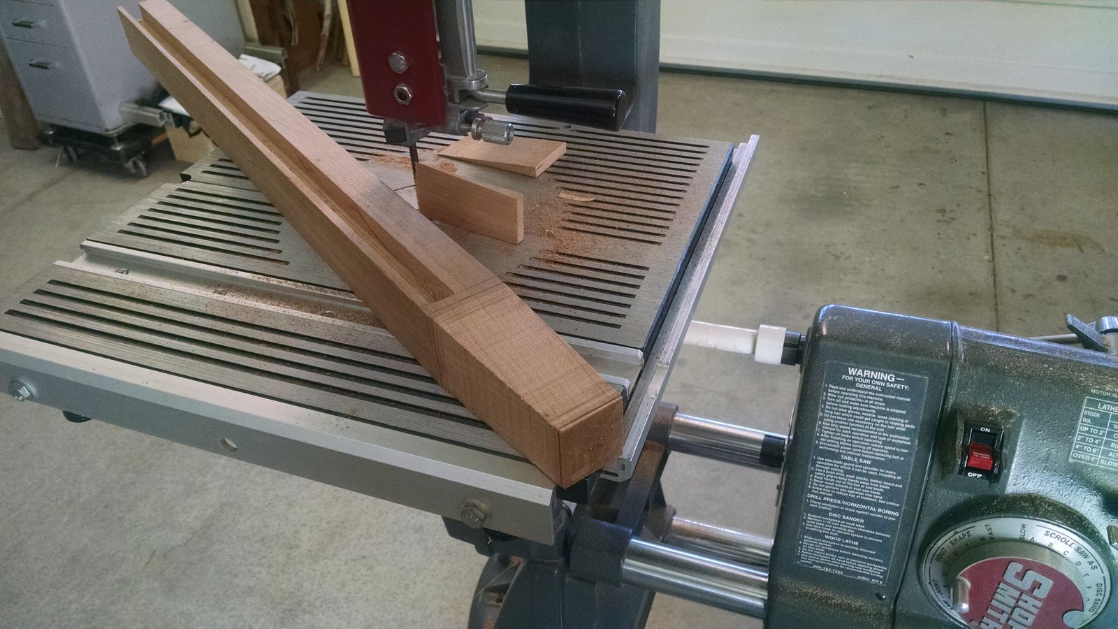

Popular Post John Morris Posted August 17, 2019 Author Popular Post Report Posted August 17, 2019 Well here we are folks, a little update from the last one. We actually worked on this project last weekend but just did not get any new images up of our progress, and while my son was in school today I worked on the desk a little as well, so here are a few updates. So, how about a knuckle head mistake! While grooving the dadoes into the legs for the desk panels, the first cut, on the first leg, right off the bat, I ran that sucker right through all the way! Made a nice clean groove from one end to the other, it was supposed to stop 4 inches up the leg, but boy did I show it! So I took a spline of cherry and glued it into the mis-hap slot and planed it down flush and no one but me and my son will ever know, and of course you all! Then the tapered legs are laid out, the orientation of the tapers were actually a bit confusing for me to come up with, without tapering the wrong side. I am not sure if my mind is still really slow from current health conditions, or I'm just out of practice, but I really sat there and had to think about this simple operation, we want the taper on the insides of the legs, not all around. So the front corners of the legs should be straight, and the back and sides of the legs should be tapered. I finally figured it out, really, it was ridiculous how long I sat there and just stared at them till I got the pencil lines down. My brain is slow these days, it truly is. I took the legs over to my Shopsmith band saw and cut the tapers, leaving some room for clean up with the plane. The legs are tapered. With my No. 4 I planed down the bandsaw marks. The tip of the legs, I took a block plane and planed chamfers on the edges, to prevent the legs from splintering on carpet and what not when in use. When doing an operation like this, plane with the grain first, then you can tackle the grain that is perpendicular to the edges. If you chamfer the perpendicular grain first, you'll likely have chip out and splintering, so to avoid that, chamfer the easy grain first. So, this is basically all we had time to do last weekend, we only spent a couple hours on the project, we had a few things going on in the home that needed attention. Today (Friday the 16th) I worked on the project and made some progress, later I will post up some more images and text of what happened today, it's starting to look like a desk! Stay tuned. Gerald, lew, Cal and 4 others 7 Quote
