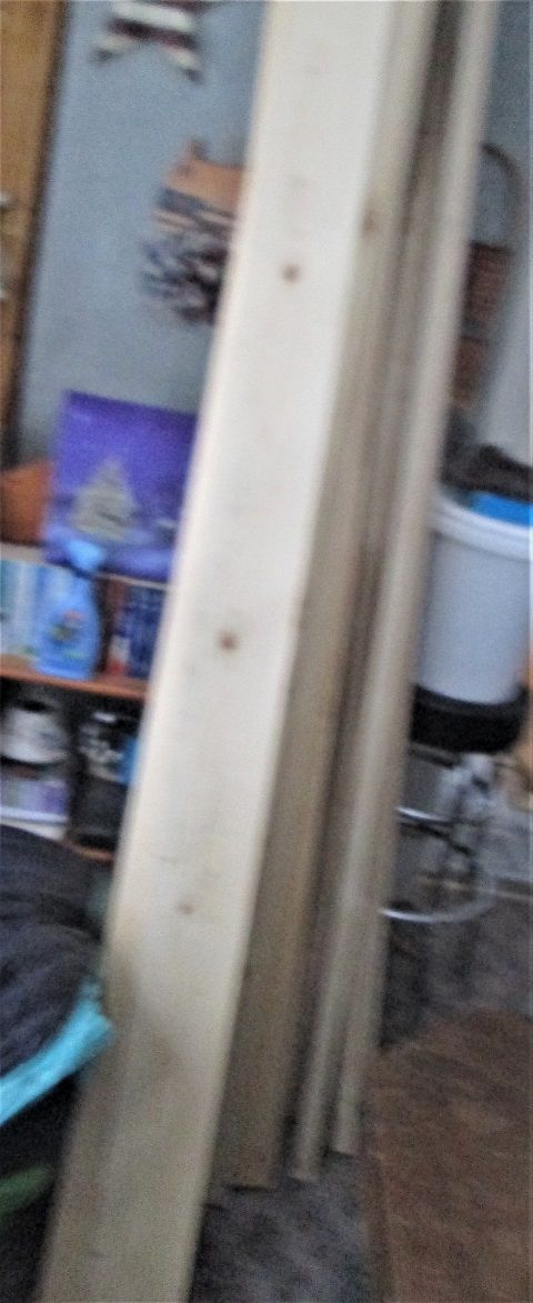

Have been working on a shopping list...may get to do a "lumber run" tomorrow....plywood from Lowes....not paying Menard's price. :ArguingSmileys:    Menard's for the rest of the lumber....can sort all day long, looking for the best.:TwoThumbsUp:...here we go....still part of the "Plan" stage, right..:WonderScratch:
Need a pair of the best 2 x 4 x 8' boards I can did up/out....These will become the corner posts...B)
Need a couple 1 x 3 x 8'...wider parts of the face frame and the top and bottom rails on the sides...depends on the "selection":DevilLaughing: may use 1 x 4s instead..:ChinScratch:
Need 8 sticks of the best 1x 2 x 8' I can drag out of hiding.:CoveringEyes:....olden days, I'd just rip a 2 x 4 into 3/4" thick strips...use the best of the mess for the skinny rails on the sides, and to build 6 webframes...leftovers for kickers...
Need a pair of 1 x 6 x 8' planks.....top two drawers.   each will provide a front, two sides, and a back.
Need three 1 x 8 x 8' planks.....bottom 3 drawers, and
One  1 x 10 x 8' plank, two crosscuts, flip around, and glue up a panel for the top.  Kickers will be from leftovers.
Plywood, one 1/4 x 4' x 8' sheet of decent looking Luann plywood....5 drawer bottom, and the back of the case...leftovers, plus what I already have...5 panels on each side.
May get to go out and shop..tomorrow.  Grandson to drive, and do the lifting.   Need the drawer blanks to help lay out the drawer spacings...

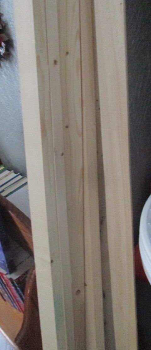

Lumber Shopping for today....Priced the plywood at Menard's..they don't have a panelsaw to cut down panels with..:ArguingSmileys:..Rest of the Pine boards were picked through, and I got the "Pick of the Litter":CoveringEyes:, leave it at that.:DevilLaughing:    Will do work-arounds for the worst sections.....Nails, a large bottle of glue, and a ten pack (!:BugEyeSmiley:) of handles.   Will do a drive to Lowes later, tomorrow, and get the plywood....maybe..
Need to start layouts for the drawer spaces....due to one 1 x 6 being a bit nasty along one edge...top drawer will be a bit narrower than the next one down....
I went with the cheaper "Standard" grade lumber, rather than the stuff that cost 4 times as much....Gold plated Pine?:BangingHead:  will spend some time with pen and paper, later....I need a nap...:GoodNight:

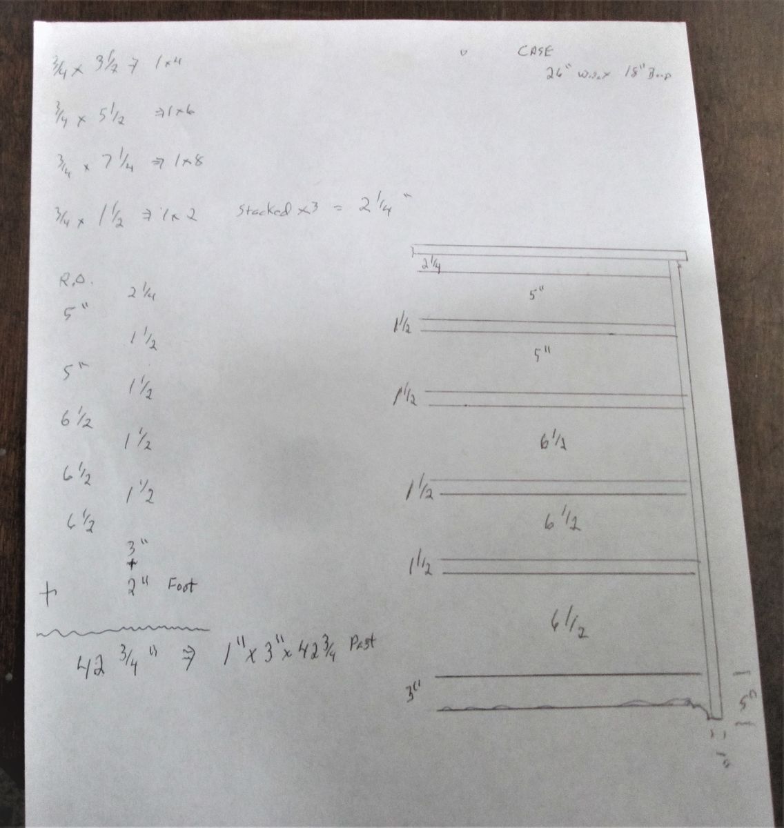

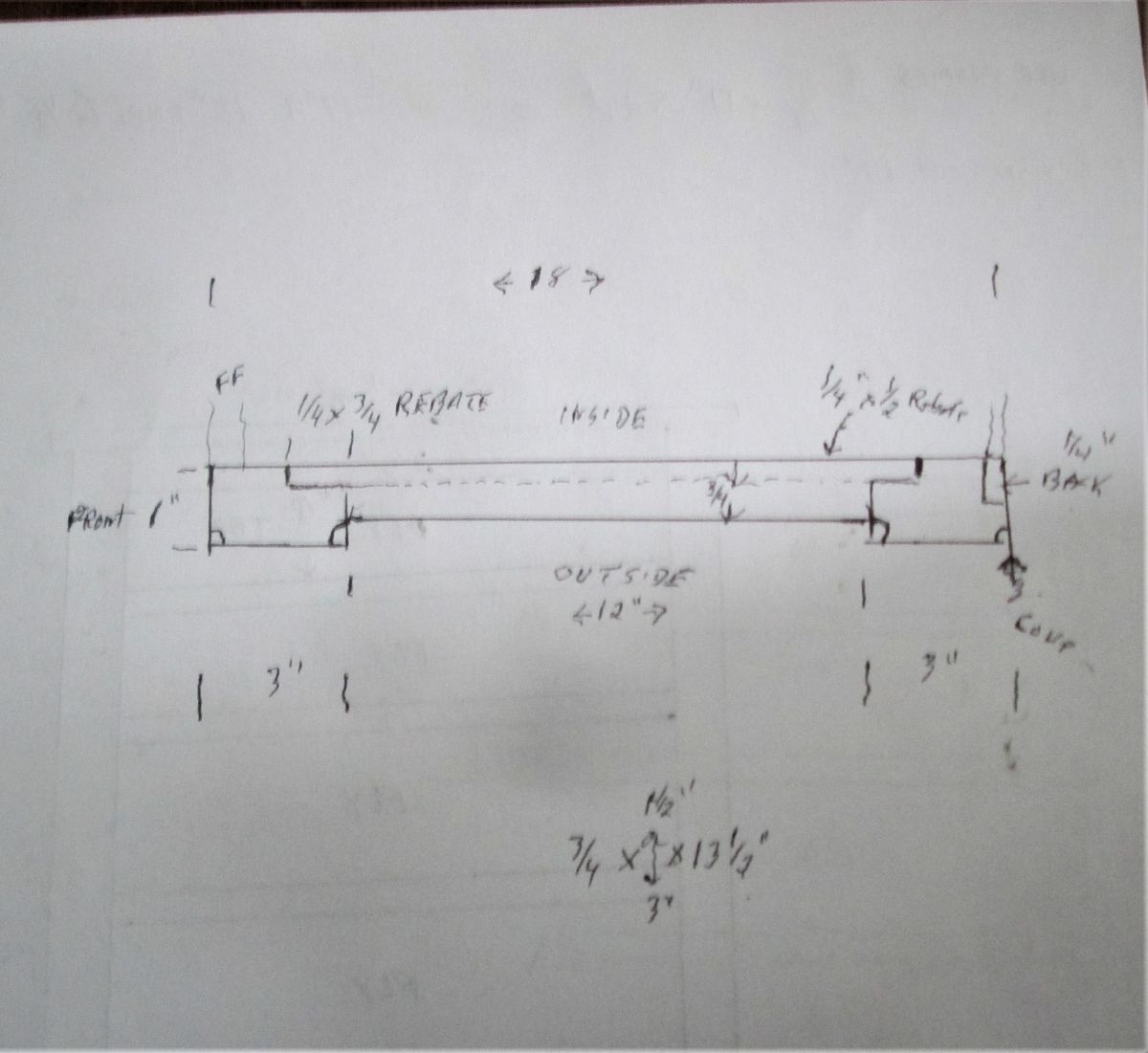

Ok, trying to draw up some plans, with the right hand shaking ( left is fine, but, I;m right handed)  wasn't the easiest thing to do, this morning.  Got about 3 pages of sizes.:JawDrop:..and other things needed to be figured out....almost ready to crosscut a few skinny boards, to build the webframes...
Not to any sort of scale, of course....:WonderScratch:
Counting the top, will be almost 45" tall, case will be 26" wide, and 18" deep....tried to figure out the side parts..

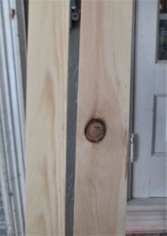

These are two 1 x 4 x 8s...that knot will be heading to the fire pit, at a later date....these get ripped down to either 2-1/2" or 3" wide...some of the other boards..
Some edges are good, some...not so good...

Almost forgot, used a board to do the drawings on...:ChinScratch:

Those are my kind of sketches,only W/O the ruler. I made sketches like that for my crew for many years, and they seemed to understand them.

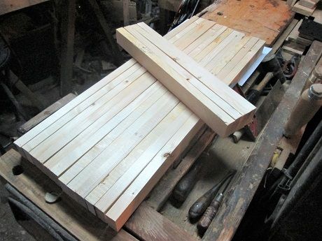

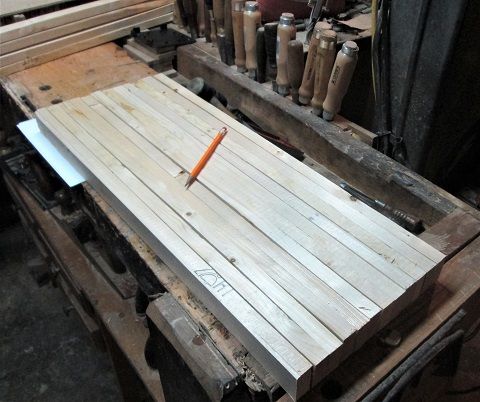

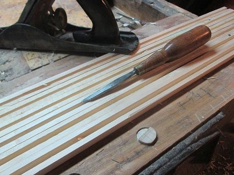

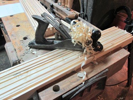

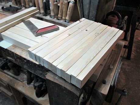

Ok, my back, not the belly, was what shut down today's misadventures..:ph34r:..but, it did feel good.:TwoThumbsUp:...even used a Junior Jack plane :JawDrop:
Enough stiles to make 1/2 of the webframes, other half is sitting there, waiting their turn.
haul a couple if 1x 2s to the shop ( was on Laundry Detail, anyway) Made a bunch of crosscuts..
12 of them, 24" long, took a couple more 1 x 2 s than I planned on..the 4 laying back there? are a bit too short....cut those down a bit
And kept the leftovers.   Made a push stick for later...right now, needed the rest of these 15" long rails done..
And had two pieces leftover, to start on kickers with, at 17" long.

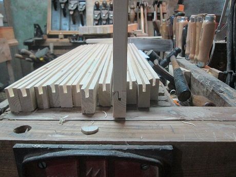

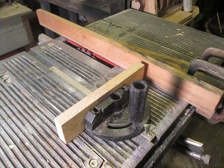

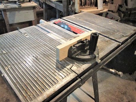

One chore today, was to add a new "pad" to the mitre gauge...then set up the rip fence, since the crosscuts were done, for now...then run each stile to make a groove, which is what that plane was leveling, also used a small chisel...
had a sliver down the center to remove.  reset the fence and blade height..
Then took a scrap and made a test tenon....and a test fit
remember, this is only a test.....:ChinScratch:Have one pair of grooves a bit too wide, rest are tight fits....rather they be a little tight. :TwoThumbsUp:
Laundry was done, back was getting sore...I think that will do for today.   Still learning to do photos with this new computer...:WonderScratch:
Will see what I can do...tomorrow :DevilLaughing:
Stay tuned:cowboy:
If'n the boss here wants, he could start this last post as a woodworking thread....Maybe  call it " A Chester Drawer build?:TwoThumbsUp:
