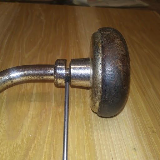

I got started restoring the brace.  After a little wire brushing, the ID popped up.  It is a Miller Falls 732.  Looking at the pad on the head, I now have a question.
I have a pretty big gap between the head and the rest of the components at the top.  This pic shows the gap with a small screwdriver in the gap to highlight it.
This is a picture of the head disassembled.  Am I missing something, a bearing or bushing of some sort?  Or should I just pack some washers in there to take up the gap.  I can't seem to find any kind of a parts breakdown that would help me order a missing part, if that is my problem.
Sorry about that picture.  Somehow, part of the left side got clipped off, but you can still see the tip of the crank.  That has the slot for the C-clip just to the left of the wooden pad.  Any suggestions?
What i can find seems to indicate that there should have been a bearing in that gap at one point; although another source on the web indicates that some braces the retainer collar slips down too far.   I don't really know if yours is fixed in place and missing the bearing or not.  Is there anything on the shank to "hold" it in position. (or for that matter, anything on the metal base of the upper handle to lock it so the whole mechanism doesn't poke through the handle at some point.
I will have to look at my braces in the morning and try to get a better idea - i may have one similar to that.
The only thing that holds the whole assembly in place is the c-clip that goes on the end of the crank up by the upper handle or pad.  Everything thing slides on to the shaft except the clip and wooden part, the clip is installed on the end of the shaft, the wooden pad screws on to the large metal disc by means of threads in the wood mating up with the threads on the protrusion from the disc, and three screws secure the disc to the pad.  Once all that is put together, I have that gap.  According to my research, Miller Falls transferred or sold out to a Chinese, company, (what a surprise!!), so my chances of getting any information or parts from them are pretty nil.  I think everything will probably work, I just don't like all that slop in the mechanism.  BTW, thanks for the response Peter.  Sorry it took me so long to reply, but I got busy with family issues.
