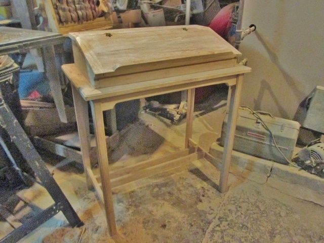

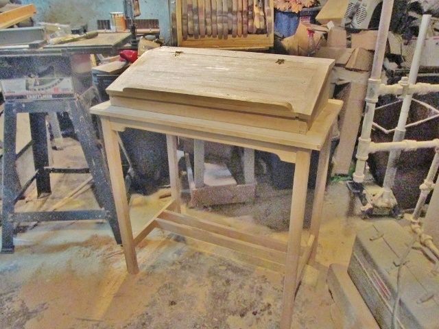

C clamps are removed, how about a PIP?

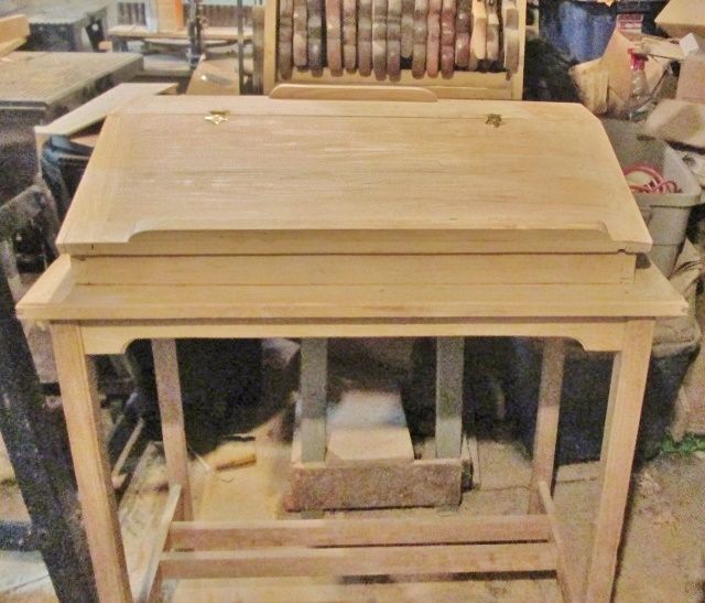

View from the front....and..
View from the end.  Just glue holding the book rest in place....need to make a bunch of plugs and install them, before the stain goes on..

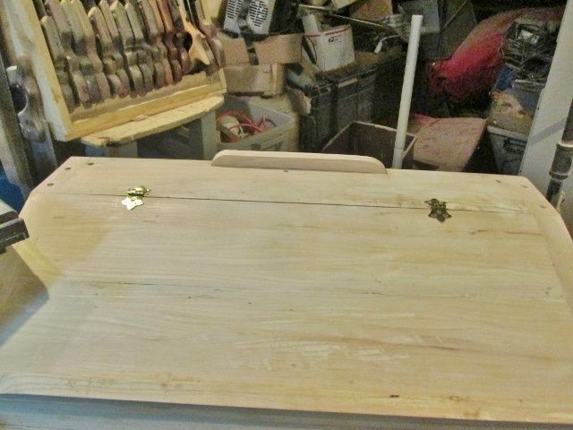

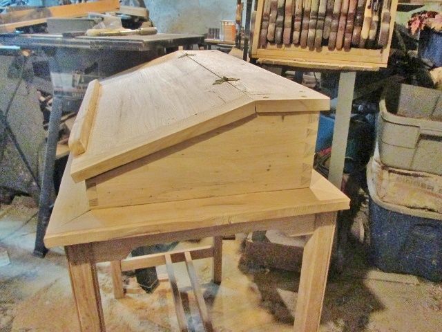

Thinking of adding this "topper" at the back edge....Need to add a strip to the left edges of the lid....
As there is no overhang on this end.....IF the shop warms up...and Tuesday gets here...
I like that idea...flows well with the book rest and interrupts the long back edge. Good classical touch.

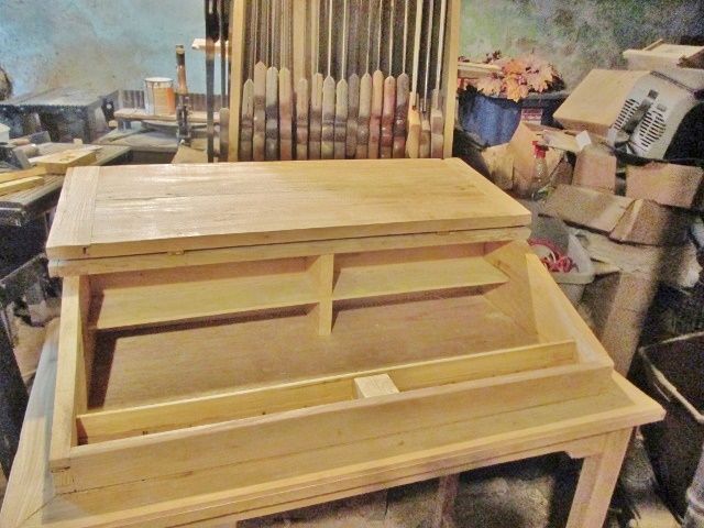

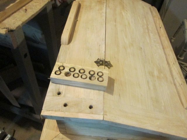

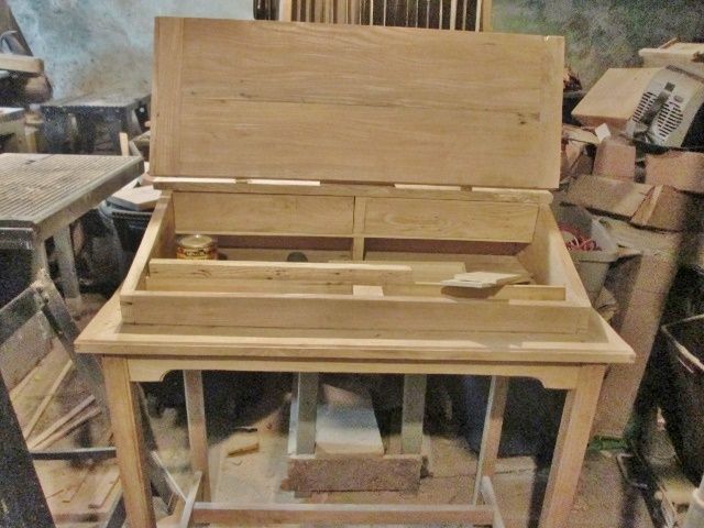

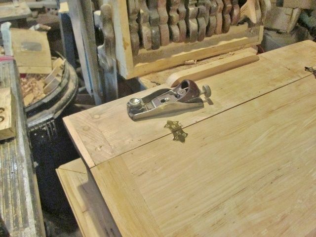

Got a little bit done...clamps came off a bit ago...lid now has an overhang on the left side.    Accent piece on the top has been glued in place...came in handy...

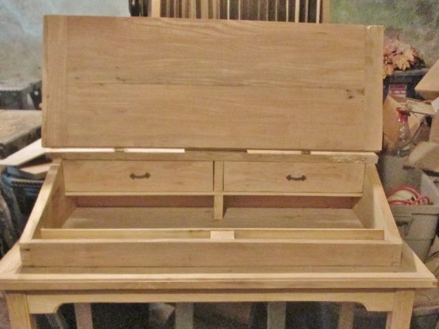

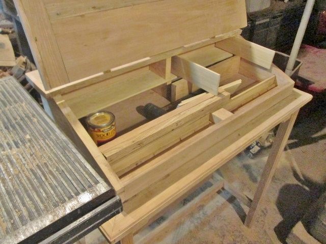

While I made and glued in a couple dividers.   Top one is for between the drawers, bottom to support the middle.   Notebooks  have a place to slide into.

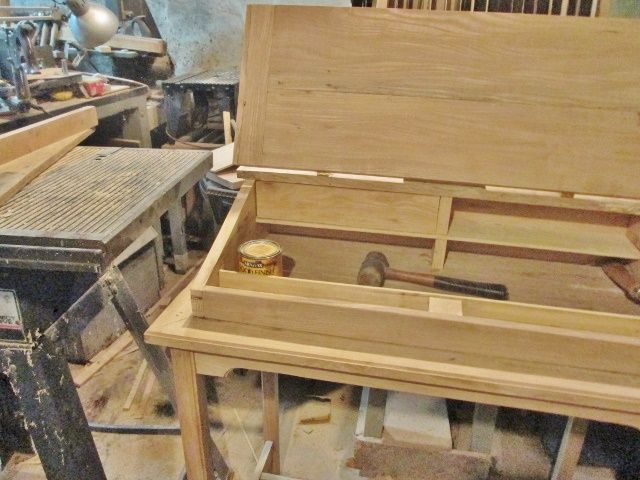

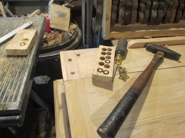

Closed the lid, plugs needed to be installed..
And, you can see the add-ons to get the overhang...Pop a plug out with a screwdriver blade, bead of glue on the narrow end..
Hammer to tamp each down tight....then come back and trim flush..
And allow to dry.  May go back and start on 2 drawers, after Supper....shop was a bit warm..
Stay tuned...

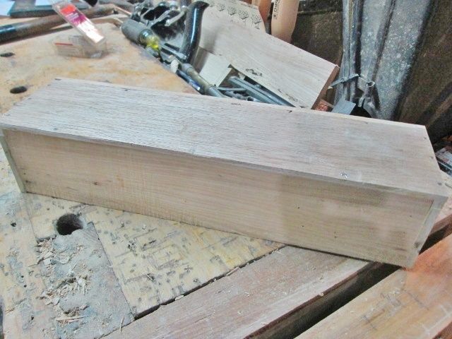

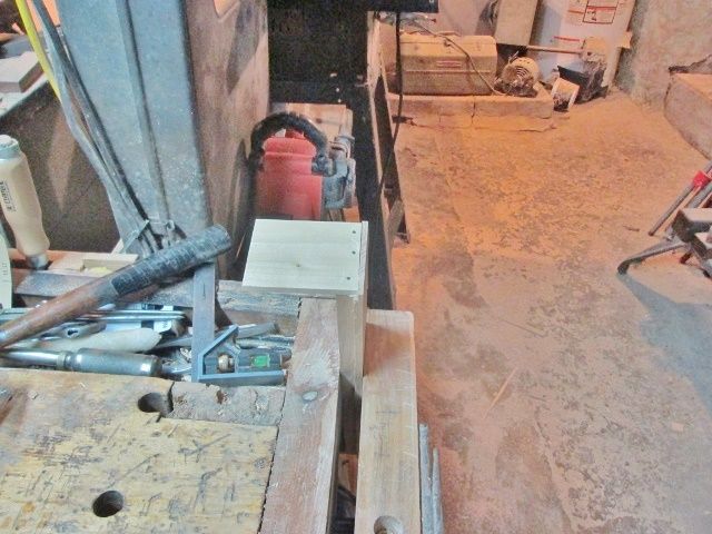

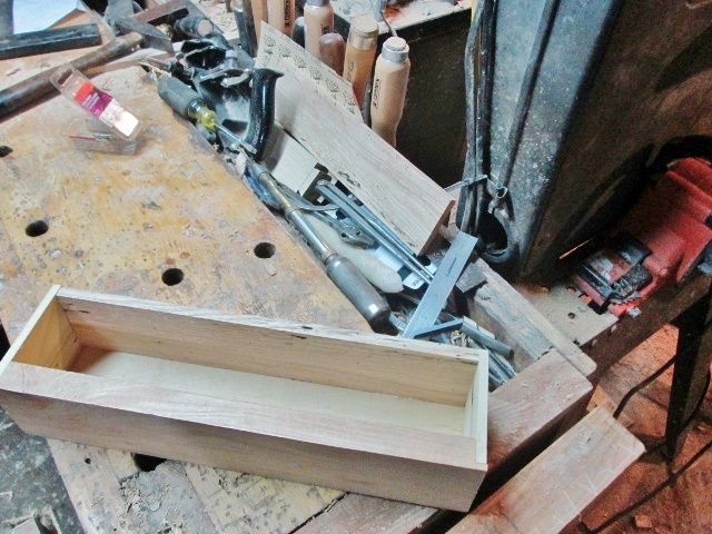

Drawers have been built....nottin fancy.....:rolleyes:

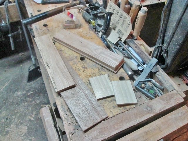

Lot of rip and cross cuts, test fits...trying to get the most out of the least..
Drawer fronts...these are 3/4" thick...the rest of the parts are not...
1/4" luann plywood for the bottoms, squares are for the sides, out of Poplar...had to resaw a 3/4" thick plank down to make the back.  Front has a few rebates, for the sides and bottom to nail to....just glue & nails...
Nailing end grain is harder than I thought...:BangingHead:
As long as the spot I was trying to nail was over the bench's leg...seemed to drive better...set the first one aside..
Then worked on the second drawer..
Really not much too these drawers.   Added a handle to each...
I think that will do..:TwoThumbsUp:..close the lid..
I have 4 plugs left to install...:ChinScratch:
Maybe a final sanding, then it is time for Stain and varnish....might make that weekend deadline, yet:Cheer:

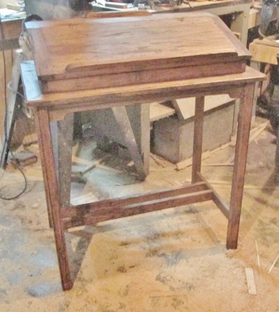

Last of the plugs were done...bit of sanding, here and there...then tried to stain the entire thing...
Only areas that will show.  Brush on the Minwax Dark Walnut stain....working on a section at a time, then put the brush down, and wipe the excess stain off, then move and repeat.
Trying to figure out which light settings I need...as things are not quite this "red"
Still needs a coat or two of Clear Gloss Poly....and a camera expert to do the photo shoot...
Almost done...stay tuned...
