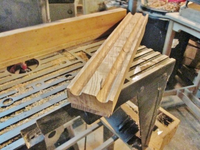

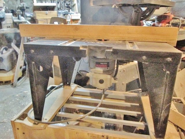

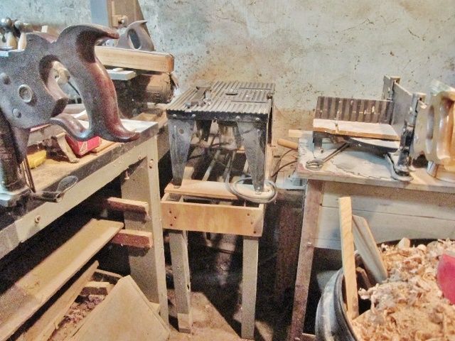

Short shop times, again.   Can't just sit around, have to do a little something, to divert the mind.   Drag the old router table back out:JawDrop:

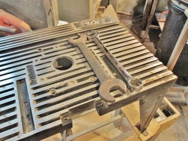

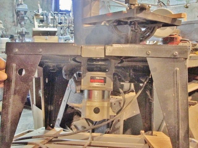

Set up my do-everything Fence/Guide.   Router needs two wrenches, to change bits, took a bit of digging around...:ph34r:402514786_routerwrenches.jpg.047ea6601a6e43647049cd83a611c0b9.jpg
Fat wrenches, have to lower the router almost all the way down...

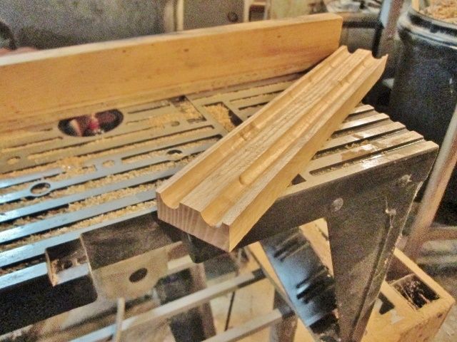

When was the last time B&D made all metal routers?  All this just to run 4 cuts..:o
Pencil grooves.   And the other pair..
Then lower the router back down, remove the bit, and put the table away...

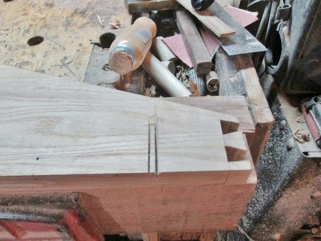

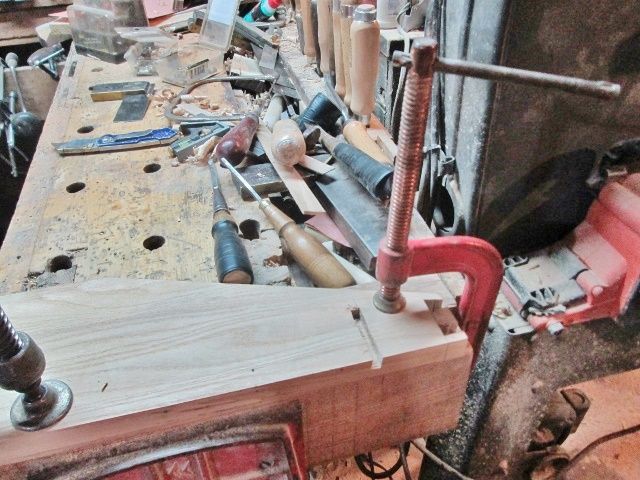

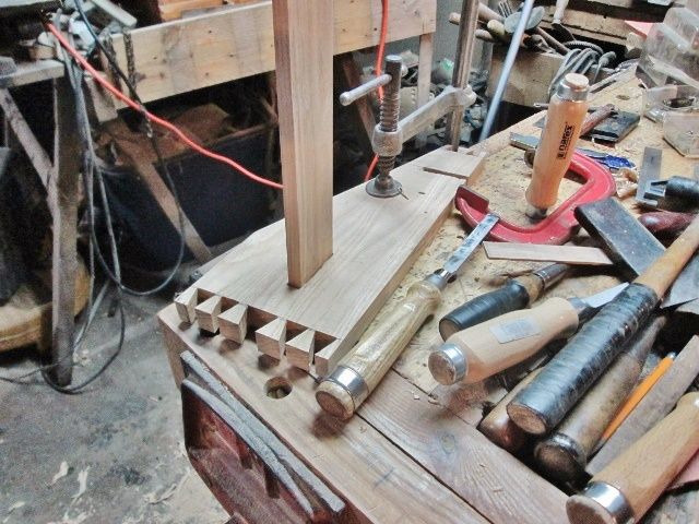

Next item?   One side needed a couple holes chopped....no safe way to use the router...sooo
Handsaw a bit, chisel a while...B)
Clean it out...test for fit

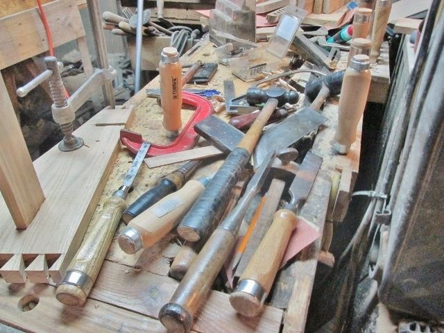

This thin board will go behind those pencil holders.   Decided to chop out for the drawer "runner"
Dry fit. :TwoThumbsUp:  Does not need to go all the way to the back,  just a place for the drawers to slide on.  Top of the case keeps them from tipping.  Used a bunch of chisels...
Lew's Mallet is on Vacation....what a mess..:CoveringEyes:
may try later, to get the other side chopped...stay tuned:cowboy:

Pencil grooves.
I get the pencil grooves, but no inkwell?  :throbbinghead:

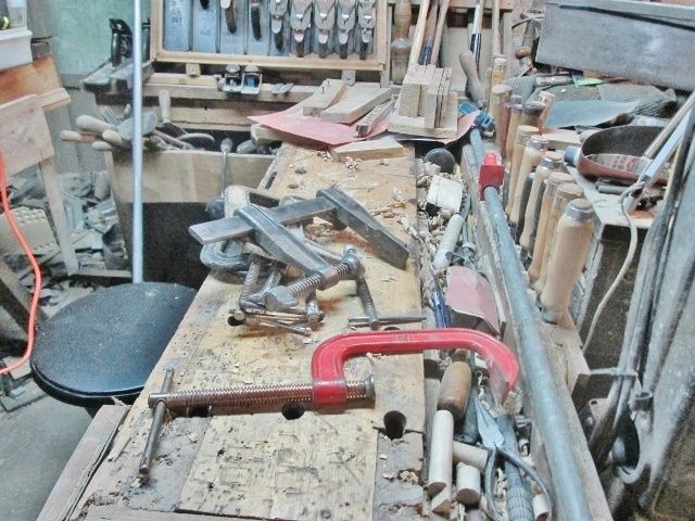

:JawDrop:Might take a few minutes.   Need a small brush, to dab the glue into a bunch of nooks and crannies :ph34r:
Cussing levels are sure to rise :ArguingSmileys: Need to get all of these things over to the bench...
New poplar boards have replaced the less then perfect Ash ones..may need to trim them a slight bit...
May need a few cauls...soooo, IF you see a blue streak coming from my shop...:BangingHead::DevilLaughing:  be sure to where ear plugs...going to be LOUD:BugEyeSmiley:
Will head that way in a little bit...you been warned:CoveringEyes:
Stay tuned, will return with the results later...I hope...

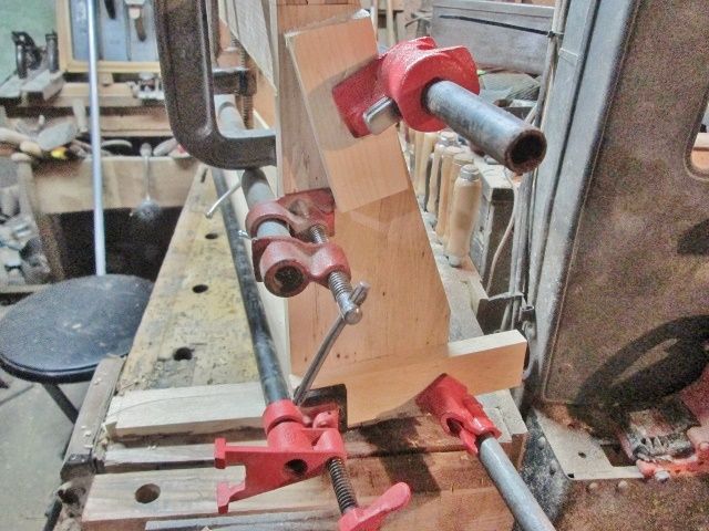

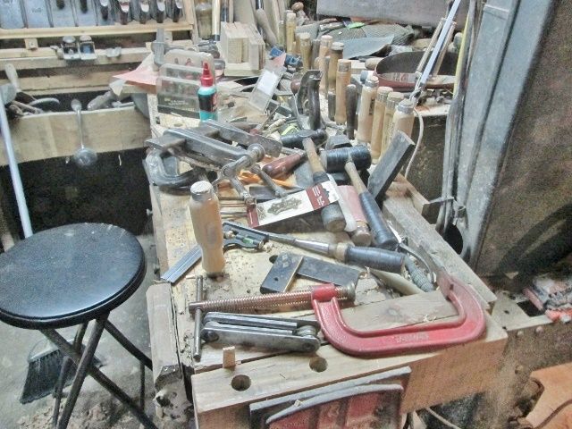

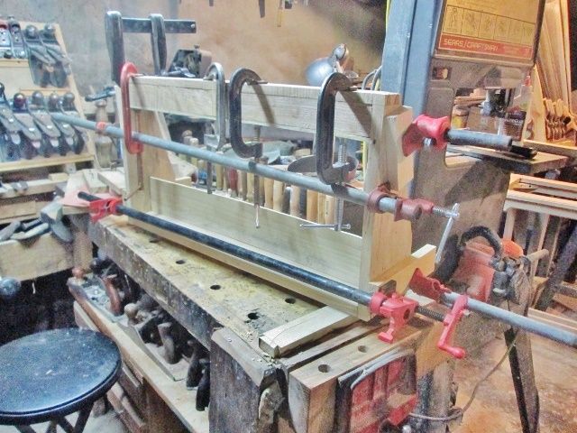

Tis done...scene of the crime?:o
And I used almost all of these...and, IF a hammer doesn't..we get a bigger hammer..:ChinScratch:

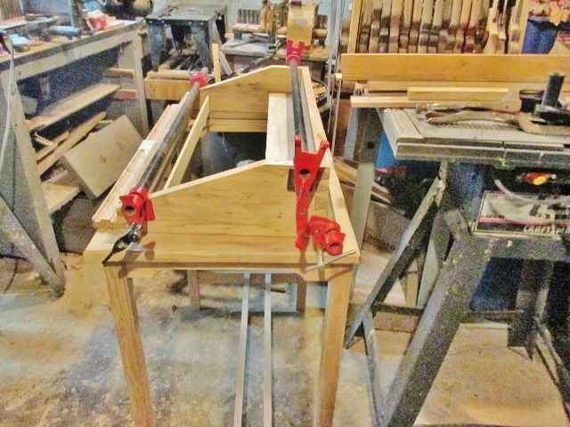

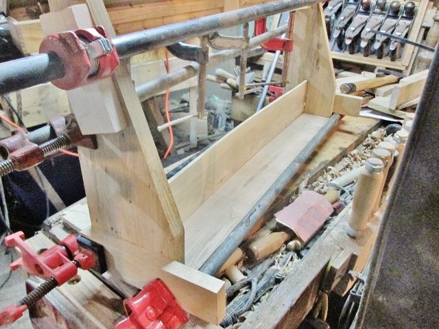

Pencil holders glued in...cauls on the pipe clamps, missing the pins.   Needed pressure on the tails..

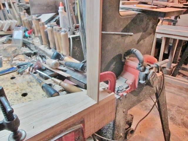

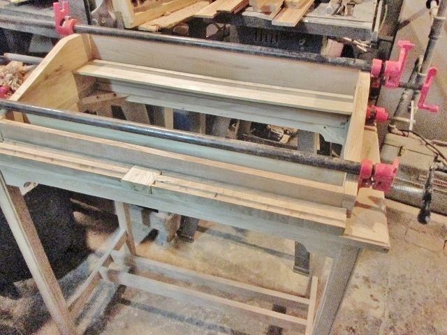

I trimmed the drawer shelf a bit....still wasn't quite enough :BangingHead: Will correct with a couple dividers to keep the shelf flat..
Once I get the top of the desk in place, I can add the dividers between the shelf and the top....glue & screws.
I checked the corners for square...got lucky, this time...all square:TwoThumbsUp:
