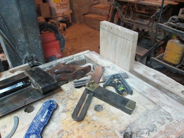

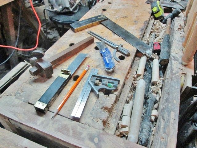

Give this a try...had to lay out some tools, before I worked on the dovetails..

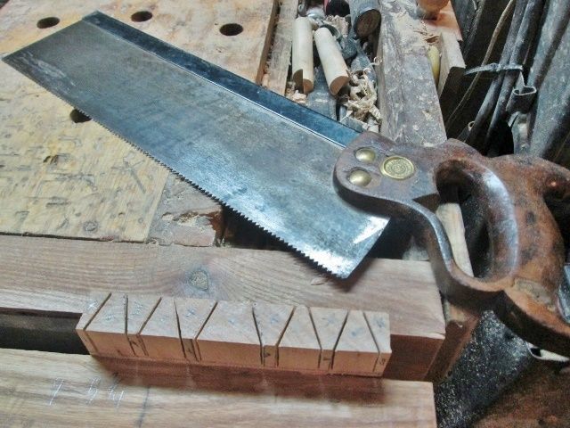

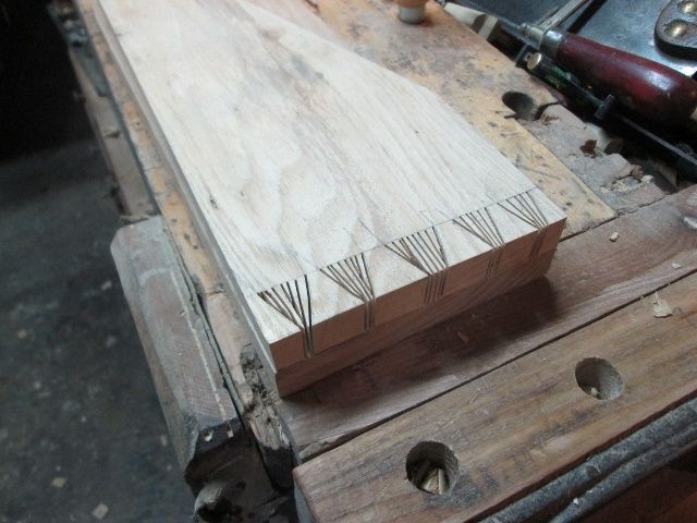

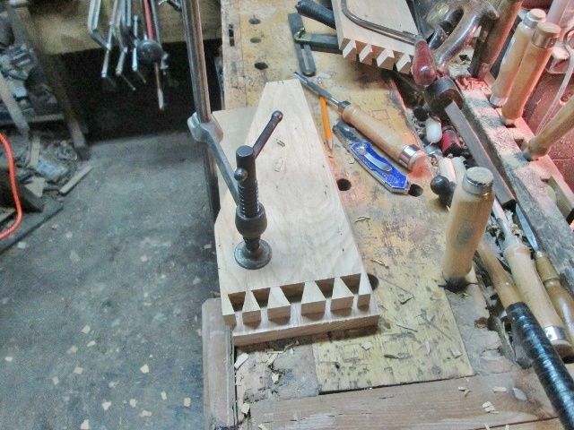

Found out why that angle is cut like that on the bevel gauge...is the same angle I use for dovetail pins.   Was going to lay out spacing with the dividers, went a different way.   I came in from each end, and worked to the middle.   Blue knife to make a "knife line/wall".   Nice to stand the part up in the vise, both for lay outs..
And when it came time to us the "dovetail saw"
I can drop things down to elbow level, makes sawing a bit easier.

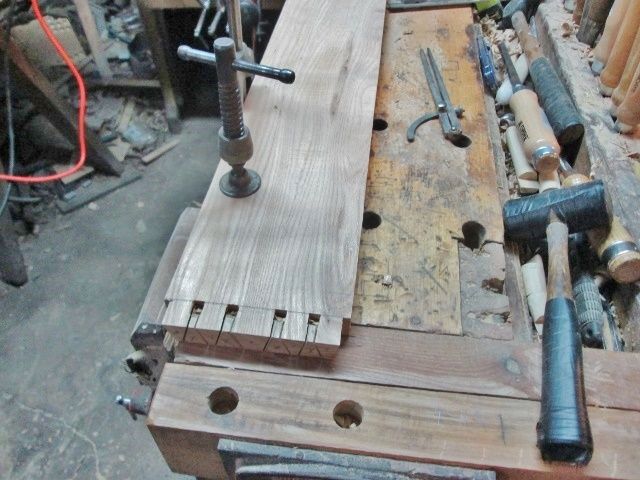

Then a bit of chisel work   chop down about 1/2 way, leave a little for support
So when I flip this board over, and chop from the other side..

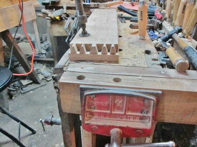

There isn't any tear out going on the other side.   Stand this thing up, onto a desk side, making sure I had the correct side, and use those pins and a pencil, trace around each pin.  then the bandsaw makes a few cuts.....as I can see the cuts being made a lot easier...trying to leave the lines, cutting on the waste side
A few extra cuts don't hurt, easier to get the chunks out...same as before 1/2 way from each face..
Then that dry fit..336716644_testforfit.jpg.1babff364723cf1e5a47db00a846c17b.jpg
A bit snug.  Can pare if need be...set this aside, while the other tails get chopped...

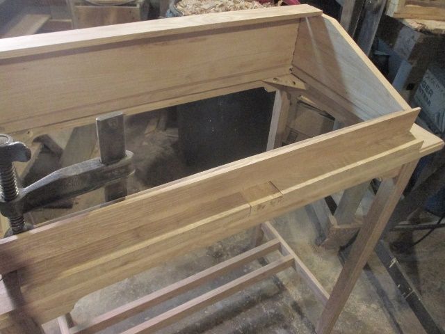

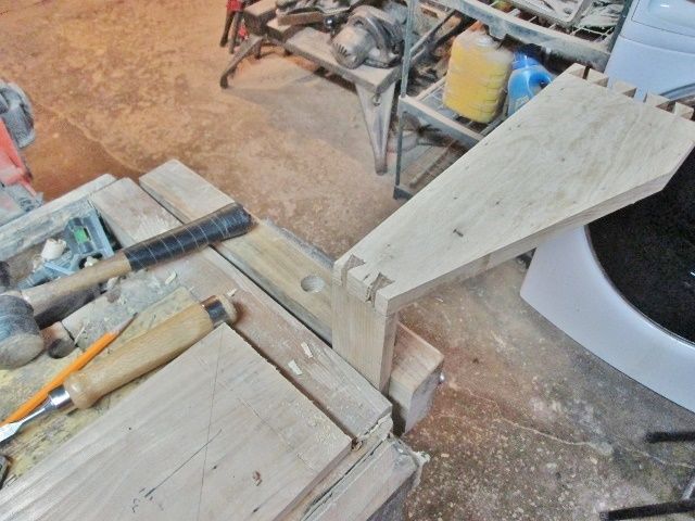

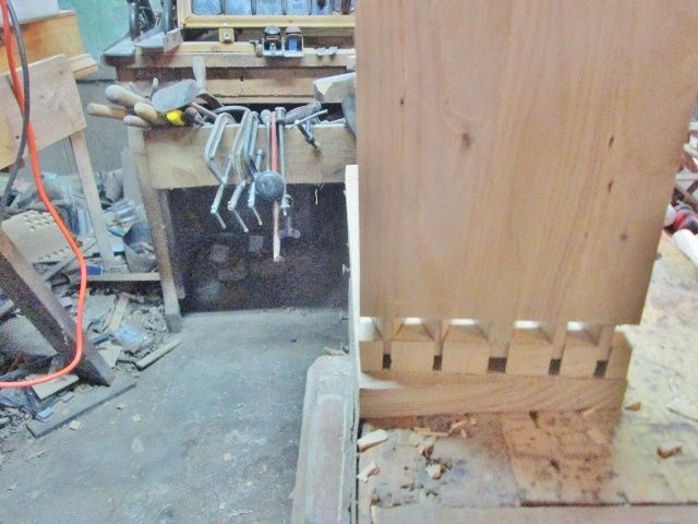

Since I had the pins already done....then I tried to do the front rail....got the pins done..
And this is where I had to stop....couldn't see much of what I was working on.   set the part down..
And closed the shop....stay tuned

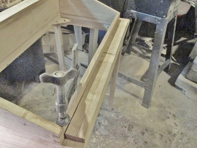

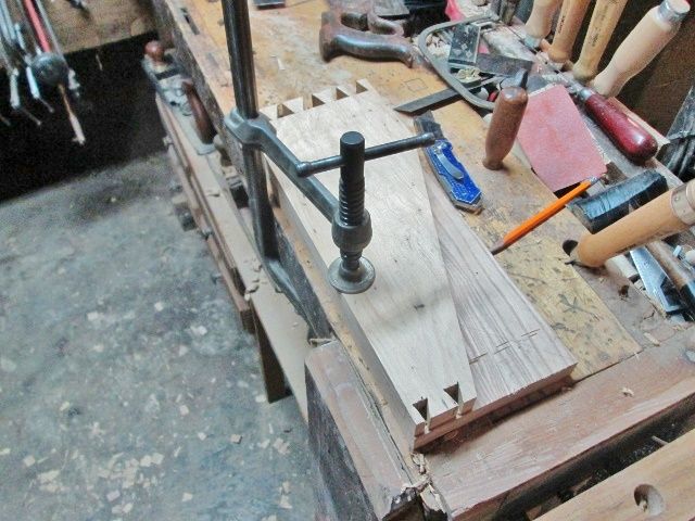

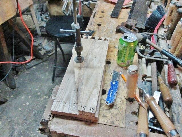

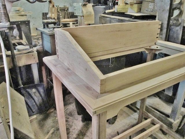

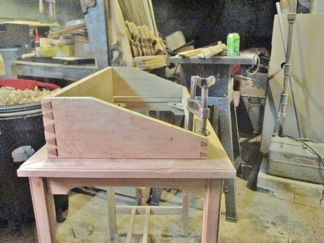

Needed to at least finish the dovetails on the front of the desk.....slowly..
Used the pins to lay these two out.  Bandsaw to make the cuts.   Mountain Dew had been left in the shop...thursday, might be a bit nasty:rolleyes:
Chisel and rawhide mallet to do half the chops...then flip this over, and finish the chops
Then a dry fit, or three:ChinScratch: until things fit.
Took a few...then repeat for the other end.   At least I can sit down and do this stuff:TwoThumbsUp:

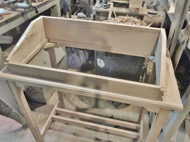

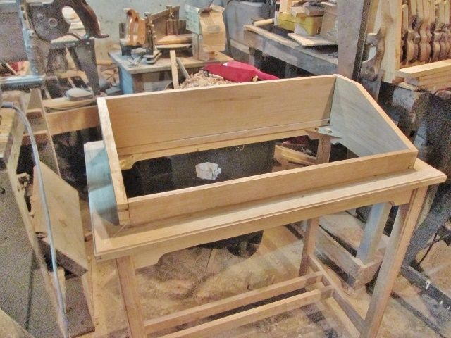

Got both ends done...dry fit the entire mess..:CoveringEyes:

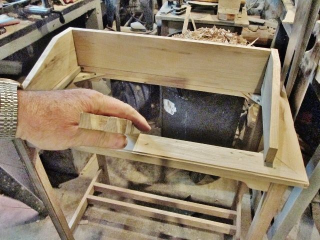

Oh, you want to see the side? Hmmm
Clamped to keep this sitting still, while I marked a few thins for size
This will be for the drawers to slide on.   Need a dado for it to sit in...as soon as I get the sizes of the drawers.

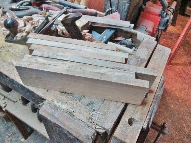

Drawer parts...had a few 1 x6s, bandsaw to rip those down the middle...
Need to change the bandsaw blade to that 1/2" wide one,  then resaw these down to 3/8" thick parts.

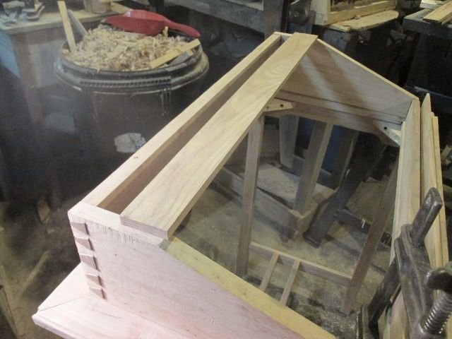

Other than getting the dados done, might be getting close to a glue up?
Stay tuned....1 hour at a time:OldManSmiley:
