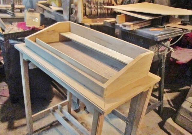

Ok, 2 hours in the shop, before Mr. Gumption left the building...concentration was a bit low, too:WonderScratch:
So...ran that router around a bit..

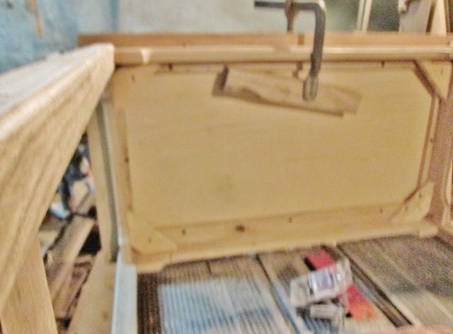

Then cut and almost fit a plywood panel..
Glue and nails.   Not too worried about around the edges...
Because this thing covers all of them.   came out of the clamps, no issues....gave it a good clean up..
Fun part will be, when I attach this in place....screws come up from underneath.....Pencil holders..

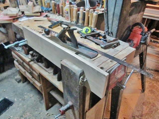

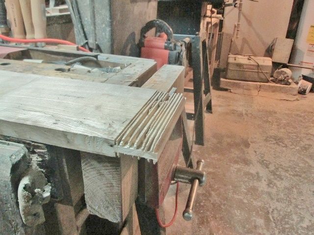

Had to take a beltsander to the underside of the tray, leveled the playing field.  Hauled a plank to the shop...cross cut @ 30" long...set one plank on top of the desk
Hmmm, don't think I want THIS one...maybe the other half looks better?
Much better....will need to joint an edge..
We have ways..

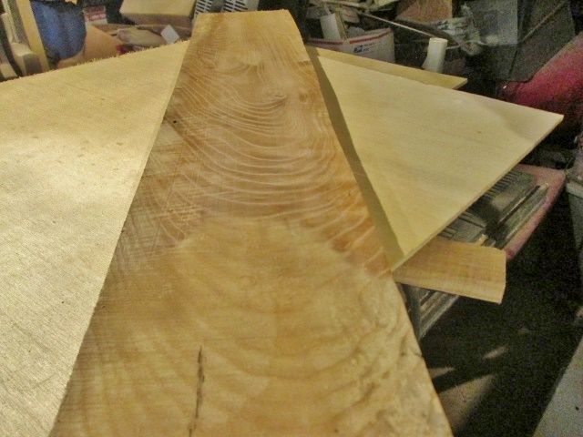

Helps to have a nice straight edge, when doing a lid...As for that curvy, wavy board?
Thinking a few rip cuts, to make stock for bread board ends?   Toss the worst in the fire pit :WonderScratch:

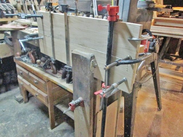

Hauled the last of the boards to the shop, cross cut it to match the other two pieces....
Flipped and flopped a bit, til the gaps match, and the grain was close, big "X" to mark which faces go where....then fold the two together..
Joint both at the same time.   Unfold, spread some glue, moosh the joint back and forth a bit...then clamps

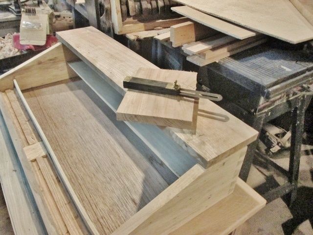

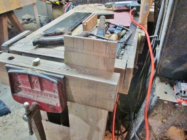

Lid can sit here a few days.   Laid out a scrap block and a bevel gauge...
To figure out the angle to bevel things to.     Need to find enough room, to sit this to where I can attach things together....Need to clean off the tablesaw, have a few jobs for it..

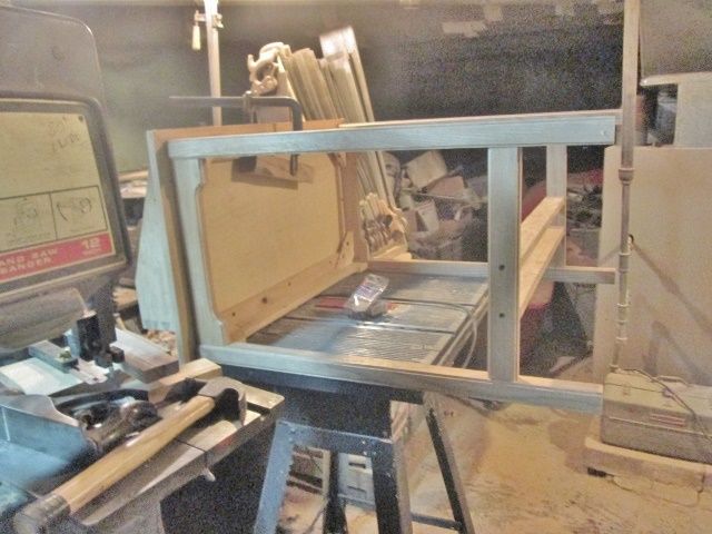

Going to try to get a bit of work done....sometime after Lunch is done....hope the camera is all charged up....need to clear off that tablesaw first...trace around the desk, clamp the desk in place, and add a few screws....then see about some work on that lid....

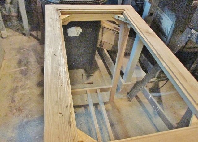

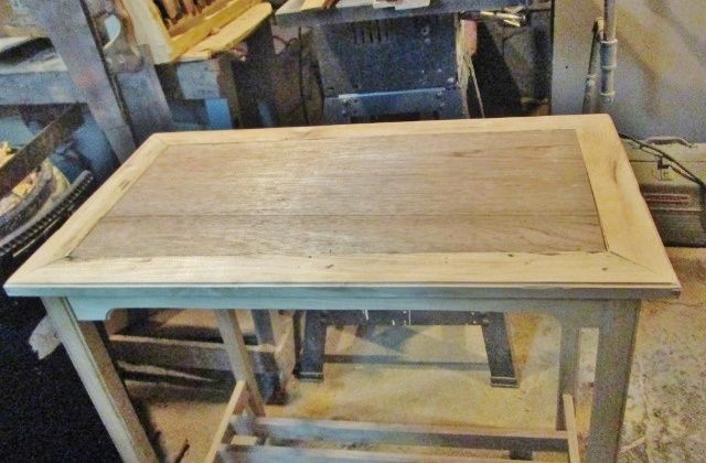

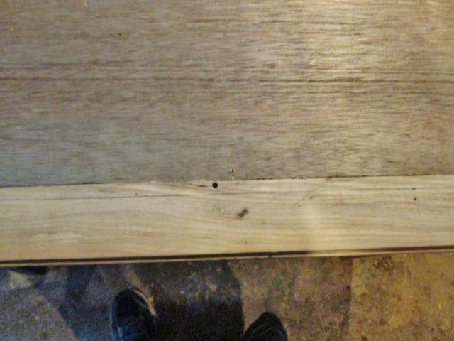

About 4 hours, today....have had better days in the shop.....traced around the desk unit, and drilled a few pilot holes...
Was a good plan...except where those corner blocks were....kind of block the access to the holes...Clamping the desk in place was a fight..:BangingHead:.finally got a 3 x 3 chunk to help out
Had to redrill a couple, and hope I didn't miss too badly...getting this thing onto the saw was"fun":ArguingSmileys:
And try and reach some of the screws.....set this aside...found out I had crack the poplar backer strip on the pencil tray..:(

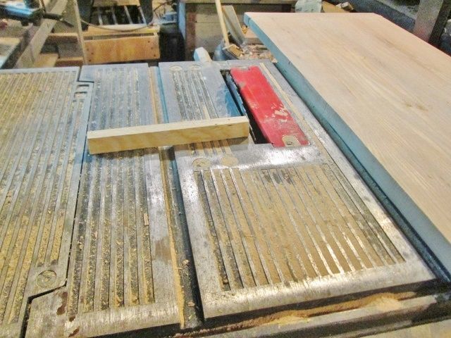

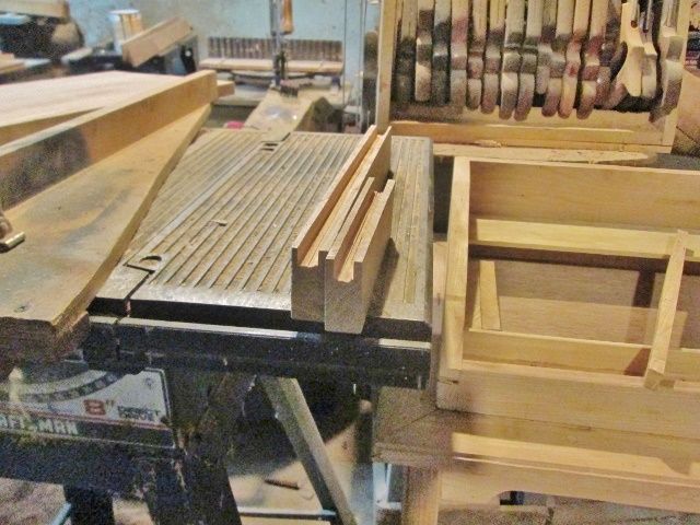

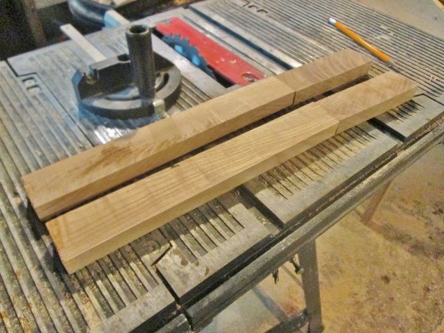

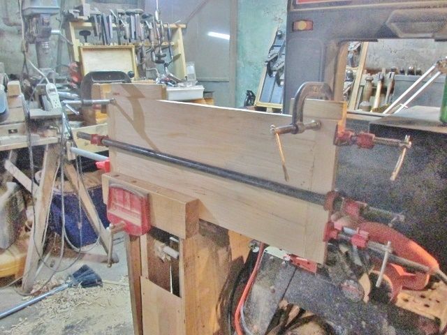

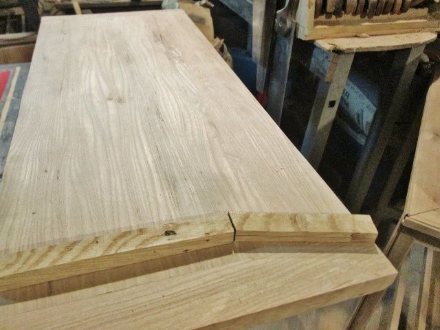

Filler block was made and glued up.   Used the fence to rip that nasty 1 x 6 into strips for bread board ends
Best of the cuts....meh..tried the saw to cut a groove...:BangingHead:
Not great...came back later with the router table, and a straight cutter bit, and clean things up...Stanley 45 wasn't up for the job,today:BangingHead:

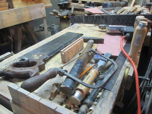

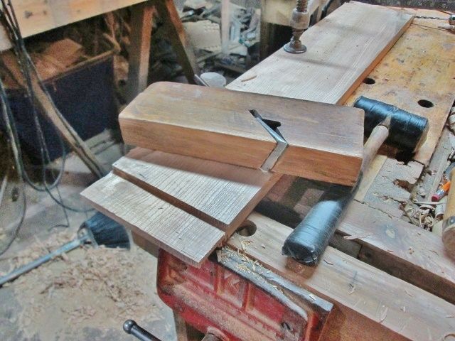

Underhill did a through tenon for his bread board ends.....:DayDreaming:
Started out making this long tenon  had to clean things up, too:DevilLaughing:
Mallet & chisel...that old plane did a decent job..B) Then the next step..
Two through tenons, strange looking saw to remove the waste.
So far, so good?   Bad part was chopping through mortises in that little block back there....block did the splits.:angry:..design change! :ArguingSmileys:

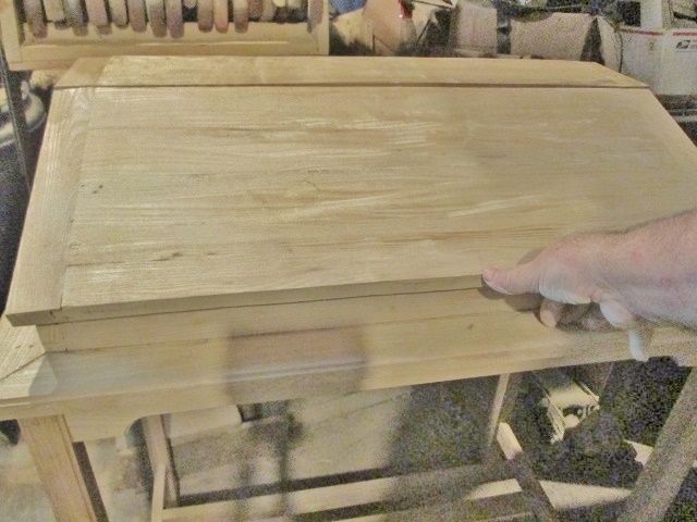

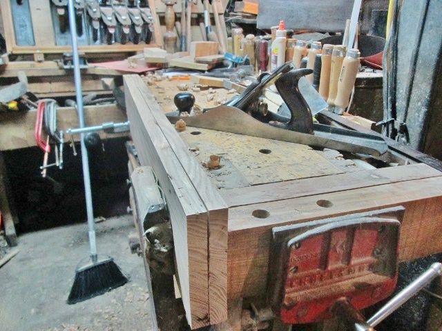

Buzzed the tenons  down, making this a tongue & groove joint...glue and clamps....
After the clamps come off...I'll pin things in place from the underside.....Same routine with the lid section...
Same with this thing..when the clamps come off, I'll pin from the underside...swept the floor, called it a day...

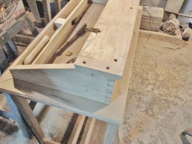

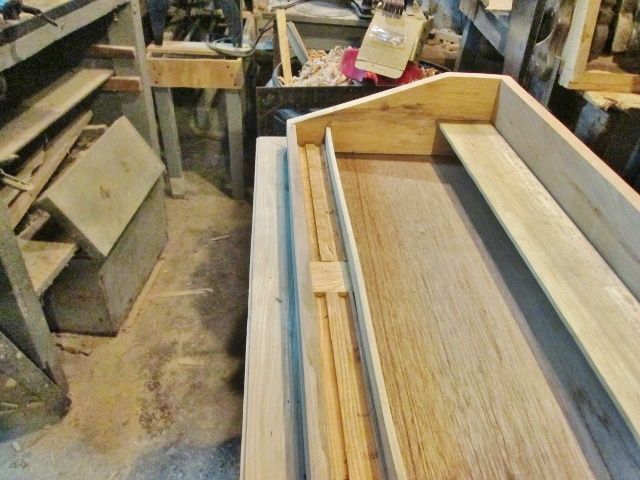

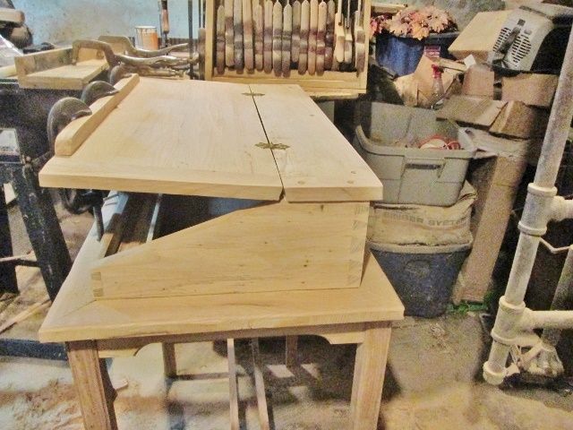

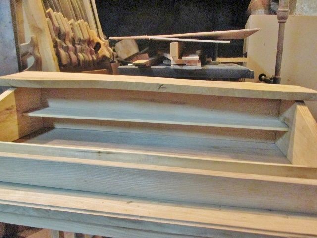

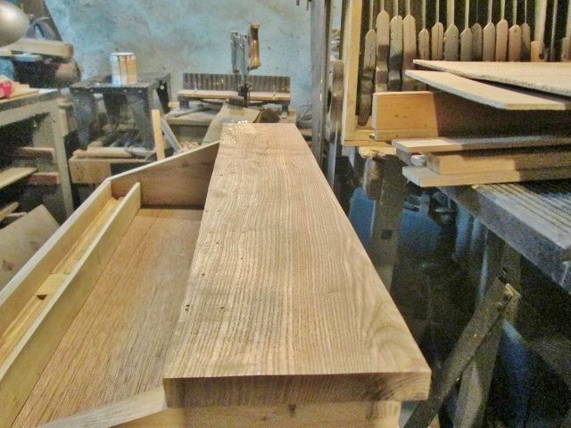

Got the top and the lid all cleaned up...ends were squared up a bit...Decided to figure out an angle...needed a bit of scrap..:ph34r:
Shorter one is for the top shelf...longer one for the lid.   Once these fit nicely, I could set the tablesaw  for a bevel rip...top came out just about right..:BugEyeSmiley:
Close?   When it came time to rip the other side...
Had to double check as to which face went where.:ChinScratch:..also cleaned the cut a bit, bandsaw  did a wavy cut.:BangingHead:  Cleaned the saw marks up, drilled a few holes..

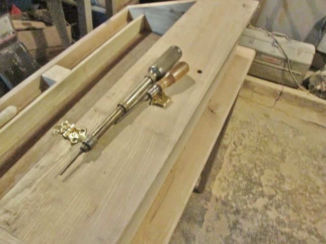

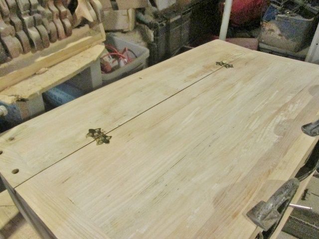

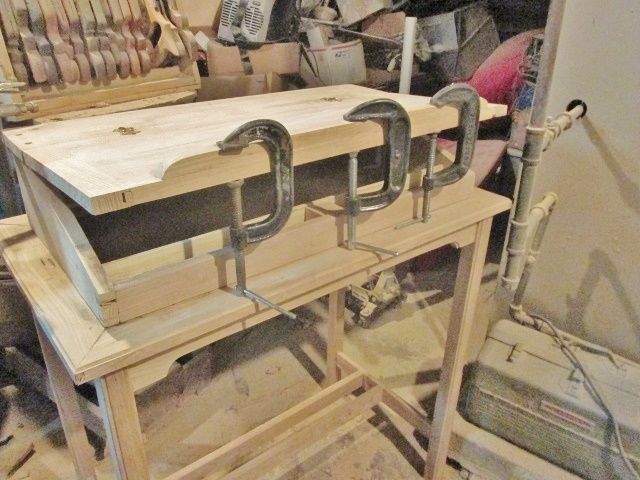

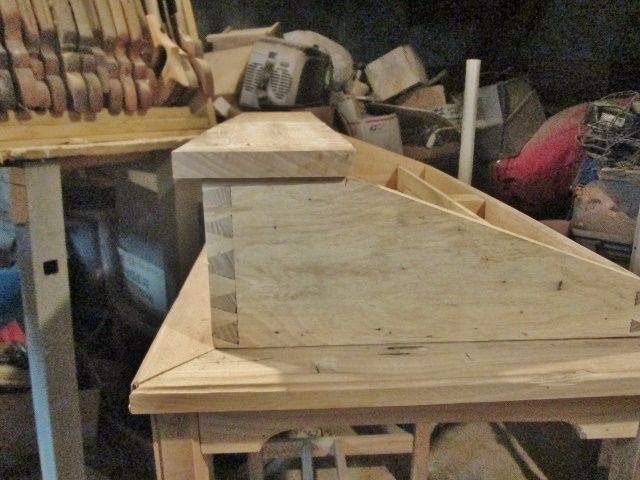

And attached the top shelf...need to make a baker's dozen plugs.   Installed some hinges...usual toys..
Almost needed an extra hand...wax on the threads helped.  Finally..
C clamps are doing a glue up...

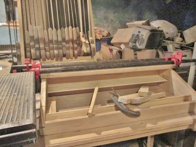

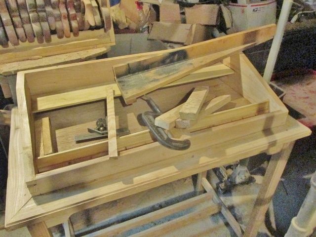

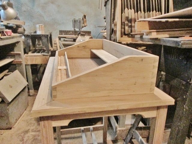

Adding a book rest...a view from the end?B)

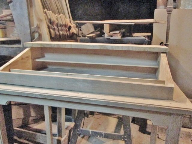

We getting there..:TwoThumbsUp:...and a before?
Before all the angles were made...making sure the lid was long enough...
Just 2 hours today    may start on the drawers..next time...:ChinScratch:
