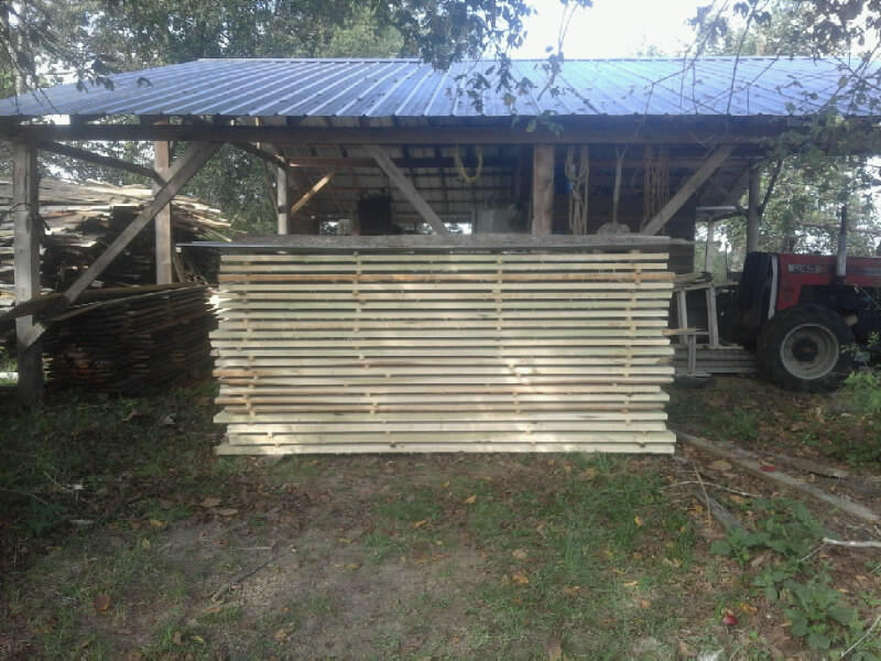

John the Cedar will be ready in a couple of months. It dries way faster than anything I have.
We don’t wrap it, but it’s stored in a 60x80 metal building that acts like a kiln. We just sticker and stack it good so it get air flow through and around all the boards.
This summer when it’s been upper 90’s it was hot inside the building. It has eight roll up doors and I open them to get airflow.
It it has worked for me.

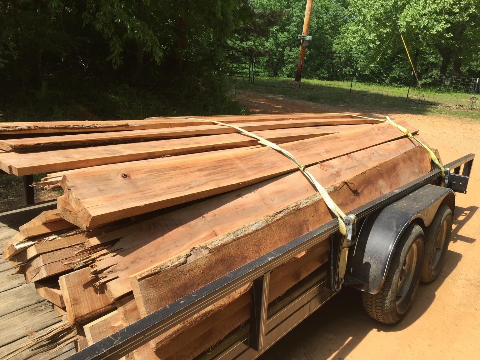

It’s Eastern Red Cedar.

We try to stay far enough ahead to allow it plenty of time to dry. Some I can use in a year. Some I’ve had stacked a couple of years. I’ve had some slabs cut and it takes them about 2 1/2 years to be dry enough to use.

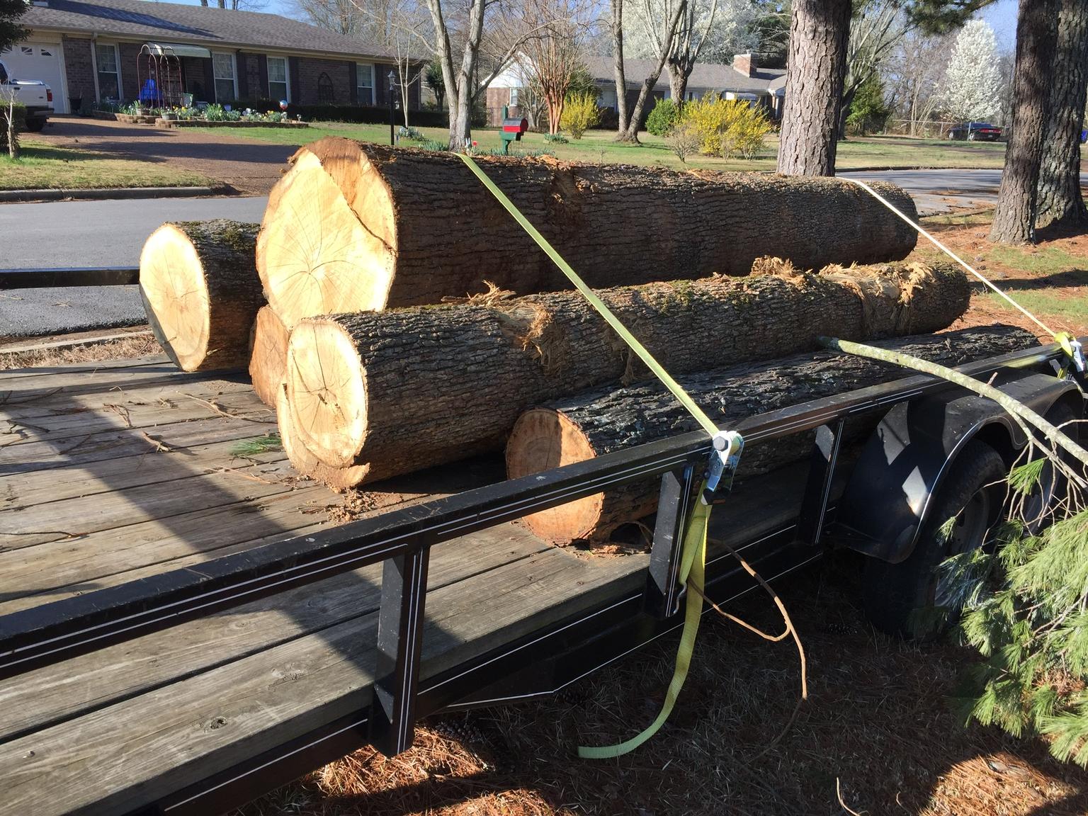

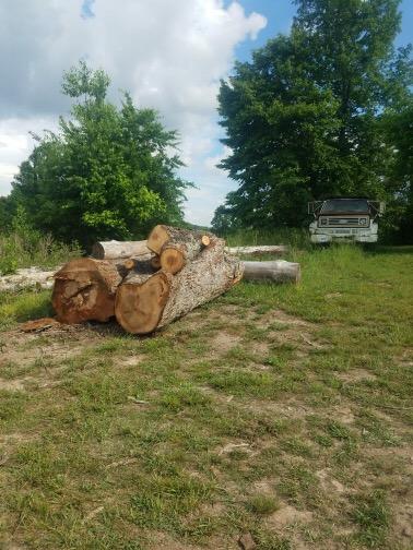

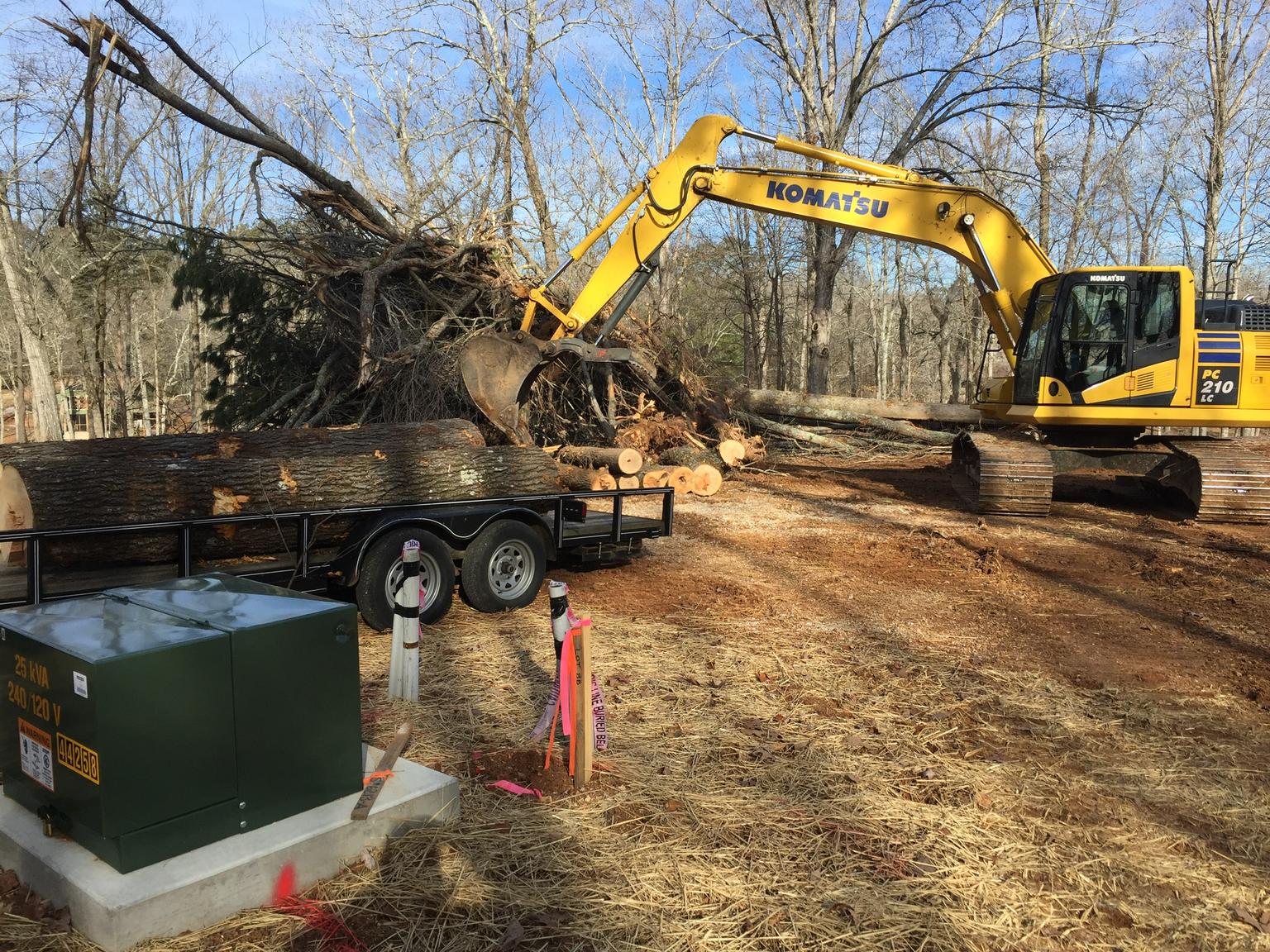

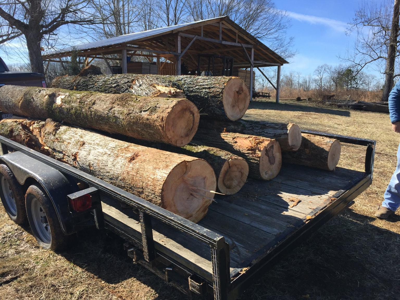

This is the way I get logs. A lot was being cleared for a new house. They marked the trees to come down, called me and we picked the ones we wanted. They took them down, loaded them and I carried the to my sawer.B936ECDE-6216-4EDB-BAA3-9DC61E498003.jpeg

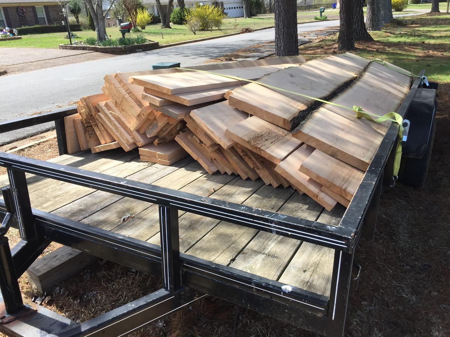

he then cuts it and loads it on my trailer if I’m bring it back right then.

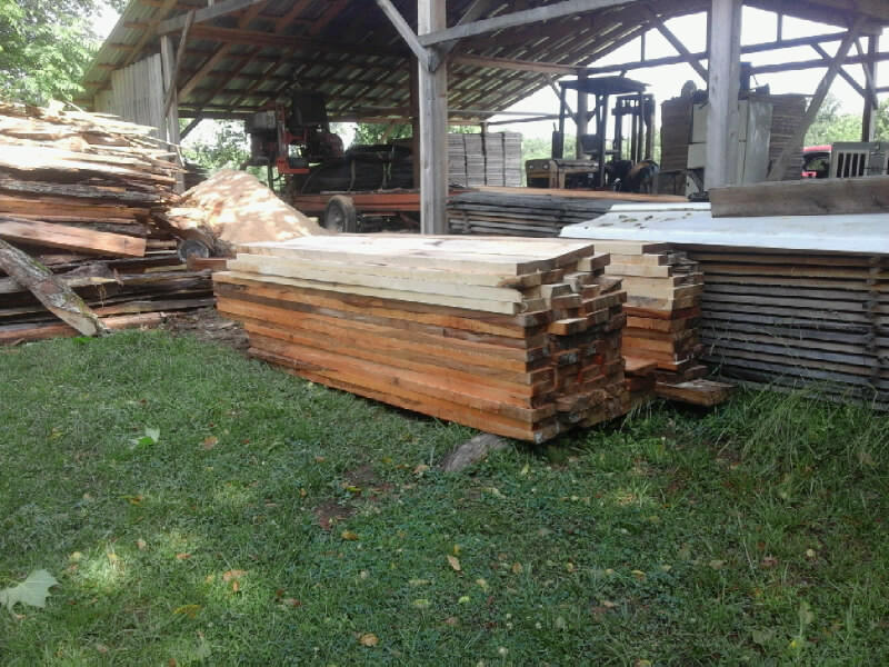

but he cut me some poplar and stickered it for me till I pick it up.
over to the right of the poplar is some cherry I have stickered and stacked at the mill.
and the last two pictures he has stickered and stacked also. Some maple, cherry, Hickory, elm, and oak.
right now I have close to 10,000bf of lumber stored in three different places.

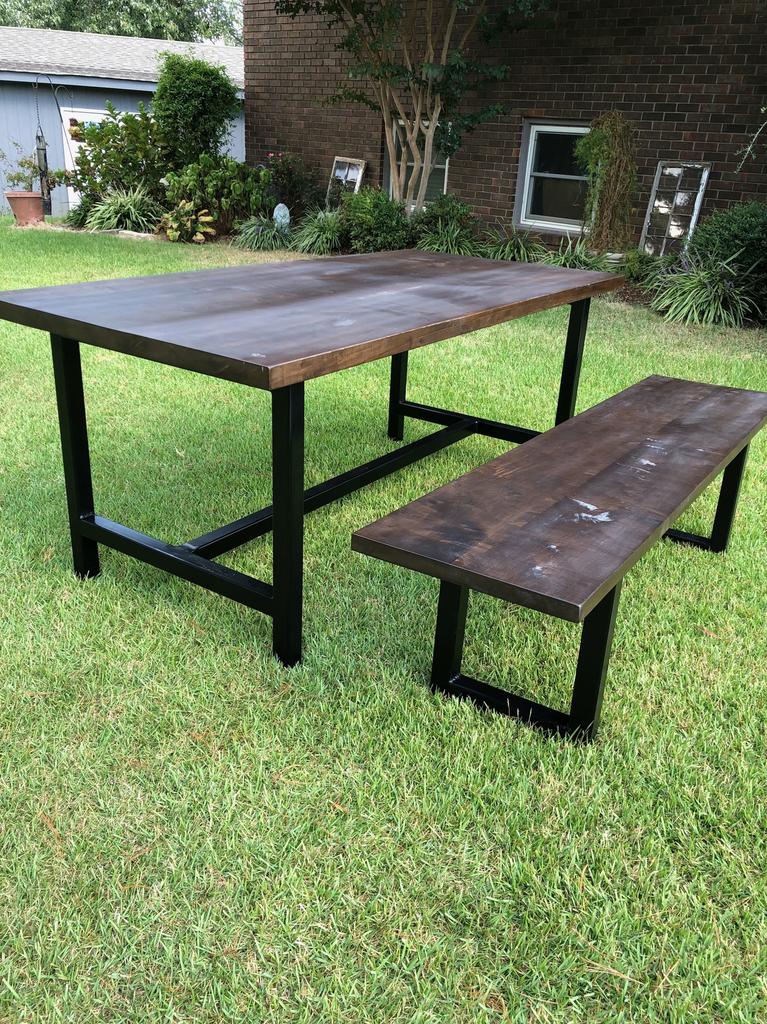

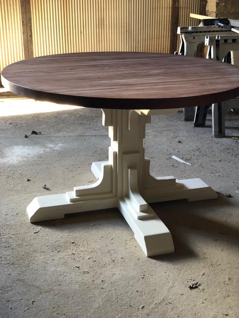

All of these pieces of furniture were built from air dried lumber that we took from the tree to the board to the piece.
The big advantage of getting your own trees and taking to the mill around here is price.
if I take the tree to them, it gets cut and loaded on my trailer for .20/bf no matter the species.
if the have the tree and cut it and call me to buy it, it cost me $1.00/bf no matter the species.
so if I take the trees and cut a 1000bf of lumber it cost me $200.00, where if they have the tree and I buy it it cost me $1000.00 for a 1000bf of lumber, no matter the species.
i like to get the trees!
What wood do you use for your stickers John?
Random species cut-offs or a specific specie?
Size ~1"x 1"square or???
One time use or reuse until?
Great information! BTW, where did you say the drying barns were located?:rolleyes:
Yo @John Moody,
Sweeeeet!!! :2030125484_TwoThumbsUp:
We try to reuse the stickers. The safer at the mill cut me a bunch when he was sawing of different species. I try to separate them and use the Cherry with the Cherry and maple with the maple and so on.
