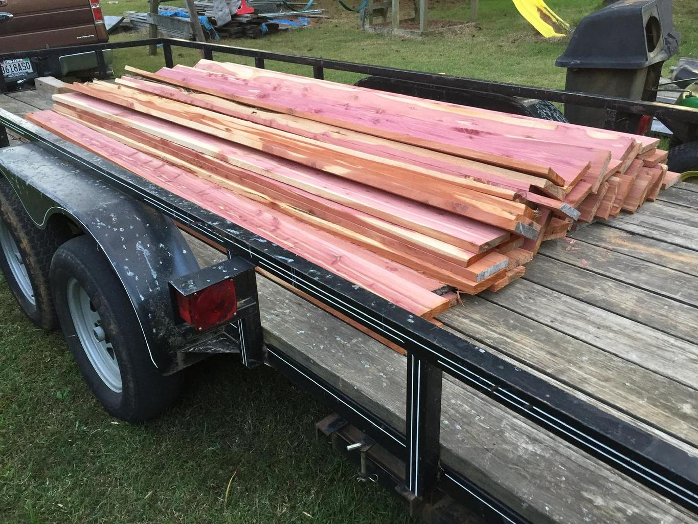

i just picked this Cedar up at the mill Tuesday afternoon. Already got it stickered and stacked.

John, in your experience, how long will it take until the cedar is ready to use?
Also, do you wrap your lumber with anything while it's drying or is it just stickered in your lumber storage structure? Thanks!

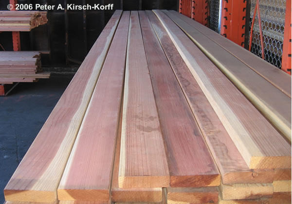

that sure looks like redwood..
Stick,
I believe it's Eastern Red Cedar, I've got a few of those trees but nothing big enough to harvest yet.
4 minutes ago, Larry Buskirk said:
Stick,
don't see much ERC here..

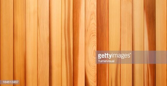

WRC
western-red-cedar-timber-panelling-pictu
Redwood
wood_clear_redwood_2by6.jpg&f=1
We'll have to wait on @John Moody to see what he says it is. :998427331_ChinScratch:

he already said it was cedar...
But what kind of Cedar? :huh:
If John Moody says it's cedar, you can rest assured it's cedar, he's been using it for years building his Green Egg tables. As far as the type of Cedar, it would make sense it's Eastern Red Cedar.
Perhaps our Wiki has information on it.
eastern red...
