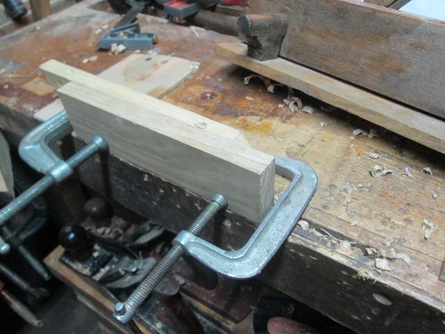

Made a jig to hold the parts still, long enough to make a groove..
Once the groove had started..rubbed the sides with the candle....made things move a little better...reset this jig...

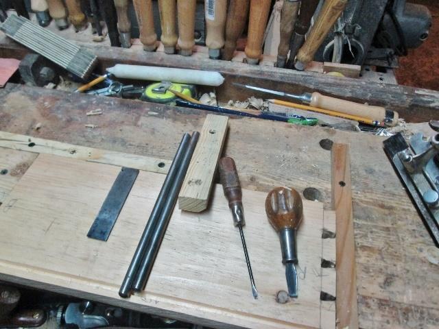

Then rebuild the jig again..and the Stanley 45....needed a few new parts..
Skinny screwdriver to change the nickers...one of which needed a quick hone.   Long rods instead of the shorter ones..more balance that way.  Cutter is a #18 1/2, matches the thickness of the pine boards...rebuild..
Long rods and the cutter installed..nicker on the other side has been rotated to the cutter...
About like this...both "skates" have a nicker, for going across the grain.  needed a way to hold things steady, while I put this plane together
Another reason for these long rods..stick a little extra out the side....and clamp in the vise...
All assembled..skates have to be even with the edges of the cutter, to let the nickers do their job..Depth stop was set

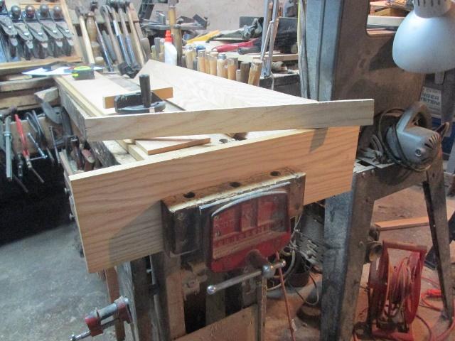

hauled the rest of the Oak from upstairs to the shop....had a puzzle to work on..
Because I need to build 2 doors, and that topper shelf...out of what I have left..
These three are 6-1/2 wide...by 3/4" thick....need 8" wide sides....
These two are only 5-1/2" wide, and are 3/8" thick....door panels?  Then there is this chunk...:1070527865_JawDrop:
A 1 x 12....need part of this for the very top of the case...
Without getting the crack involved. :998427331_ChinScratch:  Top of the case needs to be 9" wide..

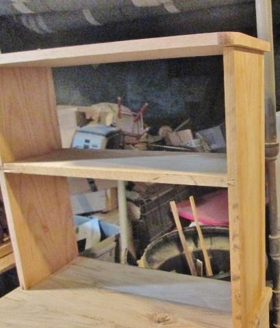

I also need a shelf for right above the microwave oven...8" wide....along with 8" wide sides
Will spend a bit of time, trying to get a "cut list" done up....Single Brain Cell Sketch Up  needs all the help it can get..:rolleyes:

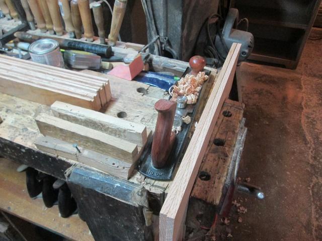

I took the WR #62 to this mess....I needed to find a center in the rough opening, set two stiles between the side and the center mark, measure  between the stiles, add an inch to that...to find out how long to cut these things down..into 4 rails....(turned out, I needed a fifth one..or..just a fifth?:angry:)..
Got things cut for length..at least they were all the same width....thickness?   these were still 4/4...needed 3/4" thick parts...set the tablesaw up, and "buzzed off " the extra wood....then face planed them smooth....Planes..?   Oh yeah..needed 9 grooves made ( total, counting a remake)...didn't feel like resetting the Stanley 45..

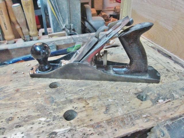

Plane was made in 1864...a wee bit before my time.  Cuts a 1/4" wide groove....will come in handy, IF I ever find it's "match", to do T & G joints..
Plane makes curlies for shavings....LOTS of curlies.  Combe square to tell me when I am deep enough...no depth stop on this plane...needed a lot of candle wax, too.

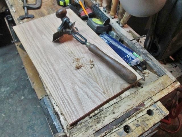

Panels were trimmed square as needed, then I laid a frame on top of the panel, to see where ti rip the excess width off..both edges...scraper to clean up the glue joints...
Thought I could just bevel one side...nope...had to bevel from both sides, for the panels to fit into the 1/4" grooves...
Called a Junior jack plane...was a little bit handier doing all them bevels...

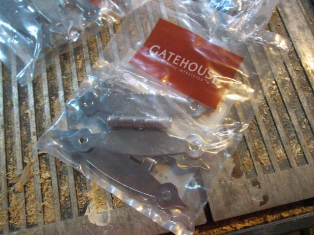

Hinges were bought..
Knobs were bought..
Along with washers to back them up.   Brushes were also stocked up on..

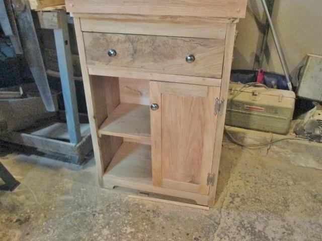

Laid these out twice, double checked even....one socket was 1/8 lower than the other?  went and cut off the offending extras to level the shelf...one side was installed via a hammer and a hardwood block....no glue was used.   Top shelf has 3 counterbored screws per side,   Need to make a pair of cleats, to attach the topper to the case...AFTER I sand the "H" out of it...A back needs a recess between the two shelves...rabbetting bit.
A look at the over all picture...
Doors get the same knobs.

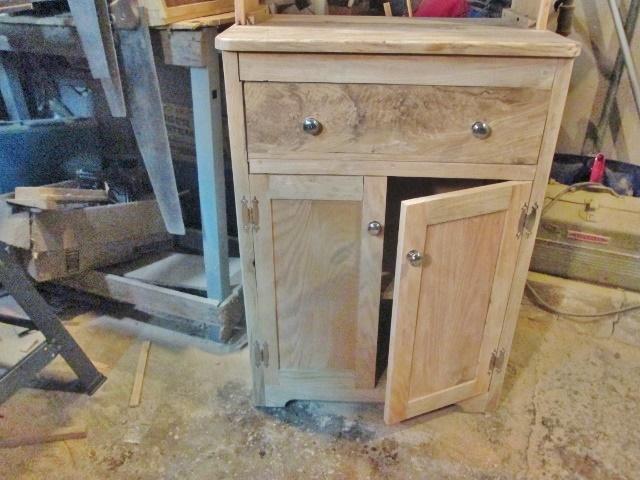

A view of the fixed drawer....more on that hole in a bit...needed to change over this thing..
To use a rabbetting bit...after I honed the cutting edges...
Needed a chisel to square the rounded corners up..
Then mark a plywood panel, to make a back for the topper..
Was just enough room to make the cut on the bandsaw...then glue and nails to attach the panel...
Needed a few plugs made, installed and trimmed down, before I could round over the edges...
Keeps the block from wiggling around...Next..was a door..
remember that hole?   Try to find it here.    Hinges..
Kind of like that Yankee drill...VIX bit wants to wander around.  Knob and hinges installed..
Note that thin strip of wood?  I had that under the door, while attaching the hinges to the case..second door needed trimmed for width..
After the bandsaw remove the bulk of the extra...plane to joint the edge...test fit..joint the other edge...repeat until the door fits..wasn't taking all that much off each time..
Didn't want to take too much off...
need to install the magnetic catches, to keep these two shut.   Step back a bit...ready?
Topper has been attached with cleats.  Big opening is for the Microwave to go.. Top edges are rounded over, plugs sanded flush, From edges of the shelf and the sides are also rounded over.

Topper and the drawer installed....tried to add the catches before the case came upstairs...one went on nicely enough, the other had been broken at the store...went in the trash..anyway, this was as far as I got for a bit..
Fancy drawer joints?
Front view?
And, you can see the cleats that hold the topper in place...
Need to fix the flooring...but this is what she wanted....Microwave fits like it was built for it.   Power strip hung on one side, Boss has already started to load this thing up.  Not sure what she'll do with the opened areas...yet.   May get a series of narrow shelves between it and that door jamb?   May get storage between this and the stove, too.  For some reason, I am a bit tired out, today....
